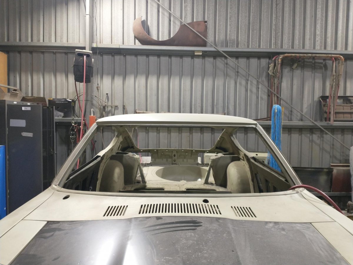

Wags Posted August 30, 2020 Author Posted August 30, 2020 Got some more photos from Locky of CAF. Check out these beautifully gapped panels! Bodywork is almost drawing to a close. Some beautiful work done to this shell thus far. looking on track, and in to paint when our guy is next available. Dragonball240z, Enzo, AndBir and 5 others 8 Quote

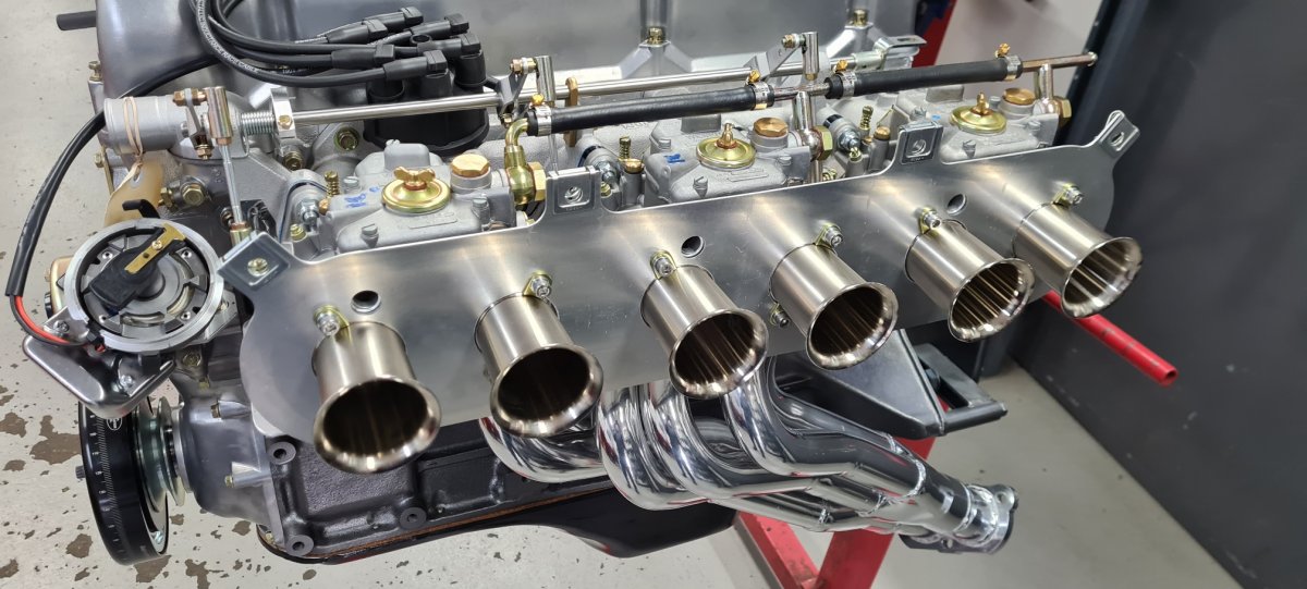

Wags Posted September 5, 2020 Author Posted September 5, 2020 More pictures from the artists at LCR today. Engine almost complete and ready to go on the Dyno. The ATI balancer we ordered arrived and when that goes on we will kick it over. CBR Jeff, JDM-TOY, OdinZ and 1 other 4 Quote

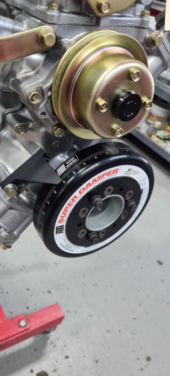

Wags Posted September 8, 2020 Author Posted September 8, 2020 More pics from Les at LCR with the ATI balancer in. CBR Jeff, Ponyo240z and 240ZBUILTBYME 3 Quote

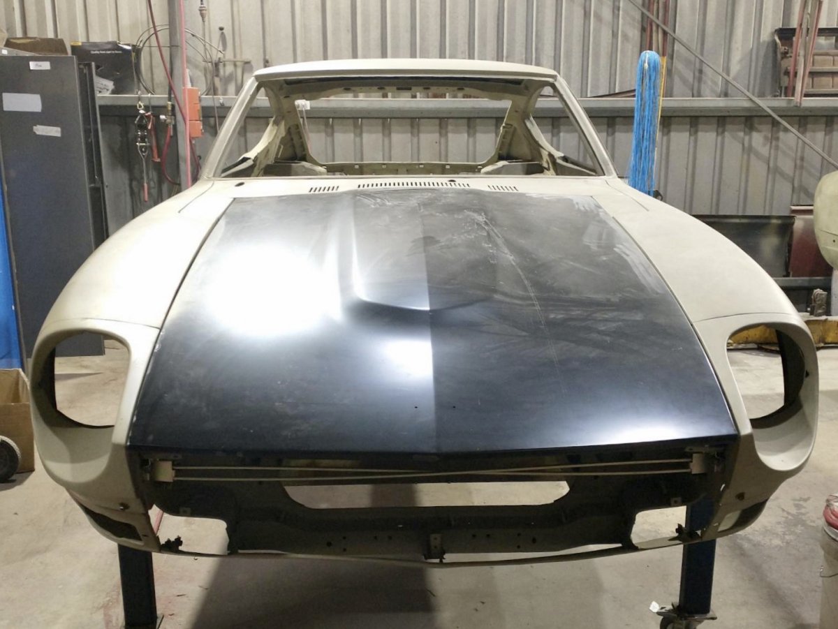

Wags Posted September 8, 2020 Author Posted September 8, 2020 Couple of more update pics from Locky at CAF showing what, I think, is the most amazing angle of these cars...front on and low. 240ZBUILTBYME, Ponyo240z, JDM-TOY and 2 others 5 Quote

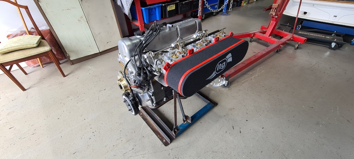

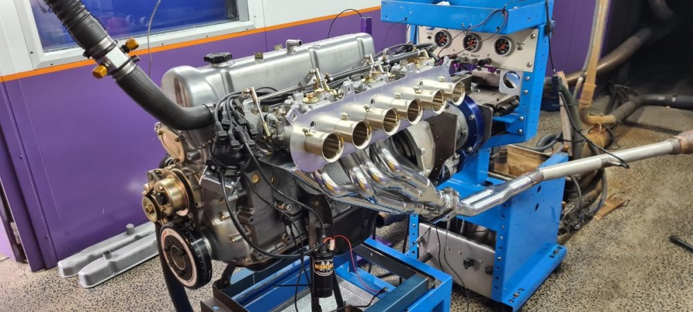

Wags Posted October 14, 2020 Author Posted October 14, 2020 Engine is on blocks ready for the dyno CBR Jeff, C.A.R. and OdinZ 3 Quote

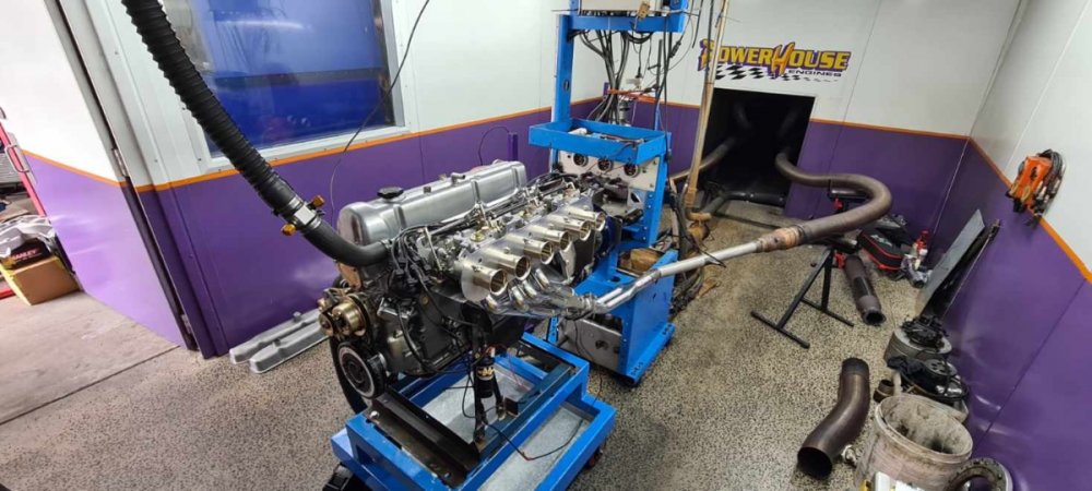

Wags Posted October 14, 2020 Author Posted October 14, 2020 Engine is in on the dyno C.A.R., Ponyo240z, AndBir and 2 others 5 Quote

AndBir Posted October 15, 2020 Posted October 15, 2020 On 10/14/2020 at 4:04 PM, Wags said: Engine is in on the dyno Drum roll...............................and the results are? Wags 1 Quote
C.A.R. Posted October 15, 2020 Posted October 15, 2020 (edited) The dyno cells fuel supply pump failed, so a new one has been ordered, then it has to be fitted. Engine won't be dyno'd until next week now. Edited October 15, 2020 by C.A.F. OdinZ and CBR Jeff 2 Quote
Wags Posted October 15, 2020 Author Posted October 15, 2020 1 hour ago, C.A.F. said: The dyno cells fuel supply pump failed, so a new one has been ordered, then it has to be fitted. Engine won't be dyno'd until next week now. Thanks mate :-) Les shot me a message re that. Oh well, thems the breaks. C.A.R. 1 Quote

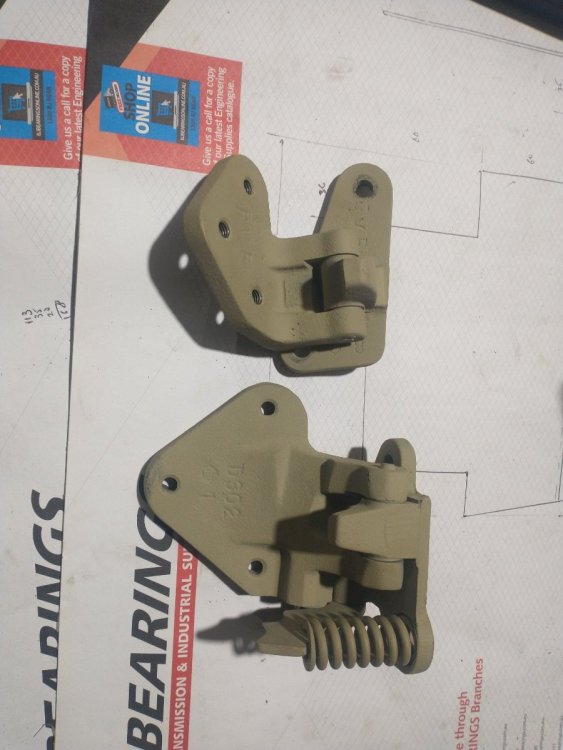

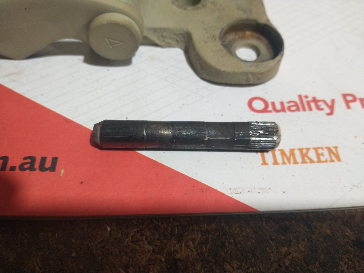

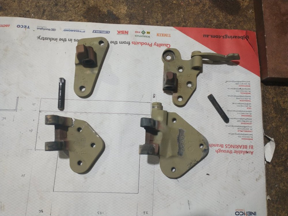

C.A.R. Posted October 15, 2020 Posted October 15, 2020 (edited) While setting the panel gaps I noticed that the RH door hinges had a small amount of slop. I contacted my friendly Z door pin and bush supplier but he was out of stock. I had to wait, but a couple of weeks ago they arrived and I finally had time to fit them. The pins were obviously slightly worn, however the new pin and bushes (along with a good greasing) have completely removed any movement from the hinges. Should be good for another 50 years now! Edited January 23, 2021 by C.A.F. mossy, Wags, gav240z and 1 other 4 Quote
Wags Posted October 15, 2020 Author Posted October 15, 2020 2 hours ago, C.A.F. said: While setting the panel gaps I noticed that the RH door hinges had a small amount of slop. I contacted my friendly Z door pin and bush supplier but he was out of stock. I had to wait, but a couple of weeks ago they arrived and I finally had time to fit them. The pins were obviously slightly worn, however the new pin and bushes (along with a good greasing) have completely removed any movement from the hinges. Should be good for another 50 years now! You’re the man Locky! Stoked with your workmanship and dedication! OdinZ, gav240z and C.A.R. 2 1 Quote

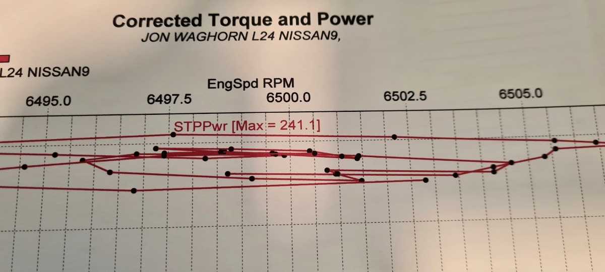

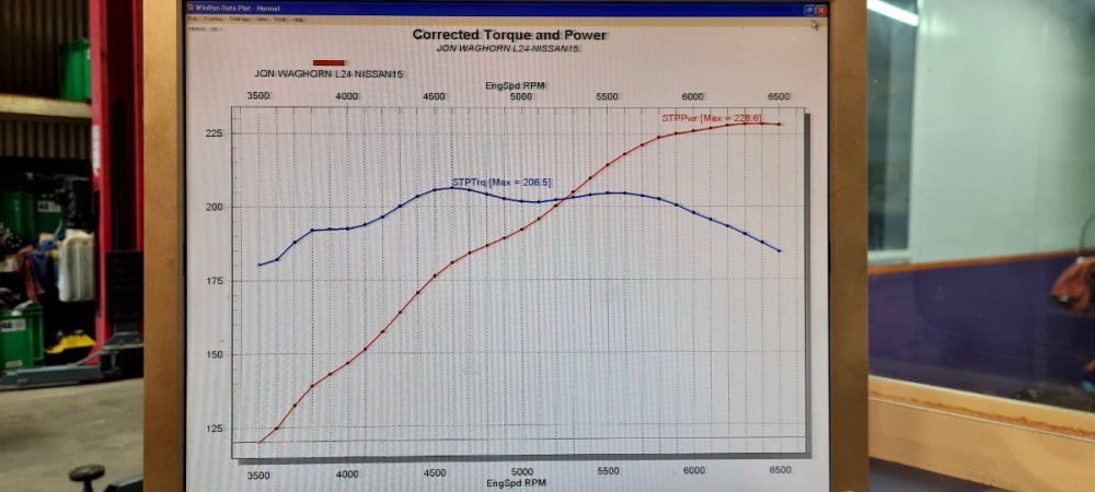

Wags Posted October 16, 2020 Author Posted October 16, 2020 The Dyno ran today. here is the readout: 241bhp at 6500rpm OdinZ 1 Quote
Wags Posted October 16, 2020 Author Posted October 16, 2020 This is a ramp run from 3500 to 6500 Excellent torque and power curves. Holds power to 6750 before starting to roll off. 240ZBUILTBYME, mossy, CBR Jeff and 1 other 4 Quote
Wags Posted October 16, 2020 Author Posted October 16, 2020 Credit to Les Collins and the team at LCR! That’s brilliant! gav240z and CBR Jeff 2 Quote
