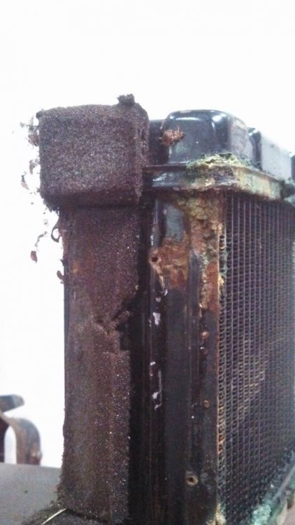

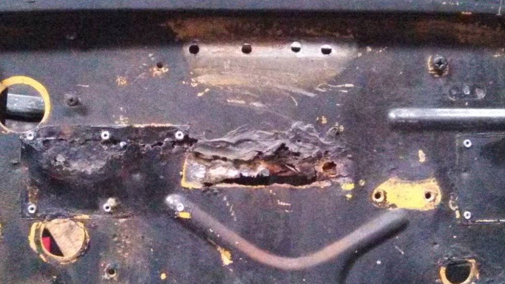

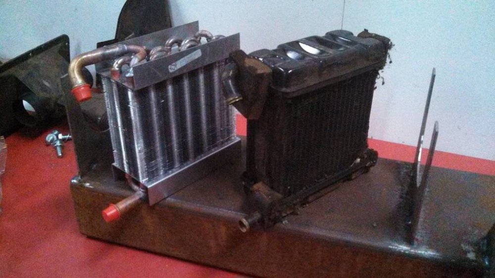

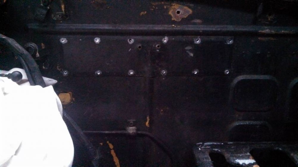

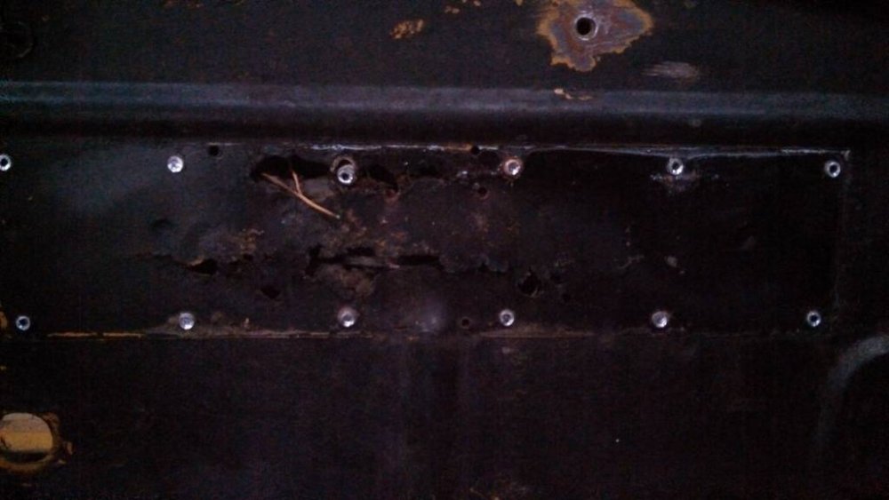

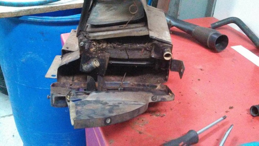

C.A.R. Posted October 31, 2015 Author Share Posted October 31, 2015 (edited) After blowing the heater core at the 2014 PI 6-Hour, I decided to replace the core with one I bought from the US. Upon removing the cover off the side of the box I found all this debris: And the damaged core which took me the best part of 30mins to extract as it had corroded itself into the box... New Vs Old: Next I removed the plates that were riveted to the firewall to cover the rust: Eww... Tis a good time to fix that properly! More soon... Edited June 3, 2016 by Lurch ™ gav240z 1 Quote Link to comment Share on other sites More sharing options...
Moderators PB260Z Posted October 31, 2015 Moderators Share Posted October 31, 2015 Nice looking heater core, very nice indeed. But gotta ask why not just get the old one rebuilt by a old school radiator shop ? Looking forward to seeing the old girl back on the road. Quote Link to comment Share on other sites More sharing options...
CroS13 Posted November 1, 2015 Share Posted November 1, 2015 ^^Sometimes that can be more expensive, perhaps that's the reason? i had my radiator rebuilt by a old school shop, it cost $500 because they needed to fit a new core to it. I only did it because i was able to write the cost off at work. If i had to pay for it, id probably just have gone an E bay jobbie.looking good Locky. I like the previous owners thinking, if we cant "see" the rust, it isn't there!......... gav240z 1 Quote Link to comment Share on other sites More sharing options...
C.A.R. Posted November 1, 2015 Author Share Posted November 1, 2015 (edited) I was fairly positive that the heater core would beyond repair, hence the new core. I might take the old one into the radiator shop & see what they say.... Rudi: Harry (RIP) loved the Zed, but it seams (After talking with Gordon Dobie) he never really had the $ to maintain the Early Girl properly.Hence silly thing's like pop-riveted plates on the firewall... Edited November 1, 2015 by Lurch ™ Quote Link to comment Share on other sites More sharing options...

dat2kman Posted November 1, 2015 Share Posted November 1, 2015 Recently had a 240z radiator top and bottom tanks sweated off, and tubes rodded/cleaned out, tanks sweated/soldered back on, pressure tested, all good, $132. In Brisbane. Core was in good cond, no collapsing fins. They can do heater cores, and fuel tank internal/external coating. FYI,,,,, Quote Link to comment Share on other sites More sharing options...

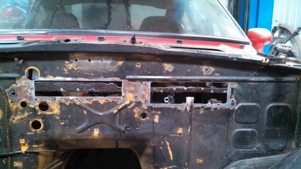

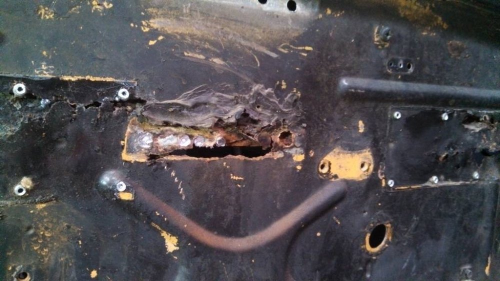

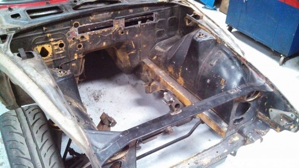

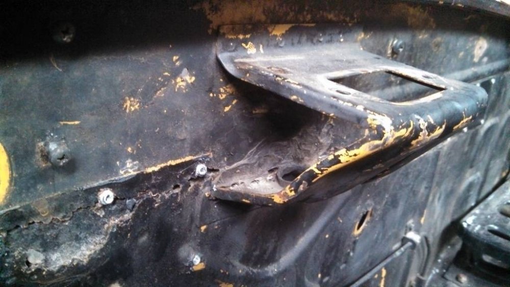

C.A.R. Posted January 3, 2016 Author Share Posted January 3, 2016 So I HAVE been making progress with this - just not as much as I'd have liked!Engine bay is mostly stripped of components, &I decided I needed to tackle the firewall rust. On closer inspection, it seemed the extent of the rot had crept past bonnet catch mount: so I had to take action and... Off it came, revealing the HOLE underneath It was at this stage I decided to get the angle grinder out & start cutting:So now I have massive holes in my firewall.I've buffed back the rust to get some cleaner metal & given the affected area's a coat of Phosphoric Acid.I've also cut some replacement sheet steel to weld in, but no more progress until next weekend when I can get back to it. KatoKid and gav240z 2 Quote Link to comment Share on other sites More sharing options...

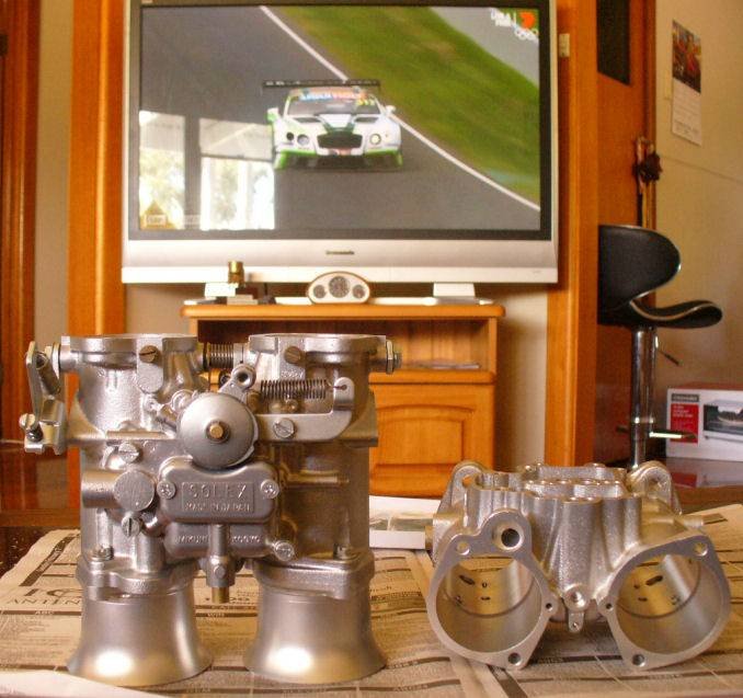

Riceburner Posted February 7, 2016 Share Posted February 7, 2016 They look brand new have they been water jet blasted? What choke size do you think it will end up with? Quote Link to comment Share on other sites More sharing options...
C.A.R. Posted February 7, 2016 Author Share Posted February 7, 2016 So your car was originally mustard........ Ever thought of going back while you're doing all this work? Correct mate - it was originally Safari Gold. But I won't be going back to that colour, as a Red car with a Safari Gold engine bay will look odd... They look brand new have they been water jet blasted? What choke size do you think it will end up with? Yes G-Man - water-jet blasted & all the steel items have been re-plated. No idea on choke size atm. We'll start with 43's & tune from there. Quote Link to comment Share on other sites More sharing options...
