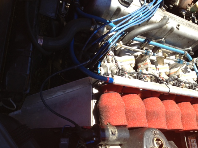

As Gareth alluded to in his above post, last financial year I got a fairly sizable Tax return & part of money from that went into these:
EFI Hardware 45mm parallel throttle bodies & (courtesy of 'D3coy' - thanks Jake!) a Kameari 50mm manifold.

:o very nice Lurch. Do I see some SWM headers in there too?
If you can be bothered I'd love to see a 'how to' or 'sticky' on the R32 front and rear brake upgrade  ;)
Awesome, your "Early Girl" just keeps getting better  :)
Looking forward to seeing it when I am in that part of town.
Ready for the drive day Lurch? I'd be interested to see how the l24 goes with the throttle bodies  ;)
It goes well, very well. Trust me  ;)
