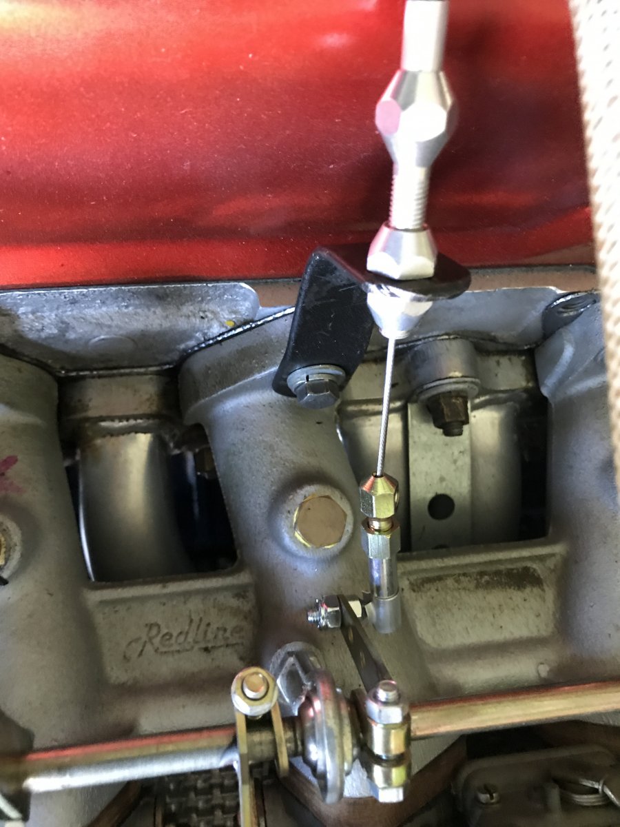

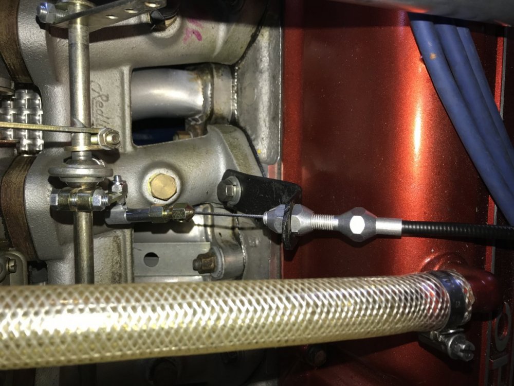

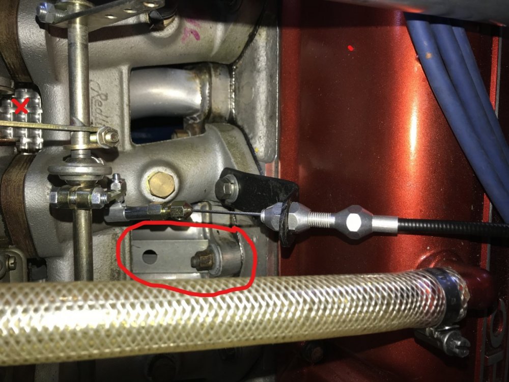

peter t Posted August 22, 2020 Author Posted August 22, 2020 Well I had issues with the throttle linkages being sooooo old so I fitted up a new cable and what a difference. So responsive got rid of all the jerking etc. RAP260 1 Quote
peter t Posted August 24, 2020 Author Posted August 24, 2020 The cable bracket looks flimsy but is solid steel. Made from an old cargo barrier bracket and doesn't flex. Quote
RAP260 Posted August 25, 2020 Posted August 25, 2020 On 3/7/2020 at 2:41 PM, peter t said: A couple more teasers. IMG_1277.MOV Looking fantastic Peter. Love how it sits. Your running kdrs-09 and kdfl-04 springs, with the shorter strut tophat / insulator on the rear, correct? Cheers, Rob P. S. Yea, you can't beat a cable. I'm using them on my HS6's, so smooth. peter t 1 Quote

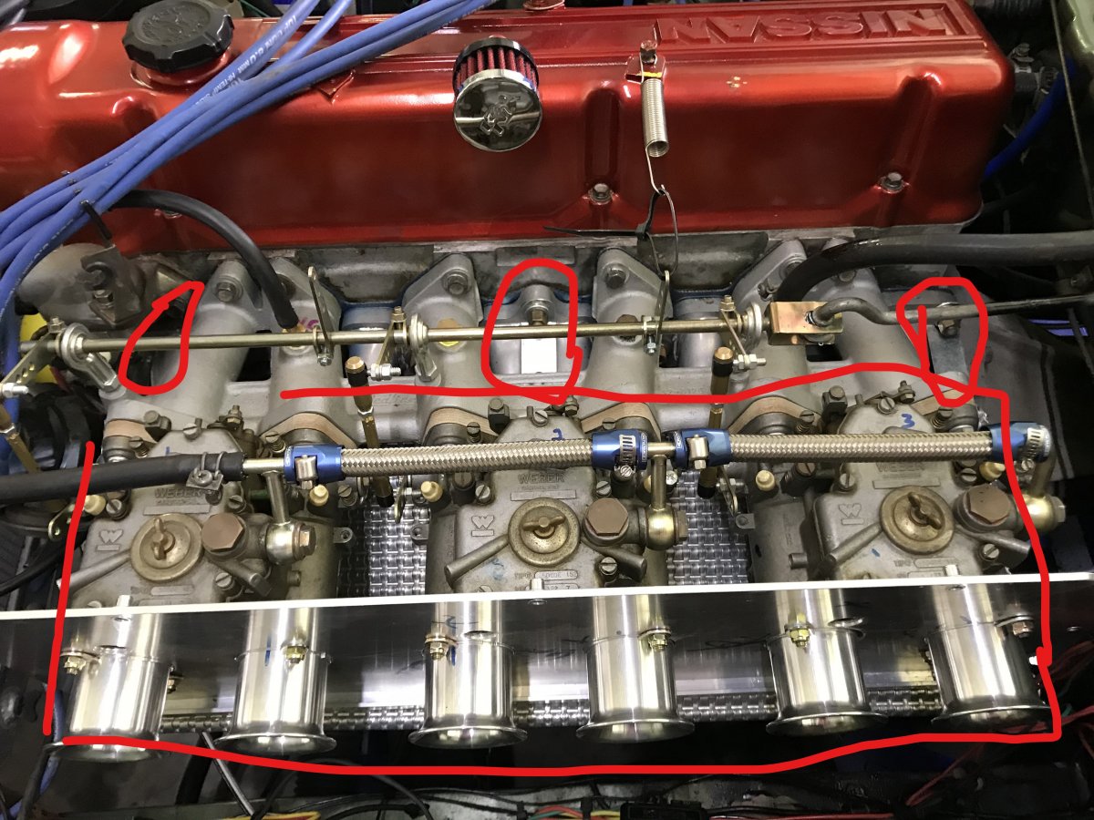

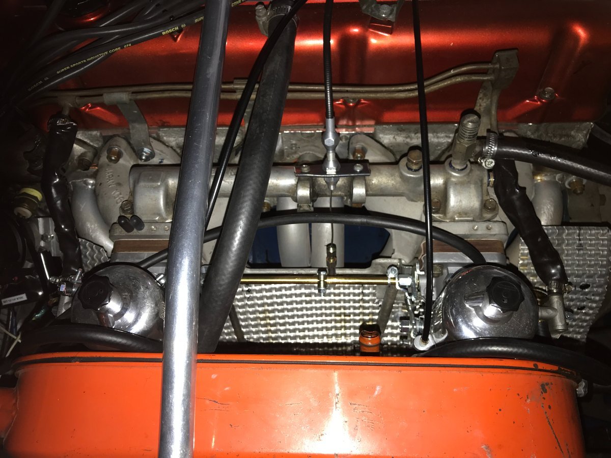

AndBir Posted August 25, 2020 Posted August 25, 2020 On 3/7/2020 at 12:36 PM, peter t said: Well the old bus has a new heart. Hi Peter, I am interested in how you made/attached your heat shield for the carbs - any tips you can pass on would be appreciated. Thanks, Andrew. Quote

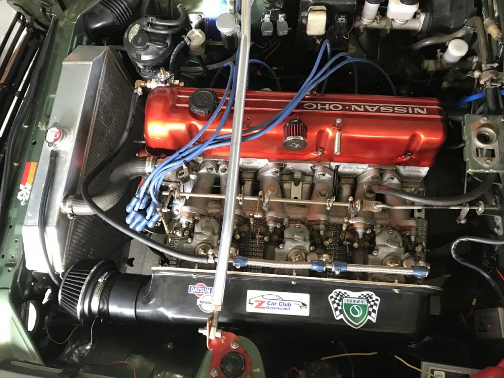

RAP260 Posted August 25, 2020 Posted August 25, 2020 (edited) 2 hours ago, AndBir said: Hi Peter, I am interested in how you made/attached your heat shield for the carbs - any tips you can pass on would be appreciated. Thanks, Andrew. I'm interested in how Peter solved this problem also. But I'll share my solution. The heat shielding looks very similar to what I used when I had triples . ACL Heat Shield. http://www.autoxcel.com.au/product_info.php?products_id=140 I made use of the existing holes in the webers to basically suspend mine below the carbs. I used threaded rod, worked a treat. Refer to the attached picture. Had it fixed at 3 points. Hope this is of some help. Edited August 25, 2020 by RAP260 Quote
AndBir Posted August 25, 2020 Posted August 25, 2020 2 hours ago, RAP260 said: I made use of the existing holes in the webers to basically suspend mine below the carbs Thanks, that looks the go - I will give it a try Quote
peter t Posted August 27, 2020 Author Posted August 27, 2020 (edited) On 8/25/2020 at 8:36 PM, RAP260 said: I'm interested in how Peter solved this problem also. But I'll share my solution. The heat shielding looks very similar to what I used when I had triples . ACL Heat Shield. http://www.autoxcel.com.au/product_info.php?products_id=140 I made use of the existing holes in the webers to basically suspend mine below the carbs. I used threaded rod, worked a treat. Refer to the attached picture. Had it fixed at 3 points. Hope this is of some help. yep I used three modified brackets that are for Air pods bolted to heat shield and then bolted to manifold studs. Edited August 27, 2020 by peter t RAP260 1 Quote
peter t Posted August 27, 2020 Author Posted August 27, 2020 This may be better. PB260Z and RAP260 2 Quote
AndBir Posted August 27, 2020 Posted August 27, 2020 4 hours ago, peter t said: This may be better. Thanks Peter, I appreciate the extra detail. gav240z 1 Quote

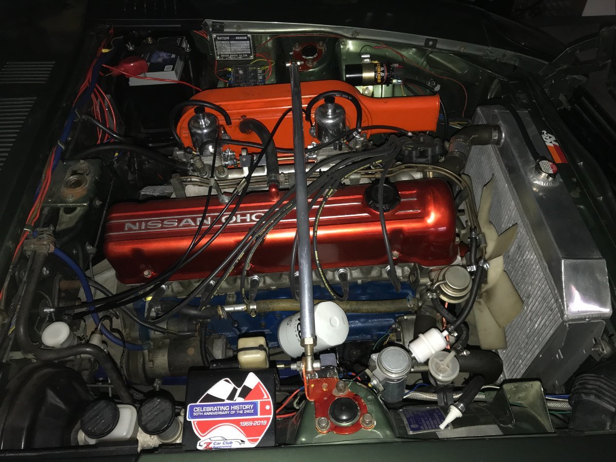

peter t Posted December 29, 2020 Author Posted December 29, 2020 Well after a few more additions this is the Christmas 2020 COVID version.LOL. New engine is going great after final dyno tune. Wiper upgrade done with new wipers as well. New koni yellow adj shocks all round and Standard King springs installed. I got sick of it hitting down all the time. ( getting old) Lets all hope for a better 2021 but I think its just a case of getting used to the new world of COVID shit. I am looking at getting valves inserted in my lungs in the new year so I can breath a bit better so I hope that works. Meanwhile here is the 12/20 version of my Bus. Oliphips, Enzo, CBR Jeff and 3 others 6 Quote

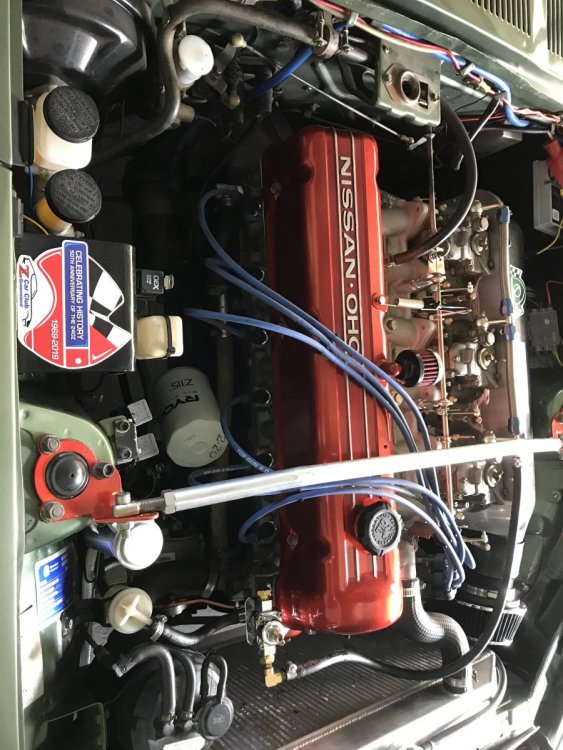

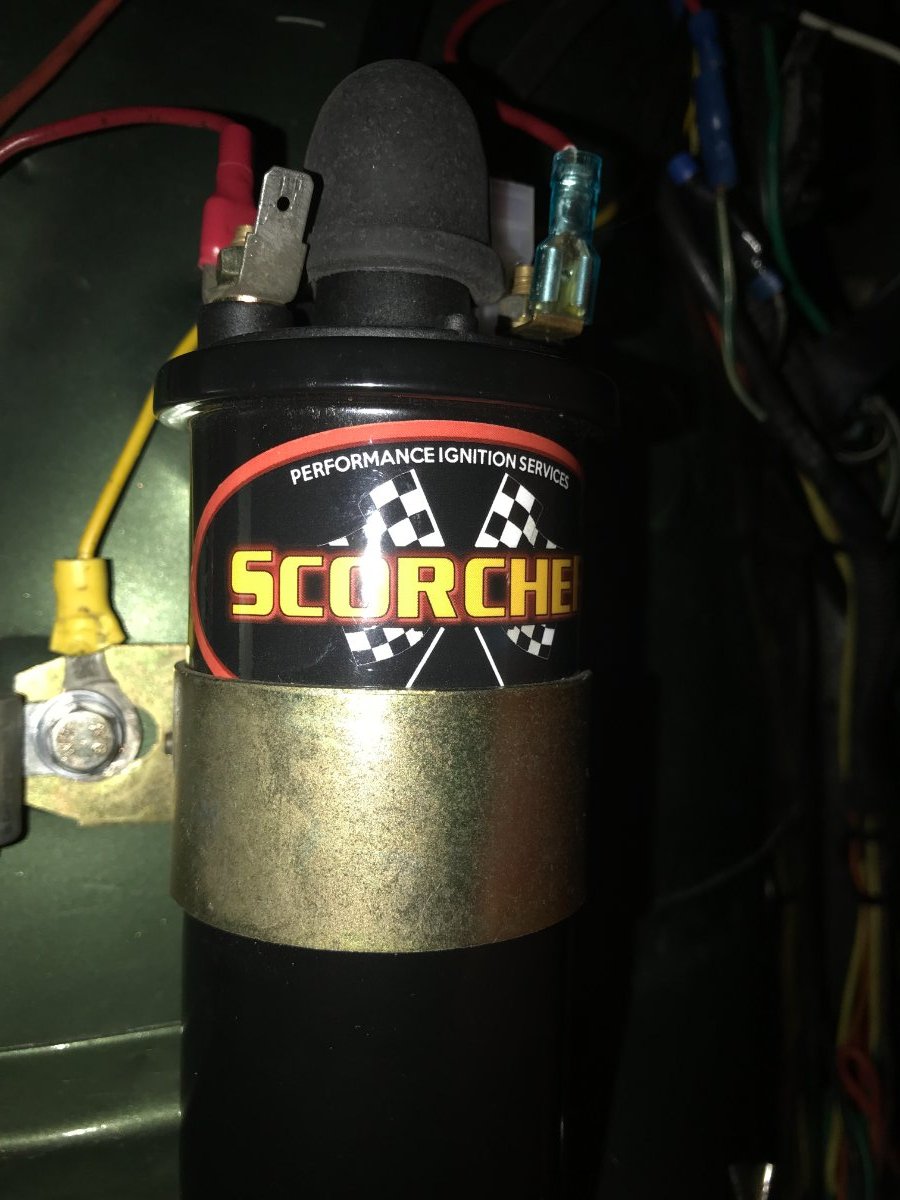

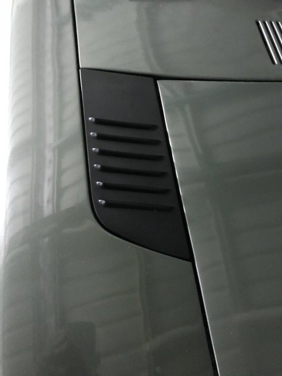

peter t Posted October 31, 2021 Author Posted October 31, 2021 Must be getting old so here is an update to what has happened to the old bus. Got rid of the triple 45's / Wasn't happy with them as a road car and got sick of the carter pump groaning away and annoying crap out of me. Went back to the Holly but couldn't stop it from fouling plugs. Purchased a set of brand new 1 3/4 SU carbies, Scorcher ignition system, new leads and plugs. Fitted a o2 sensor port in headers for tuning. Car now goes beautiful after being tuned by a good mate who knows what he is doing. Fitted new Koni yellow shocks and King standard springs/getting too old for low. LOL. Now have a very enjoyable Z to drive. Also have some fluted vent panels from Skillard. Oliphips, gilltech, sexual_sushi and 2 others 5 Quote
