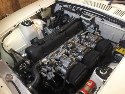

adam Posted September 4, 2019 Posted September 4, 2019 Hi all, Thought I'd be a little old fashioned and use forums instead of modern age Facebook social media. Those of you who have rebuilt your L series motors, whether it be L24, 26 or the L28, has it been worth the effort? Let's be honest, in this day and age, you can buy much quicker cars and motors. I'm currently running a stock L28 with triple carbs and a full exhaust, it does the job and love the fact I can squirt it around town without breaking speeding fine records. It's a little tired, chewing through oil, leaking a bit here and there. Was thinking of a standard rebuild, possibly flat tops and mild cams but the question, did you take it a bit further? Was it worth it? If you could do it all again, what would you do differently? Original L series is my goal but should I waste my time? Keen to hear from those who have done it. Thanks, Adam gav240z 1 Quote

adam Posted August 24, 2020 Author Posted August 24, 2020 (edited) Just wanted to report back because of iso boredom. Ended up getting the spare motor built, standard crank, aftermarket H beam rods, 1mm oversized dished pistons and your usual ARP bolts, fresh seals, etc. Got machine work done, bearings to suit from machine shop so it was just a matter of slapping it all together at home. Was going to go flat top pistons but supply and concerns around detonation with stock cams, i decided it wasn't worth the effort. Before Victoria/Melbourne went into our first lockdown, I managed to get the motor finished and installed. Did a few drives to run the motor in and what can I say, even standard build, the motor has so much more torque than the old motor. Blows less smoke, mid range pickup is amazing. This was literally no changes to carbs or cams as these were swapped out and over into the new motor. Would be interesting to dyno this motor and see what power it makes now after run in. To answer my own question of whether it was worth it, with my goal, this was enough. More than enough power to blast through the hills or cruise through it in 4th gear. The power drops off dramatically from around 5krpm though (so did old motor), so I'm currently looking into a new cam to open it up a bit. A 72 with high lift (which will require new springs and retainers) is looking like the choice at the moment as I don't intend on revving it any higher than 6.5krpm. Also got the spare flywheel machined and lightened too but didn't install it as it's a 240mm item while the HD clutch I had and transferred over was only a 225mm. Will hopefully get this in at some point. Edited August 24, 2020 by adam More detail added Ponyo240z and mossy 2 Quote

AndBir Posted August 25, 2020 Posted August 25, 2020 3 hours ago, adam said: I've done a heap of reading and experiences of hitting a wall and just making noise from 5krpm From your AFR plot you are going too rich at higher revs so you might need to change your emulsion tube. Quote
adam Posted August 25, 2020 Author Posted August 25, 2020 43 minutes ago, AndBir said: From your AFR plot you are going too rich at higher revs so you might need to change your emulsion tube. I believe the plots on my blog are all out of date. I've since tinkered with the jets some more and AFRs in top end are at 12 -12.5 now (from memory) which shouldn't be far off the mark. Believed I could do with one step up in air jet but wouldn't have thought it'll give that flat feeling Gav's also referred to. Quote
