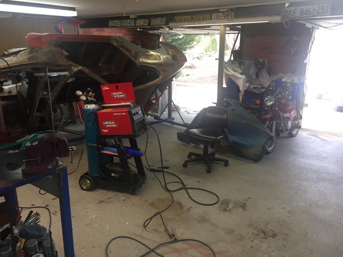

CBR Jeff Posted July 6, 2016 Author Posted July 6, 2016 Haha. Just arrived in Bairnsdale for the night. Will be in Warragul for coffee tomorrow morning. I'm excited. Quote
260DET Posted July 6, 2016 Posted July 6, 2016 Excitement has something to do with ^that^ picture I'm guessing Quote
Sirpent Posted July 7, 2016 Posted July 7, 2016 Think there will be some private corner time for you Jeff after you see and hear it run for the first time LOL CBR Jeff 1 Quote

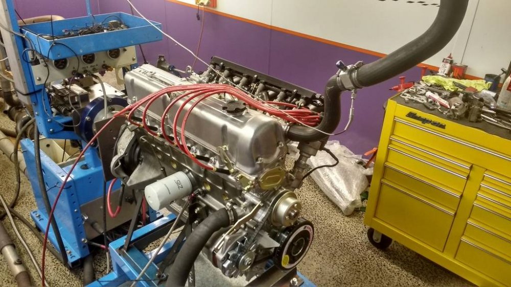

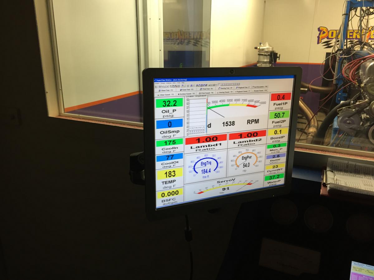

CBR Jeff Posted July 7, 2016 Author Posted July 7, 2016 Oh la la. 300hp give or take. Sirpent 1 Quote
C.A.R. Posted July 7, 2016 Posted July 7, 2016 305HP @ 6800RPM 260FT/LBS @ 4200RPMNot bad for an L24!!!https://www.facebook.com/LesCollinsRacing/videos/1820750944826013/ scott, andyk_79, CBR Jeff and 1 other 4 Quote

mossy Posted July 7, 2016 Posted July 7, 2016 This will make a few people want to do this to their L24, I was drooling over this motor the other week at the shop, sorry Jeff gav240z 1 Quote
Administrators gav240z Posted July 8, 2016 Administrators Posted July 8, 2016 But is it possible to do this with most L24's? Can they be over-bored enough? Or is most of the added displacement from the stroke of the crank? If the walls are too thin is re-sleeving an option to get more bore out of it? http://www.knowyourparts.com/technical-articles/installing-cylinder-sleeves/ Quote
CBR Jeff Posted July 8, 2016 Author Posted July 8, 2016 But is it possible to do this with most L24's? Can they be over-bored enough? Or is most of the added displacement from the stroke of the crank?If the walls are too thin is re-sleeving an option to get more bore out of it?http://www.knowyourparts.com/technical-articles/installing-cylinder-sleeves/Gav My understanding is the the over bore is not excessive. There is still enough to give another bore if and when required. Bore has gone from 83mm std to 85.5mm but the stroke has gone from 73.7mm to 89mm. That's the big jump. It sounded good at 7500 rpm. I did see it go to about 7800 as it settled for the 7500 static. Jeff. gav240z 1 Quote
260DET Posted July 8, 2016 Posted July 8, 2016 Does LC partly fill the coolant voids in the block? That helps support the bores considerably, as a rule of thumb a one third fill will not cause overheating problems, apparently. Quote
Riceburner Posted July 9, 2016 Posted July 9, 2016 Wow, it's going to be an awesome ride Jeff! Is it a 76degree cam or custom LCR? What are the plans for the driveline combo? Does LC partly fill the coolant voids in the block? That helps support the bores considerably, as a rule of thumb a one third fill will not cause overheating problems, apparently. I filled my L28 to the bottom of the water pump, it's had no impact on the cooling temps at all. Quote
CBR Jeff Posted July 9, 2016 Author Posted July 9, 2016 (edited) Wow, it's going to be an awesome ride Jeff! Is it a 76degree cam or custom LCR?What are the plans for the driveline combo? Hi Gareth. Yes it's going to be fun to drive. Gearbox and diff are the original units but have both had a rebuild. Jeff Edited July 9, 2016 by CBR Jeff Quote

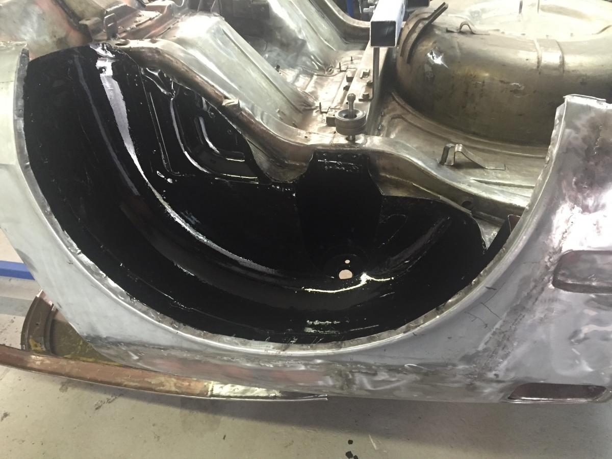

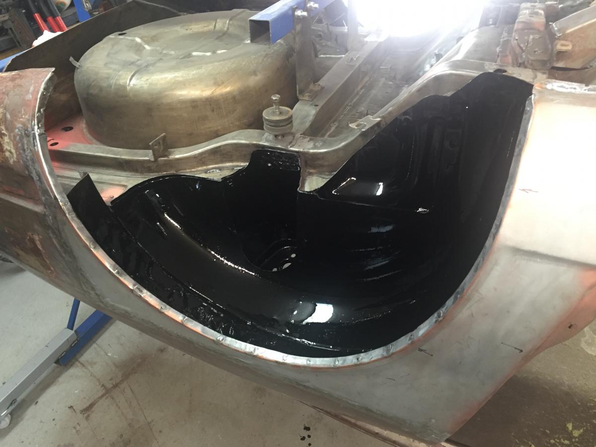

CBR Jeff Posted July 10, 2016 Author Posted July 10, 2016 (edited) Nothing more motivating than the events of last Thursday. Quite a few small jobs ticked off this weekend including a watershed moment. I managed to have a big clean up of the shed and can now move the Z around a bit more. Welded in the repair section I made a few weeks ago to replace the rusty gutter and I have finally applied some POR15 to the body. Just the inner rear guards and shock tower internals on both sides but a big step never the less. Edited July 10, 2016 by CBR Jeff Sirpent 1 Quote
Sirpent Posted July 10, 2016 Posted July 10, 2016 Always luvin your work Jeff. I'm not that familiar with POR15 apart from the bits Ive read here and there, was that applied by hand and did you need to use any primer? Also, do you intend using it as a base for any other finishes? Quote
CBR Jeff Posted July 10, 2016 Author Posted July 10, 2016 Always luvin your work Jeff. I'm not that familiar with POR15 apart from the bits Ive read here and there, was that applied by hand and did you need to use any primer? Also, do you intend using it as a base for any other finishes? Thanks John. POR15 is basically the same as KBS. You use it the same way and apply it likewise. This lot was applied by brush. It will have underbody then a top coat of paint applied in the future. Jeff Quote
