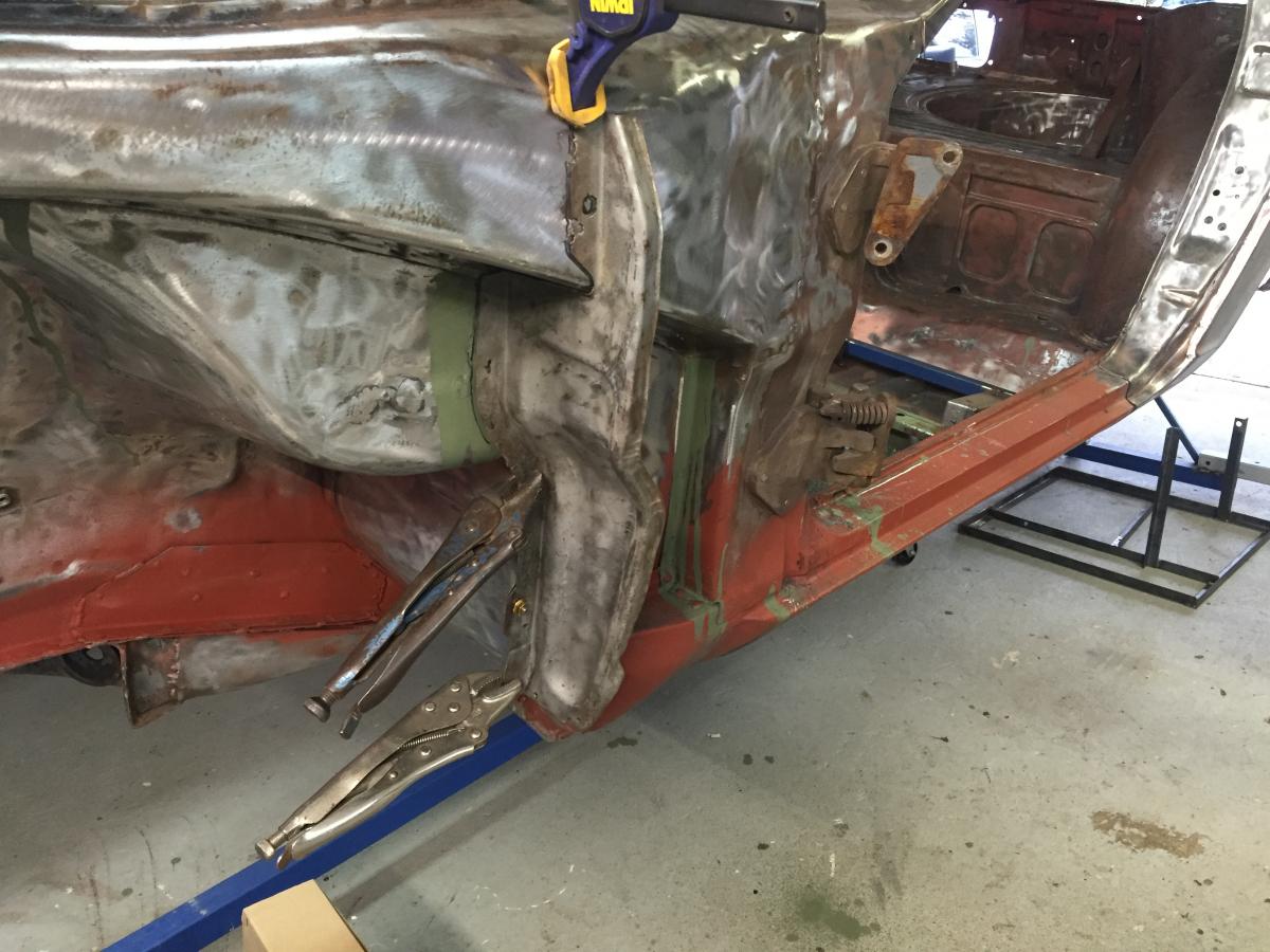

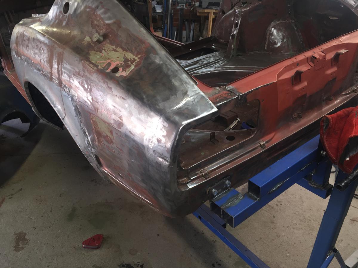

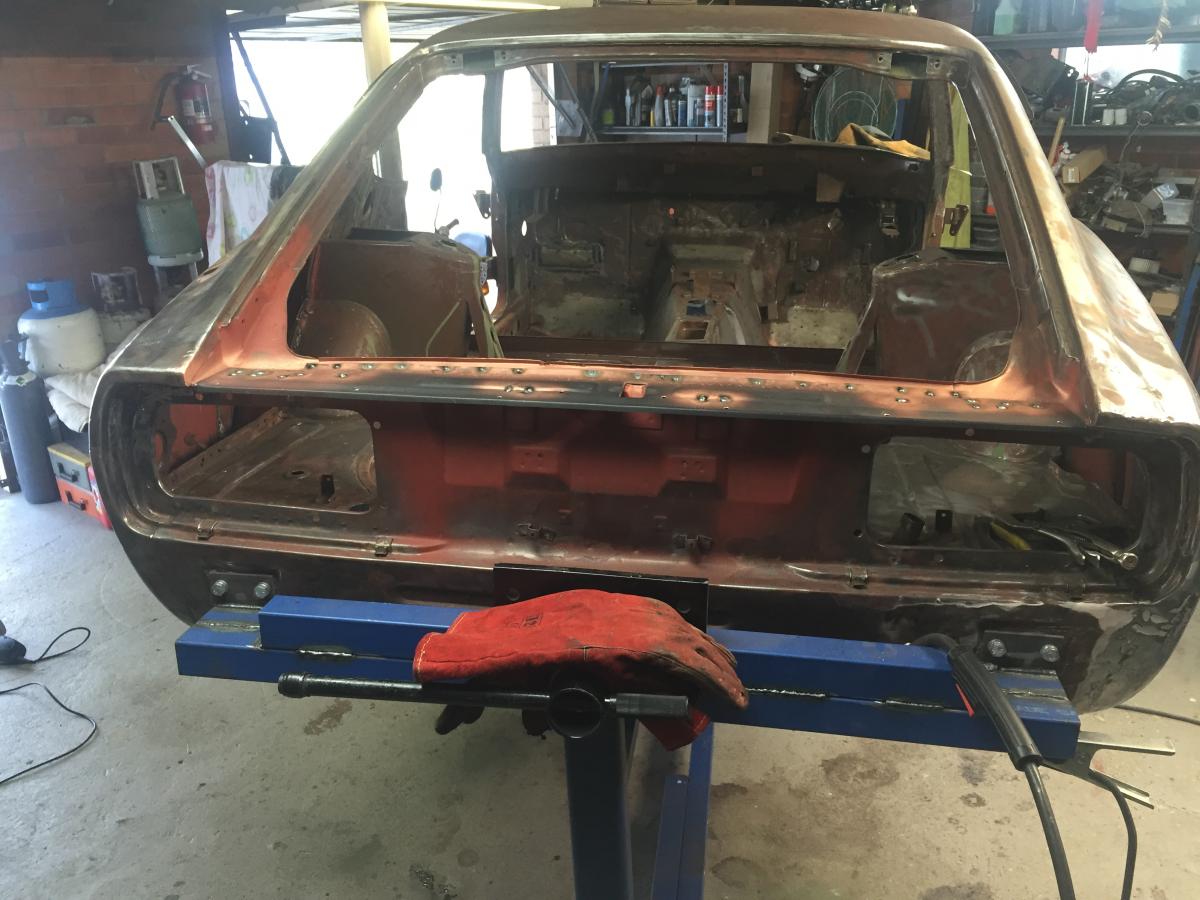

CBR Jeff Posted September 11, 2016 Author Posted September 11, 2016 A good weekend in the shed. Was great to be working away and listening to the football finals. Only problem is most of my teams lost. At least the wallabies got up last night. The rear is now sorted, just some lead work to be done when I'm finishing off the rear quarters. I had a big clean up yesterday. I'm quite fussy when it comes to having a clean work area and I was just not happy with how the shed was looking. After that yesterday I changed the media in the sand blast cabinet then used it to blast the sections I cut out of the donor cut. Cleaned them up and under coated them in weld through primer. Today I fitted them with a bit of fussing around I managed to get them fitted and welded in. Then I drilled the new (rare spares) slam panel and fitted it. The Cleco pins got a good work out today. They are a very handy thing when doing jobs like this. The list is getting smaller :-). What came off/out Tacked in to place Ready to,be finished off Slam panel in place with cleco pins All welded in place. Beer time. Jeff gav240z, Ponyo240z and mspecr 3 Quote
Sirpent Posted September 11, 2016 Posted September 11, 2016 Nice Jeff. It's all shiny and new .That would be a good line for a song LMAO Seriously, nice work Mate Cheers John CBR Jeff 1 Quote
CBR Jeff Posted September 11, 2016 Author Posted September 11, 2016 ^ ^ ^ I deserved that. Haha. Jeff Quote
Gordo Posted September 11, 2016 Posted September 11, 2016 That's come up well Jeff. It's a nice feeling walking out of the shed after making good progress . Quote
CBR Jeff Posted September 12, 2016 Author Posted September 12, 2016 Thanks boys. I'm very happy with the result. Went back in this morning and admired my work. I have been worried about this section repair as to me it's one of the iconic sections of these cars. Getting the rear quarters correct and matching is important to me. The rear 45 view is just it for me. Like legs....... ;-) Jeff gav240z 1 Quote

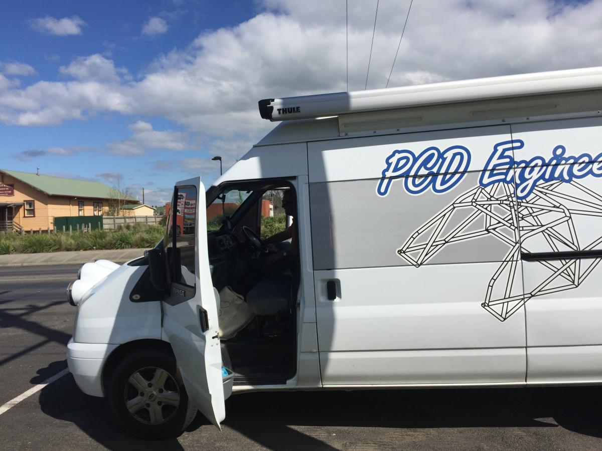

CBR Jeff Posted September 22, 2016 Author Posted September 22, 2016 It's cold, raining and I have to go to a meeting at 4 so don't want to go to the shed and get dirty. Update time. Last week the boss and I traveled to Warragul and finally picked up most of my gear that was sitting at LCR. On the way we traveled down the Hume and dropped passed dattocams place and picked up a few small items that he had for me. John (Sirpent) I will visit you next time when I have more time. Then it was onto Warragul pick up the engine, efi gear fuel tank and a few other assorted items. Then back to Canberra up the Cann river and through Cooma. It was an interesting drive 1300 km in two days and one night spent in Benalla on the way. Friday was a very long day. We borrowed the van that we use to tow rally cars and service out of at various events around the country from a good friend who builds high quality role cages for top end competition cars. We had lots of room and for it's size it is easy to drive and goes like the clappers. It's also been fitted with a light pod with 4 x Cibie Turini lights that made the run across the Monaro dodging kangas a bit safer. Saturday was spent unloading the van, cleaning it and then dropping it back. Sunday Rocky and I made it into the shed. We took a tv down and watched The Sandown 500, drank tea and tinkered with lots of small jobs. We cleaned up the engine mount brackets and gear box mount. Sand blasted then painted with POR15 and then engine enamel. Found all of the nuts and bolts to mount the gearbox to the engine and stuck the two old mates back together. The starter motor was then pulled apart (it was just black at the start) cleaned up given a bit of a service and re assembled and put back on the engine. daretobedifferent came down from Sydney on Monday and picked up the rear cut. This has freed a bit of space up in the shed. Tuesday afternoon was spent back on the shell. I found the stone guards that are fitted under the front guards. Cleaned them up, panel bet them and started to get them ready to be re fitted. They were welded on when they were removed but are going to be re fastened with nuts and bolts and sikaflex not liquid metal. More this weekend.... KatoKid, C.A.R., PeterAllen and 1 other 4 Quote

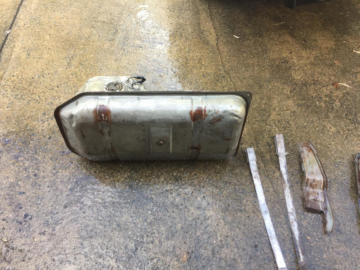

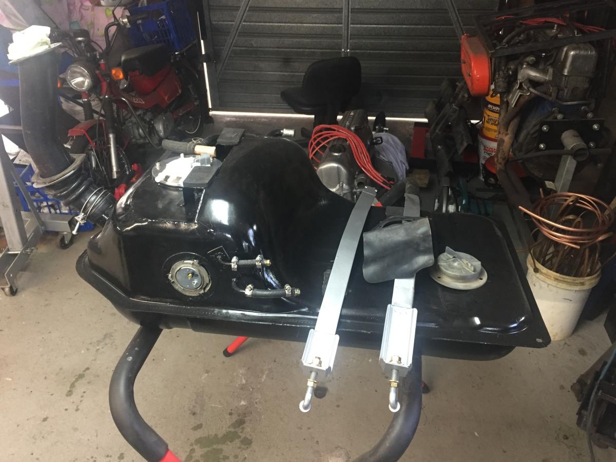

CBR Jeff Posted September 23, 2016 Author Posted September 23, 2016 Life is all about making the best or most of opertunities. Today was a good example of that. Finishing a project off earlier than planed I had the opertunity to spend the afternoon in the shed, happy days. It's good the break a big project into chunks and get each chunk done and dusted, then tucked away with all of its components ready to be installed when needed. I picked up the fuel tank with the efi pump installed (thanks Lurch) from LCR last week. It was sitting in the shed just needing cleaning up painting, gathering all the parts associated with it and getting them ready for assembly and instalation when needed. So this afternoon I started and should be able to get it finished over the weekend. I took the in tank pump out of the tank Taped up all of the holes in the tank and stripped off the paint. I used paint stripper and water. I cleaned the fuel tank straps up at the same time. I was surprised (but should not have been) how much rust was hiding under the original paint. After going through the 3 step process I painted all the parts with POR-15. Black for the tank and silver for the straps. The straps needed some serious tin bashing to get then straight. The fastners also had a clean up and a bit of an update I'll find all of the fuel filler parts and get them cleaned and ready for instalation and apply some topcoat to these parts over the weekend. Jeff mspecr 1 Quote

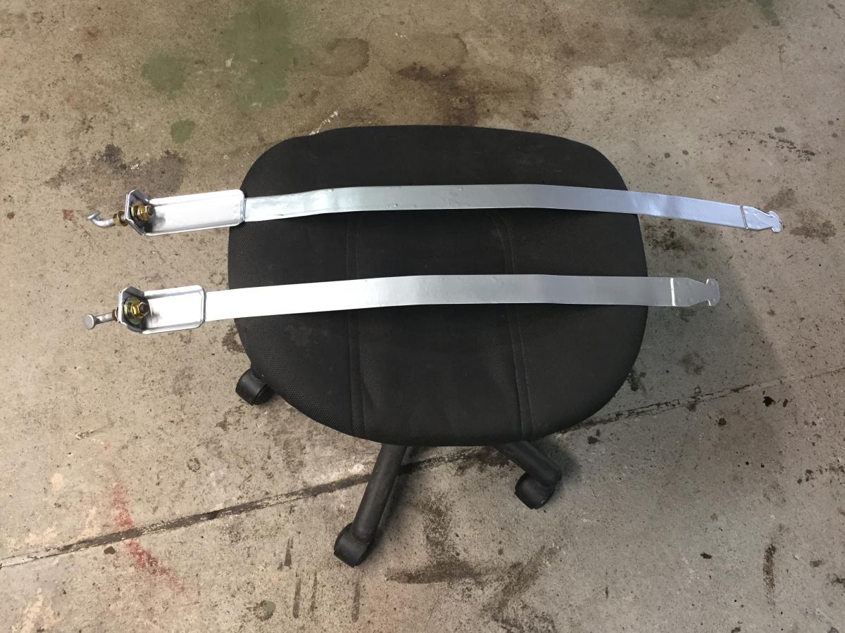

CBR Jeff Posted September 24, 2016 Author Posted September 24, 2016 Finished the fuel tank straps off today, and made further progress on the tank and a few other jobs. Jeff Sirpent 1 Quote

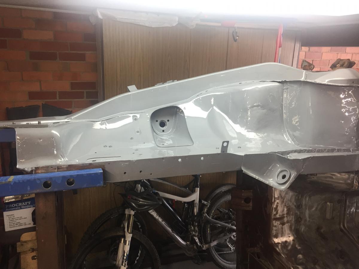

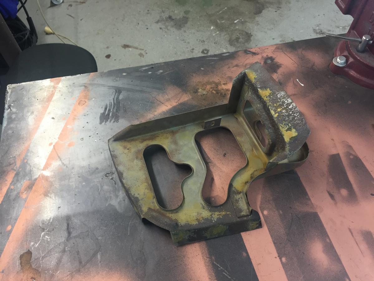

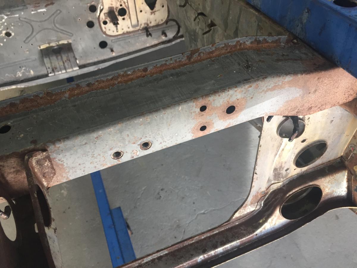

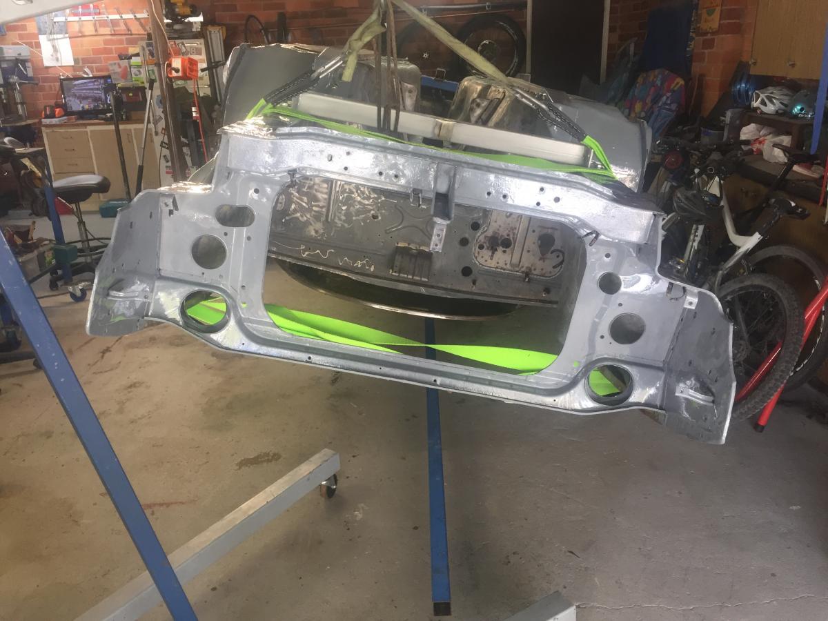

CBR Jeff Posted October 3, 2016 Author Posted October 3, 2016 Another long weekend. Lots of football and F1 to distract. I had to build up the brownie points a bit but managed a few hours in the shed. I started cleaning up the battery carrier, filled up the holes left from removing it and made it ready to be coated with POR-15. I'm going fasten this with nutcerts so it can be removed and cleaned as per the Lurch method. Also finished stripping the engine bay almost ready for the POR treatment. I uncovered lots of surface rust under the paint on the radiator support. There was no indication that this was present so I'm glad I decided to strip this area. Rocky was very tired after the confusion to his system caused by daylight savings so he had to sleep most of the time but was happy to get up to eat and go for a walk. Out of town this week with work so won't be any action until next weekend. The TV is set to be taken to the shed next Sunday. Jeff KatoKid, Sirpent and AndBir 3 Quote

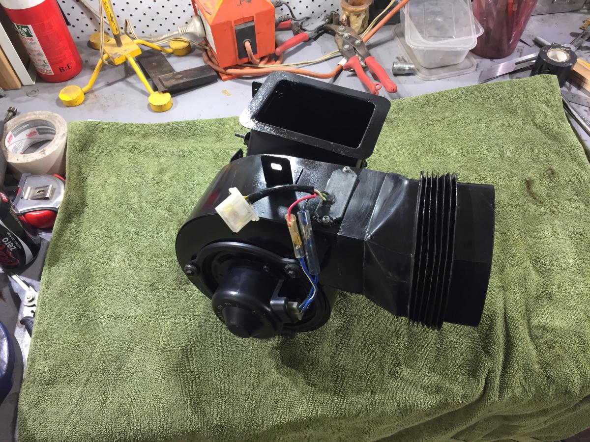

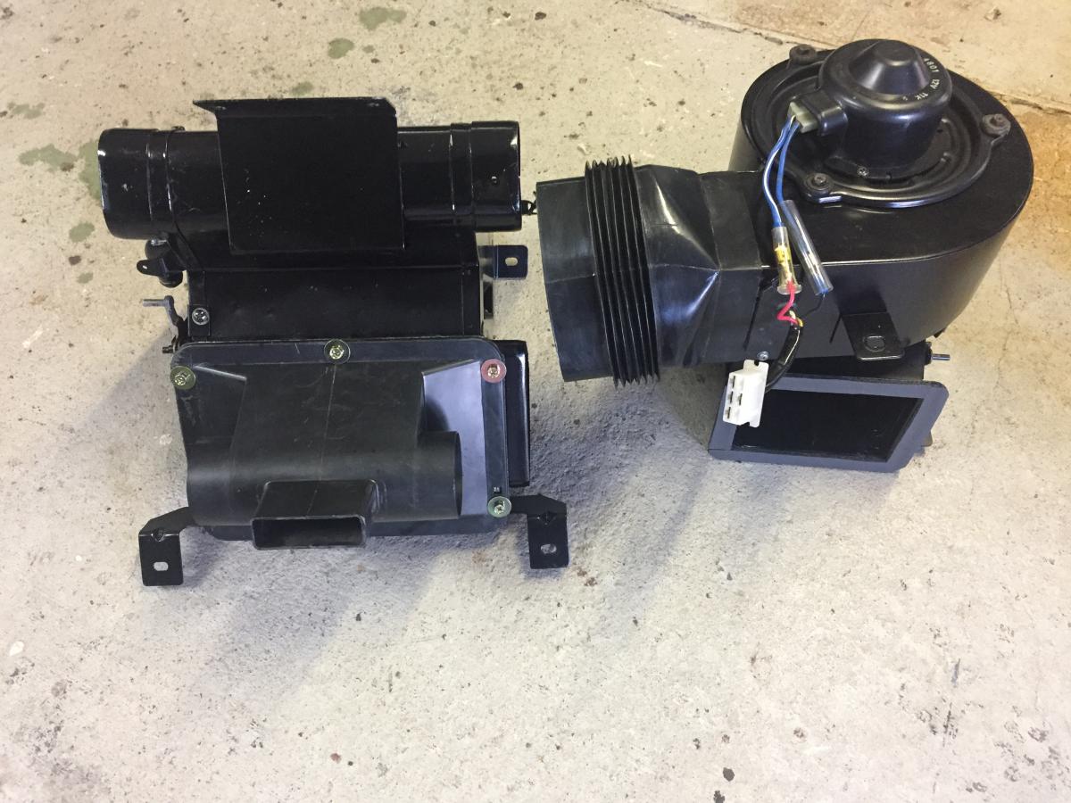

CBR Jeff Posted October 23, 2016 Author Posted October 23, 2016 (edited) After a weekend of sickness then a weekend away at a MTB race it was great to have a weekend at home and healthy. Kicked off with a lap of Mt Stromlo on the MTB bike on Saturday and a few jobs around the house so I was able (allowed) to spend today in the shed. I took a TV down and had the V8's on in the back ground, very enjoyable. I removed the front section of the rotisserie so I could finish a rust repair off. Then another small rust repair and it was time to paint on some POR-15 on the radiator support panel and battery frame. While I was waiting for it to dry enough to apply a second coat I started the heater box/fan reconditioning process. I stripped, cleaned and painted the fan section fitting the Honda fan I purchased from CraigZ a few moths ago. Then I managed to start on the coil/air box section but didn't get It finished. I'll get the rotisserie back on this week once the POR is sufficiently cured and keep Rolings along. I will see how this week goes but the air box looks like a good job for one evening this week now it not below zero at night! Jeff Edited October 23, 2016 by CBR Jeff Quote

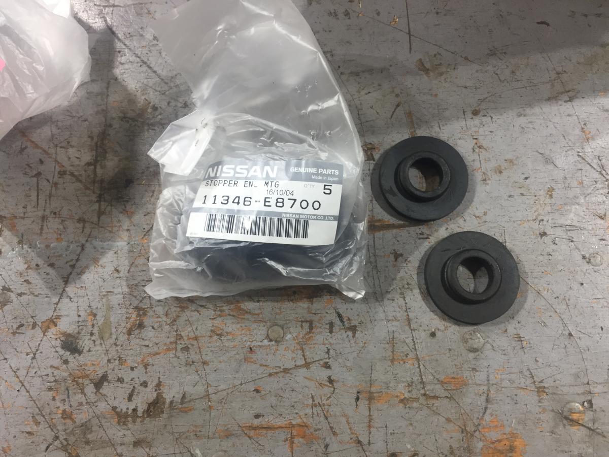

CBR Jeff Posted October 29, 2016 Author Posted October 29, 2016 Another MTB ride yesterday then I finished off the heater box. It was the project during the week and it just needed re assembly yesterday. I then started the pedal box, pulling it apart and cleaning, blasting and then prepping it for painting that I should get to today. Some parts also arrived at the local Nissan dealer this week. I wanted a new set of the rubber spacer washers for the gearbox mounts and as I could still get them and after inspectin of the door handles on my doors I decided to get a new set. Back onto work on the shell today. Jeff KatoKid and jeff43 2 Quote
CBR Jeff Posted October 29, 2016 Author Posted October 29, 2016 What a difference some welding and paint makes. AndBir and jeff43 2 Quote

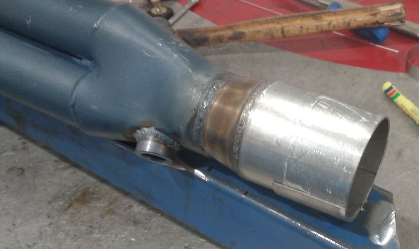

C.A.R. Posted October 29, 2016 Posted October 29, 2016 (edited) I finished modifying your exhaust secondary's on Friday mate. Les will be in touch next week with regards to it. Edited October 29, 2016 by Lurch ™ CBR Jeff and scott 2 Quote
CBR Jeff Posted October 30, 2016 Author Posted October 30, 2016 (edited) Thanks Lockie. They are small pipes for 300+ HP :-). Look forward to the call as always. Big weekend on the car. Pedal box is back together after a clean up strip and paint, looks like new. Engine bay is painted in POR and looks great although I do have a couple of spots that ended up with some bubbles due to being a bit over enthusiastic with the coverage. They will be fairly easy to address later before primer. Onto the underside this week then inside. Time for a beer and the moto GP. Jeff Edited October 30, 2016 by CBR Jeff KatoKid 1 Quote
