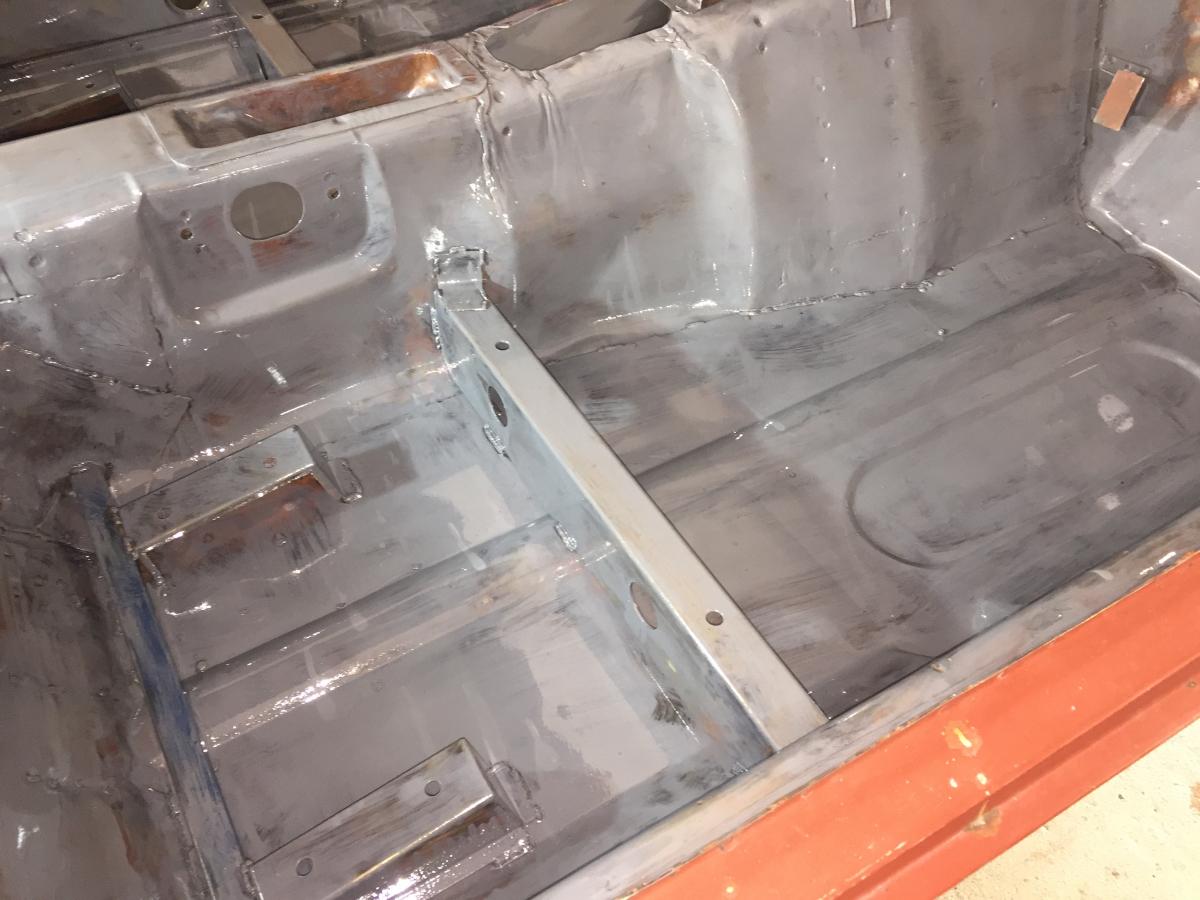

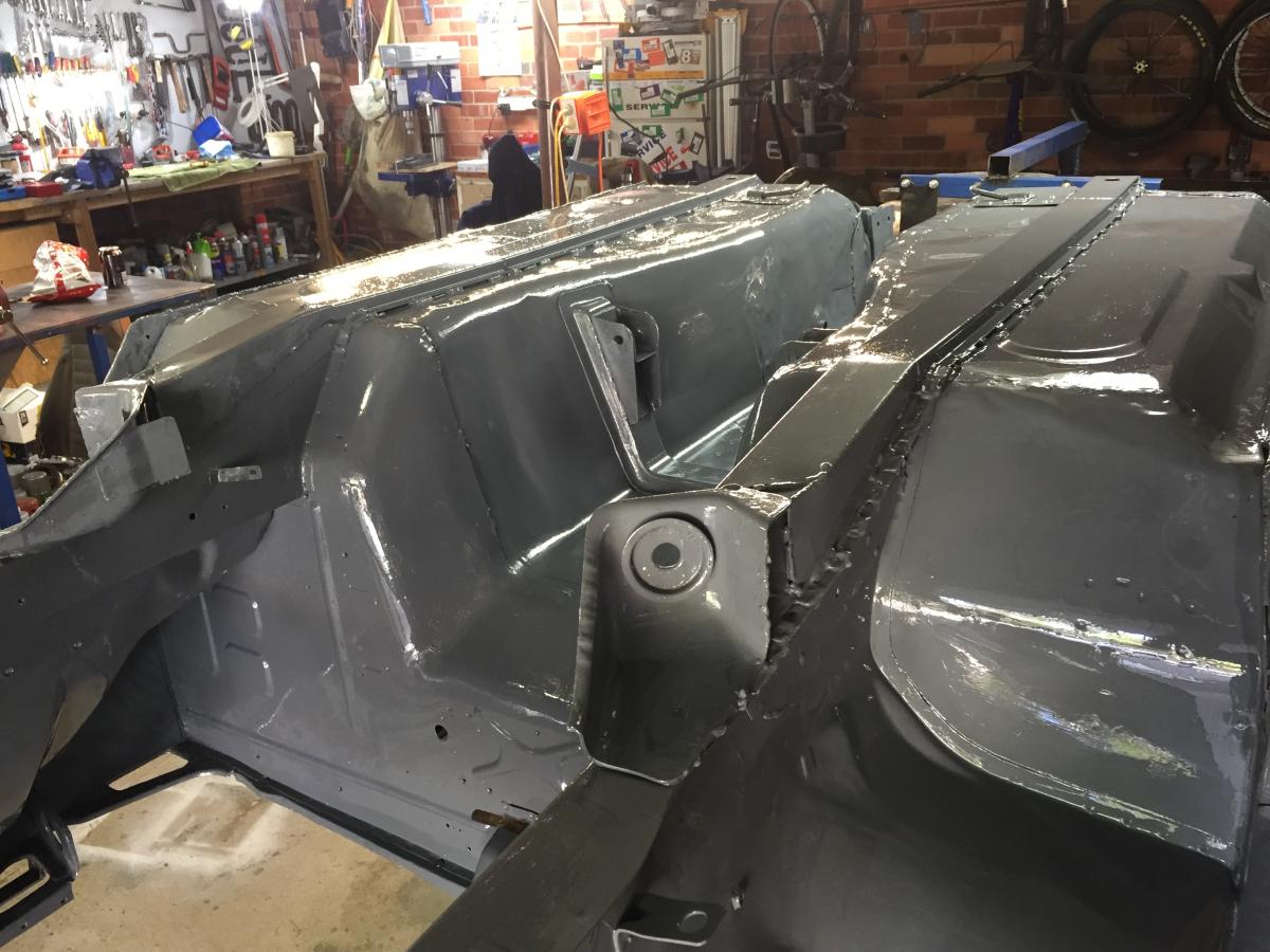

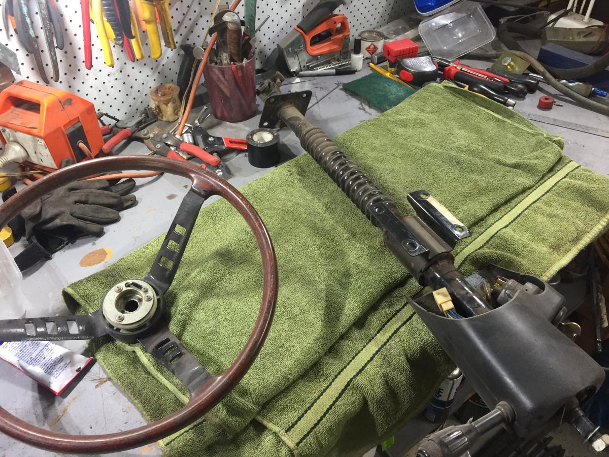

CBR Jeff Posted November 6, 2016 Author Posted November 6, 2016 (edited) It was a big weekend at our house. Girls went to Wagga for the weekend so Rocky and I were batching, happy days. The list of things to do was massive and we almost got them all done. Saturday A quick 2 hour Mountain bike ride at Stromlo. Visit to the local coffee shop. Finish off the wire brush/wheel and paint removal of the bottom of the car from the engine bay to the rear suspension drop pins and the inside floor section. Clean both sections with marine clean and the metal ready. A couple of small jobs on the list left by the boss. Sunday Get a coffee on the way to helping sort out the tyres for the Rally of Australia, several calls to Japan to confirm plans. Firsts coat of POR-15 or area prepped on Saturday. Wash the windows (outside) of the house. Get ingrediants for dinner and throw into the slow cooker. Check the POR-15 but not ready so started to pull the steering column apart and clean up. Apply second coat of POR-15. Drink beer and update build thread before girls get home then dinner. Very tired Jeff. Edited November 6, 2016 by CBR Jeff Quote

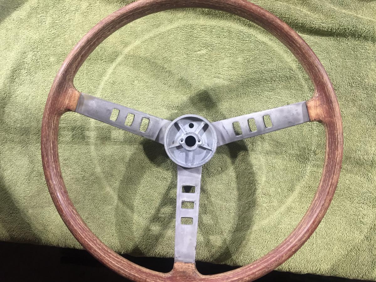

CBR Jeff Posted November 8, 2016 Author Posted November 8, 2016 Thanks again boys. Last night I started on the steering wheel. Had a bit of time in the shed and this job fitted. I do like the original steerers. Quote
ScottyD Posted November 8, 2016 Posted November 8, 2016 Hey Jeff, Nice prep work on the wheel, I'm just about to start on mine, did you sand to remove the old paint and varnish and are you going to add wood stain if so what colour. Thanks Scott. Quote
CBR Jeff Posted November 8, 2016 Author Posted November 8, 2016 (edited) Thanks Scott. I media blasted (carefully) the central section and have started to sand (paper) the wheel. I'm not up to colour yet. But it will probably be original ish. But might get carried away and polish the metal section yet? Time will tel. I like these old wheels. I'm probably going to get a horn cap machined up out of aluminium to clip onto the original push switch. See how we go. Jeff Edited November 8, 2016 by CBR Jeff Quote

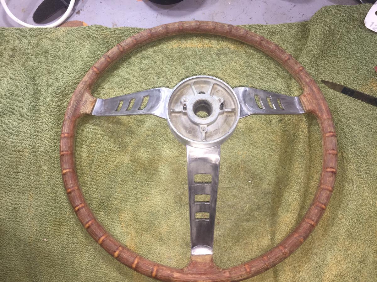

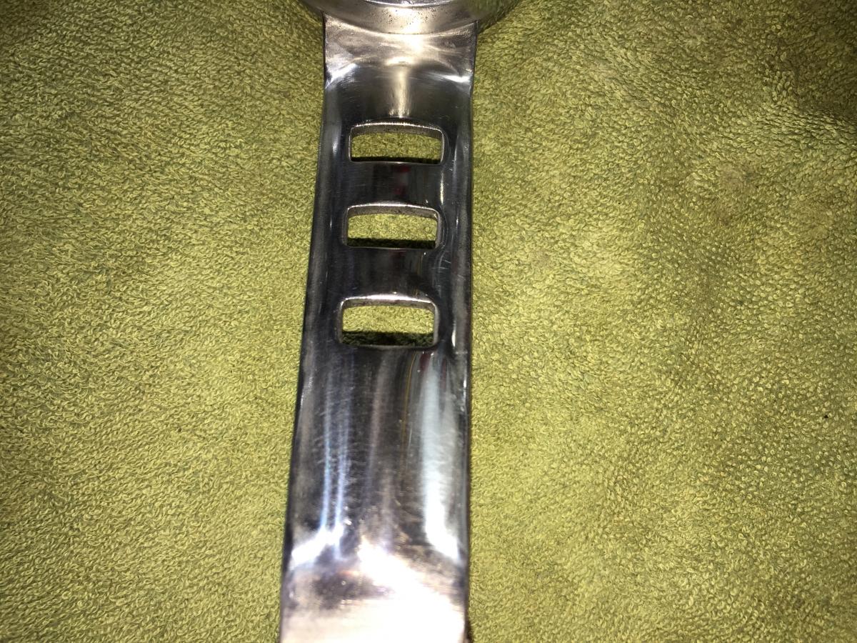

CBR Jeff Posted November 9, 2016 Author Posted November 9, 2016 I think it would to Chris. Looks like it's not going to be to much work either. Had a bit of a crack at polishing it this afternoon. It's a start. Jeff Quote
CBR Jeff Posted November 10, 2016 Author Posted November 10, 2016 It's polishing up ok. It's not going to be perfect but it's 40 years old and I think it looks good. Jeff scott and George 2 Quote

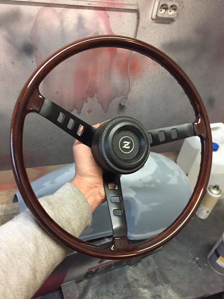

Administrators gav240z Posted November 10, 2016 Administrators Posted November 10, 2016 Yeah I do kind of like it 'naked' like that, but it tends to have a bit too much bling for me when installed against the sea of black vinyl . Although it's hard to tell if I'm just so used to the original look anything else looks strange now or out of place. Next wheel I do I want to apply clear coat to really give it that gloss finish. (which for some might be too much). From a Facebook post recently. https://www.facebook.com/groups/datsun.europe/permalink/1611252812511555/?sale_post_id=1611252812511555 Quote
Administrators gav240z Posted November 10, 2016 Administrators Posted November 10, 2016 By the way Jeff how are you polishing it? For a job like that I'd be tempted to invest in a dremmel with various attachments. Quote
CBR Jeff Posted November 11, 2016 Author Posted November 11, 2016 Gav a dremmel would be ideal if you had one. I have used items I already had in the shed. Started with the renovator/multi tool with the sanding attachment. Worked from 180 to 400 grit paper. Then using a buffing attachment on a battery drill, finally elbow power with cut and polish compound. I'm going the satin finish on the wood. It has not taken much effort or time to this point. Jeff Quote

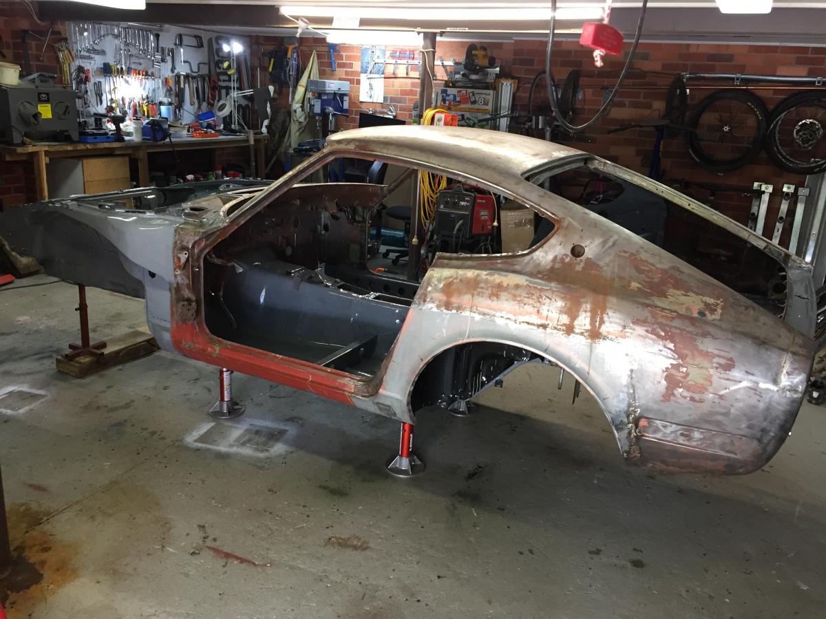

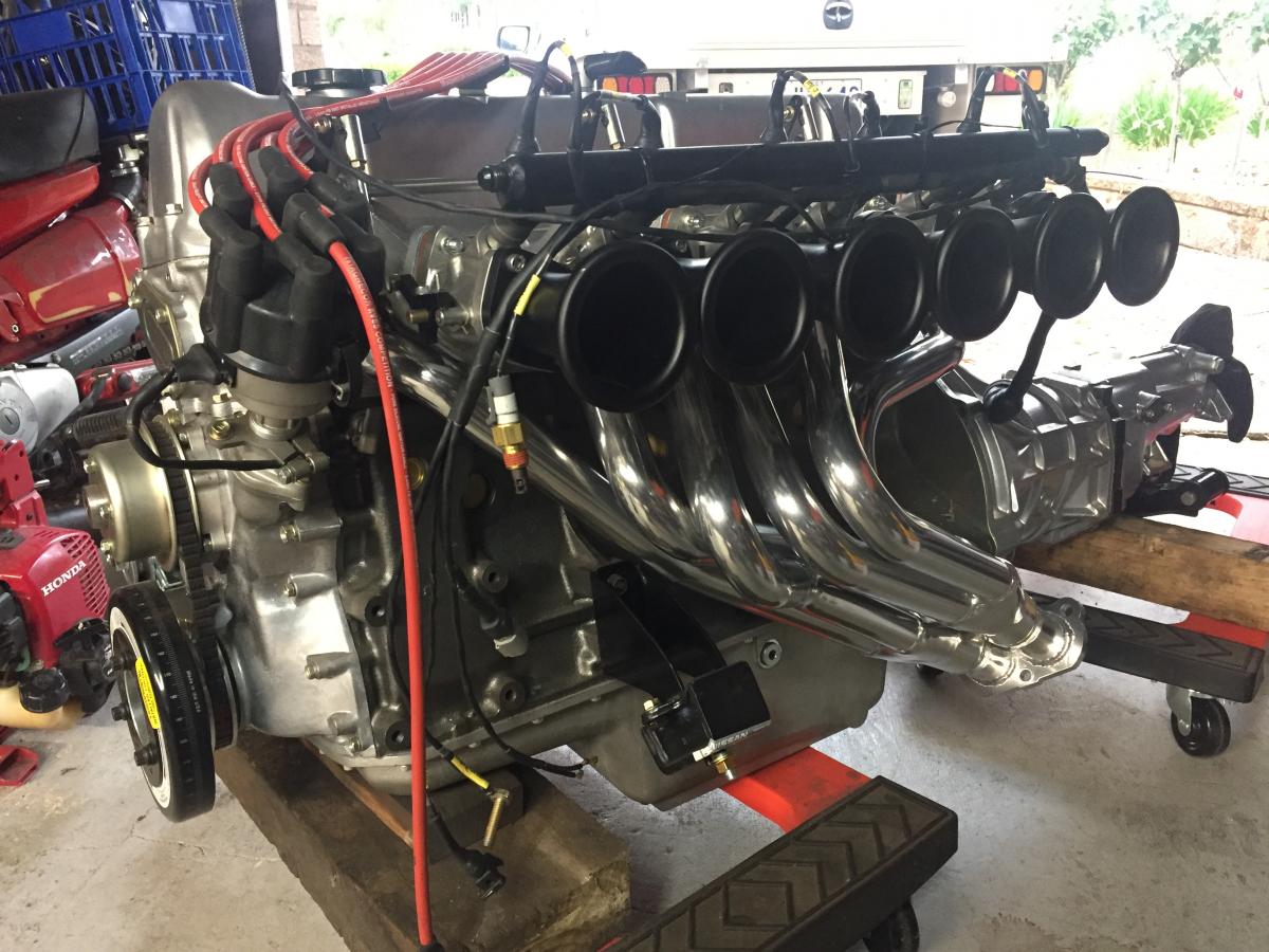

CBR Jeff Posted December 17, 2016 Author Posted December 17, 2016 (edited) It's been over a month since I have had time to post in my build thread. Work has been typically pre Christmas where everyone wants to go on holidays and want all job they have been sitting on most of the year finished!! I have been getting in as much time on my Z as time possible and chose to spend time doing rather that on the forum (sorry :-)). Steering wheel and column have been finished for what seems like ages. I also have finished off the last body repair job on the rear hatch strut mounting point on the shell. It was suffering from a previous repair after it had basically failed. I ended up manufacturing a small strut to attach to the bottom extending to the rear suspension tower. I made it from a section of 10mm rod that I heated and shaped old school blacksmith style. It will help support the rear hatch gutter where the strut mounts. The extractors arrived all shiny and new. So I fitted them to the engine along with the inlet manifold etc. Today was spent starting the dry build, what a day. Car is now sitting on jack stands in the shed with all the suspension, diff gear box and engine fitted. It started today on the rotisserie on the side of the shed. Later this week I'll fit the exhaust, the EFI equipment including the ECU relay plate and radiator. Then I'll pull it all apart again and put it back on the rotisserie to finish off the underside early in the new year. Edited December 17, 2016 by CBR Jeff AndBir, PeterAllen, shaun240 and 1 other 4 Quote

CBR Jeff Posted December 21, 2016 Author Posted December 21, 2016 (edited) Dry build continues. Bit of time this afternoon. Exhaust fits (almost) just a couple of small modifications and it will be spot on. Radiator is spot on. It's not bolted in yet but won't take much work to fit, I just need to mark the radiator support holes on the radiator mounting plate, drill them and mount the radiator. Jeff Edited December 21, 2016 by CBR Jeff Quote
C.A.R. Posted December 21, 2016 Posted December 21, 2016 Exhaust fits (almost) just a couple of small modifications and it will be spot on. I was really hoping that it would fit perfectly without needing modification CBR Jeff 1 Quote
CBR Jeff Posted December 22, 2016 Author Posted December 22, 2016 I was really hoping that it would fit perfectly without needing modification Locky it's no big deal. The exhaust is spot on it's just the extractors are a smudge to long :-). The back is perrrfect. Jeff. Quote
