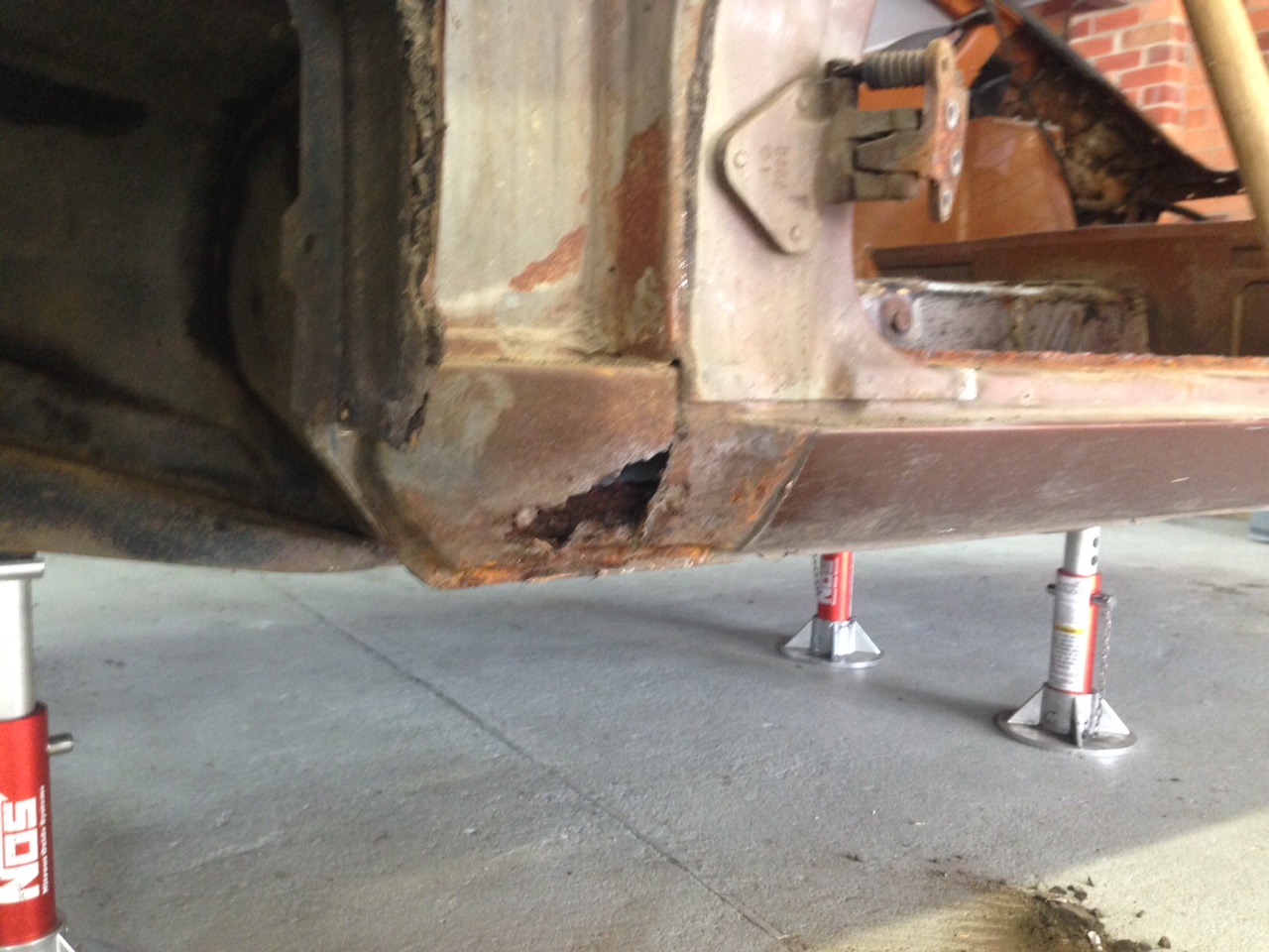

First thing I did was to fit new tyres, cleaned a few things up and took it to rego inspection in November to see what would happen. It failed on two items, rust in the drivers floor (not the only place but only place that seemed to matter) and the turn indicators not flashing fast enough (they worked but are a bit slow, like me)

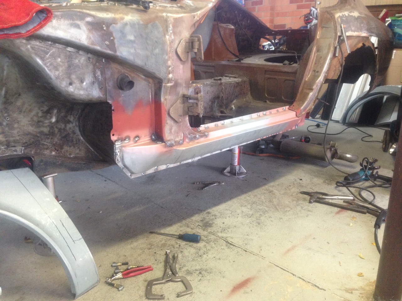

After getting our shed organised, cleaned out and purchase of some equipment, work has now started in earnest. After closer inspection of the rust and mechanicals a clear path has been set and the wheels are now in motion.
Lots of parts have been ordered components removed cleaned and shipped off for repairs or modifications. I decided to start work on the passenger’s side (good place to practice as I won’t see that side as much)
The Sill has been removed and replaced, Most of the sound proofing has been removed (renovators are an amazing tool for this). Rear quarter is next in this area with a new outer cut and inner guard to be fitted.

I have been using a "renovator" with an assortment of blade type bits to remove the underbody. It is very effective. Took about 15 min for each floor section and about 20 min on the inner wheel arch. You can see the before and after in the photos.

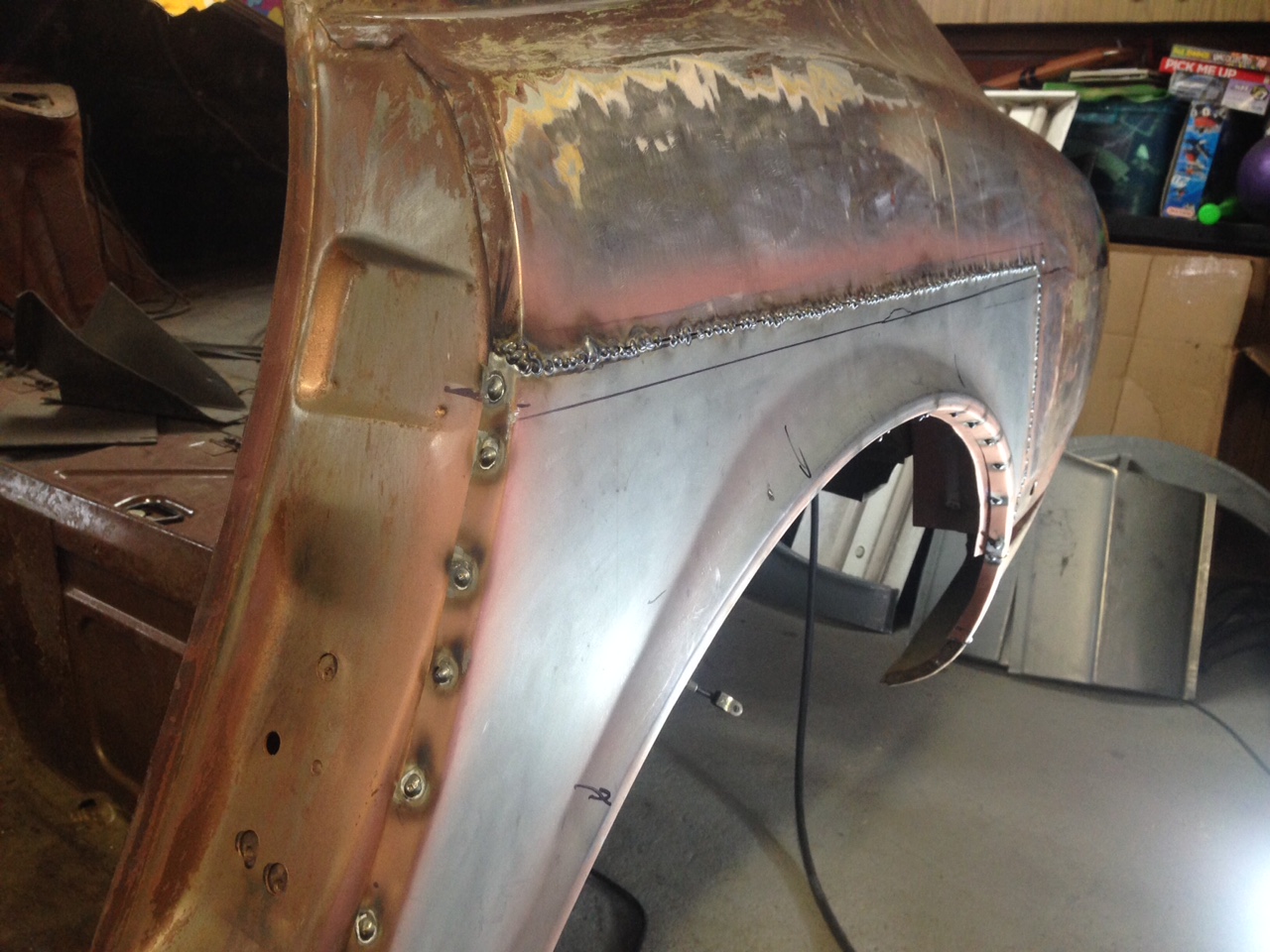

I did manage to get home early today after dropping off my steering rack and control arms at the local suspension and steering emporium for some attention, to do a test fit of the passengers side inner and outer guard section. I will pull it apart again and re check before making the final cut through both the new and old outer guards so I have a neat cut line to weld with a 1mm cutting disk gap.

Here is another angle of the repair.

Nice work mate. A handy tool to have is  a air operated punch and flange tool. This allows you to put a step in the patch panel and overlay the patch on the job by about 10mm making it a stronger repair instead of doing a butt weld. Also saves you blowing holes through the metal when welding.

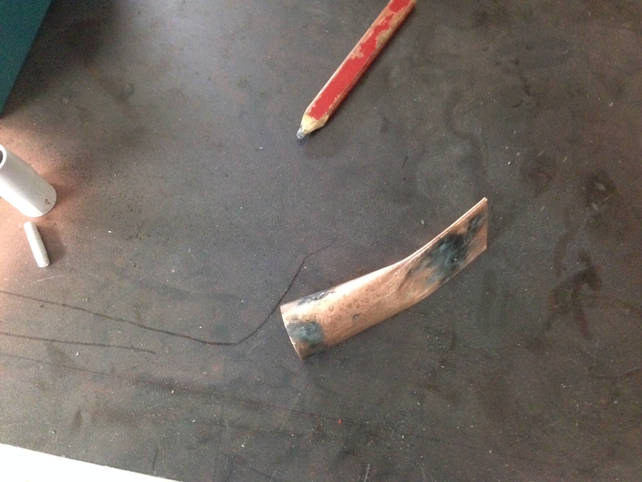

Thanks @Red76z. Yes that is one of the methods that can be used. Like all of the options there are good points and bad to each of them. My preferred method is to use a gap and but weld it using a copper helper like this
or this
> its a matter of using a method you are comfortable with.
I am a refrigeration mechanic so have a fair bit of copper tubing hanging around. My plan is to use a length of thick wall large diameter tube and make a specific tool for the job that can be fitted behind the butt weld and then slid out after its all done through the rear hatch area. It may well be a one use only but see how we go. I will post some photos.

Also managed time this afternoon to weld in the inner guard section and may even get the outer section done tomorrow (maybe)

First thing was to re fit the passenger’s side door to be sure all was aligned.
Then the rear guard was re fitted after some primer was applied. It was removed and re fitted several times before being fitted and cut with the angle grinder.
Removal and drill holes for the plug welds and then re fitted and removed again.
A re fit and then some tack welding.
I’m happy with the outcome. I also made some copper weld helpers that came in handy during the process. Managed to get Max our son to give me a hand during the welding process as it was proving difficult not having disjointed elbows and longer arms.
Photos are attached.
