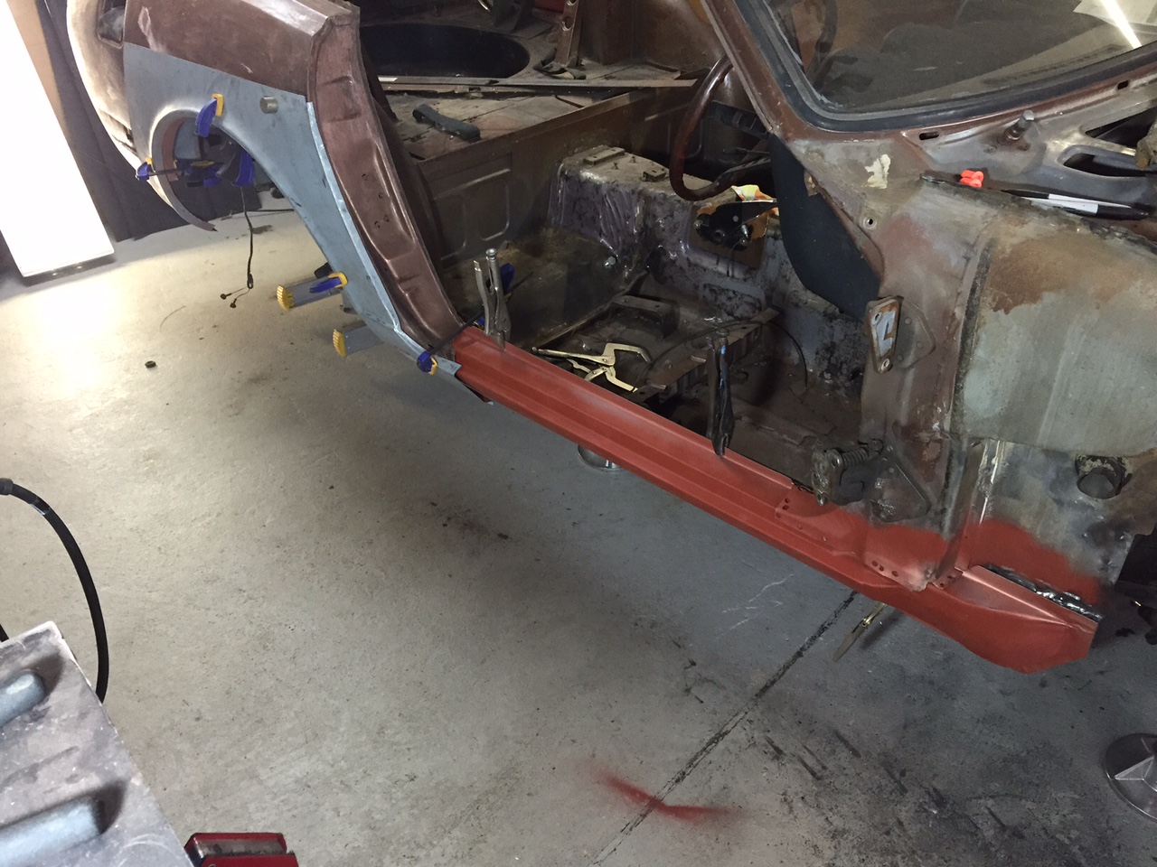

CBR Jeff Posted July 12, 2015 Author Posted July 12, 2015 Had a few hours in the shed yesterday. It was one of those times when you spend what feels like ages but don't actually accomplish that much. A few photos of progress on the drives side. Managed a test fit of the new sill before I called it a day. Rocky was ever present and helping. Quote

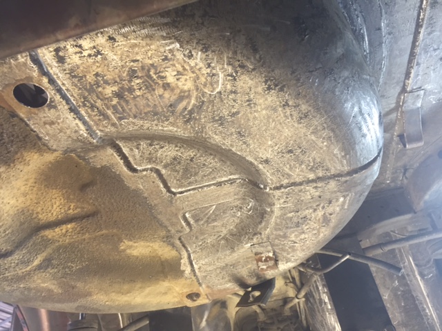

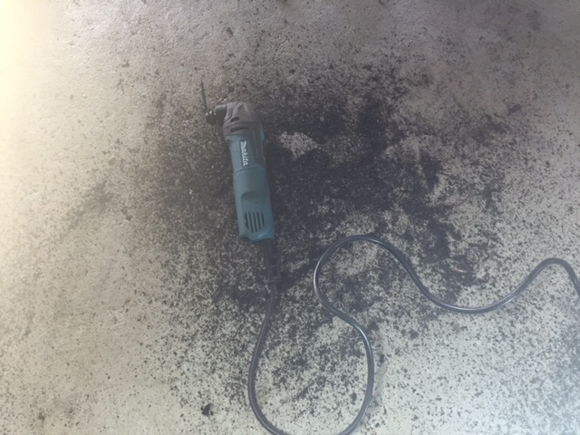

CBR Jeff Posted August 16, 2015 Author Posted August 16, 2015 Finally managed to get back to the shed today. Spent all afternoon on my back removing body coat and muck from under the back of the car. Its not finished by a long shot but its a good start. Very therapeutic work without much need to think. Something I can handle lying down as it was... Weapon of choice is the trusty multi tool. Just pops it off. Quote

CBR Jeff Posted August 17, 2015 Author Posted August 17, 2015 I have spent quite a few hours now removing body coat from the underside of my car and I personally don't think it is therapeutic. I will be happy when it is all done that's for sure. I don't have a multi tool so haven't tried that options. My weapon is a heat gun and paint scraper, gets the big flat areas done easily. I am finding it is all the hard to get to fiddly areas are the hard part. There is not much room between the wheel well and the beaver panel that's for sure. Jeff all I can say is get a Multi tool!!!!!!! Seriously it becomes quite a fast process. You will be amazed how easy it is to remove. And yes the space or lack of between the spare wheel well and the beaver panel is very small. Jeff Quote

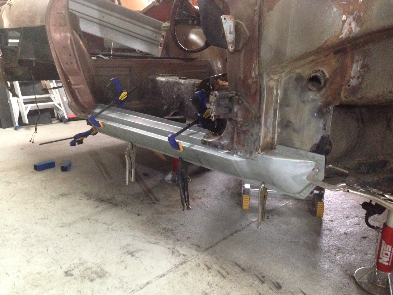

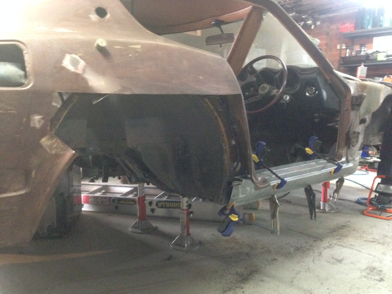

CBR Jeff Posted August 20, 2015 Author Posted August 20, 2015 I managed to spend a few hours in the shed this afternoon. So I am getting back on track I welded a few strengthening pieces in place at the front and back of the drivers side door rail that had previously been manufactured and painted. These were needed as the rust in these two areas was particularly bad so I had to cut a couple of bits out and replace them. The seat belt mount was a bit of a worry but I have a plan that involves both sides of it that should sure up this important section. So after some cutting welding hammering etc and The drivers side inner guard, outer rear quarter repair section and sill are all test fitted. Nothings permanent yet but it all lines up sort of. Quote

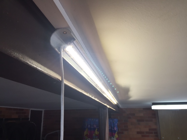

CBR Jeff Posted August 31, 2015 Author Posted August 31, 2015 (edited) More progress over the weekend. Had a bit of a clean up and fitted an extra light in the shed. Max my young bloke picked up an LED light bar that was left over at work. I had to make a carrier for it out of drain pipe and wire it in. Wow does it add some light to the shed. Very happy with it. I have now fitted the sill to the drivers side and had a bit of a fiddle with a few other items. Packed off the L24 to LCR with a mate who is picking up a L24B in a couple of weeks. Progressing nicely. Work is still getting in the way though . Edited August 31, 2015 by CBR Jeff Quote

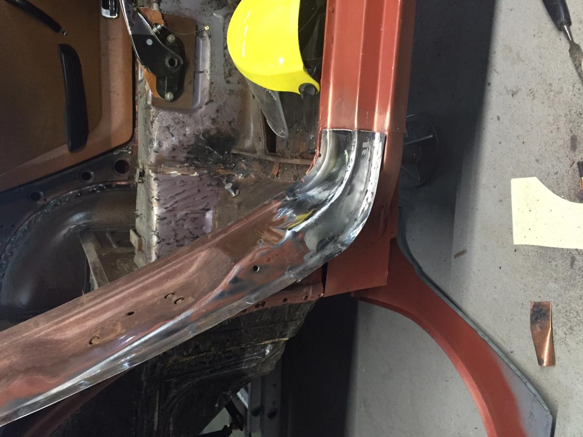

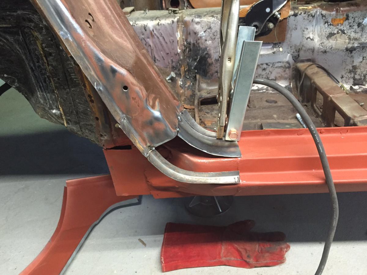

CBR Jeff Posted September 15, 2015 Author Posted September 15, 2015 My gearbox has made the return trip back to Canberra for LCR. So its sitting in the middle of the shed in front of the beer fridge being admired by every visitor to the house, even if they are not interested . On a progress note I have manufacture and repairer the bottom of the B pillar on the drivers side. Photos below. Quote

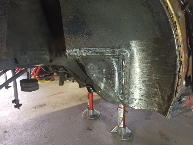

CBR Jeff Posted September 15, 2015 Author Posted September 15, 2015 One more photo of how I made the section. It was constructed out of three sections welled together. Balinski 1 Quote

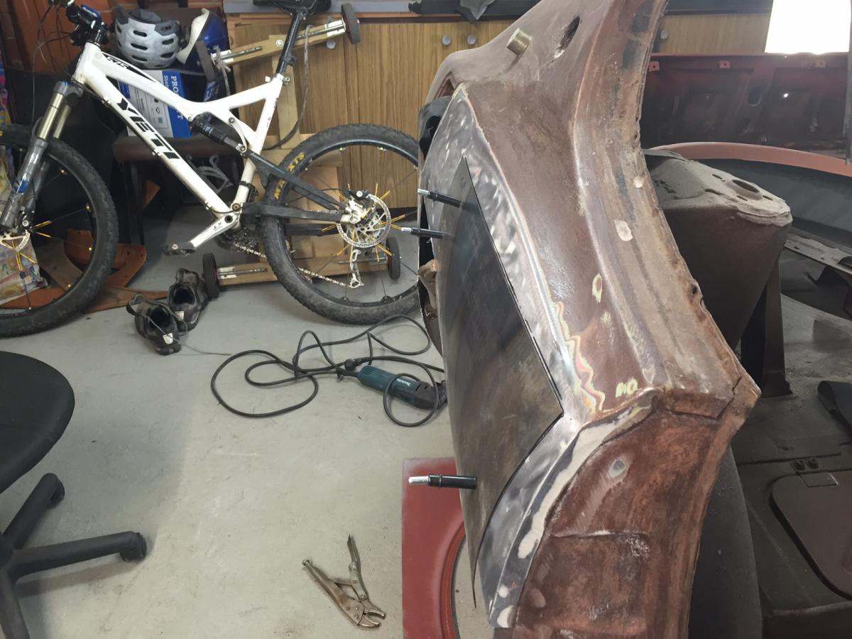

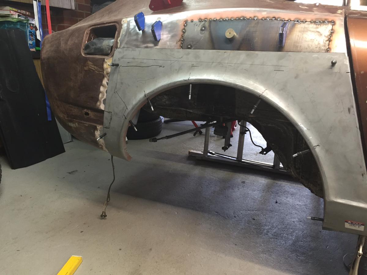

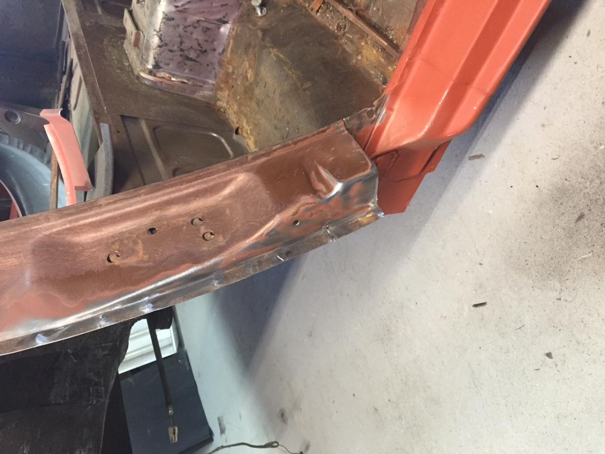

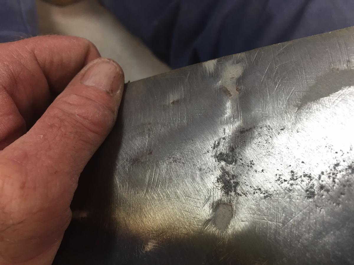

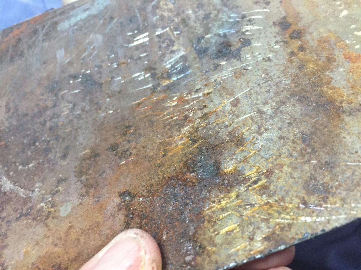

CBR Jeff Posted October 4, 2015 Author Posted October 4, 2015 (edited) Progress again at last. Life has settled down a bit in the last week so I have managed to spend time in the shed. Rocky has been enjoying the company and providing lots of supervision and much needed advice. I did unearth a couple of nasty surprises along the way. I knew there was a bit of "bog" in the rear drivers quarter and that it had had a bit of hit at some stage. So as I progressed I found a few man made problems. This nesesitated the fabrication of an extra panel repair section and some more cutting, rolling, bending, welding, grinding and several (more than usual) cups of tea. As they say a picture speaks a thousand words. So here are some pictures. Edited October 5, 2015 by CBR Jeff Quote
CBR Jeff Posted October 4, 2015 Author Posted October 4, 2015 This is the section on the drivers rear quarter that had been stretched, beaten and bashed then left to rust under the bog. It was well above the area covered by the Tabco repair section. I decided after looking at it for some time the best thing was just to cut it out and make a new section. It turned out a lot better than it would have been if I left it as it was. and I am happy with the result. Quote
