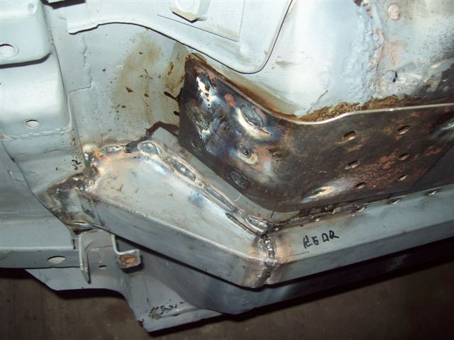

Sirpent Posted April 9, 2016 Posted April 9, 2016 Nice, and very quick, Christ you make me feel slow. Quote

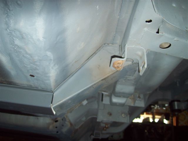

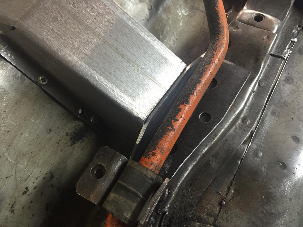

CBR Jeff Posted April 10, 2016 Author Posted April 10, 2016 Jeff. Just make sure you have clearance for the rear roll-bar with the extended frame rail. I got caught and had to redo mine.Thank you Peter. Checked this morning and no I don't. Very easy fix now but might have been both embarrassing and a hassle later on in the build. I'll get yo that later, off to all Japan day for s look shortly. Jeff Quote

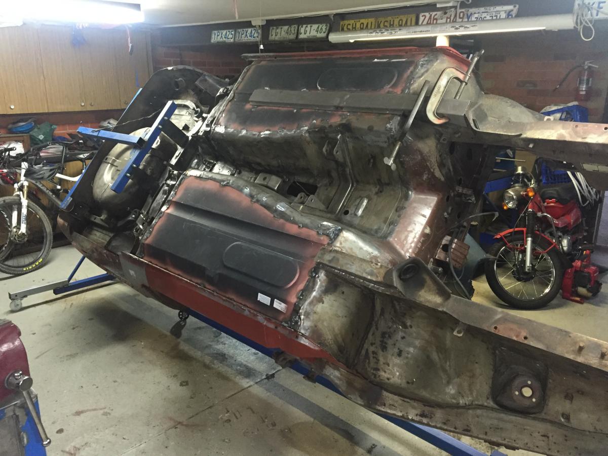

PeterAllen Posted April 10, 2016 Posted April 10, 2016 (edited) I settled on making three sections (the front rails, the floor rails and the rear up-sweep) and welding them together in-situ. It was far, far easier that trying to make a one-piece to fit. As you can see, I married the rear up-sweep more to the side of the rear cross-member - the second time around! Edited April 10, 2016 by PeterAllen Quote
CBR Jeff Posted April 10, 2016 Author Posted April 10, 2016 Thanks Peter. After looking at your photos watching an episode of project binky drinking some tea and then drinking a beer I have a solution. I'll post some photos once done. I will get the other floor in first. Jeff. Quote

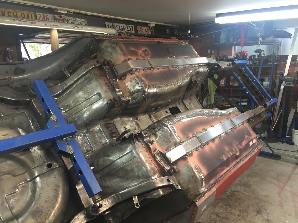

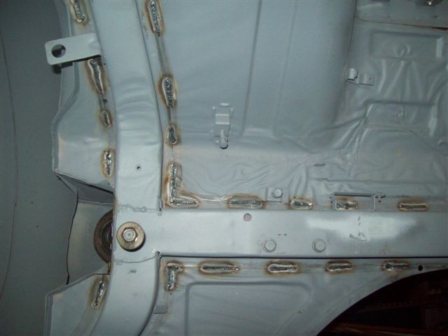

PeterAllen Posted April 11, 2016 Posted April 11, 2016 Jeff, I don't want to crowd your build thread but while you've got the welder out you might consider stitching the structural bits, e.g. strut towers and cross-member. It's best not to stitch the lighter panels, particularly fore and aft, as they can act as crumple zones to retain the integrity of the structural bits. A crumpled panel can be fixed a lot easier than a twisted structural member. Quote
CBR Jeff Posted April 11, 2016 Author Posted April 11, 2016 Dear Jeff's (LOL) True However, the rear cross beam of my chassis (Which is the one with the 2 exhaust ports) bolts at 4 points to the original LCA mount points which in Peters extension have been tied to the original rails. I'm just thinking that as I'm using this section as a major mounting point, an additional few hours work and fabrication to tie this area up to the rails and floor pan would not be a waste. Cheers John Fair call John. Keep up the good work. Jeff Quote
CBR Jeff Posted April 11, 2016 Author Posted April 11, 2016 Jeff, I don't want to crowd your build thread but while you've got the welder out you might consider stitching the structural bits, e.g. strut towers and cross-member. It's best not to stitch the lighter panels, particularly fore and aft, as they can act as crumple zones to retain the integrity of the structural bits. A crumpled panel can be fixed a lot easier than a twisted structural member. Thanks Peter Yes on the "to do list" I am also adding some additional plates to the seat belt mounting points in the floor. And a couple of plates where these cars tend to crack at the back of the seats. The extended floor rails will help this also. I have witnessed some of the old rally cars in the 6 point cage days almost falling in half at this point. I also added some extra side intrusion protection when I was doing the sills. Thanks for the comments. Jeff. Quote

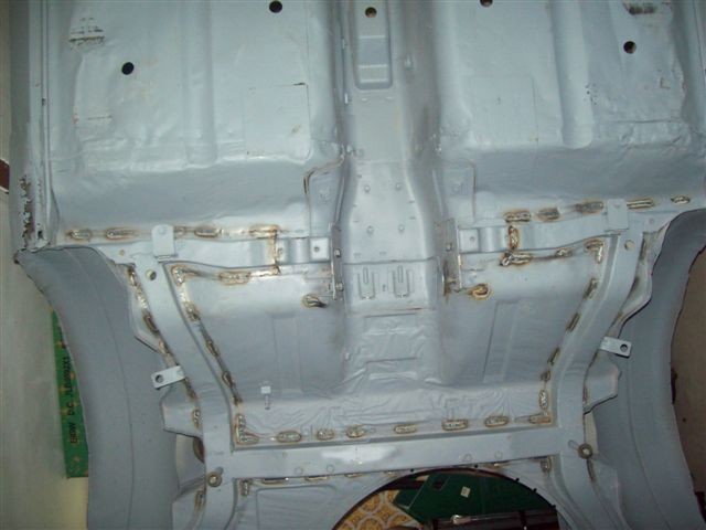

CBR Jeff Posted May 4, 2016 Author Posted May 4, 2016 It's been almost three weeks since the last proper visit to the shed. I was out of town for work (sort of, I got payed to have a great time in North Queensland). So today I managed to get the passengers side floor fitted and tacked in. Cleaned a few things up and I must rotated the car on the rotisserie about 30 times. Off to Orange tomorrow for a few days then I'm hoping for a bit of a quiet spell so I can make some proper progress. Les at LCR should have the engine together in the next few weeks so I'm planing on a road trip down south. Sirpent 1 Quote

CBR Jeff Posted May 9, 2016 Author Posted May 9, 2016 With all the rain Its been a good opertunity to shelter in the shed. Rocky has enjoyed sitting inside watching the rain fall. Both floors are now installed. Thanks to Peter Allen for pointing out the impending sway bar fowling issues I managed to resolve this issue before it was a problem. I have also made and installed the strengthening plates that are located along the transmission tunnel at the rear Just near the seat belt mount. Started to work on new seat mounts today after finishing off some work and a trip to Fyshwick to get some more weld through primer. Quote

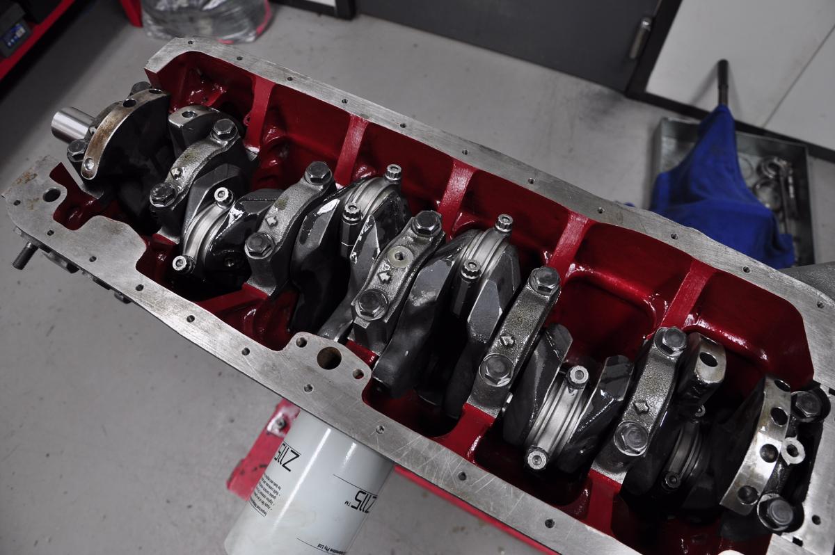

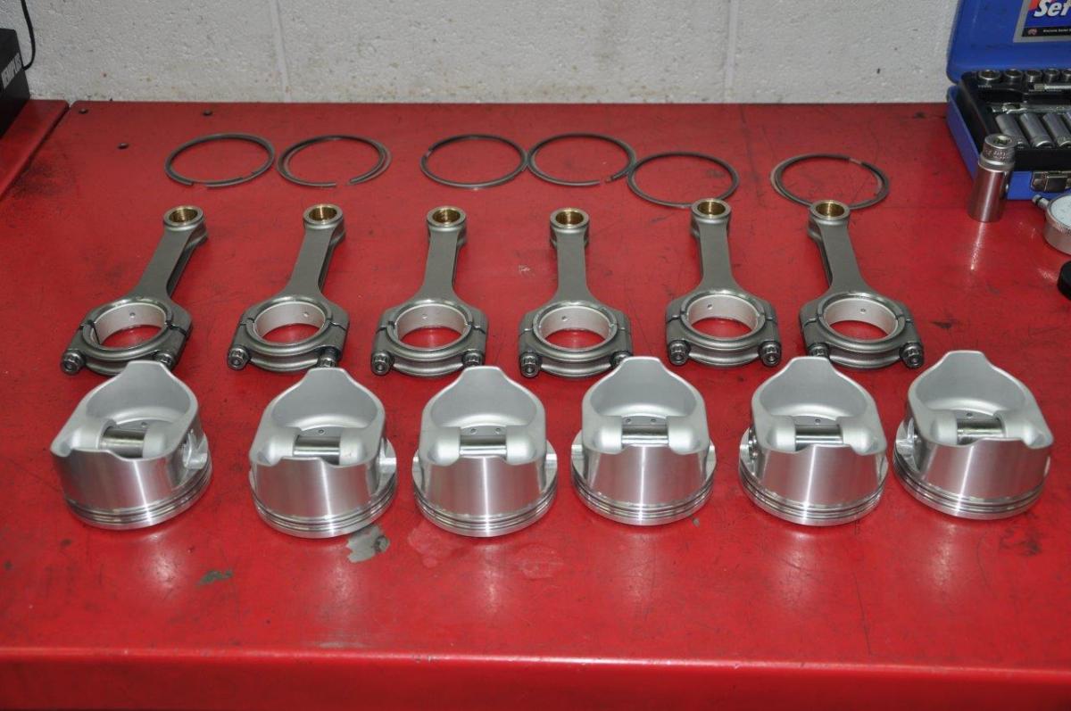

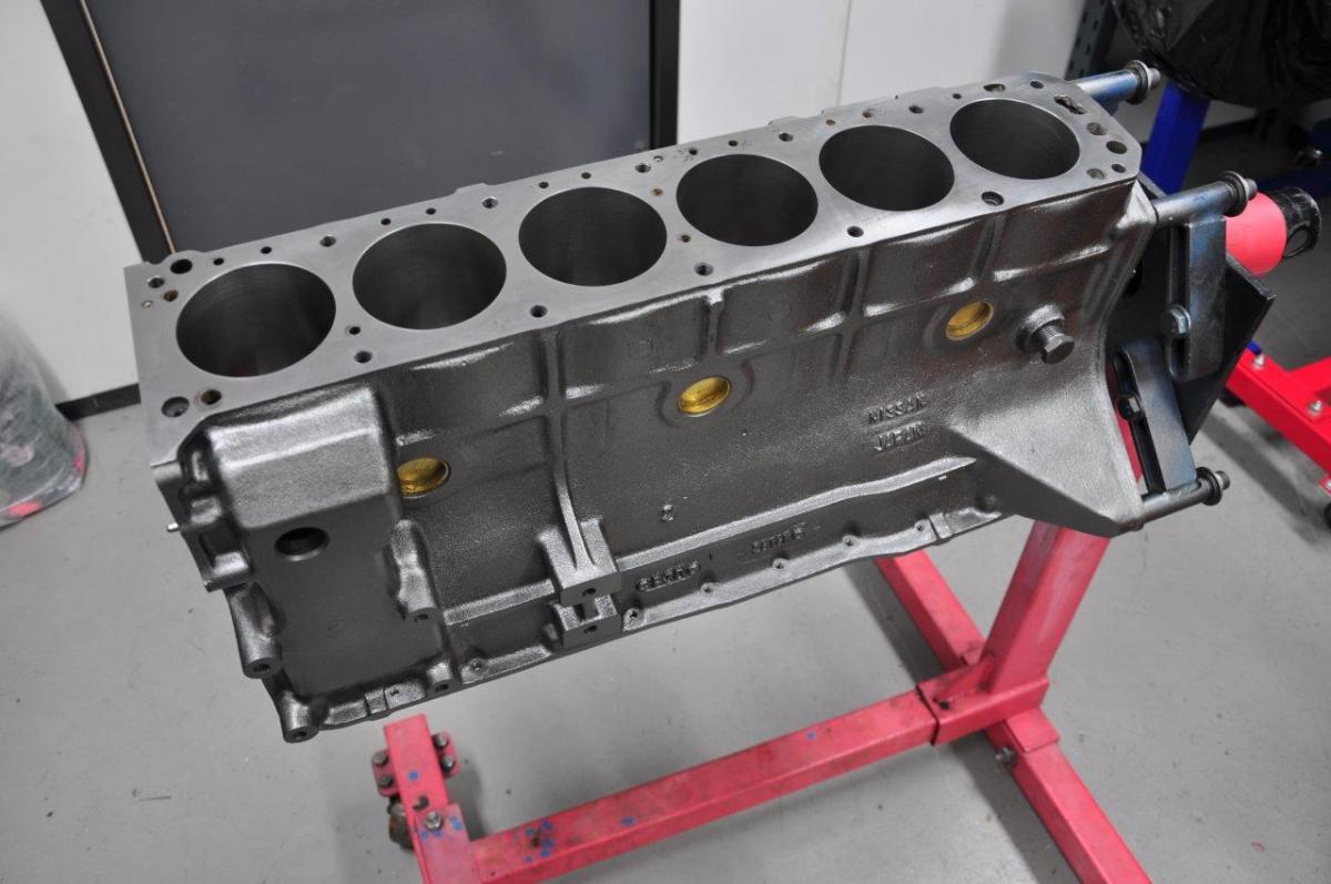

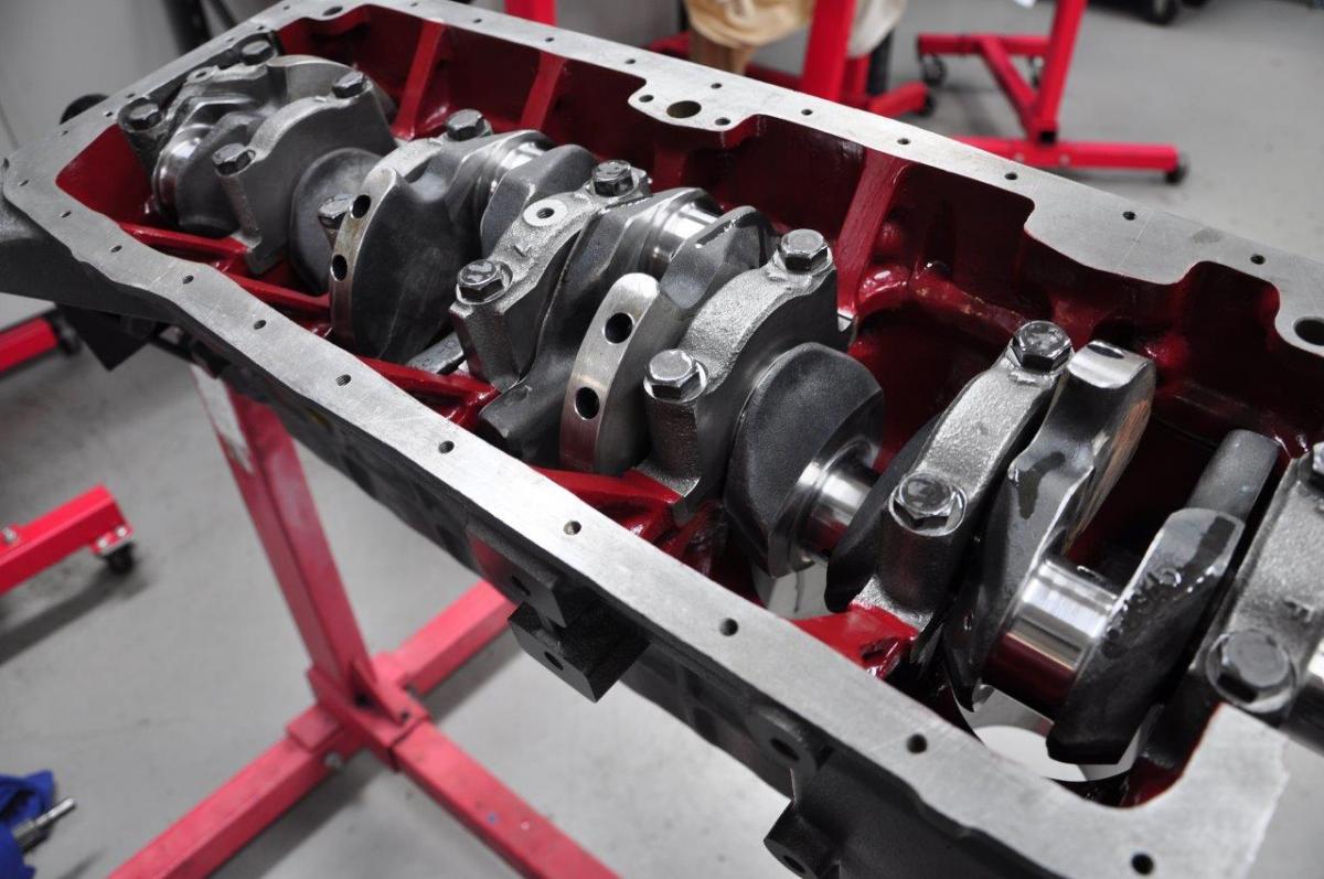

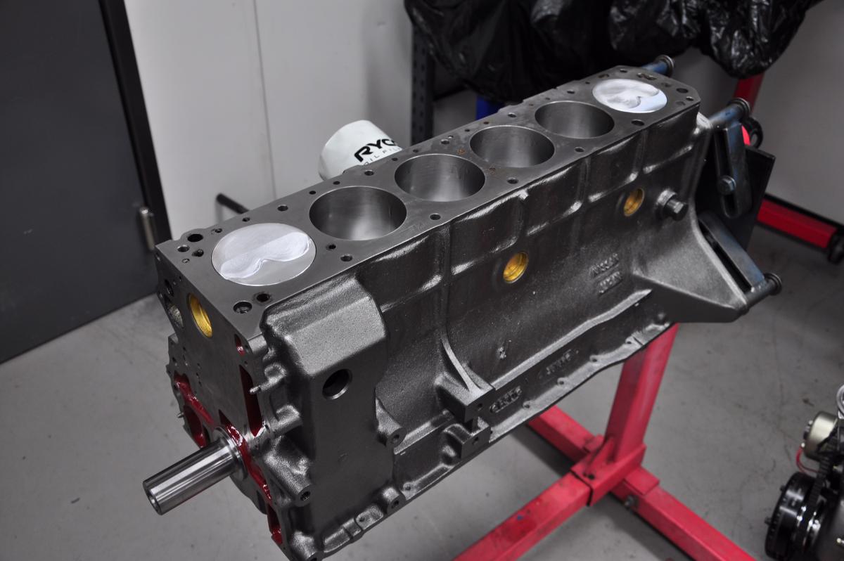

CBR Jeff Posted May 12, 2016 Author Posted May 12, 2016 (edited) I received an email from Les at LCR tonight. Every one at home is sick of me showing them (except Rocky) so now it's your turn. We have a short engine. Edited May 12, 2016 by CBR Jeff gav240z 1 Quote

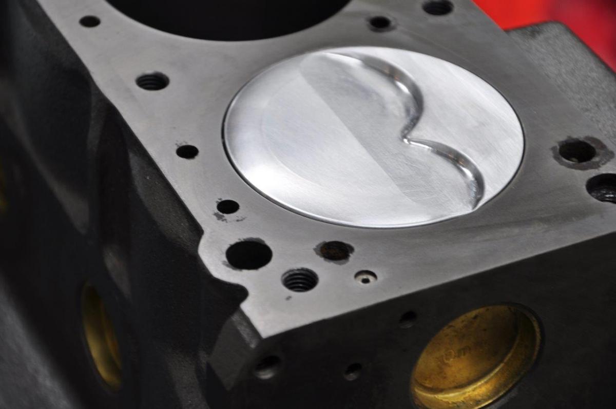

CBR Jeff Posted May 12, 2016 Author Posted May 12, 2016 And the end result from both top and bottom. Quote
