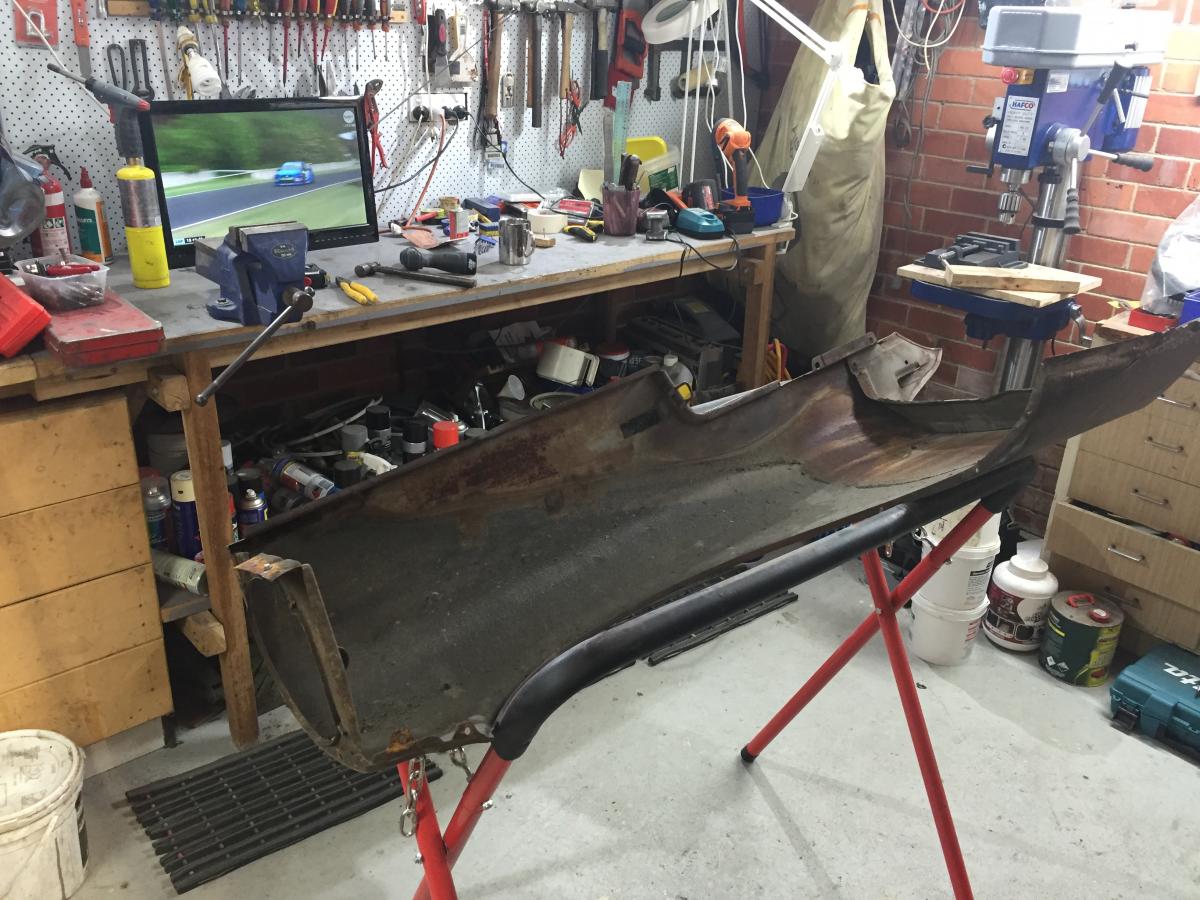

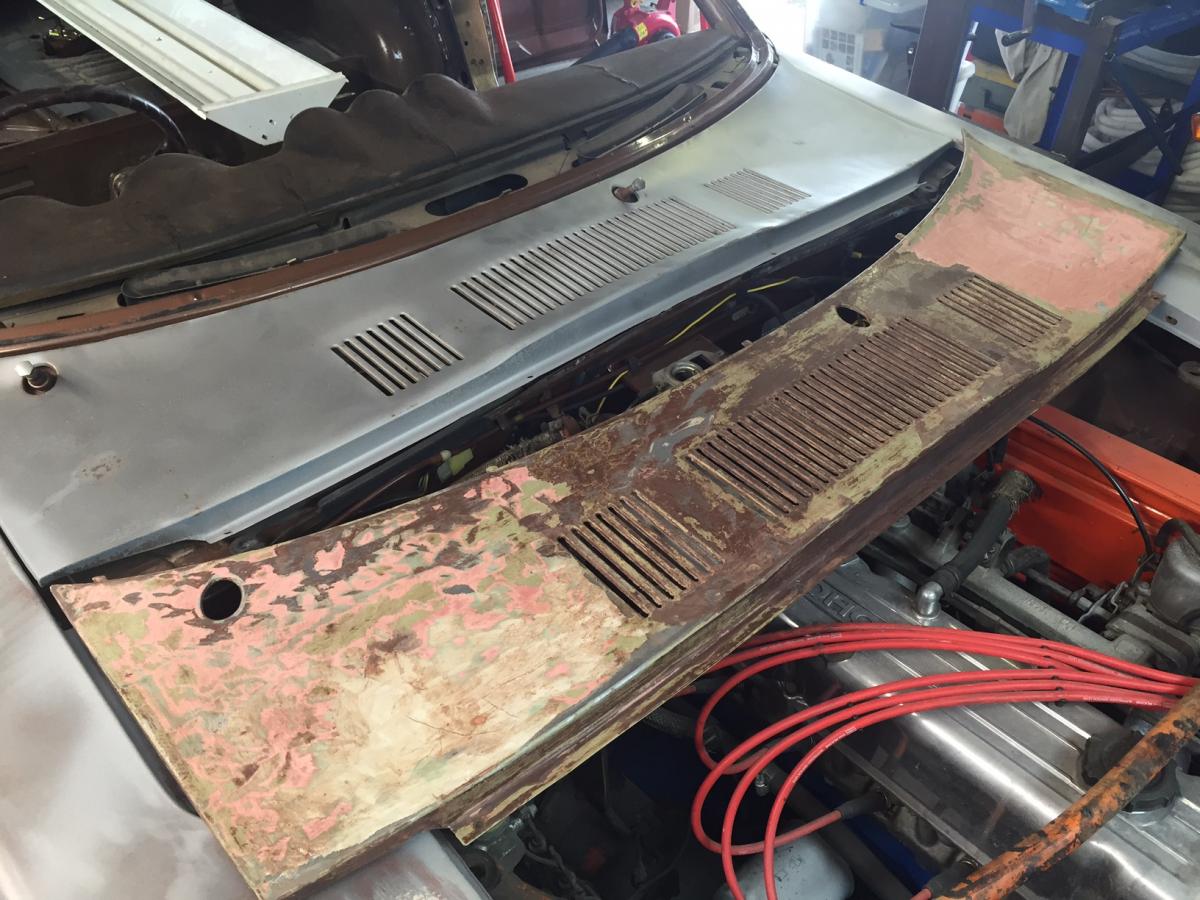

CBR Jeff Posted November 13, 2015 Author Posted November 13, 2015 (edited) How time gets away from you when you are having fun or just done have enough of it (time) Its been over a month since I have had time to sit at a computer and post an update on the progress with the Z car. So here we go. I posted this quote earlier but as I move through this build I am beginning to appreciate it more and more and understand its true meaning........ "One of the eternal truths of automotive restorations is that inherited problems from previous restorers are always worse than problems that occur naturally". Over the Bathurst weekend I managed to strip the windscreen out of the car, remove the roof lining, strip the paint off the roof, continue to carry out the RH quarter repairs and tinker with all manner of things. One of the above mentioned man made problems was my cowl panel. it had been well and truly tampered with to the point I decided I needed a new one. After stumbling across a cowl panel in what looked like very good condition (and it turned out to be just that) on gum tree I purchased it and I am very happy with this. It has now been soda blasted along with both guards and the headlight cones. The Soda blasting has also confirmed what I thought was the case with a few more man made problems when rust was repaired at the bottom of both guards. I though this was the case as when removing the guards I found that they had been welded, yes welded at the bottom as the bolts were rusted away. One of the items I found during the stripping of the turret was that some of the lead needs rectification. So today I picked up some flux and a few sticks of lead to hopefully sort these sections over the weekend. Im also going to need to use a bit of lead to finish off the rear quarter repairs,. Progress is also being made on several founts in Warragul and LCR. The Diff is having a KAZZ LSD centre fitted and should be all completed so I can pick it up in a few weeks when I am in the Gippsland region. The L24 I sent down about 6 weeks ago looks like its coming back as an over 3L.............I'm still coming to grips with the 29% increase in capacity and what that will translate into but Les said it will be good . The boys are also working on a new exhaust and some other additions for the car. A couple of photos below Edited November 13, 2015 by CBR Jeff Quote

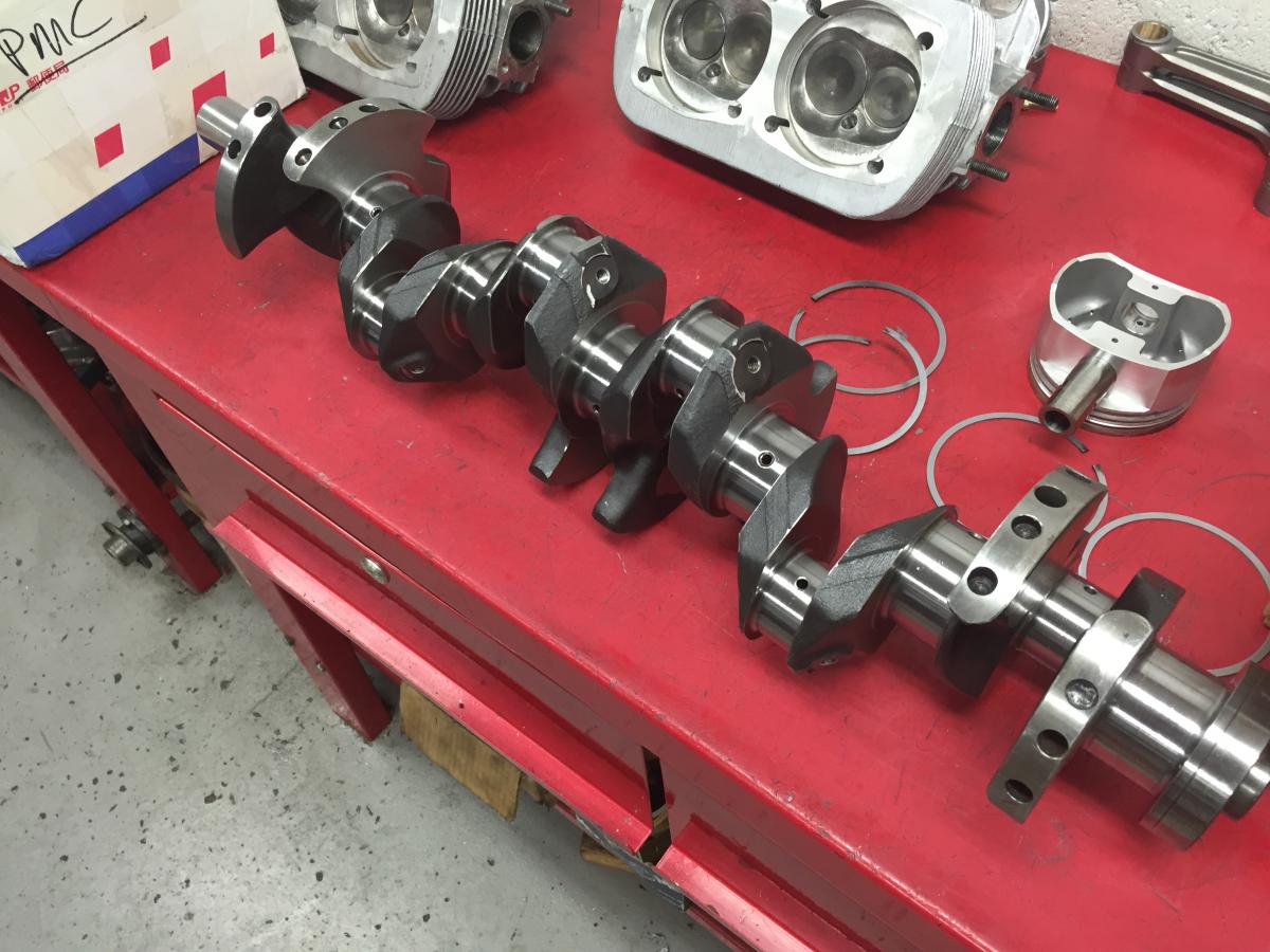

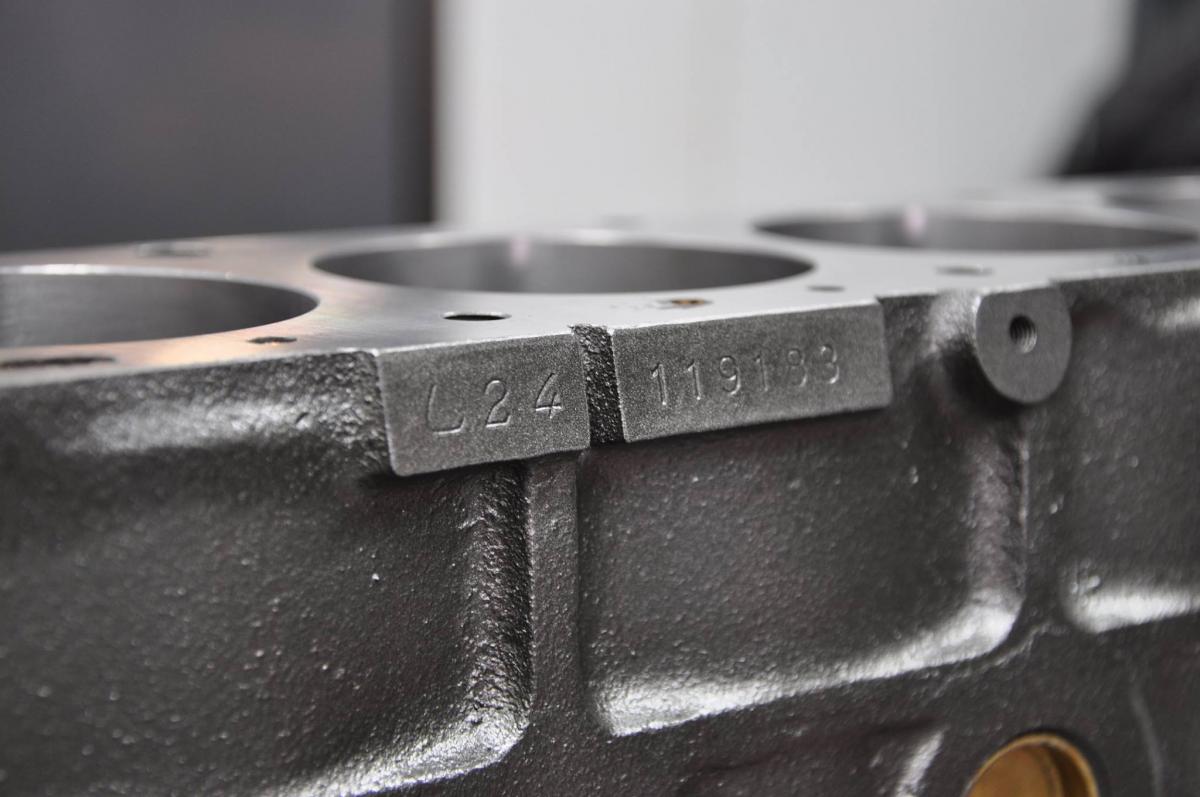

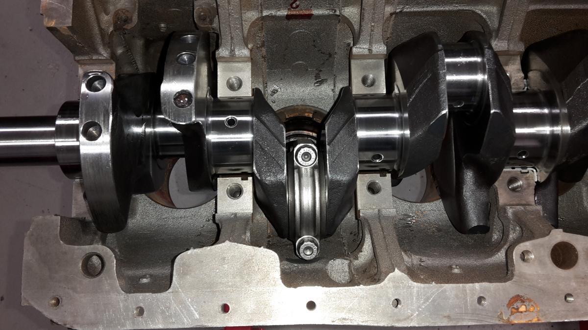

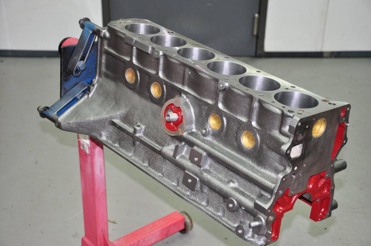

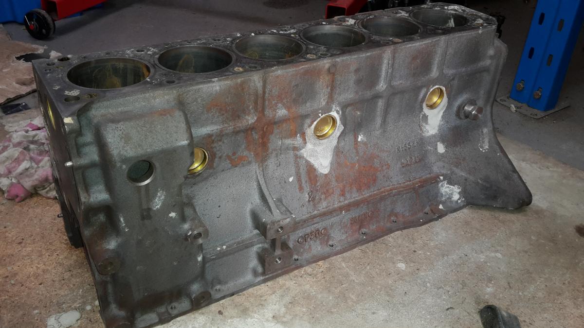

CBR Jeff Posted December 2, 2015 Author Posted December 2, 2015 I am working near Warragul this week so I made the pilgrimage to LCR this afternoon. It was great to meet Les have a Cook's tour chat about my engine build and talk about physics with Les. Les seemed quite excited about the prospect of building a (as I'm calling it) 3.1 from an original L24 block. I'm just looking forward to its performance once it's in the car :-). I took a couple of photos of a few things. Jeff gav240z and George 2 Quote
Administrators gav240z Posted December 2, 2015 Administrators Posted December 2, 2015 Yeah a 3.1ltr from a L24 block is awesome, what crank are you using? LD28? Or RB30? or is it the L28 crank? I am going with a similar idea for my Safari Gold car, L24 block with E31 head (re-welded chambers), not sure I'll go stroker yet. Keeping mine on a tight budget. Quote

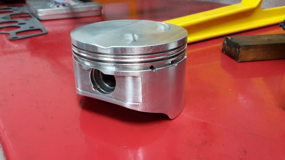

CBR Jeff Posted December 2, 2015 Author Posted December 2, 2015 Les said the crank starts life as an RB crank then gets modified with the journals reduced and off set ground to increase the stroke. Or something like that. Honda I beam rods and LCR pistons should be nice when it's together. It will be 85.5 bore 89 mm stroke makes it just over 3 ltrs. Around 300 BHP at 6500 with 260 ft lbs from about 3500. Coupled with EFI it should be a good driver. Quote

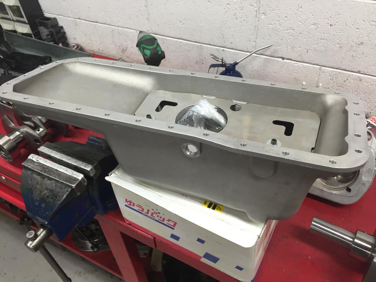

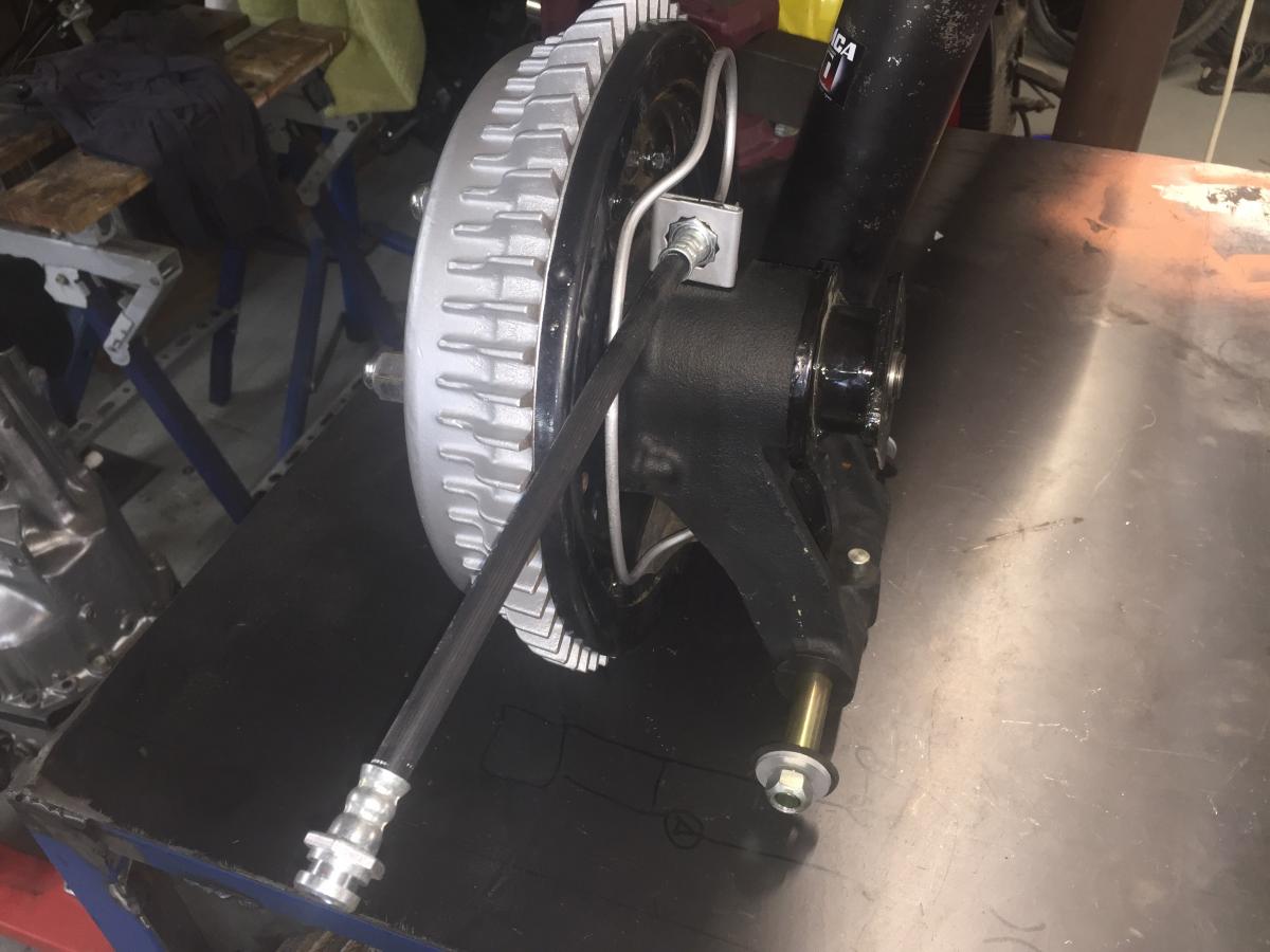

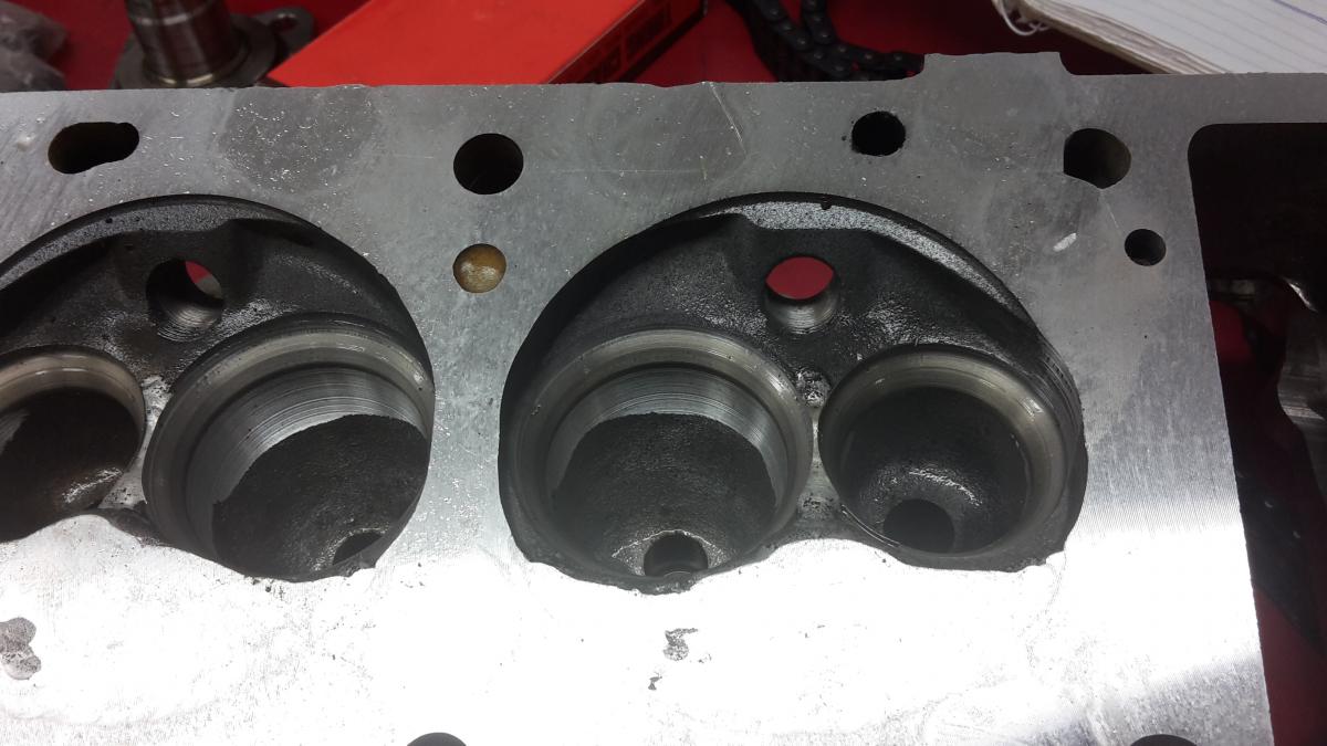

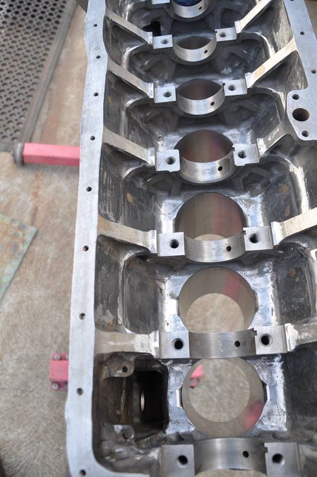

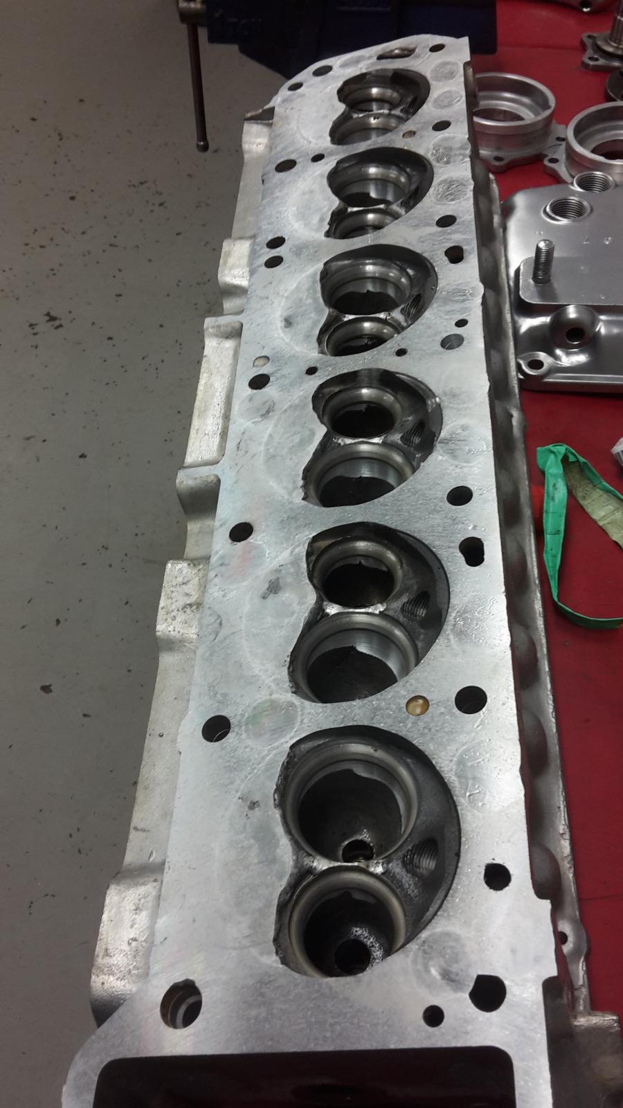

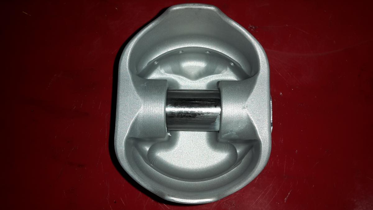

CBR Jeff Posted December 16, 2015 Author Posted December 16, 2015 (edited) I was in the workshop today for a few hours investigating a compressor failur. When I was done I had time left to spend working on the 240. It was great. I felt like doing some fitting work so I started to re assemble the right rear strut. Fitted the bearings stub axle and breaks. Always great to get the time to just potter. On the engine front I can share a few figures of what's in production at LCR. Les also sent through a couple of photos today of the Pistons and one of the block pre machining. Block original L24 Bore = 85.5 mm Stroke = 89 mm Capacity = 3066 cc (call it 3.1l) Compression = 10.57:1 Head original E88 Inlet valve = 44 mm Exhaust valve = 35 mm Chamber = 50 cc I think it should go ok. Might just be a wolf in sheeps clothing? Edited December 16, 2015 by CBR Jeff Quote

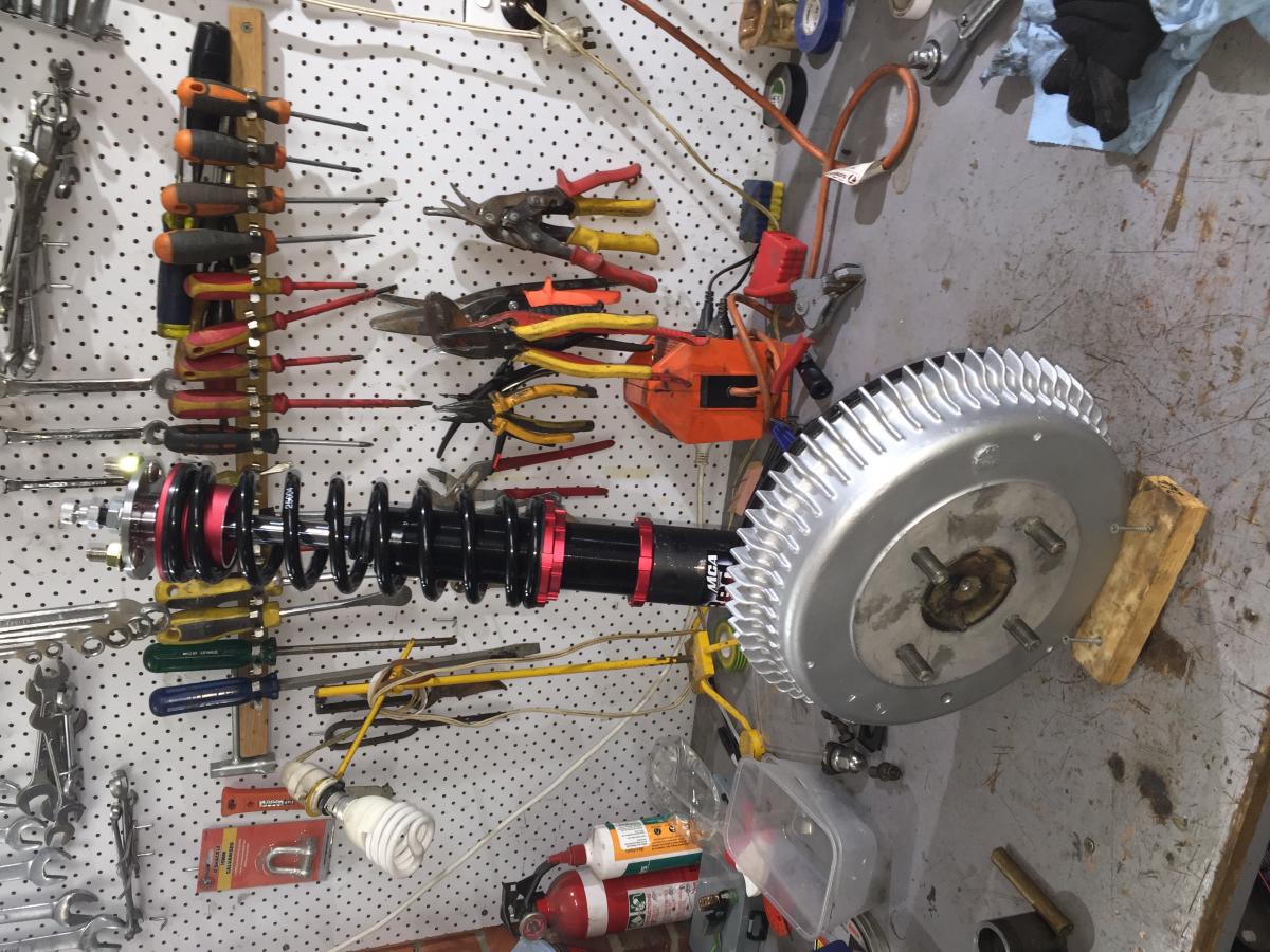

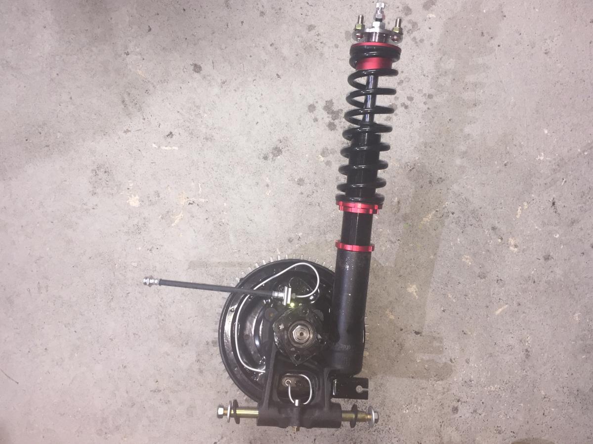

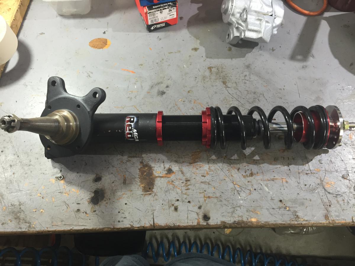

CBR Jeff Posted December 19, 2015 Author Posted December 19, 2015 Spent some of the day in the shed. Man it was hot here today. Our garage is under the house so it stays nice and cool. It was a retreat today. Spent time sandblasting small components and painting them plus some assembly work. Finished off the RH rear upright. Quite happy with it. Not sure what I will do tomorrow just to many things to do........ Quote

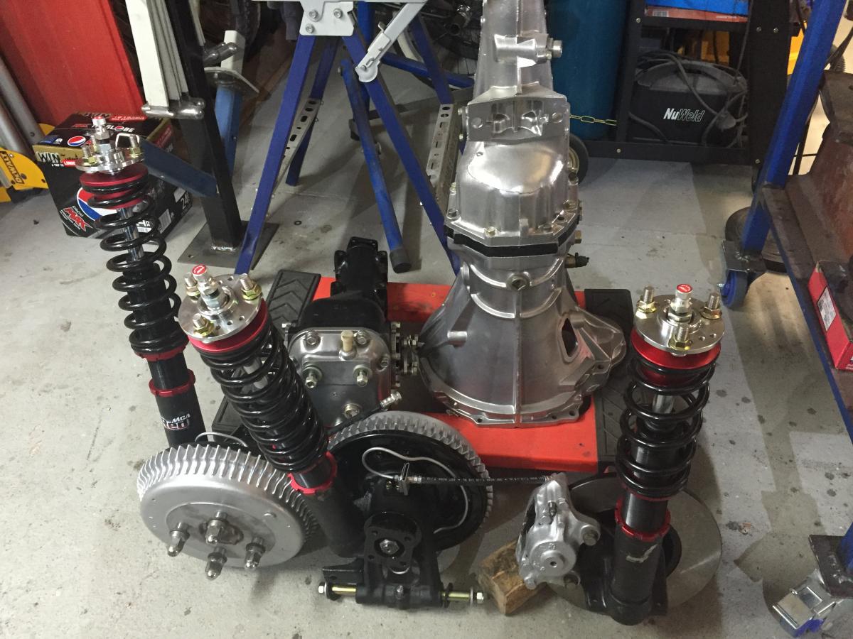

CBR Jeff Posted December 20, 2015 Author Posted December 20, 2015 More progress today. Three of the four struts are re assembled and ready for installation one day when the body is finished. Forth one I is on the bench so should get it done this week. The colection of finished components is growing larger at the back of the shed. And the bonus is that all this has feed up some shelf space. Quote

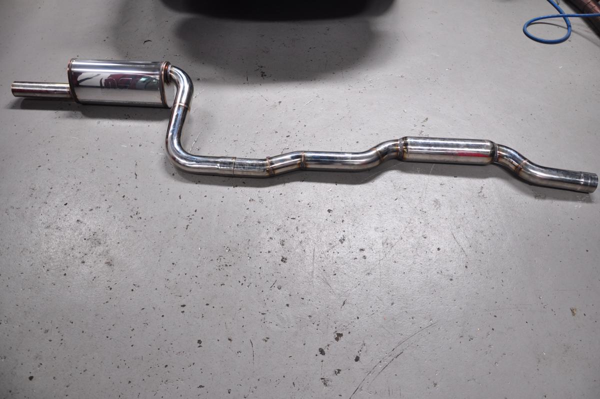

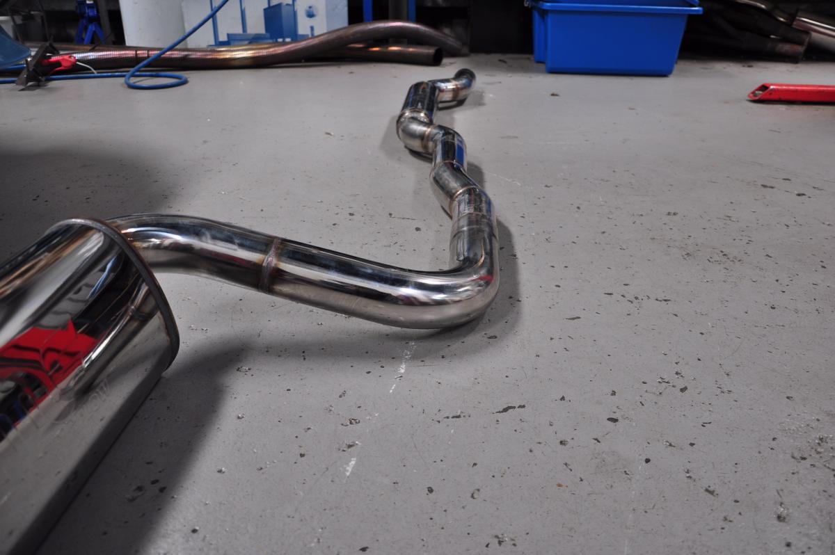

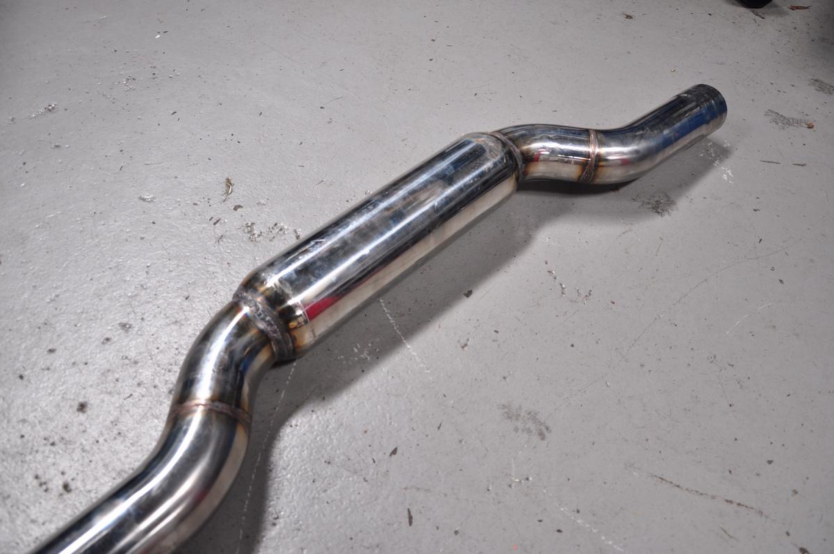

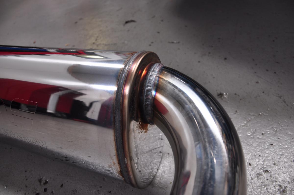

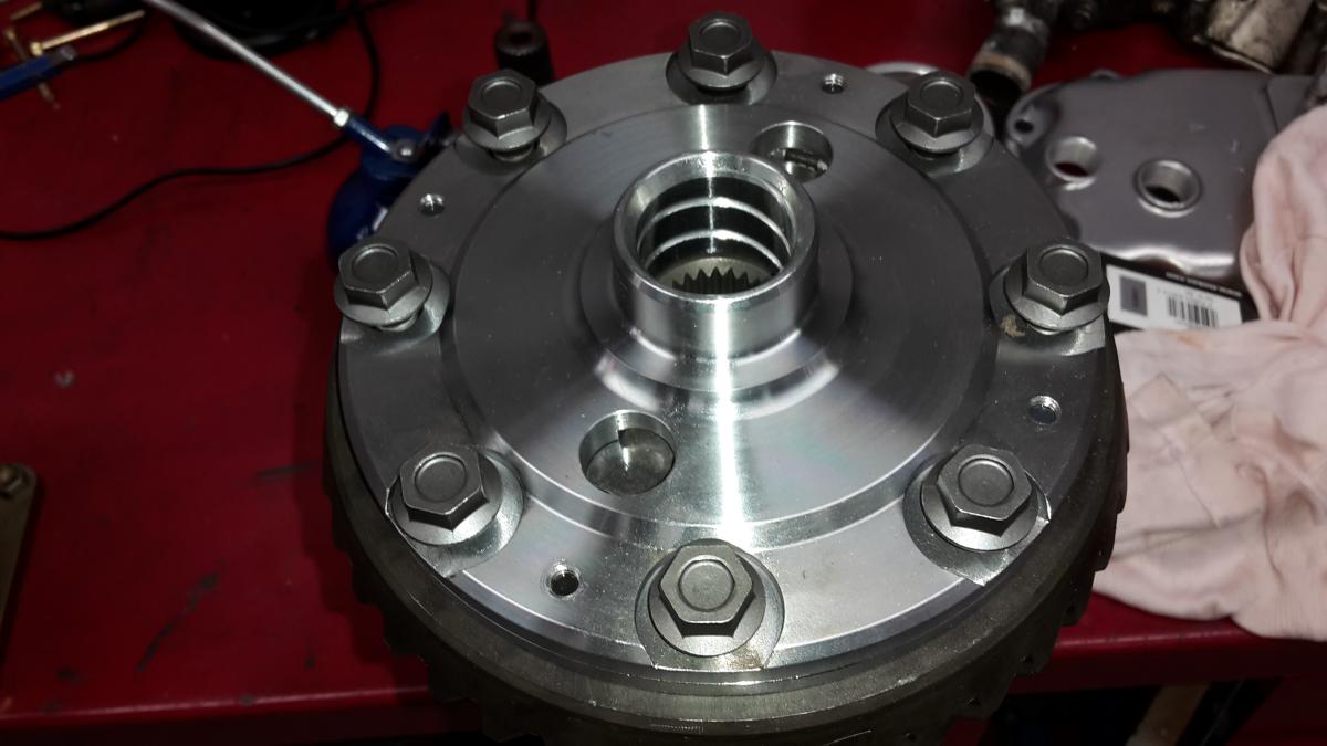

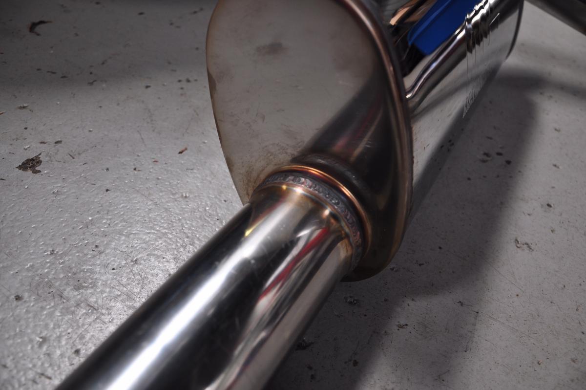

CBR Jeff Posted December 21, 2015 Author Posted December 21, 2015 This post comes with a warning. I think it's art but viewing these photos may result in feelings of lust. Lurch has made a nice job of this. C.A.R. 1 Quote

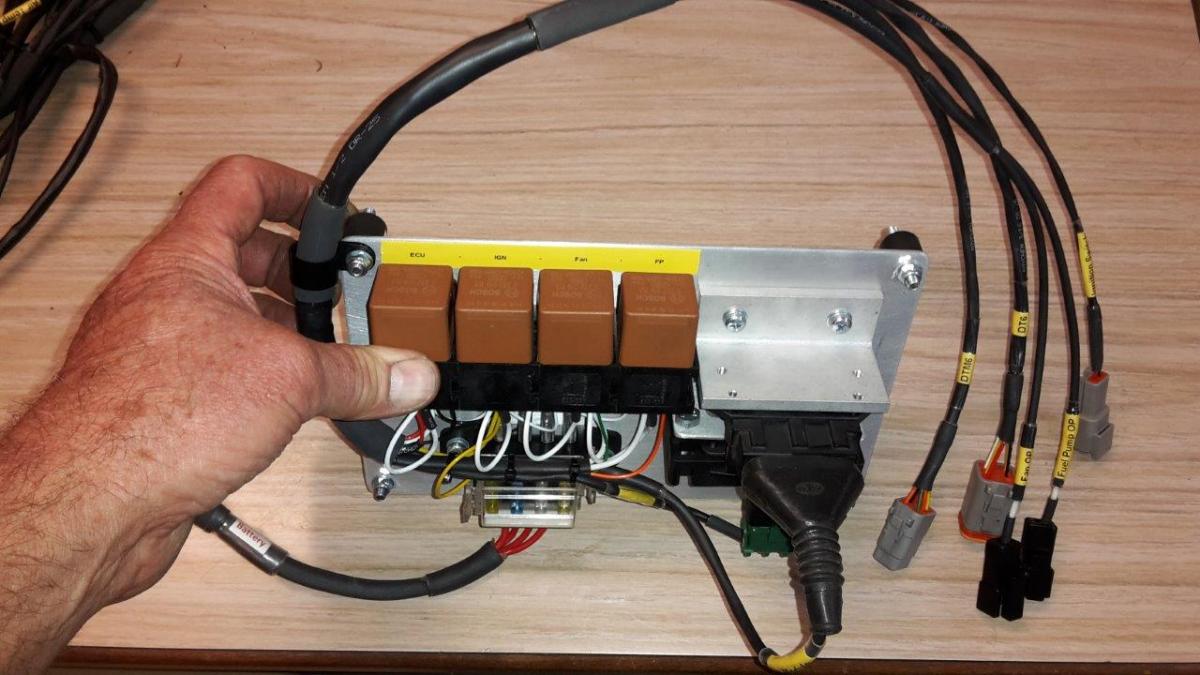

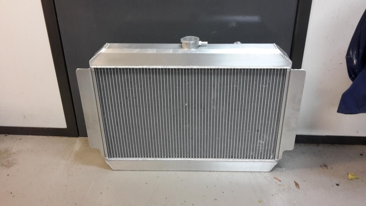

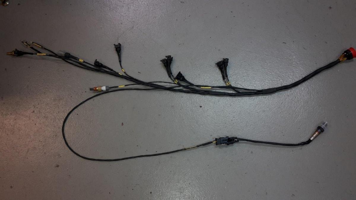

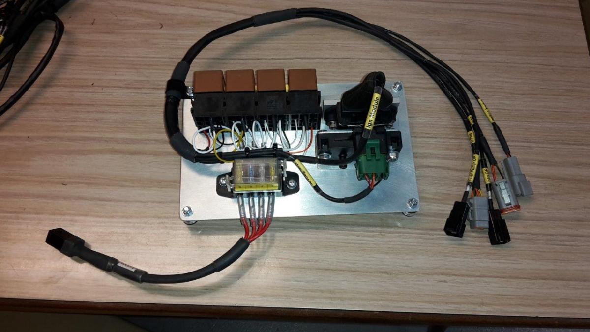

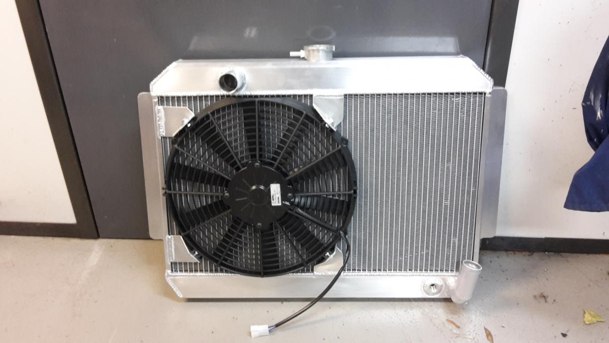

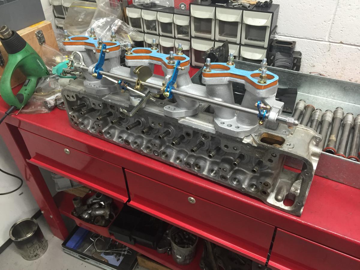

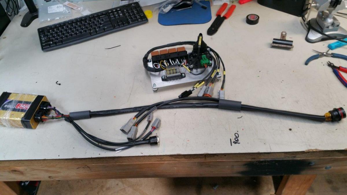

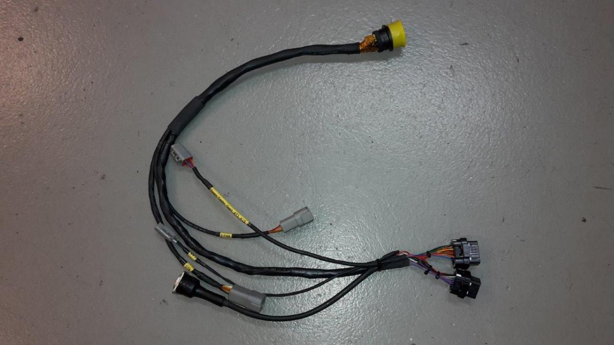

CBR Jeff Posted January 22, 2016 Author Posted January 22, 2016 Lucky Les and the boys are working while I'm on holidays. Les sent me some photos today of progress on two fronts. LCR have manufactured an efi wiring harnes to go with the motec that will run the EFI hardware throttle bodies. Les has also arranged for a radiator to be manufactured to keep the power plant cool. With increased power output will come an increase in heat generated by the engine so it's important to get that heat energy out of the system (that's physics). I was showing one of my Japanese friends some of the photos of my build, to say he was impressed by the work that eminats from the LCR work shop is an understatement. When you consider who Yoda san does work for and the quality of his work it's high praise indeed. Big thumbs up. I am looking forward to getting back to the rust and body repairs when I get home. Quote

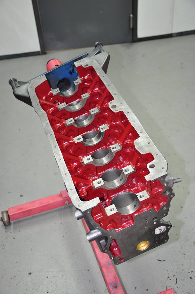

CBR Jeff Posted March 18, 2016 Author Posted March 18, 2016 Firstly apologies, I have been letting the serious stuff get in the way of the enjoyable things in life and neglecting both the 240Z and the forum. Spare time has been very short over that last 6 to 8 weeks so progress has been quite slow for me, but luckily the day job is entering a lull and I should be able to get back to the shed and the shell in the next few weeks. Also on a positive note Les and the Boys at LCR have been forging ahead. I have been told that my L24 build has again made the front page of the LCR facebook site. I must say I got a bit excited when I saw some of the photos . Les also sent through a few photos of the EFI wiring harness they have built for the motor. Quote
CBR Jeff Posted March 18, 2016 Author Posted March 18, 2016 Grabbed a few photos of the 3.1 L24 build from the LCR face book page. Looks very very nice. Quote

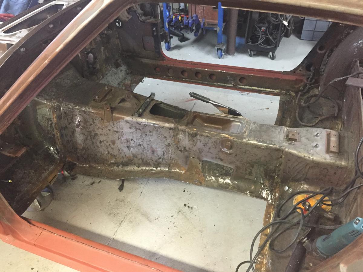

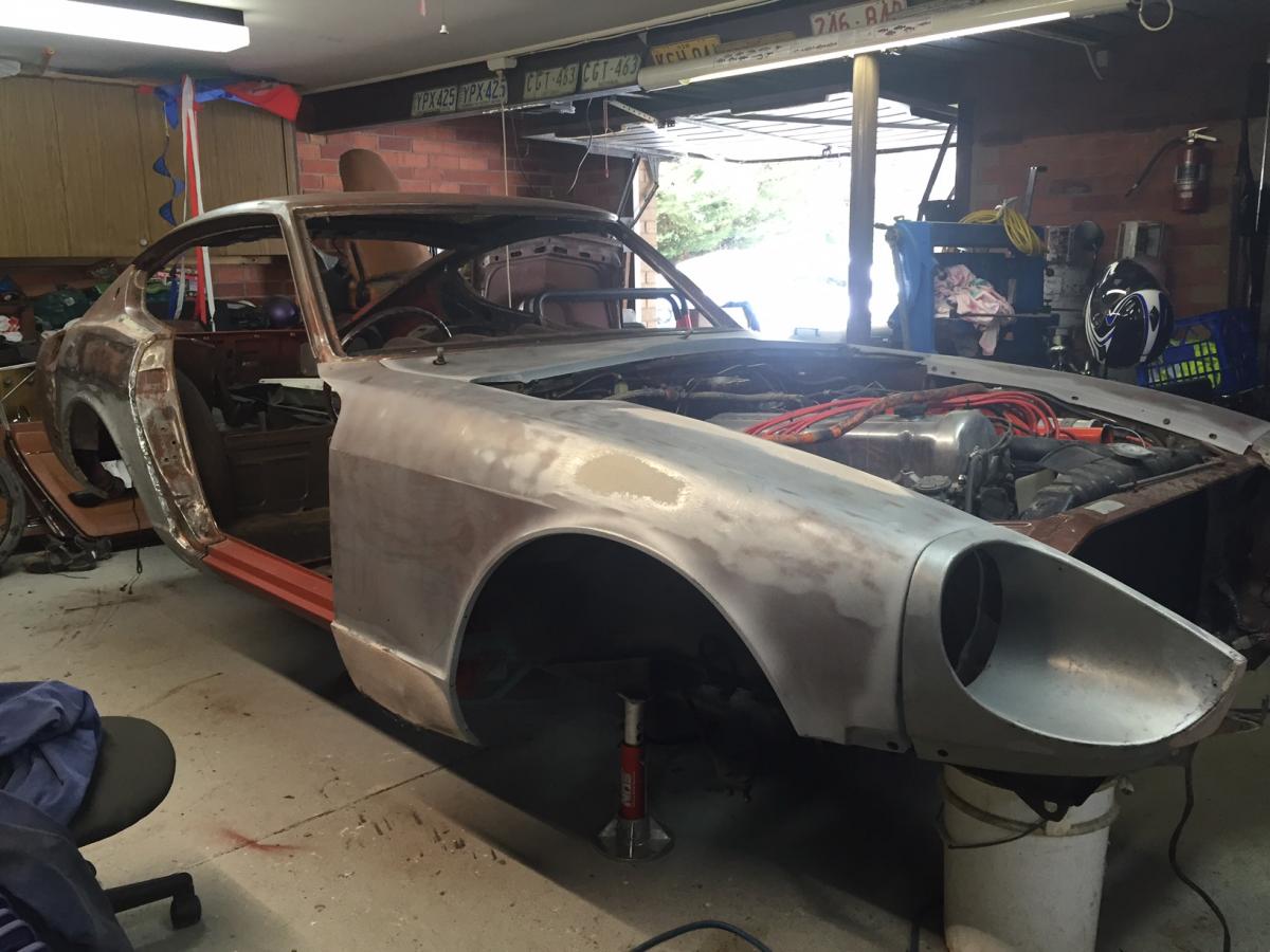

CBR Jeff Posted March 22, 2016 Author Posted March 22, 2016 (edited) I have managed to spend a bit of time working on the Z in the last few days. I have finally made the decision the car needs to go onto a rotisserie to make life easier and get a better result. So the old L26 has been pulled out and front and rear frames to mount it to the rotisserie have been fabricated and are ready to go. I also removed a few other items including the battery support. It's feeling good to be back in the shed. Rocky is also enjoying having me around a bit more as he gets to mooch around the shed. Edited March 22, 2016 by CBR Jeff George 1 Quote
