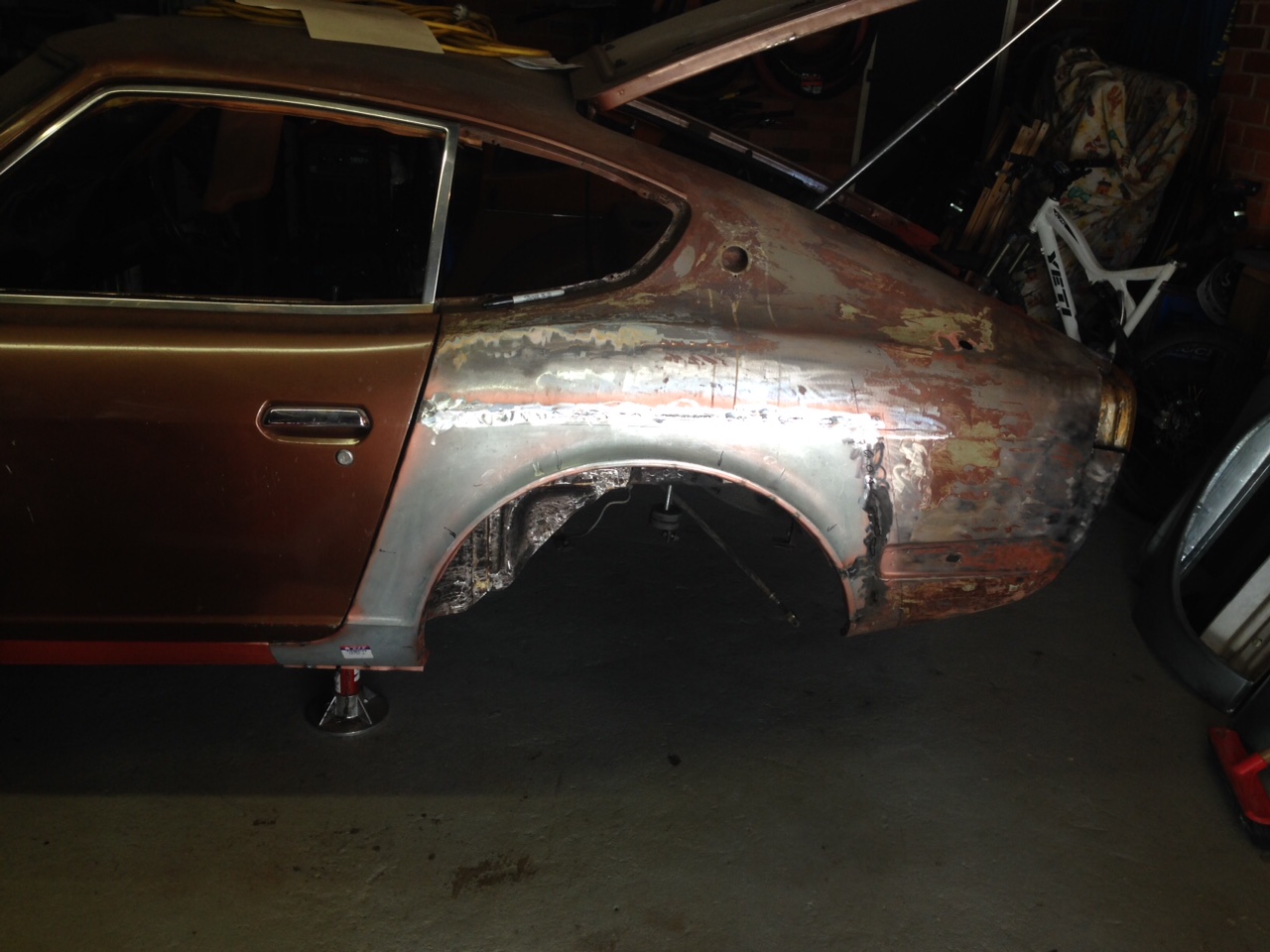

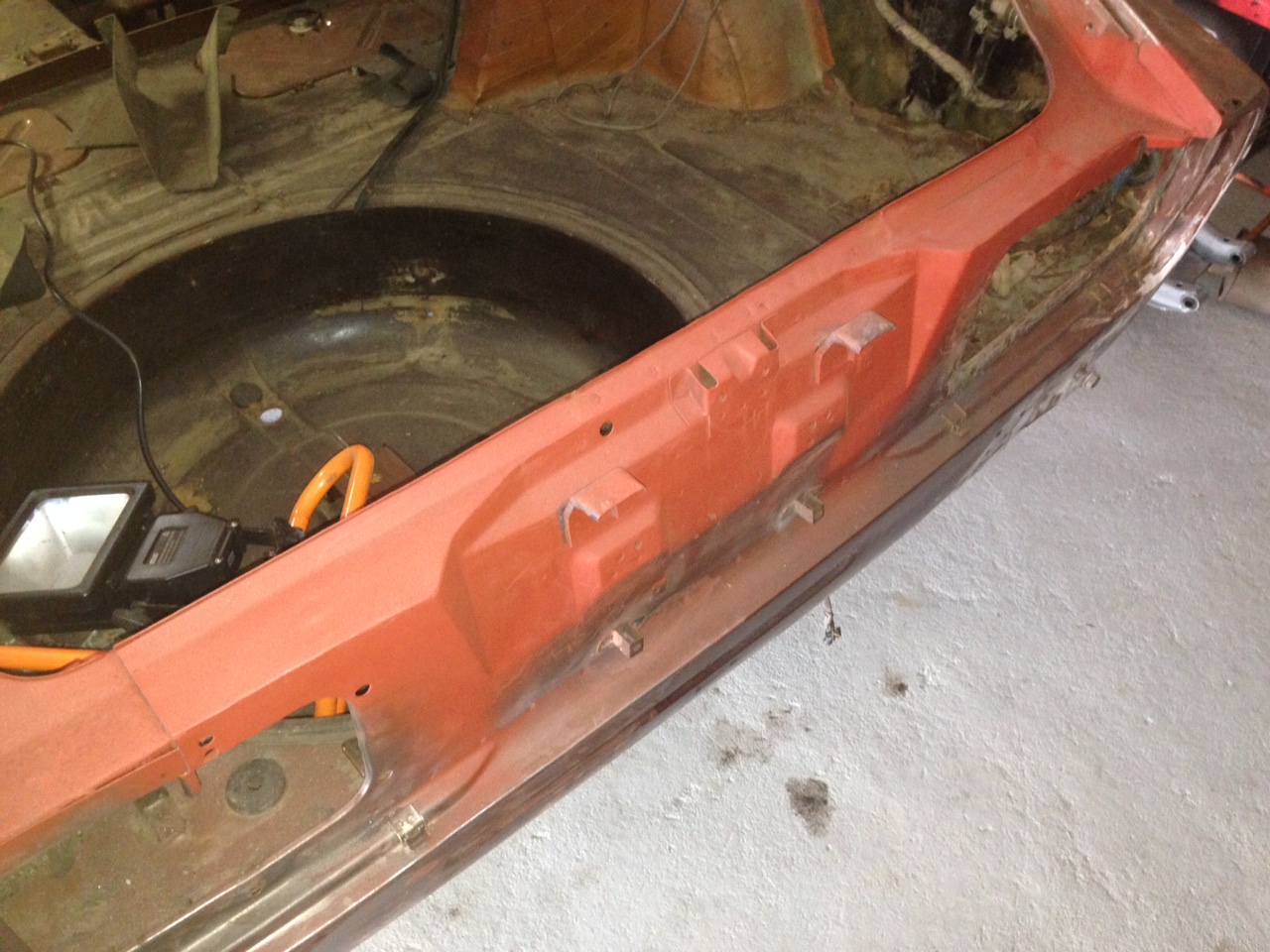

CBR Jeff Posted June 21, 2015 Author Posted June 21, 2015 I managed a few hours over the weekend to almost finish off the passenger’s side, ( just need to weld up a couple of small pin holes then grind them off). started cutting into the driver’s side to give it the same treatment as the passenger’s side. Also spent some time cleaning up some parts. Pulled the bearings off the rear drive shafts and cleaned them up ready to fit new bearings at some stage. This is a great time in a project as there is so many jobs that need doing. If you feel like detail work, grinding and cutting or just pulling something apart always lots to do. I have also posted some photos of my rear slam panel repairs, that I started before I started this thread. I’m still mulling over the repair to the Passengers side tail light area. I have had a few false starts at this as I basically need to re build the complete top of it. It’s quite fiddly. I think I will make a wood negative of this area and use it as a pattern, not sure yet. Rocky was not much help this weekend as our Daughter is home from university and all he wanted to do was walk, sleep and eat, the life of a dag… Jeff Quote

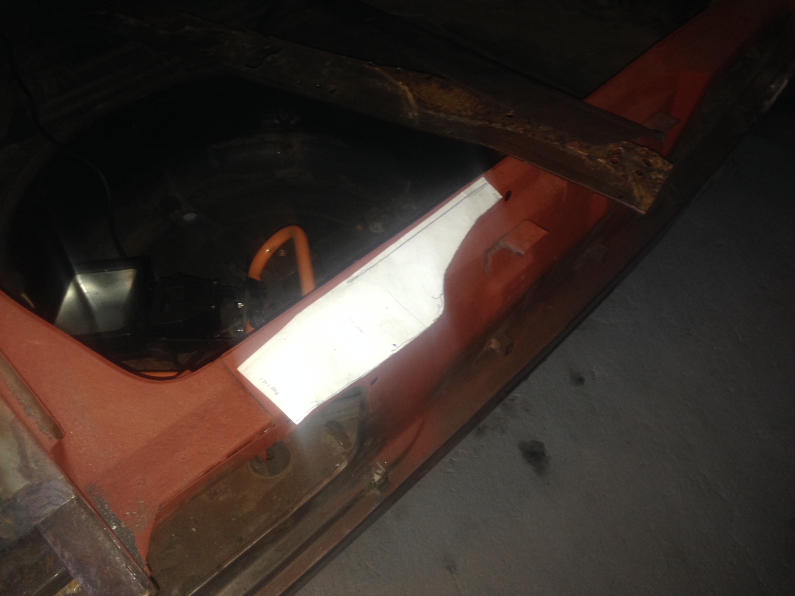

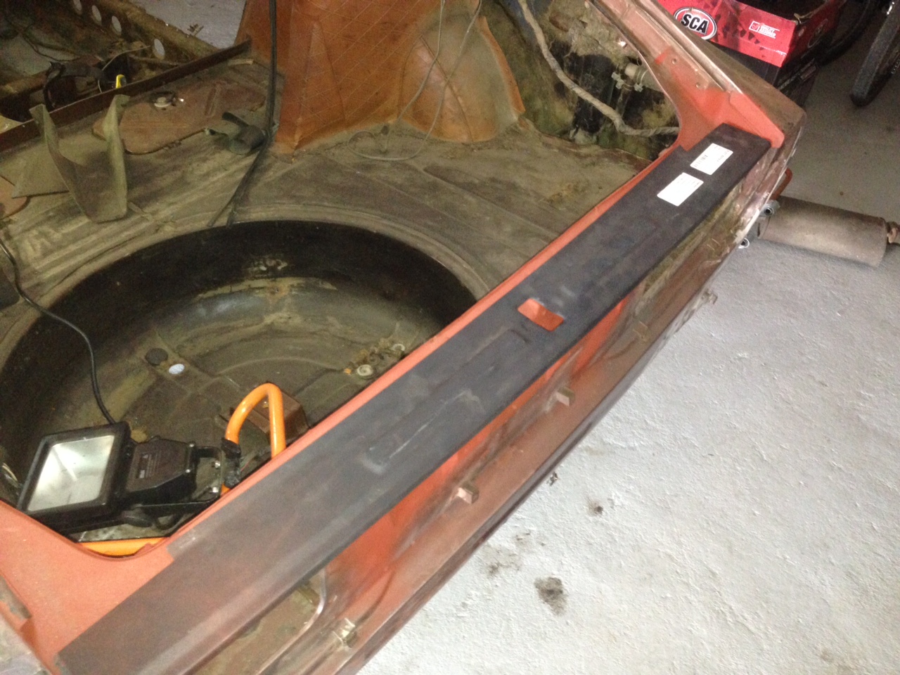

CBR Jeff Posted June 21, 2015 Author Posted June 21, 2015 Slam panel repair. I have not fitted the repair panel from Rare Spares yet as I still have a few issues at the passengers side end to sort out. Quote

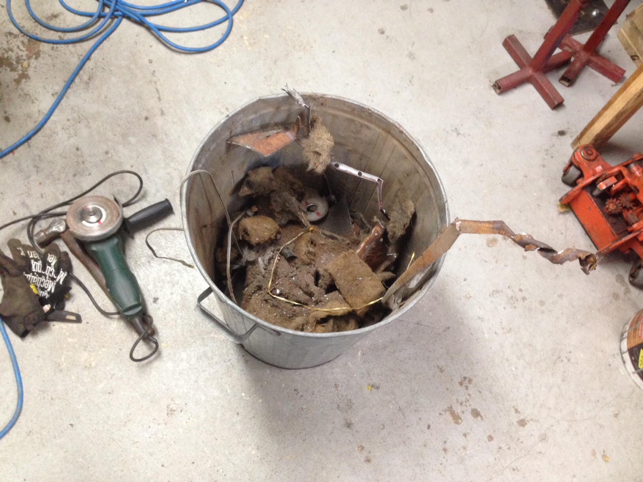

CBR Jeff Posted June 23, 2015 Author Posted June 23, 2015 Back on cars and in particular Z cars. My car has the indicator lights under the bumper but no lights in the guards see the photo. Quote

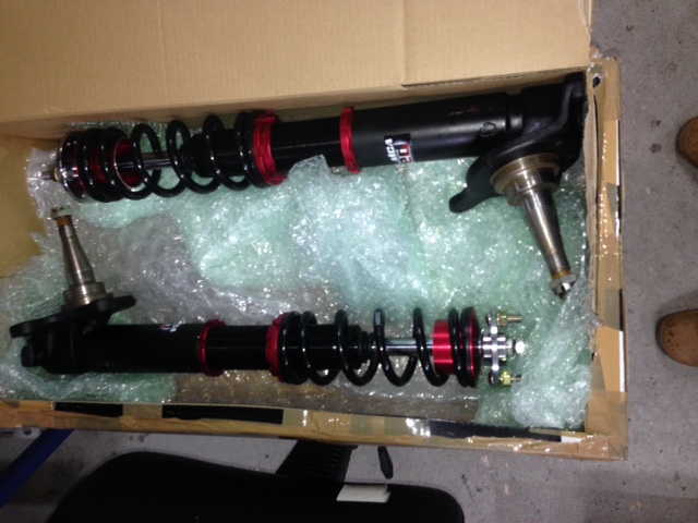

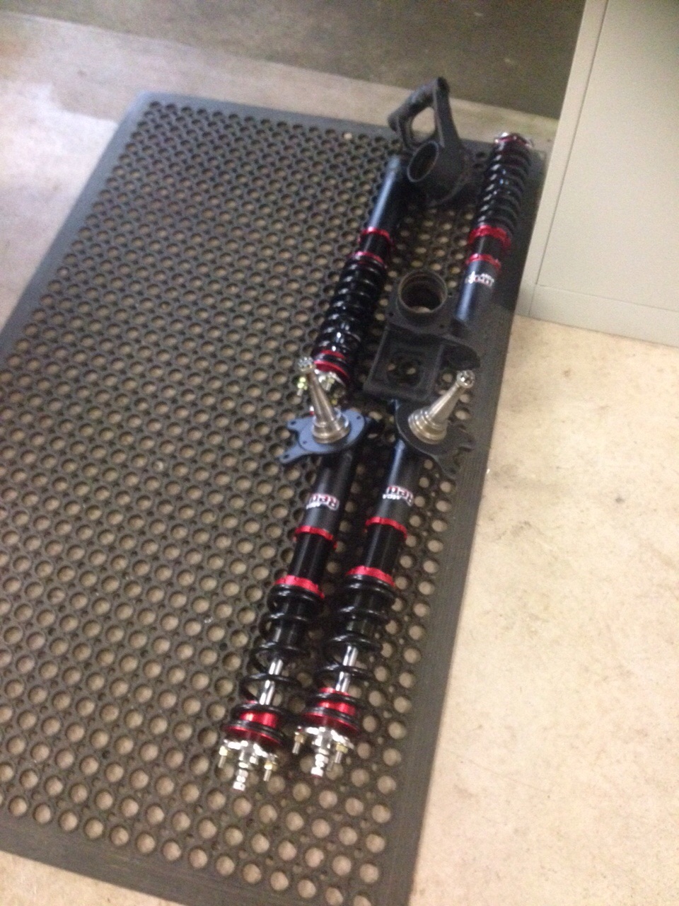

CBR Jeff Posted June 25, 2015 Author Posted June 25, 2015 Another part of the puzzel is coming along. I should have them to drool over late next week. It looks like josh at MCA has made a nice job of them. Quote

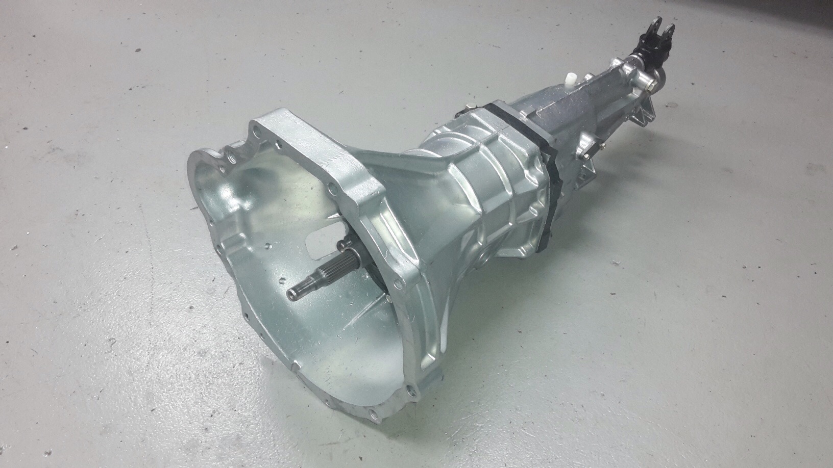

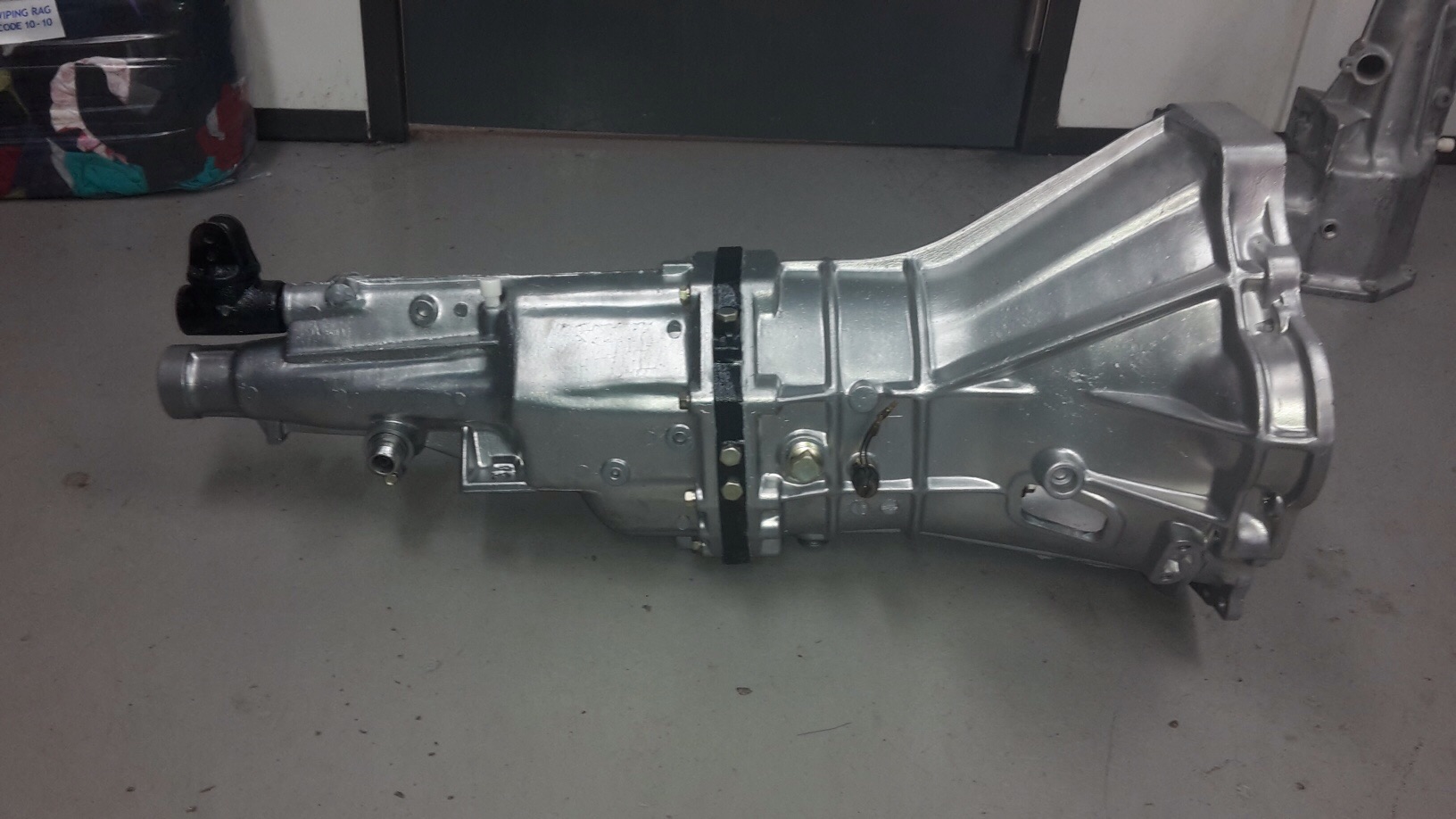

C.A.R. Posted June 26, 2015 Posted June 26, 2015 MCA's look nice. Gearbox was finished this afternoon - it looks preeeeety Quote
CBR Jeff Posted June 26, 2015 Author Posted June 26, 2015 MCA's look nice. Gearbox was finished this afternoon - it looks preeeeety Thanks lurch. Les sent me an email. I think the young people would say OMG!! MCA struts = serious you know. Yep. Pure sex. Quote
KatoKid Posted June 26, 2015 Posted June 26, 2015 Hey Jeff, I'm pretty well sold on MCA's. How much did Josh charge for the Reds? Quote
CBR Jeff Posted June 26, 2015 Author Posted June 26, 2015 Hey Jeff, I'm pretty well sold on MCA's. How much did Josh charge for the Reds? Just checked the invoice it was $3200 plus frt. That was for reds with a couple of options. I basically left it up to Josh and Murray for the set up. I'll get Neil Bates to have a drive when the car is finished for final tuning advice. Quote

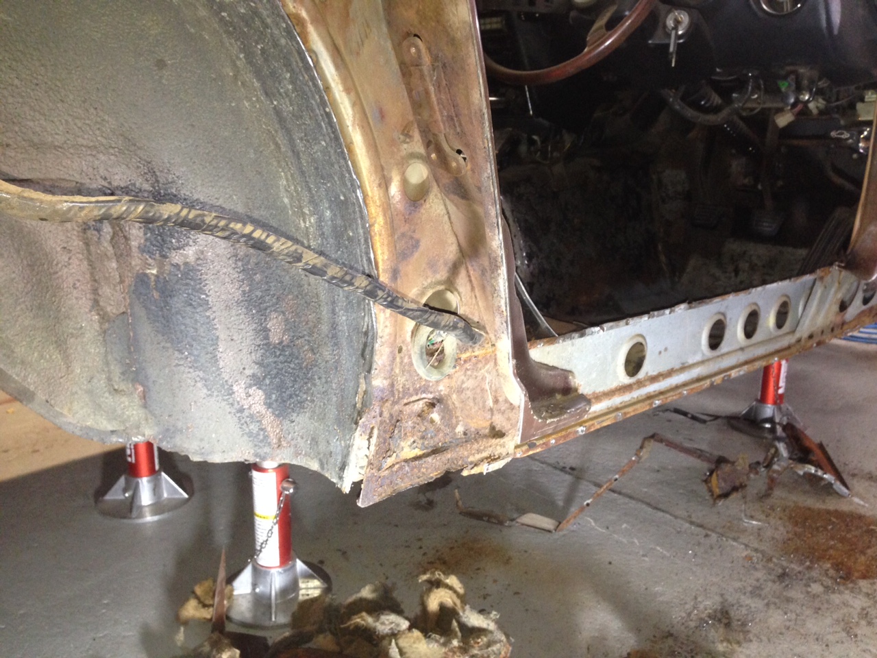

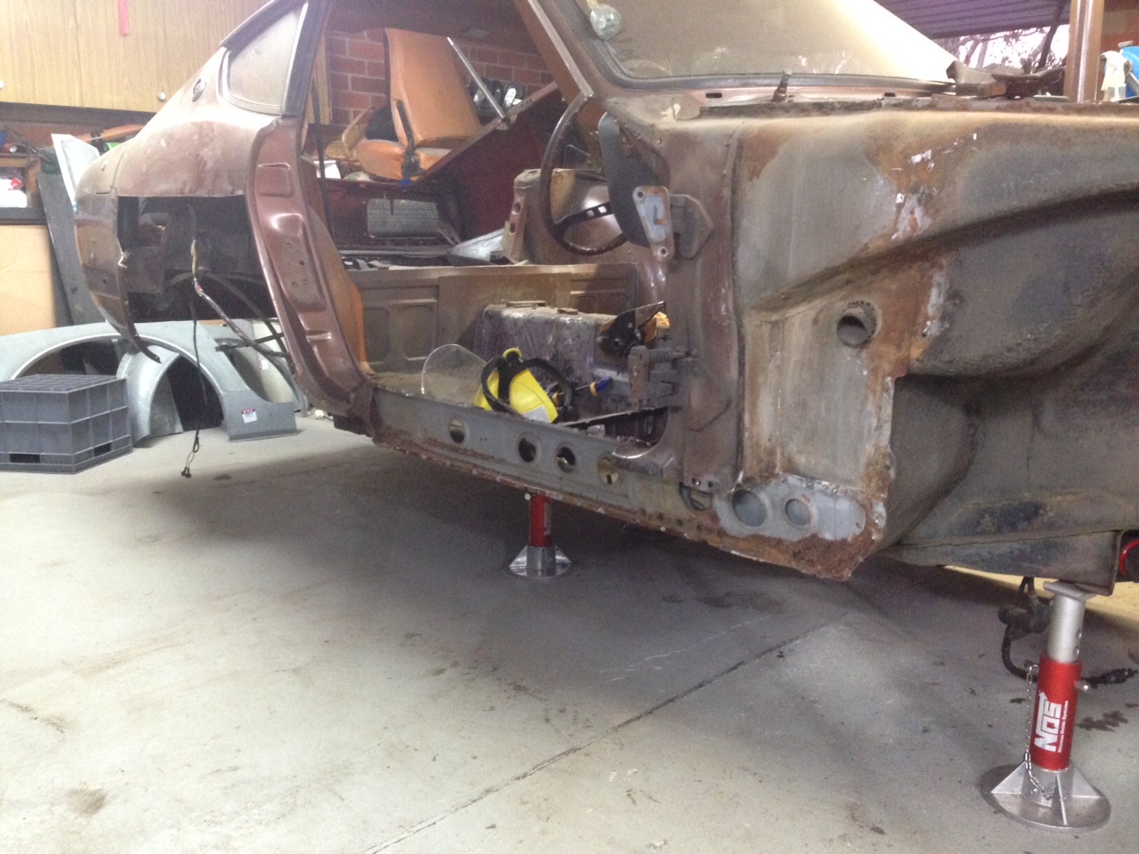

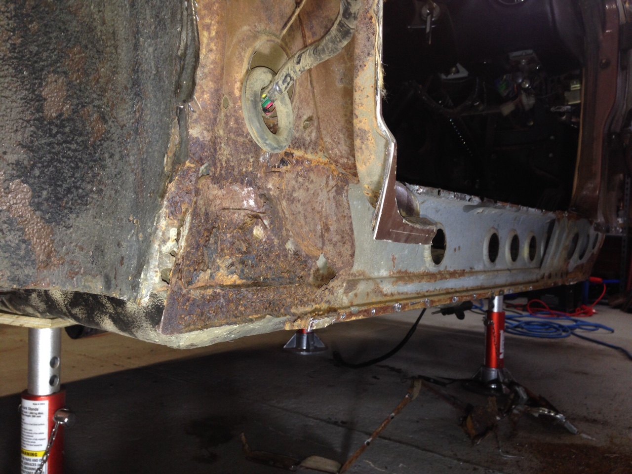

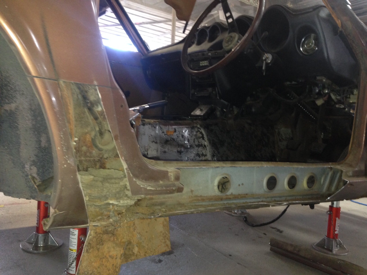

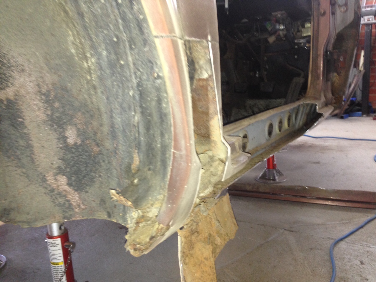

CBR Jeff Posted June 29, 2015 Author Posted June 29, 2015 After wasting a few days at the snow . It was appropriate to have some Z time . Firstly and importantly was to pay some bills. You cannot expect people to carry out work for you unless you pay the bills in a timely fashion. You also wont get parts delivered if you don't pay the money. Then it was off to the shed. Finished stripping the drivers side sill and rear quarter. Found some ugly stuff in there. So its stripped back now and ready to start the repairs, replacements and re assembly process. I can guarantee that if a car is showing signs of rust externally in the sill area it will be 10 times worse inside. I can also see why these cars are prone to rust in this area. No undercoat, poor drainage, sound proofings that hold water. Photos below. Quote

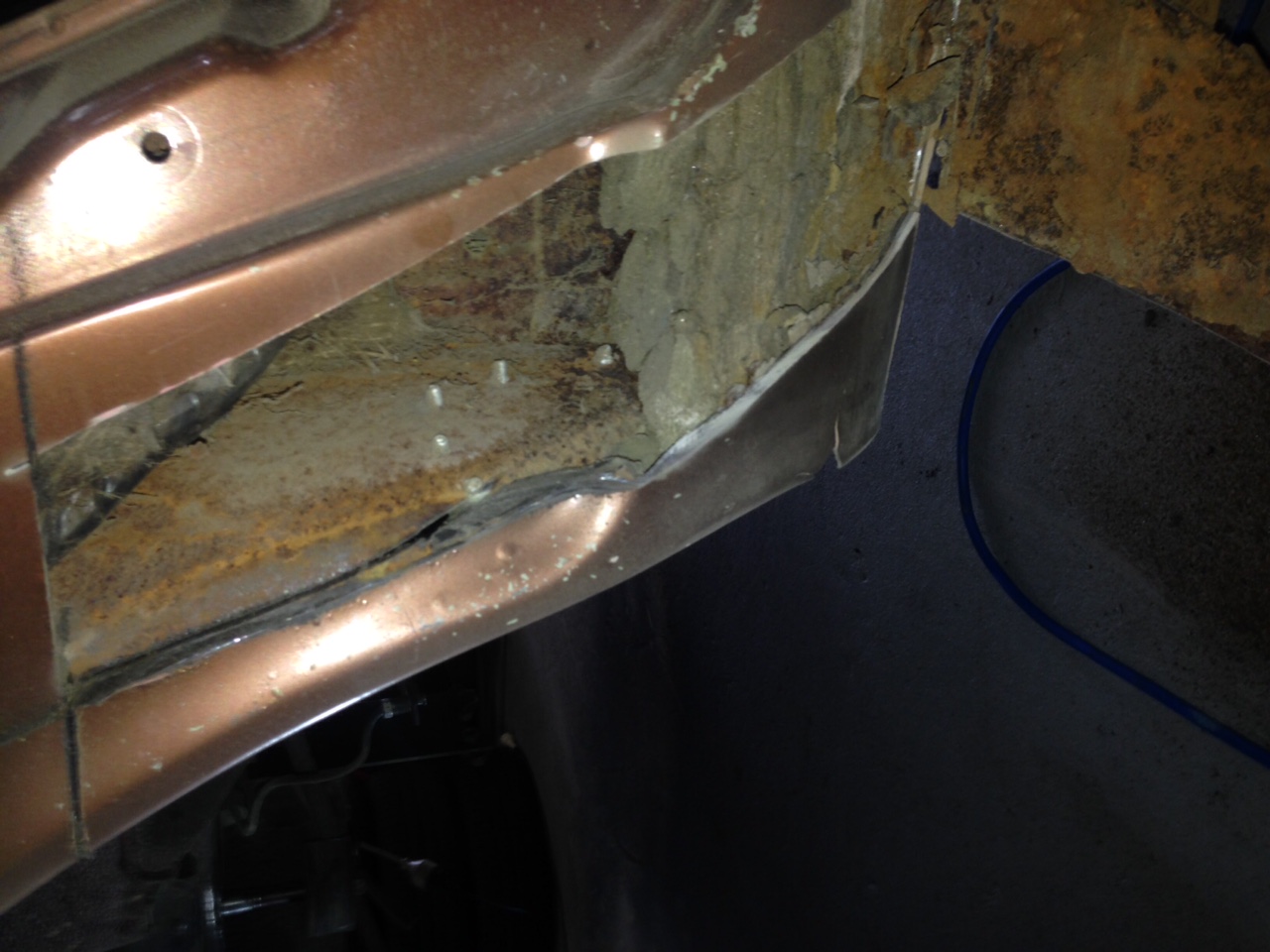

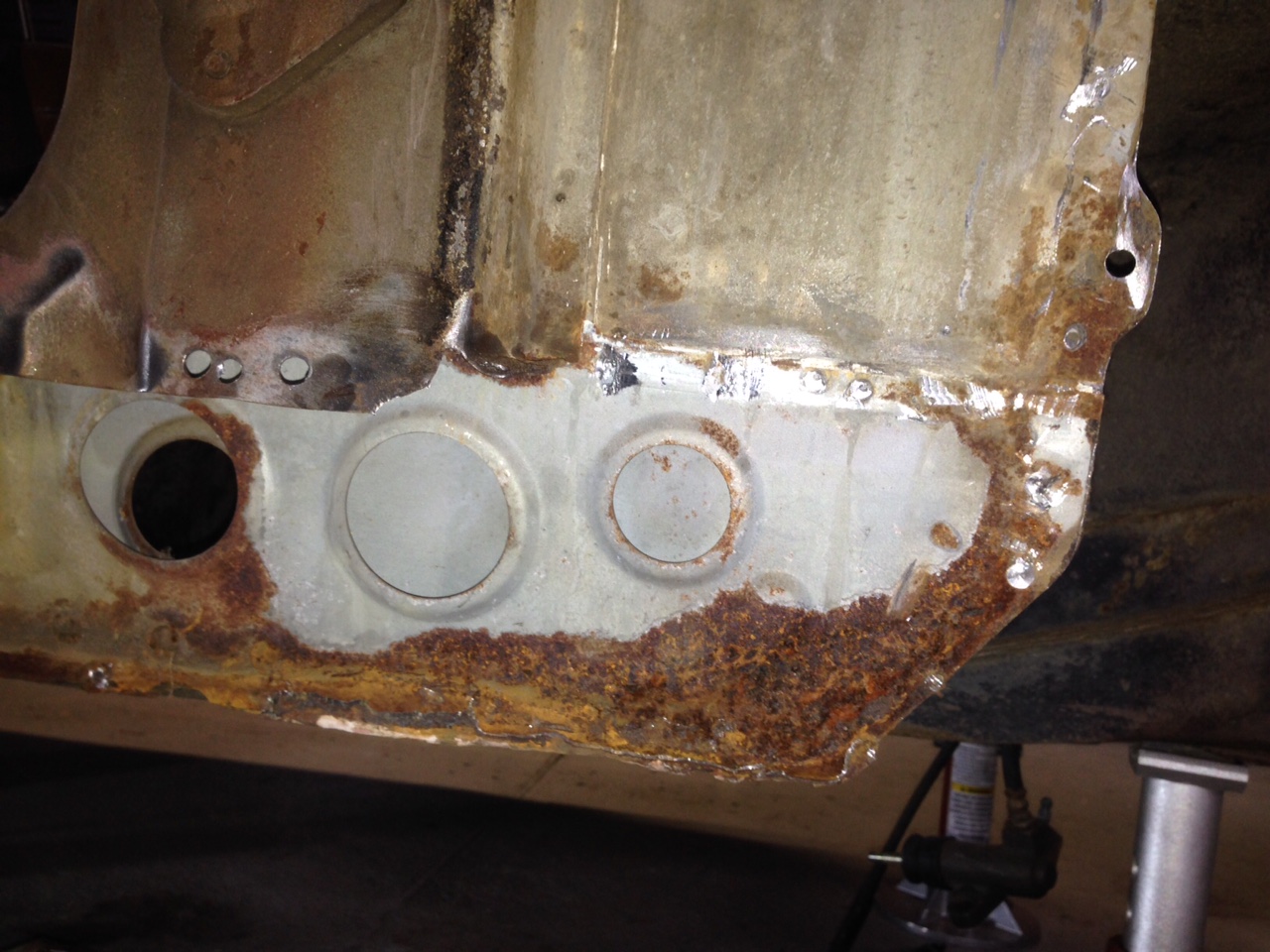

CBR Jeff Posted June 29, 2015 Author Posted June 29, 2015 One more photo of the cancer. This area is a concern as its the side seat belt mount!!!!!!!!!!!!!! :'(. A bit of work to sort out but better to find it now than when you need it! Quote

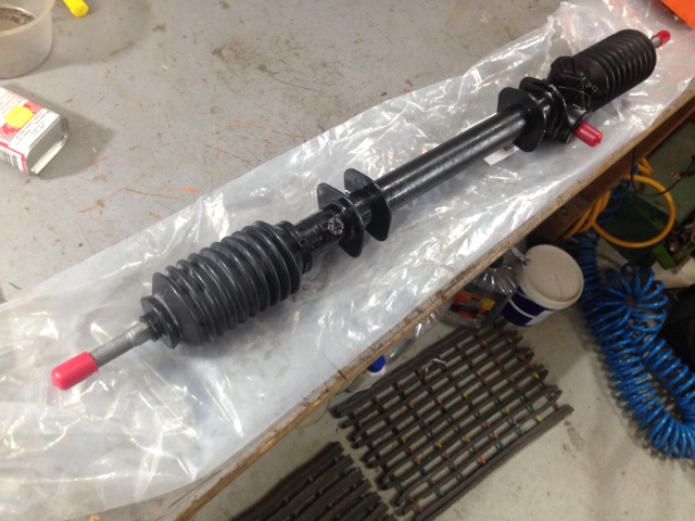

CBR Jeff Posted July 7, 2015 Author Posted July 7, 2015 Bit of an update. Work and very cold weather has stifled any major progress this week and that looks like continuing until the weekend. A few items have been delivered and gathered in the last few days. I negotiated in principal with a fellow member for some induction for my engine once its all sorted out later in the year. Two boxes of bling arrived from MCA yesterday and I picked up some steering components today including a rebuild steering rack that looks and feels (at first look) very sweet. And LCR may have had a look at my diff but not sure or worried as Les will get to it in good time. Jeff Quote
C.A.R. Posted July 7, 2015 Posted July 7, 2015 Your R180 has made it to the work bench Jeff, but we are still downing in gearbox's currently. Who rebuilt your steering rack? Local company? Quote
