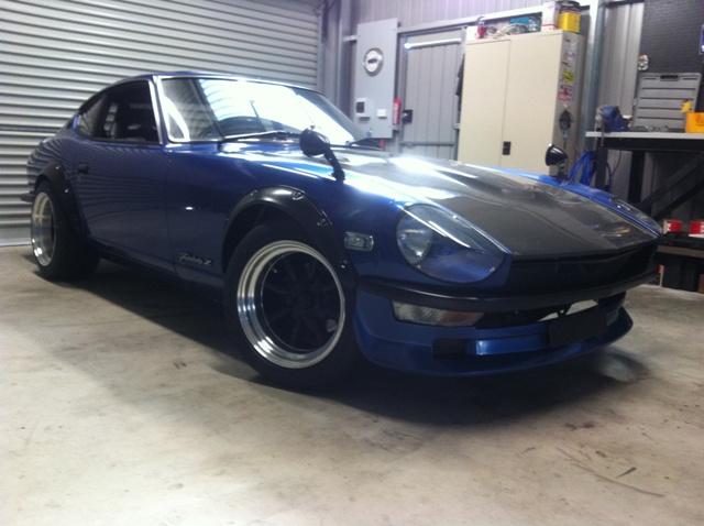

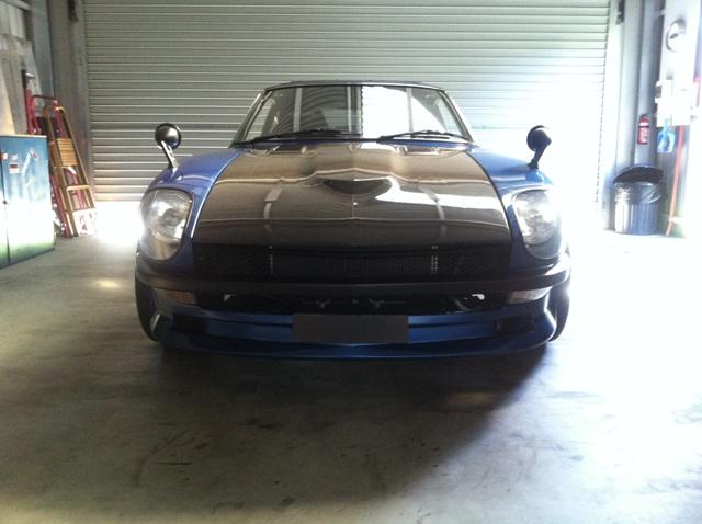

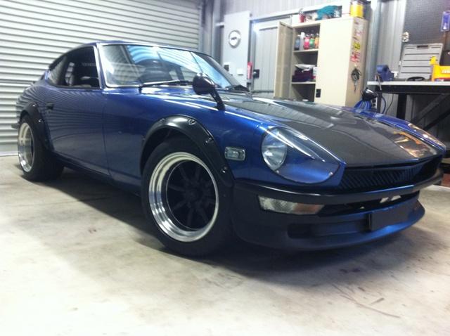

Roberto Posted September 24, 2012 Author Posted September 24, 2012 Still yet to take the zed for a decent spin as the carbon bonnet is flexing too much. I am missing the bonnet bumpers that go along the fender to keep it secure. They have been ordered and won't be long now. I have been debating for a while whether to paint the front spoiler body colour or keep it black. Well, i did finally paint it and am really glad I did. As you can see with before and after pics, it gives it a more completed look. With the fender emblems, the exterior is now complete Quote

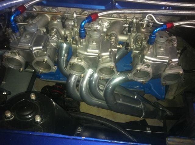

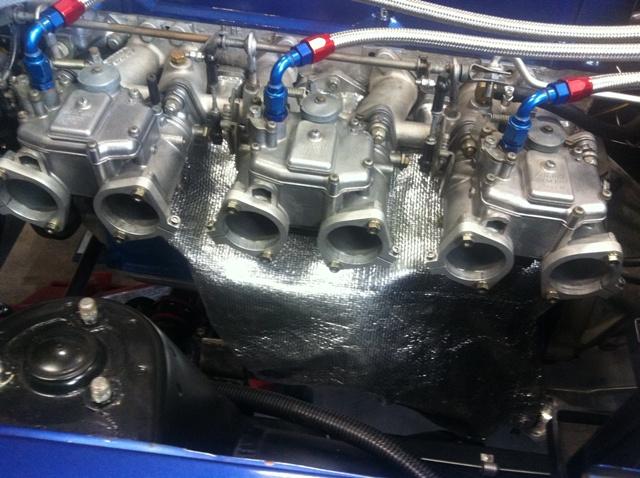

Riceburner Posted October 16, 2012 Posted October 16, 2012 Looks super neat and tidy, not a wire out of place Interesting thing with the heat blanket, I haven't seen that before other than turbos but I bet it's better than the regular shielding. Can you tell us some more info on it? Quote
Administrators gav240z Posted October 16, 2012 Administrators Posted October 16, 2012 Amazing mate, all that work and effort has paid off. We want video footage though I need to see how this thing boogies. Quote
Roberto Posted October 16, 2012 Author Posted October 16, 2012 Interesting thing with the heat blanket, I haven't seen that before other than turbos but I bet it's better than the regular shielding. Can you tell us some more info on it? Hey Gareth. I would have used a steel heat shield, but the SW extractors come out from the block almost horizontally and are very very close to the second carby. Even with the ceramic coating on the extractors, carby 2 would get very hot, more so than the other two. The blanket is great as it is flexible and slips between the mikuni's and the extractors. I was able to get the blanket higher up than a steel heat shield and after driving, all 3 carby's are only warm and equal temperature so it's quite effective as a barrier. Apparently the blanket does not reduce the life of the extractors like header wrap too. I got the blanket from Summit as they did the best price. Quote
