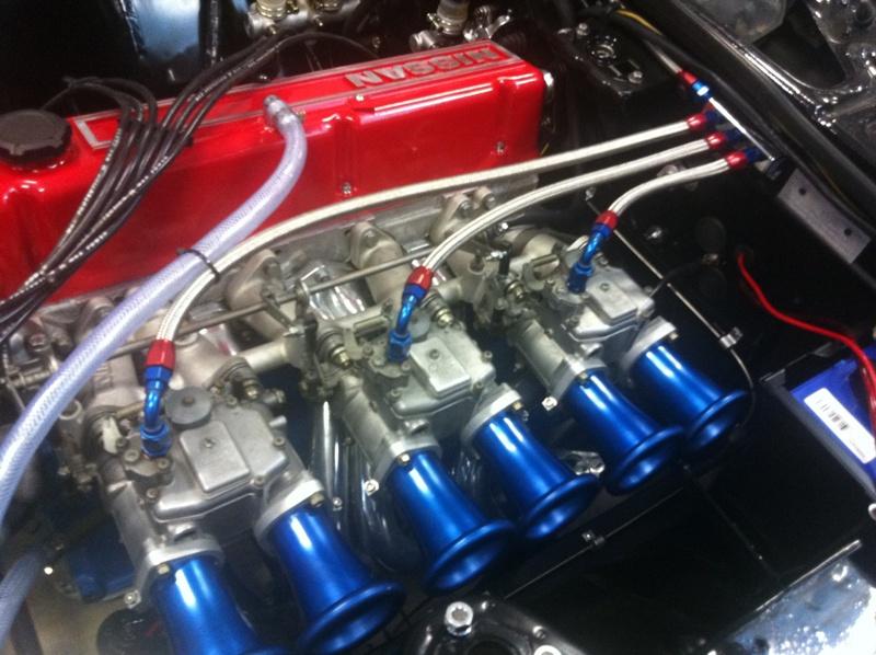

Roberto Posted March 30, 2012 Author Posted March 30, 2012 Fuel lines hooked up. Starter on. A bit of wiring and I will be cranking her up soon. Quote
peter mc Posted March 30, 2012 Posted March 30, 2012 heheheh hurry up there is only 3 wires mate Quote
luvemfast Posted March 30, 2012 Posted March 30, 2012 Looks sooo good man! What are you using as an air filter? Quote
peter mc Posted March 30, 2012 Posted March 30, 2012 uni filters 6 off red in color we may have to cut the trumpets down a bit Quote

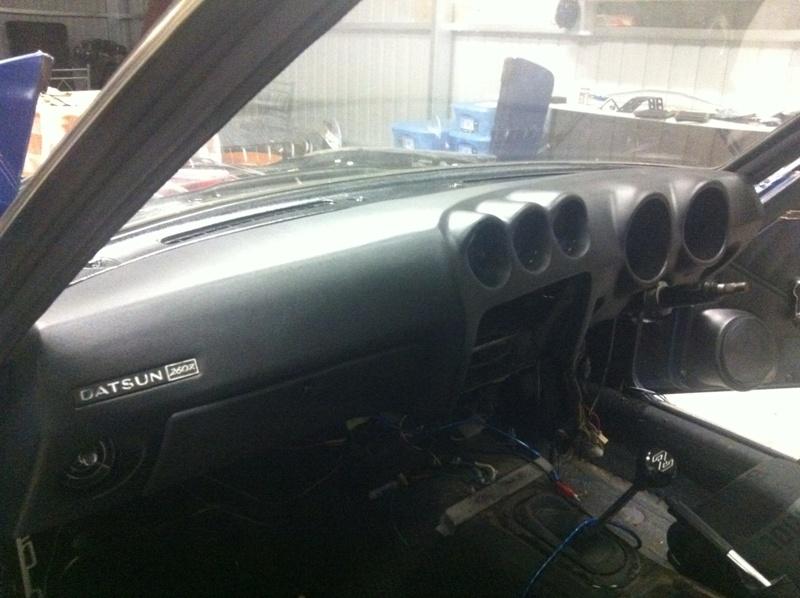

Roberto Posted April 7, 2012 Author Posted April 7, 2012 I spent the whole afternoon mounting the reskinned dash and three centre gauges since I cannot start the new engine without vitals like oil pressure, tacho etc. My goal was to start her this weekend........ Quote

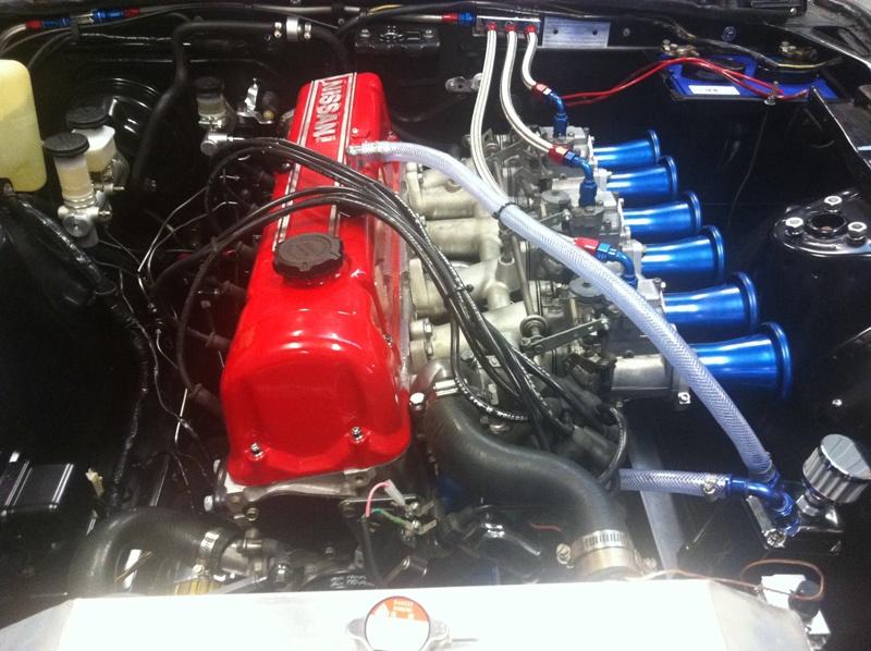

Roberto Posted April 10, 2012 Author Posted April 10, 2012 I fired her up today !! I took some video too. Enjoy! Quote
luvemfast Posted April 10, 2012 Posted April 10, 2012 Way to go Roberto The car is looking great mate! Quote
SS30RR Posted April 10, 2012 Posted April 10, 2012 man that rocker cover is horne!!!! nice. was that hp at the wheels ?? Quote
peter mc Posted April 10, 2012 Posted April 10, 2012 man i love that . turn the key and she lives, what a noise well done mate she looks a treat Quote
TBOWGN Posted April 10, 2012 Posted April 10, 2012 Love the colour combination! Looks great with the black engine bay. Quote
RB30X Posted April 11, 2012 Posted April 11, 2012 Got lump....... Wanna hear one with exhaust bolted up, then a drive by. Well done Quote
Riceburner Posted April 11, 2012 Posted April 11, 2012 Oh the sound, love it! It's come up a treat, well done Roberto Quote

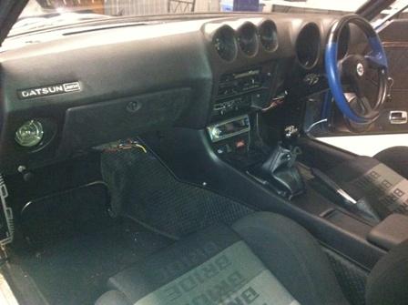

Roberto Posted April 14, 2012 Author Posted April 14, 2012 Thanks for all the support guys. Yes, I will do another video when the exhaust goes on. Might go for 3" as recommended by Peter..... The interior is all completed now with new centre console. I even managed to get my interior lights and glove box light to work too. These haven't worked in years. No such luck with my engine bay inspection light. There is no power going through the lead from the harness. No fuses appear blown. Where do I go from here? :'( Quote
Administrators gav240z Posted April 15, 2012 Administrators Posted April 15, 2012 Amazing how fixing the little things can be so rewarding. Perhaps with engine bay light check for corrosion? What does multi-meter say and what kind of resistance is there? Quote
RB30X Posted April 15, 2012 Posted April 15, 2012 No such luck with my engine bay inspection light. There is no power going through the lead from the harness. No fuses appear blown. Where do I go from here? :'( Use a torch........... Quote
