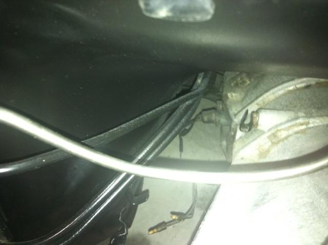

Roberto Posted March 2, 2012 Author Posted March 2, 2012 NEED HELP: I have 2 pairs of wires coming out of the right side of my manual 240K gearbox. I know one pair is for the reverse light. This goes to the engine bay loom. I don't know what the other wires are for and cannot even remember if I had them hooked up. Could this be a feature of a 240K not used in the Zed?? Pics of your Zed in this general area would be very useful. Quote
MaygZ Posted March 2, 2012 Posted March 2, 2012 Roberto, I'm just guessing ('cause I don't know) but did the 240K run an electronic speedo off the box? Or is there a chance that it is part of a pollution control (backed off fuel when 5th was selected). they are the only things I can think of. I hope I have helped. Maygz Quote
Moderators Zedman240® Posted March 2, 2012 Moderators Posted March 2, 2012 It wasn't an auto in a previous life was it? Could be ignition lock out switch? Quote

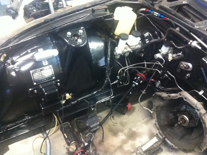

Roberto Posted March 3, 2012 Author Posted March 3, 2012 Thanks boys. I am going to ignore these wires and whatever use a 240K has for them, my Zed won't. Well, everything has been assembled now. The engine will be going in next week. Added some extreme makeover style pics. Quote
Scoota G Posted March 3, 2012 Posted March 3, 2012 NEED HELP: I have 2 pairs of wires coming out of the right side of my manual 240K gearbox. I know one pair is for the reverse light. This goes to the engine bay loom. Could be a nuteral switch. Quote
Roberto Posted March 4, 2012 Author Posted March 4, 2012 240K box??? Yeah Bluerat, long story involving $$$ and lack there of...... Essentially they are the same as the Z box with with slightly taller 1st and 2nd gears. It's very smooth to change gears too. Quote

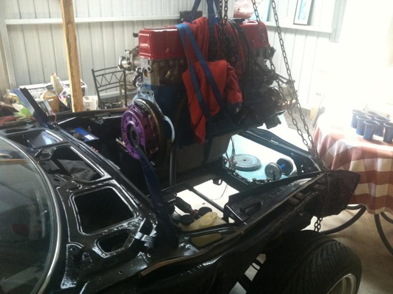

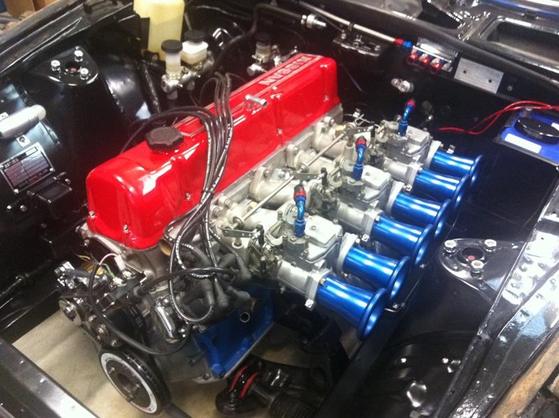

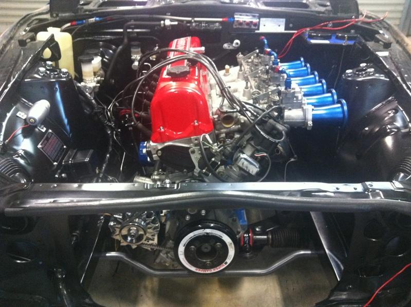

Roberto Posted March 26, 2012 Author Posted March 26, 2012 Well, today was a very special day for me...... With some help from my brother, I managed to drop in the PMC powerplant ! Quote
peter mc Posted March 26, 2012 Posted March 26, 2012 mate it looks great . you will love the sound it makes , i will come for a drive next week Quote

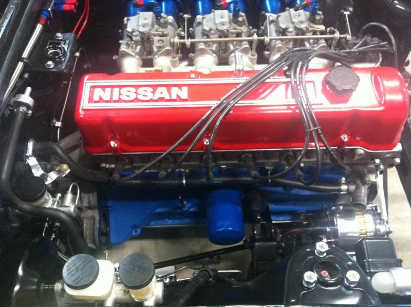

Agno Posted March 26, 2012 Posted March 26, 2012 Great stuff! Vids of when you get it on the road! Also, how did you end up setting up your fuel pump? I'm looking to do something very similar in the next few weeks Quote
RB30X Posted March 26, 2012 Posted March 26, 2012 OMG that look sooo good. I bet youre glad you tidied up the engine bay first. Quote
zzzzed Posted March 26, 2012 Posted March 26, 2012 You should bring it for a drive and come pick up your screw driver Quote
luvemfast Posted March 26, 2012 Posted March 26, 2012 +1 for you doing the engine bay Looks great mate Quote
Riceburner Posted March 26, 2012 Posted March 26, 2012 Nice color scheme. Damn, those trumpets look great! Quote
Roberto Posted March 26, 2012 Author Posted March 26, 2012 Thanks guys. I am glad I spent the time doing this. Lots of fun....... Now to get this engine fired up. With regards to the fuel pump Agno, it's all documented a few pages back in some detail. Essentially, I mounted a Mallory fuel pump near the tank and I am not using the return line. I have forgotten about that screwdriver Mick. You can keep it. A drive to Murray Bridge through the Adelaide Hills is a great idea though....... Quote

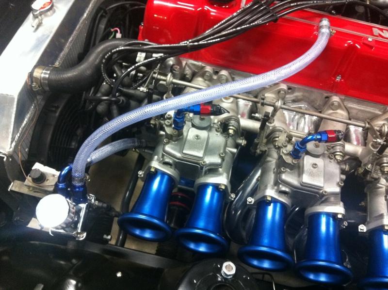

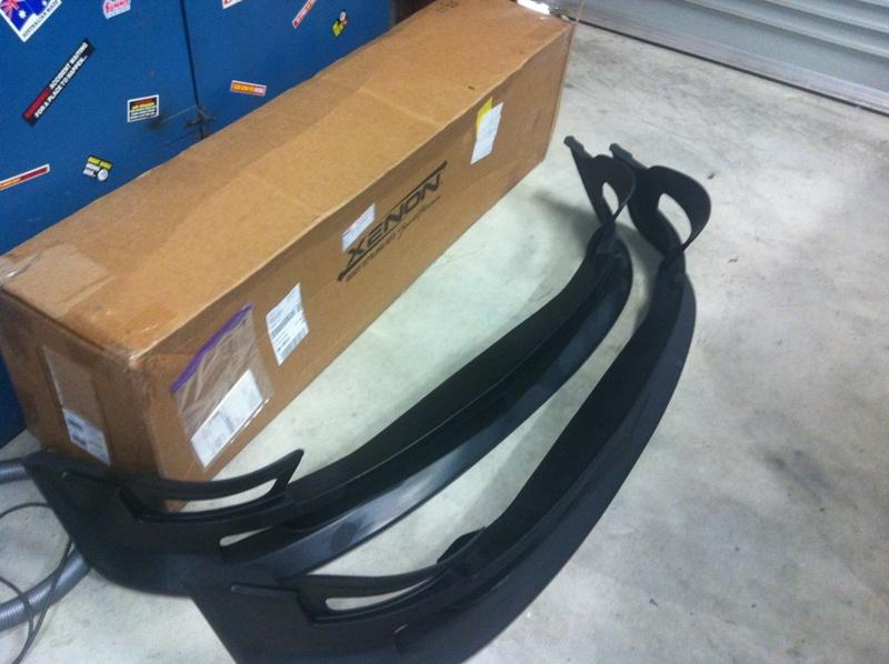

Roberto Posted March 27, 2012 Author Posted March 27, 2012 More progress today..... Radiator mounted and crankcase / rocker cover breather plumbed to vented catch can. Also new polyurethane front spoiler(s) up front. Quote
garvice Posted March 27, 2012 Posted March 27, 2012 Looking good mate. How is the clear tubing to the breather going to handle the pressure/vacuum? Always seen vacuum or pressure hose used but never thought about whether it was actually required. P.S. So your car is going to have a double chin hey? Quote
Roberto Posted March 27, 2012 Author Posted March 27, 2012 Looking good mate. How is the clear tubing to the breather going to handle the pressure/vacuum? Always seen vacuum or pressure hose used but never thought about whether it was actually required. P.S. So your car is going to have a double chin hey? There will be virtually no pressure build up in the clear tubing as it is vented to the atmosphere. I could have used black rubber tubing and if i don't like the look of it in the end, it's easy to change. Double chin, hehe. Postage from the US was identical if I bought one or two of these spoilers, so I did the logical thing. Quote
MaygZ Posted March 27, 2012 Posted March 27, 2012 Postage from the US was identical if I bought one or two of these spoilers, so I did the logical thing. Which leads to he obvious questions? what are you doing with the other one? AND How much do you want for it? (have I mentioned how much I just LOVE Adelaide? South Australians are the finest people in the world. ) Quote
