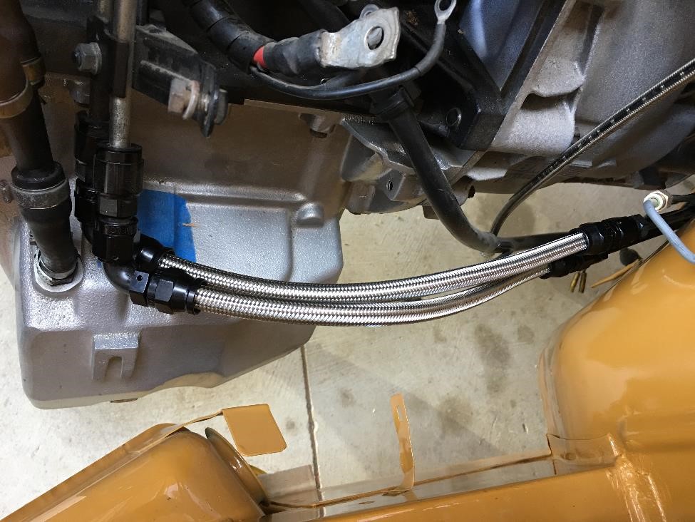

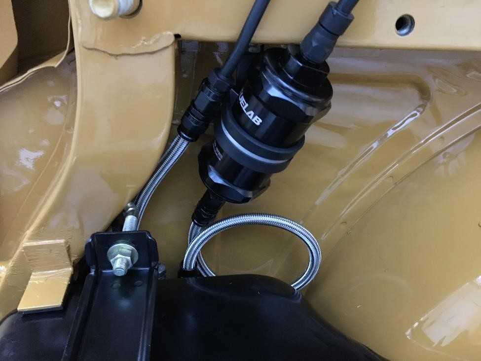

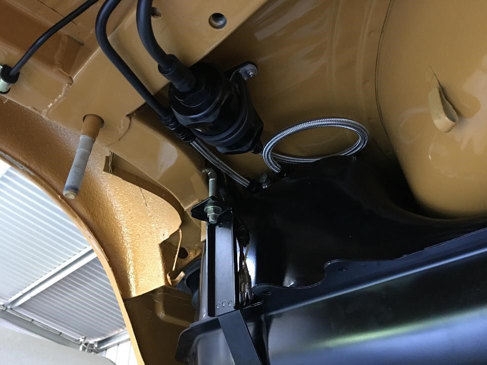

KatoKid Posted January 4, 2017 Author Posted January 4, 2017 Well the lead up to Christmas was hectic for work as well as family so I didn't get much accomplished on the project......but happy to say the fuel system is completed, wiring, installation of fuel module and tank, filter, hard lines and braided lines at each end. I went with a bigger Fuelabs filter which necessitated a new bracket and I had to put a loop in the braided line as it was too short to run direct to the pump outlet on the module. Braided lines at the engine bay end were easy enough but when I pressurized the system I found the slightest weep on the AN flare side (not the side where I made the fitting to hose joint). I undid this and gave the male end a clean up with some fine wet and dry and it looks to have fixed it. All the other connections are dry which makes me happy. Quote

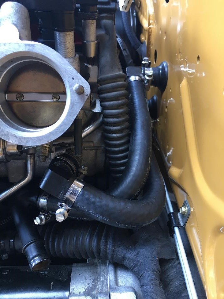

KatoKid Posted January 4, 2017 Author Posted January 4, 2017 Got the heater hoses finished. Not very factory or elegant but given the space constraints it came up alright and will be reliable. Quote

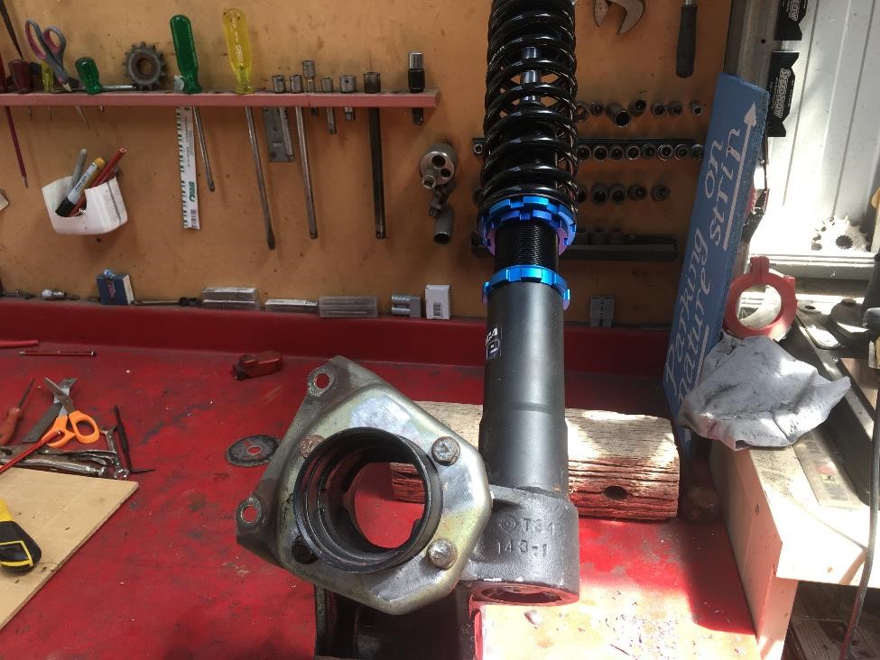

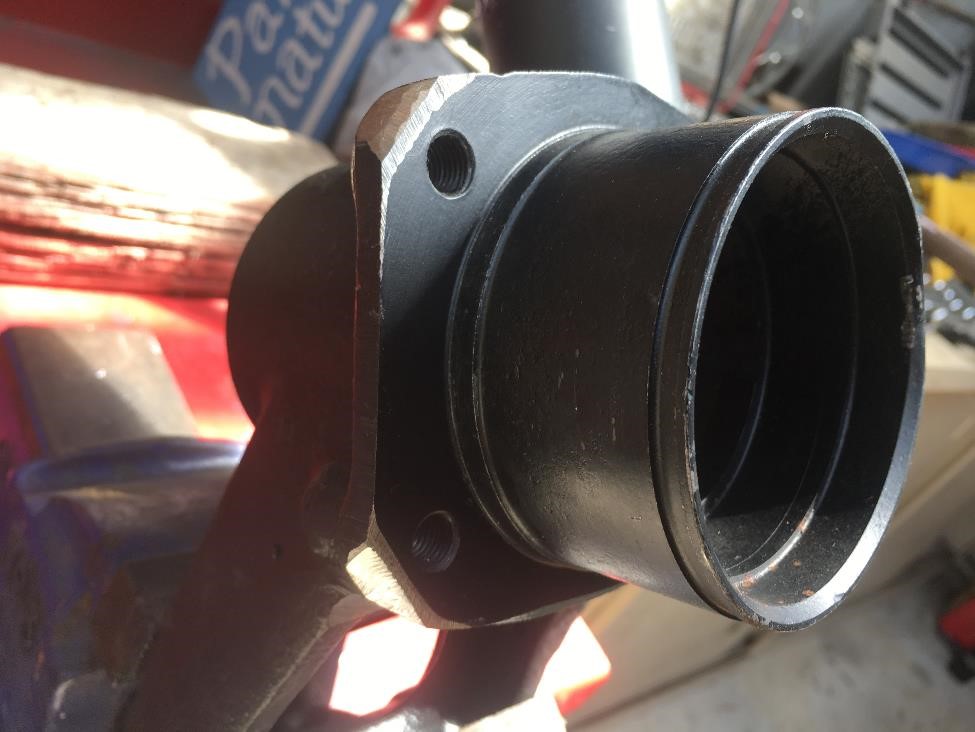

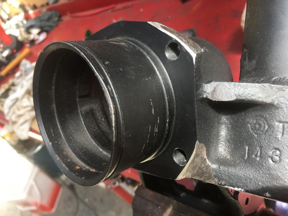

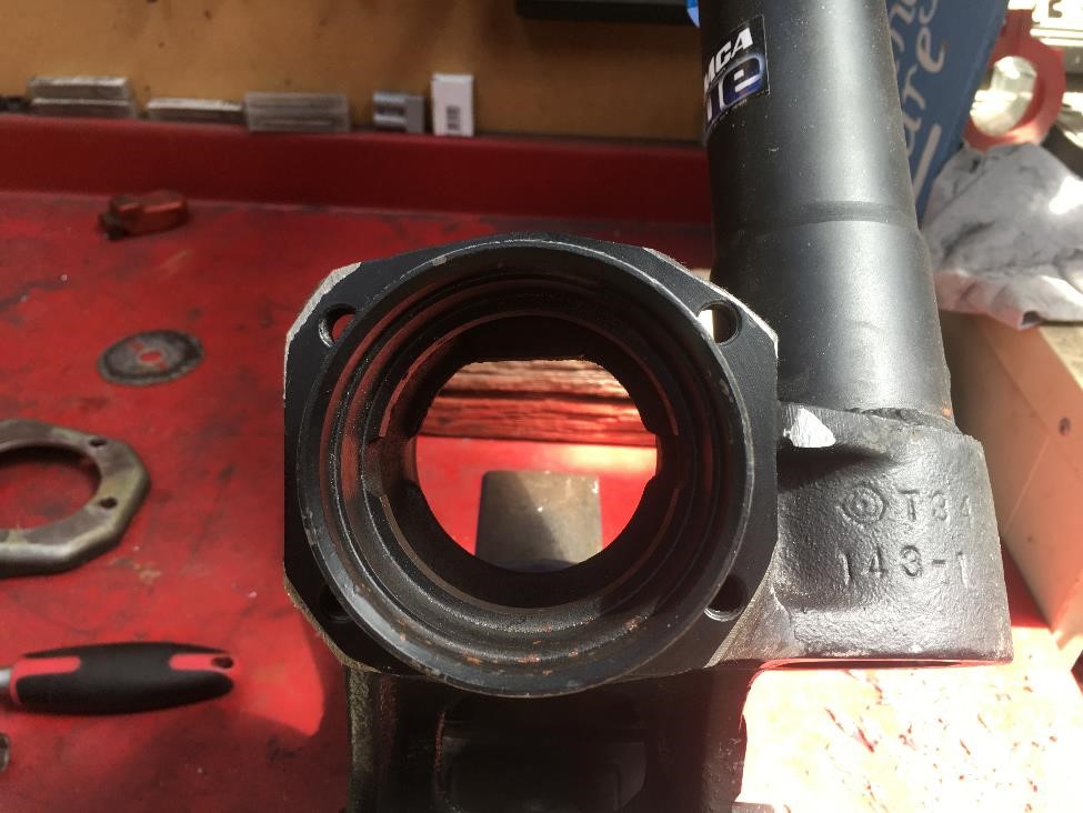

KatoKid Posted January 10, 2017 Author Posted January 10, 2017 Moving on to other things.....I'm going to use the dreaded R31 rear calipers and have followed Scoota's updates and recommendations http://www.viczcar.com/forum/topic/7330-tutorial-r31-skyline-rear-disc-conversion-for-240260z-new-300mm-rotor-conversion-sep2016/ I filled and finished the original mounting holes in the brackets and had an engineering shop machine the bore of the caliper brackets as required. No offence to Scoota (Mark) but I didn't want to risk the engineer knocking back the significantly modified brackets so I've elected to leave them pretty well untouched and have ground areas of the hub casting to get the brackets to fit and to rotate upwards as much as possible from the normal 3:00 o'clock position as per Mark's suggestions, hopefully this will be enough! Grinding the hub casting was pretty easy and didn't take long.....probably easier than modifying the brackets. Quote
