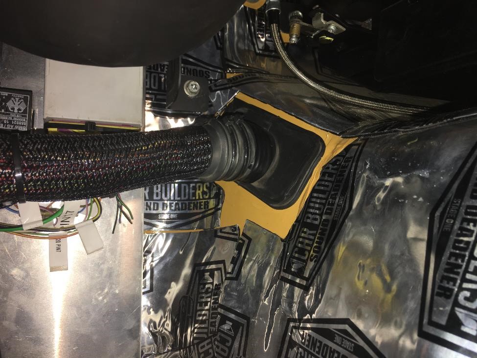

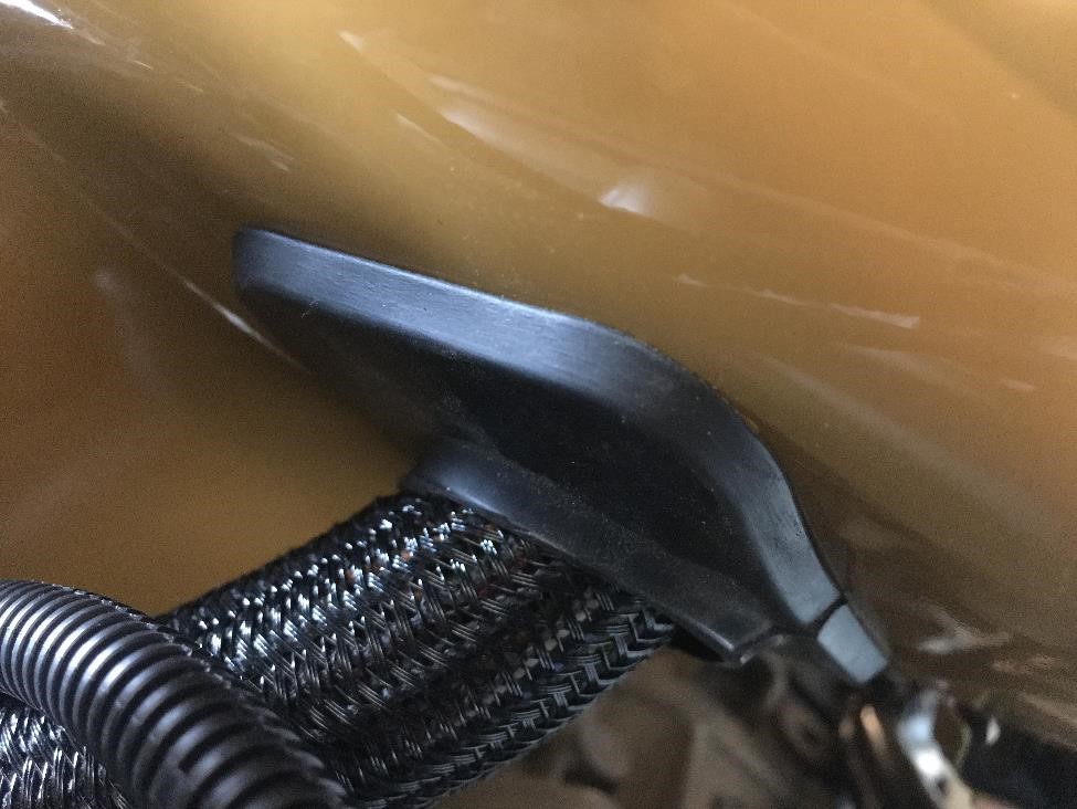

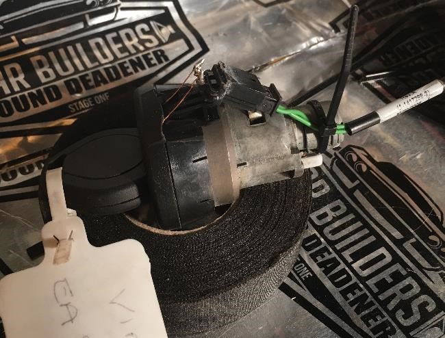

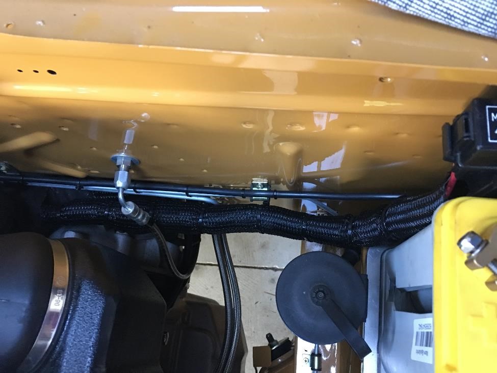

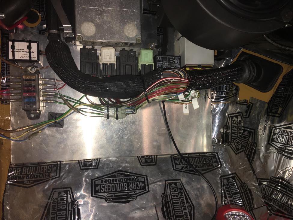

KatoKid Posted May 28, 2017 Author Posted May 28, 2017 I've been child minding all weekend so nothing significant done. Had a couple of wiring tidy up jobs to still complete and used this https://www.techflex.com/prod_f6n.asp Its dear as poison but was great for wrapping the really bulky main power and earth from the battery and also the massive spaghetti loom for the ECU and relays into the cabin. Easy to use and looks really good. Now I'm confident its not coming apart again I also installed the large rubber grommet to seal the main ECU and relay harness. Took a long time to find a grommet that would be big enough and the right shape to enable passing the ECU plug and relays through the tunnel to the engine bay without de-pining the whole lot. Happy with the way it fits and seals well. Cabin and engine bay side: And after all this the car wouldn't start. Powered up and fuel pump but no starter....grrrrrr. Started checking everything and pretty quickly realized that I had been a bit rough with the antenna ring on the BMW key and had pulled the wires out of the loop. Manged to break the plastic housing open, get access to the loop and re-solder and the car started straight up. Will need to get another antenna ring though. Antenna ring picks up the code that is stored in the key which confirms the correct key and allows starting. Quote

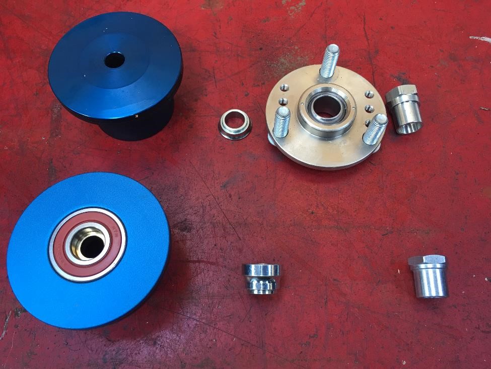

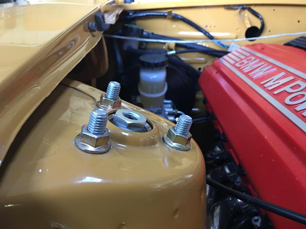

KatoKid Posted June 12, 2017 Author Posted June 12, 2017 Josh from MCA sent down some "hardware" to space down the strut shaft. Hardware consisted of a new top spring perch with a bearing and a new thicker spacer to go under the pillow ball and a new thinner retaining nut on the top side. I had to wind the shock body down into the lower tube 10mm to compensate but otherwise it was an easy enough job. Adjuster cant be retain but no big deal to keep one in the glove-box and use it as required. Quote
CBR Jeff Posted June 12, 2017 Posted June 12, 2017 That looks better Dave. Lucky you are dealing with a local company who care about their customers. Might pay a bit more but you get better results and a product that does what you want it to. Jeff Quote
luvemfast Posted June 12, 2017 Posted June 12, 2017 Are you going to fit a strut brace? Otherwise, those studs are a tad long. Yep. That's how picky we are being with your build now........ You should blame yourself really, for setting the bar so high! Quote
KatoKid Posted June 12, 2017 Author Posted June 12, 2017 Yep, good support for sure Jeff. Undecided on strut brace as yet Simon......decisions more for when its registered and on the road Quote
KatoKid Posted June 13, 2017 Author Posted June 13, 2017 Bit of an update.... The replacement top spring perch has a bearing compared to the original one without. I asked Josh why the change and his response: Main reason for replacing the top one with a bearing was to absorb some more top peg shaft so that it didn't poke through, and at the same time provide you with an upgrade. Basically the bearing helps the spring not get compressed when turning the steering wheel which can create a noise sometimes when it springs back. Quote
260DET Posted June 13, 2017 Posted June 13, 2017 All coilover struts should have a thrust bearing at the top just like OE. The monoballs commonly used are good for aligning the tops with the strut but should not be solely relied on to take the vertical load for several reasons. Quote

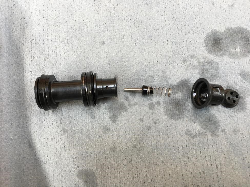

KatoKid Posted July 18, 2017 Author Posted July 18, 2017 (edited) Wheel studs are all done and hubs reassembled, perfect fit and length for what I want. A couple of weeks ago I came out to the shed and there was a puddle of fluid under the front of the car. Investigation revealed it was brake fluid leaking from a port between the front and rear outlets on the side of the brake MC. Google searches confirmed this leak is common for this type of MC when they have an internal leak. Checking confirmed that a new MC from Nissan was >$700. With no non genuine alternatives available I went the local brake shop who said that re-sleeving for $220 was the best alternative. They've always done good work so I was happy to leave it with them. And picked up a few days later. Once the wheel studs and hubs were back together it was time to refit the MC and bleed the brakes again, first time I did this it was a breeze, as easy as any bleed I've ever done but this time I couldn't get any fluid to pump to the rear brakes. After much mucking around and brake fluid usage I relented and pulled the MC from the car and tried to bleed it on the bench...still no luck. The front bled fine but each type I stroked the rear reservoir would result in bubbles and an increase in the level of fluid.........definitely something not right here. Being a Sunday I wasn't prepared to wait until Monday to return it to the brake shop so I pulled it apart and it was pretty apparent what was wrong, they had reassembled the piston for the rear system incorrectly and had put the spring on the wrong side of the return/check valve: How it should be: Not happy Jan! Anyway, put it all back together and it bled fine. Went an fronted the brake shop yesterday and showed them pictures.....they sort of apologized but not with much conviction. On to some good news.....I've allowed myself one piece of bling on this car and picked it up from Freddy yesterday: Edited July 18, 2017 by KatoKid Rickers, theremm, Ponyo240z and 1 other 4 Quote

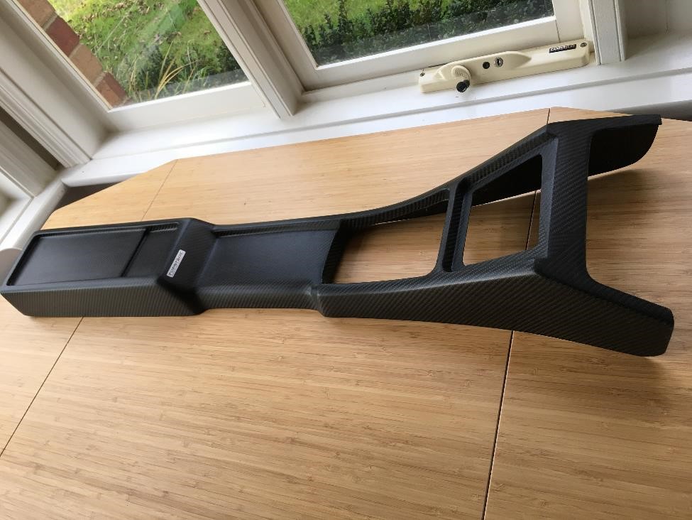

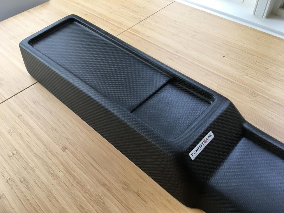

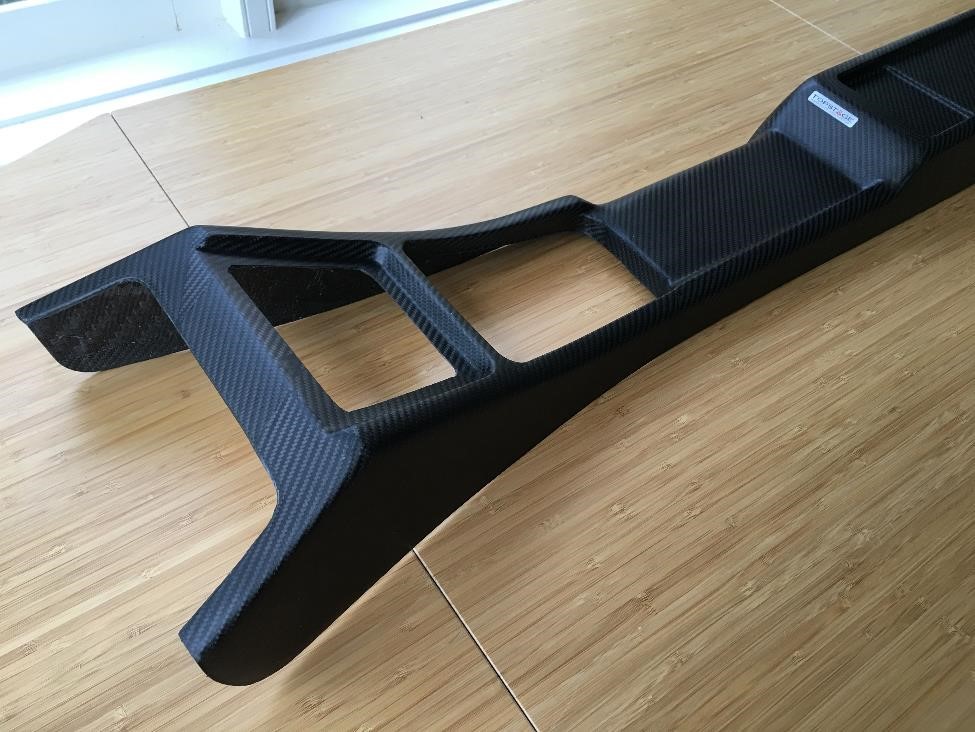

CBR Jeff Posted July 18, 2017 Posted July 18, 2017 Dave that console is a very sexy bit of kit.......... I have been looking at my battered old console contemplating what to do with it. I think I know what to do now, thanks. I don't get your thought that you only have one piece of bling for the project. I have seen may bits starting with the BMW bit ;-). Jeff Quote
KatoKid Posted July 18, 2017 Author Posted July 18, 2017 Yep, deliberated over consoles for a while as repaired or standard reproductions just weren't doing it for me. Very happy with the decision. Quote
dat240z Posted July 19, 2017 Posted July 19, 2017 I'm in love with that console. Special order? I couldn't see it on their website Quote
KatoKid Posted July 19, 2017 Author Posted July 19, 2017 I'm in love with that console. Special order? I couldn't see it on their website Yep, but email Freddy and he will do one for you. He stopped them for a while to make some alterations. I haven't tried fitting mine as yet but it will require making some brackets which is no big deal as they are quite different to the standard 240Z console, more of a 240/260 mash up. Quote

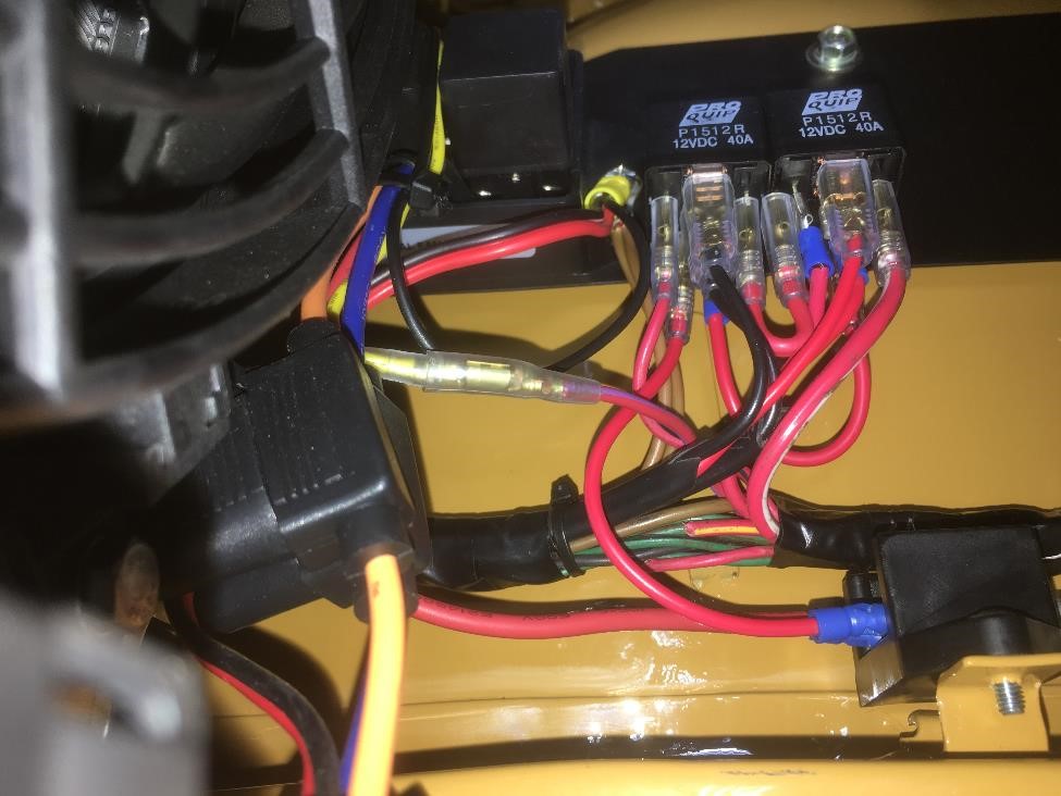

KatoKid Posted July 22, 2017 Author Posted July 22, 2017 I bought my Landcruiser OEM headlights a couple of weeks ago so thought I shouldn't put off the inevitable and install relays. My headlight switch shows signs of overheating but still works fine so figure this is a must do. I had already run a big fat power wire direct from the battery to the back side of the RH radiator support panel (through an 80 amp fusible link) to provide power for my fans and controller so it was simply a matter of taping into this power source and wiring just like any other headlight relay....right......no! Didn't take long to realize that Mr. Datsun had decided to wire his headlights different to most others. I've learnt that you are better off to consult Mr. Google sooner than later and avoid bashing ones head against the proverbial wall and one of the first hits was this thread http://www.viczcar.com/forum/topic/8756-headlight-wires-mystery-relay-upgrade/. Good old Viczcar comes to the rescue again! Anyway, followed Benny's diagram and had no issues at all. Lights are much brighter than the pale yellow they put out before. Tick another task off the list. Quote
