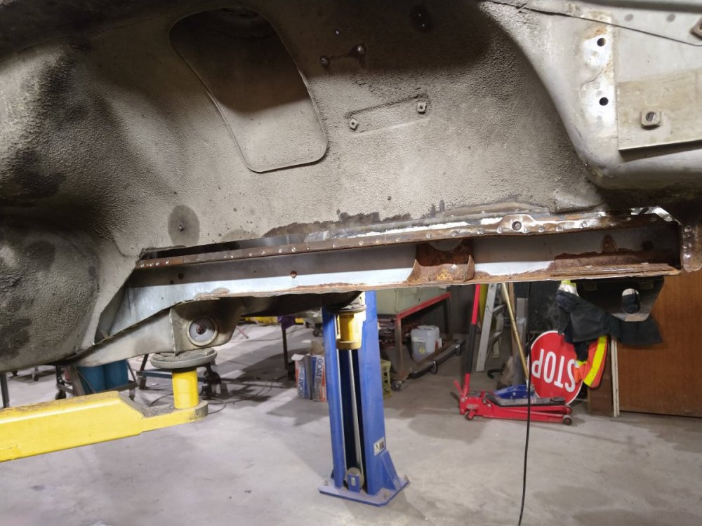

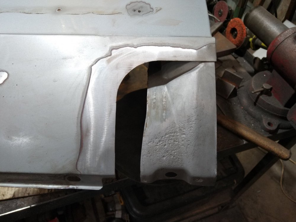

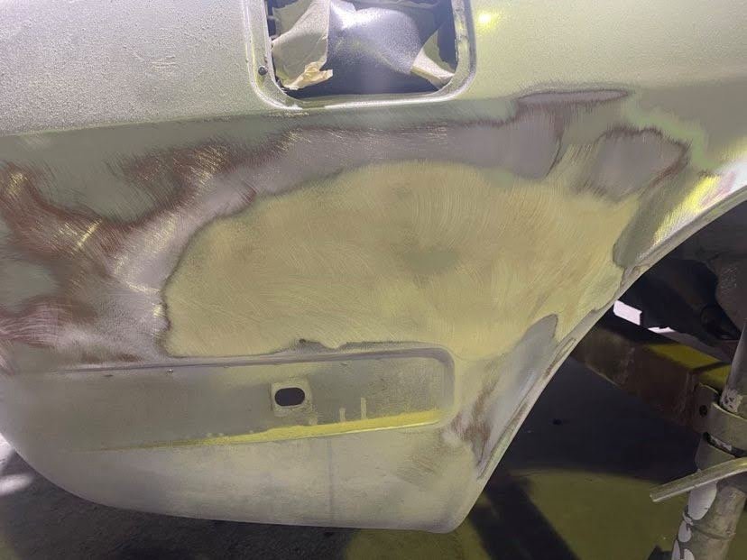

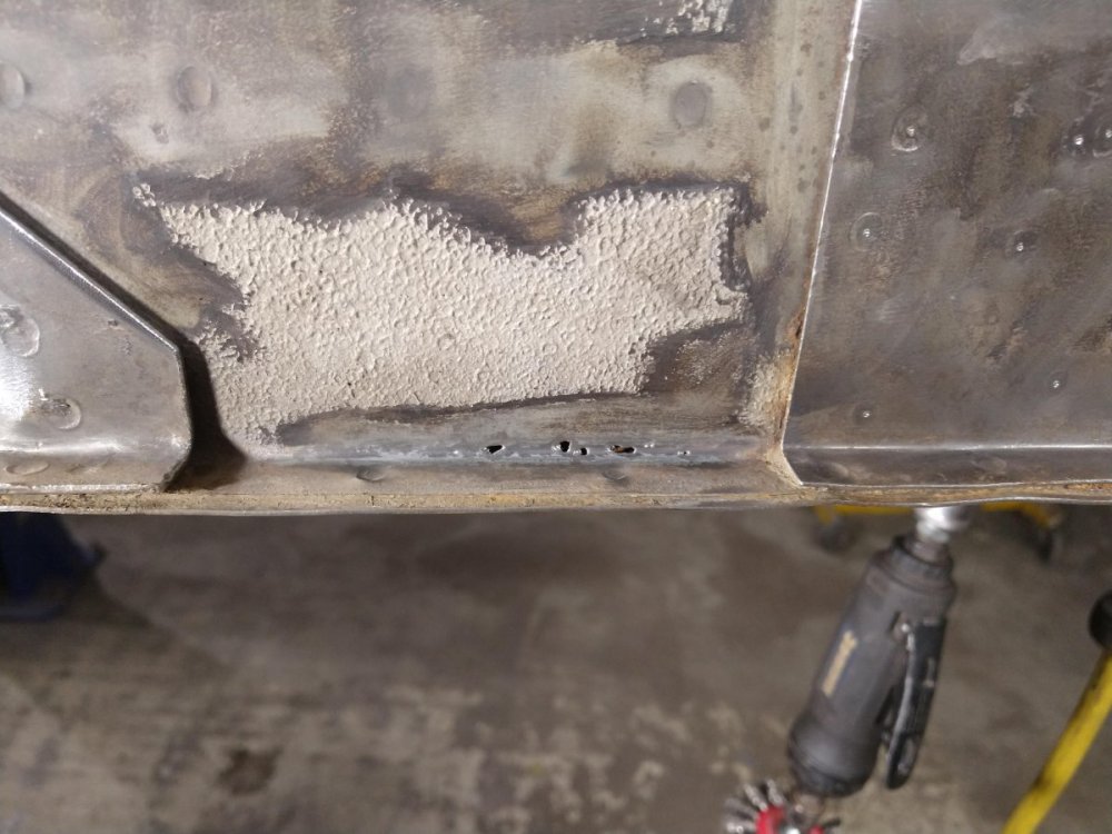

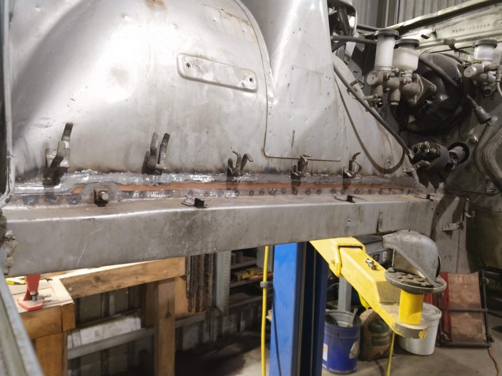

C.A.R. Posted August 20, 2020 Author Posted August 20, 2020 (edited) LH side competed, I new the RH was going to be similar... And it was. So rinse and repeat - cut out the skirt, media blast, paint on the KBS, fabricate new skirt panel, weld in place, then linish and panel beat smoooooth : Edited December 30, 2020 by C.A.F. OdinZ 1 Quote

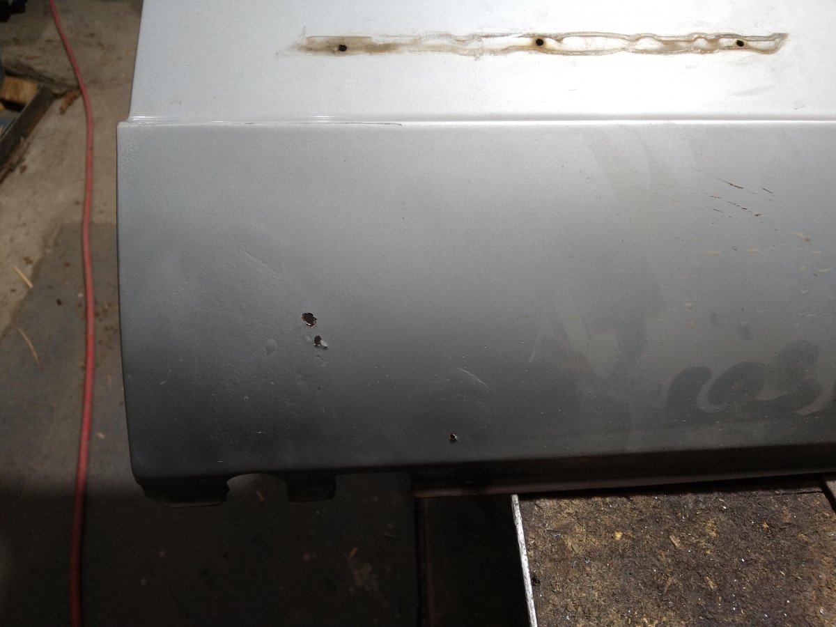

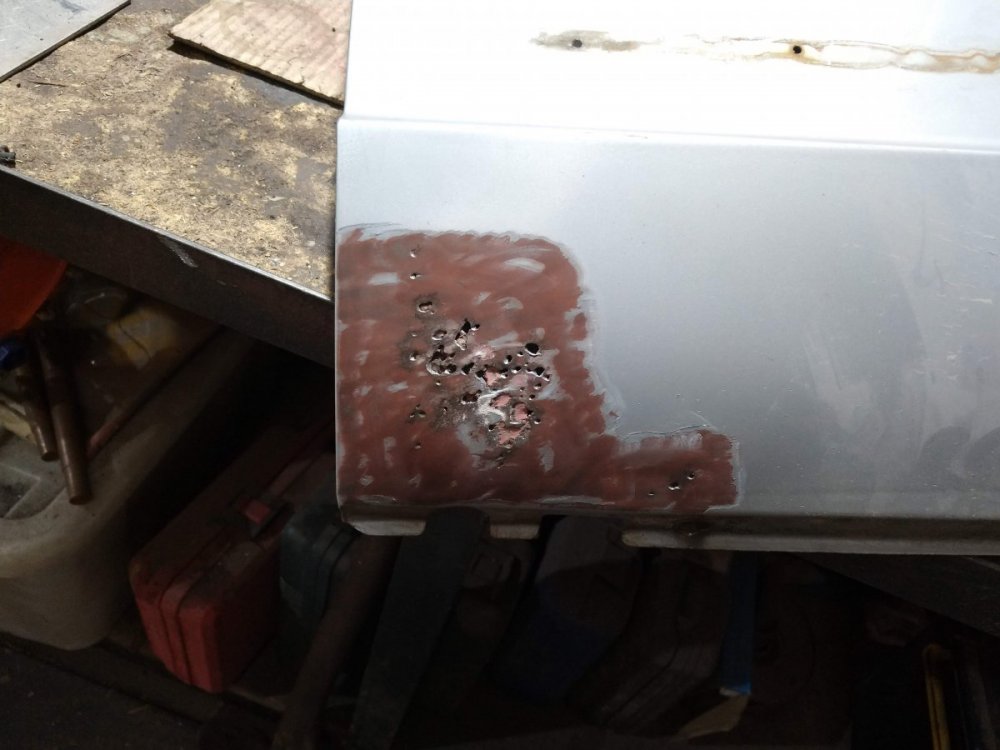

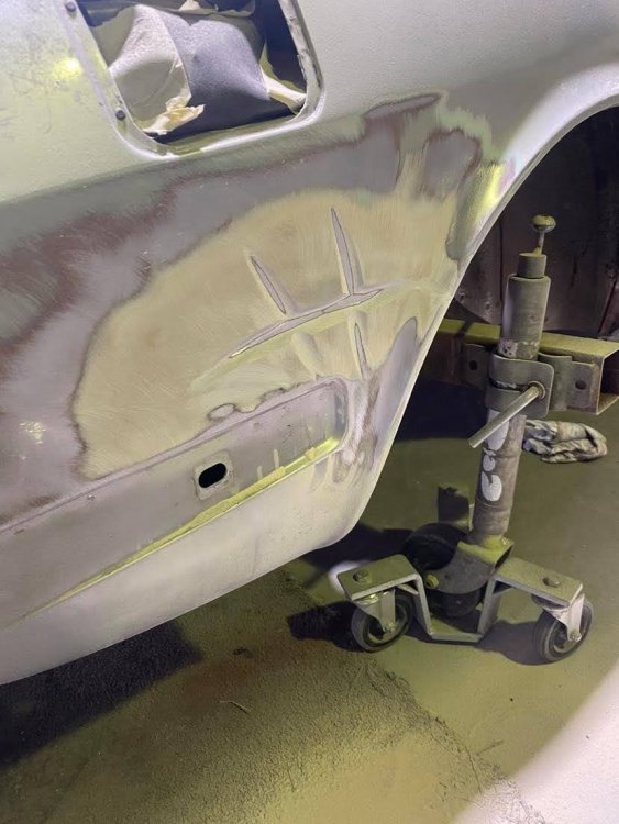

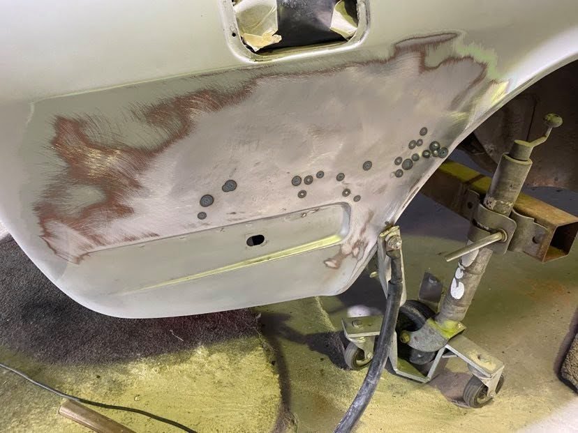

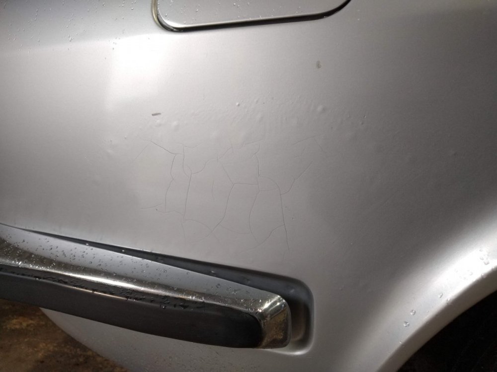

C.A.R. Posted August 20, 2020 Author Posted August 20, 2020 (edited) So I was hoping I was done, but no... When the Z arrived I noticed the RH rear 1/4 below had some serious paint issues going on: So I started digging into it and found a very poor previous accident repair. At LEAST 10mm or filler had been applied to the dent, with NO Epoxy under the paint to seal it - twas no wonder the filler had let go and was blistering... Out with the dent puller to pull the panel back into shape: Edited December 30, 2020 by C.A.F. RAP260, gav240z and OdinZ 3 Quote

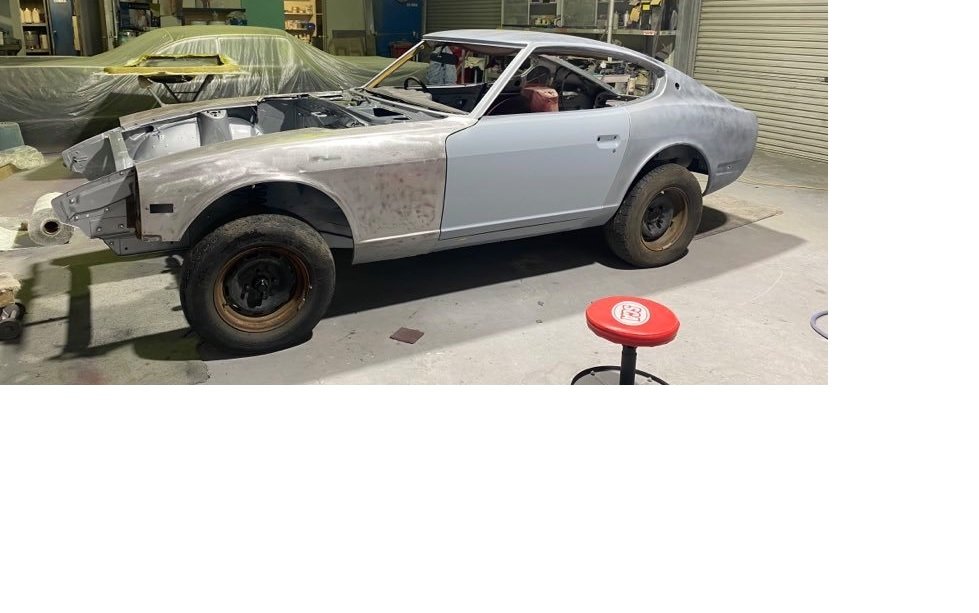

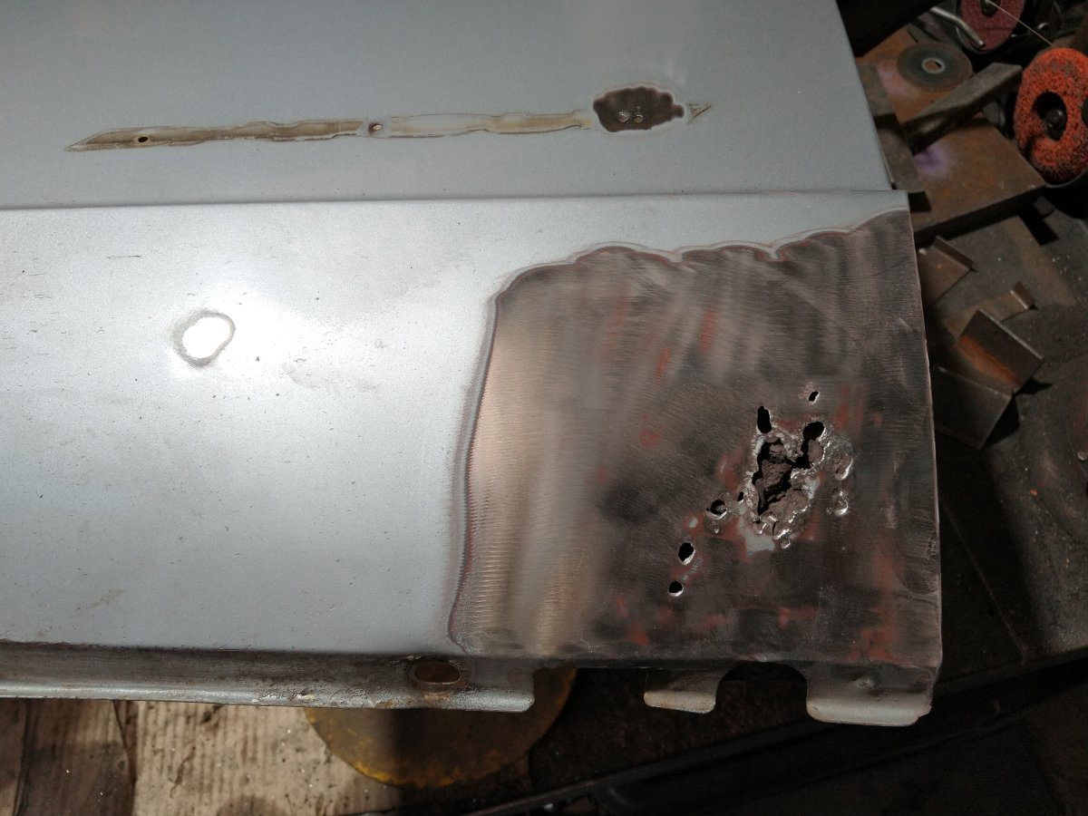

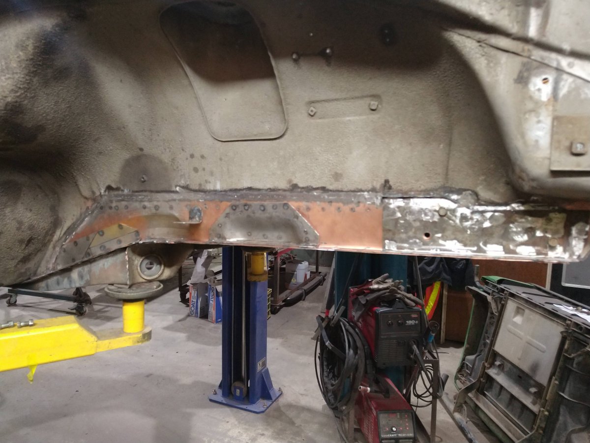

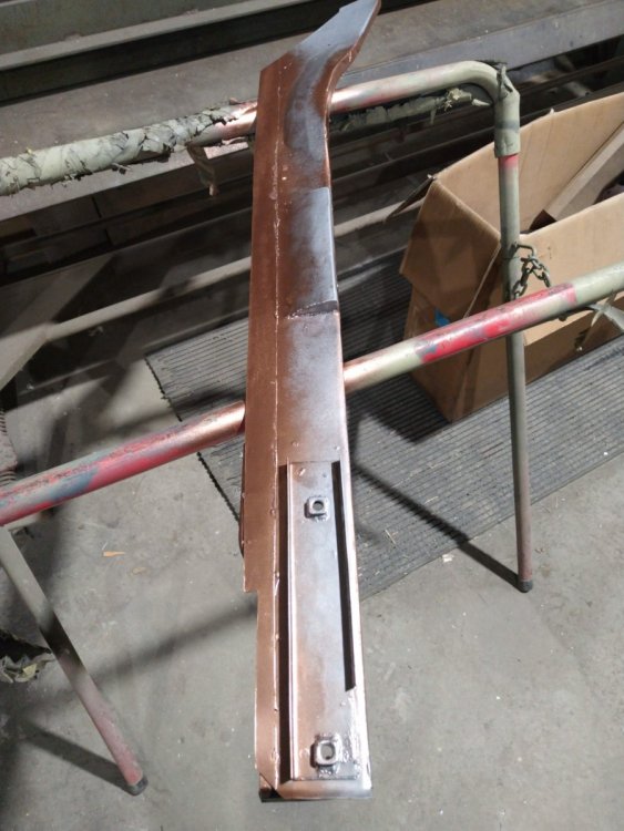

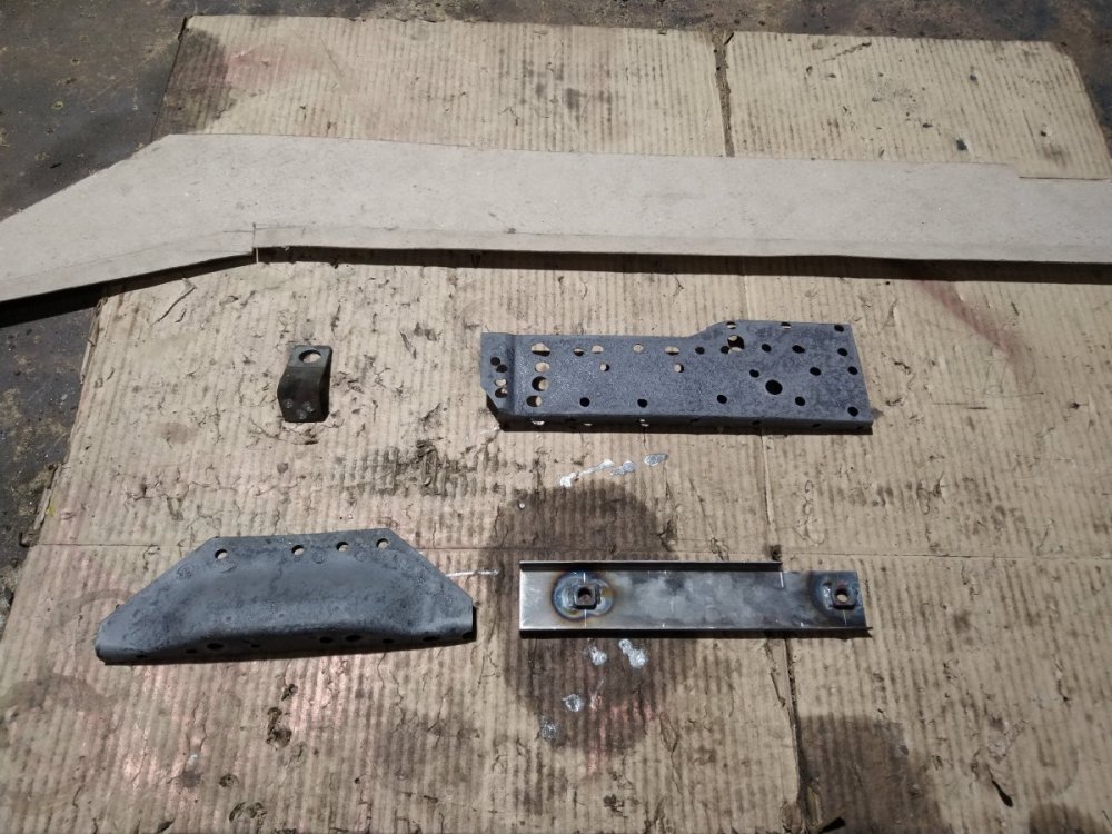

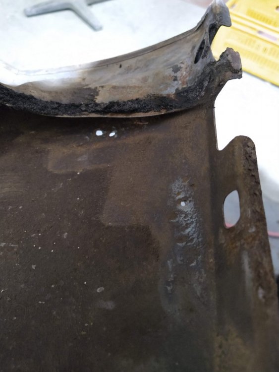

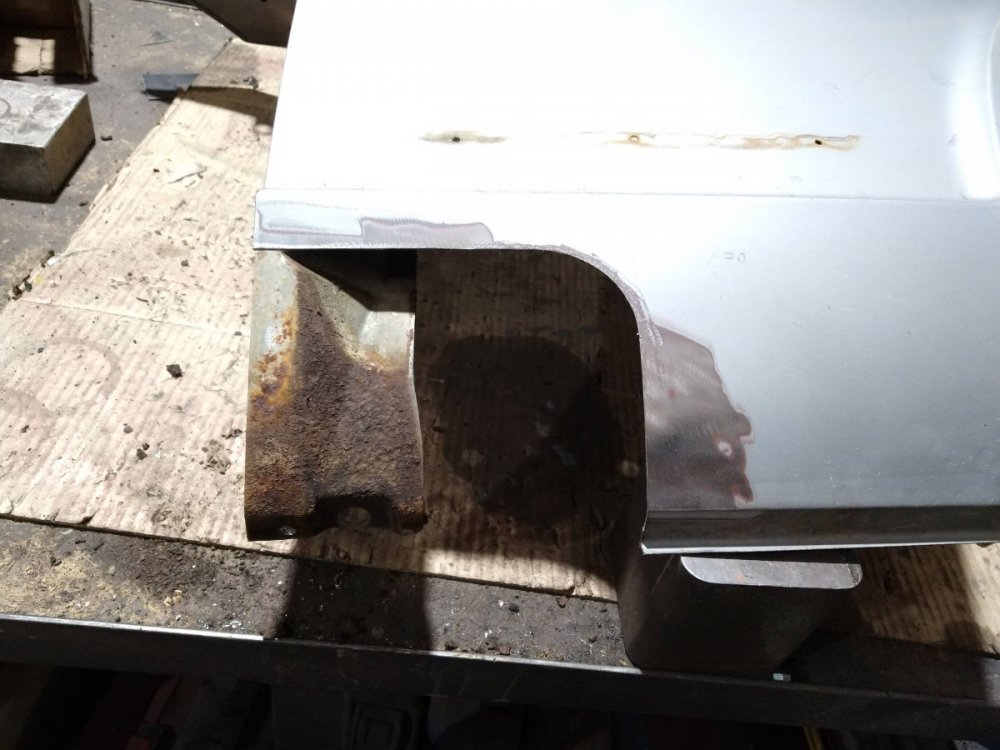

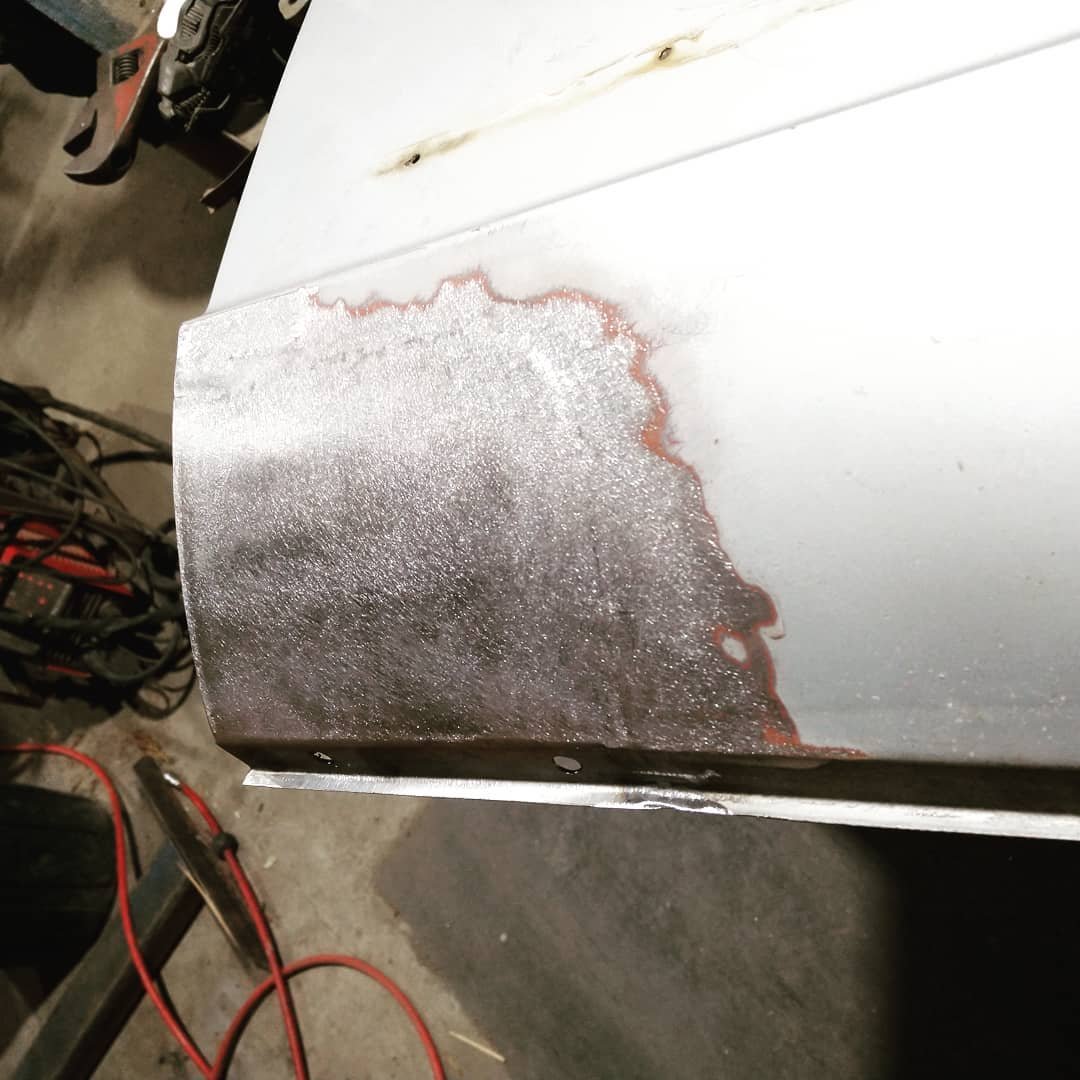

C.A.R. Posted August 20, 2020 Author Posted August 20, 2020 (edited) With the body finally(!) done, I installed it onto the dolly (that I borrowed off Gav): Then I decided I better take a look at the guards, doors and hatch... Hatch was perfect. The doors were sound, but had some unsightly surface rust on the inside, so I sanded, rust converted, then KBS'd the inside of them. Guards... Well they weren't happy. The top mounting tab that is hidden under the scuttle panel was - rather oddly - rusted though on both, so I refabricated those sections, cut the old ones off and rewelded the new one into position. (For some reason I didn't get a photo of the repairs). Then I had a look at the lower guard sections - yep there was bog: Nothing else to do but cut it out, fabricate a new section and weld it in: Rinse and repeat on the LH Side: (Finished photo missing :\ ) Edited December 30, 2020 by C.A.F. KatoKid, AndBir, Bruce and 3 others 6 Quote

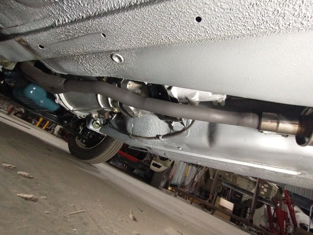

C.A.R. Posted August 21, 2020 Author Posted August 21, 2020 (edited) Finally... Into the paint shop! The body was rubbed back and was given a coat of Epoxy, then Primer. And then the colour went on in the engine bay, door jambs and the underbody was blown in, in 901 Silver: Then the scuttle gray and radiator black was applied: Edited December 30, 2020 by C.A.F. 260DET, KatoKid, RAP260 and 5 others 8 Quote

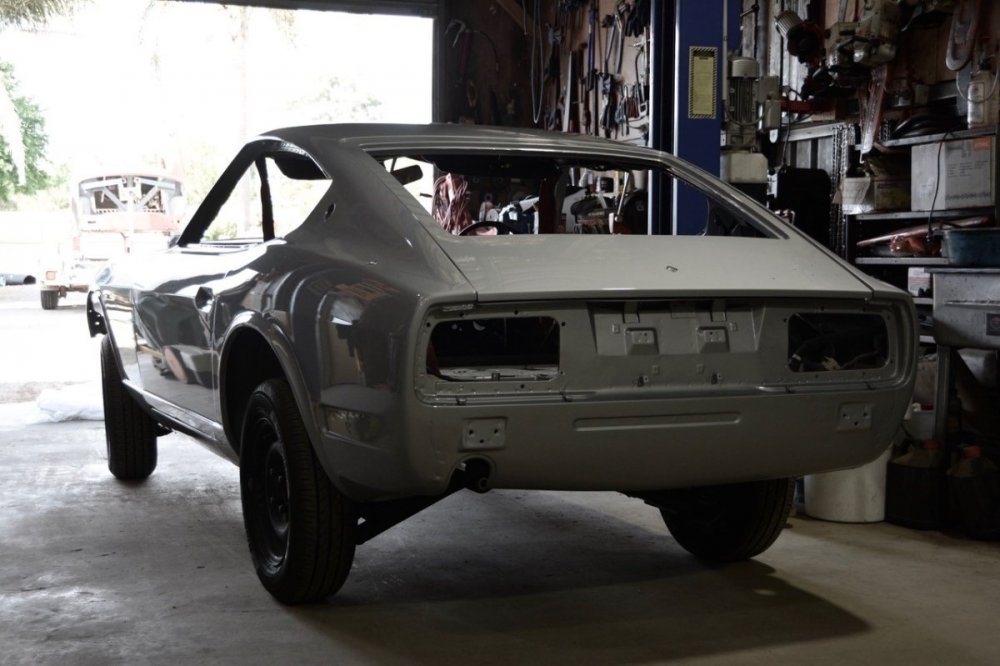

C.A.R. Posted August 24, 2020 Author Posted August 24, 2020 (edited) Painted suspension went back in, along with some spare wheels to make it mobile. Primed doors were fitted and the guards went back on to tap out the parking dents and get the gaps just that bit nicer... ...and that's where are up to for the moment. Until the COVID lockdown is lifted on the 15th of September here in Melbourne, we can't get it into the booth Edited December 30, 2020 by C.A.F. RAP260, henz, OdinZ and 1 other 4 Quote

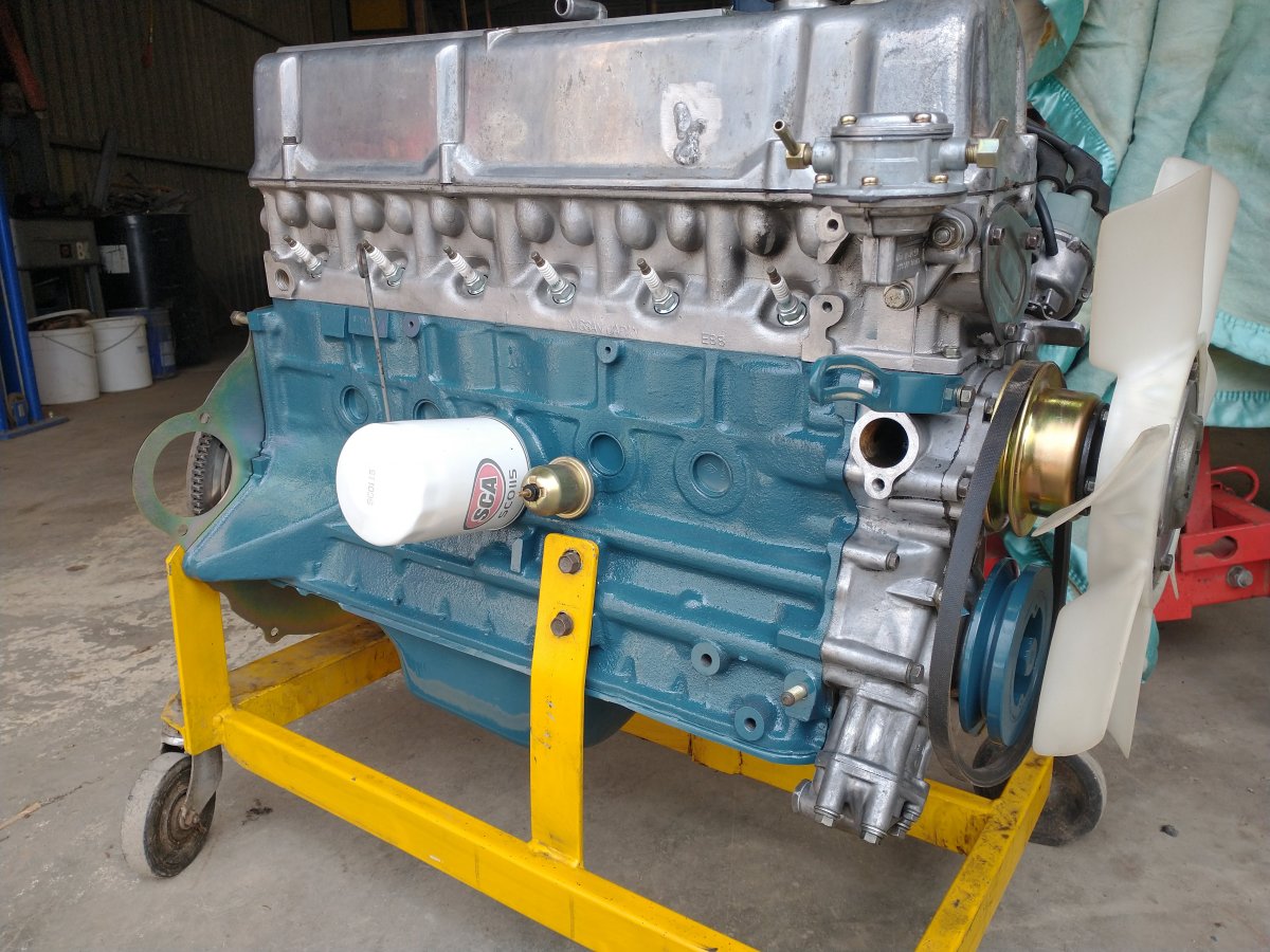

C.A.R. Posted October 5, 2020 Author Posted October 5, 2020 We are still waiting for restrictions to lift so we can get this into paint - hopefully in the next fortnight. However we've been doing what we can - mostly getting everything ready for when the body is painted. The engine got the once over; a coat of jam and some replated components. Tappet cover is going off for HydraJet blasting along with a few other Alum. items. OdinZ and gav240z 2 Quote
