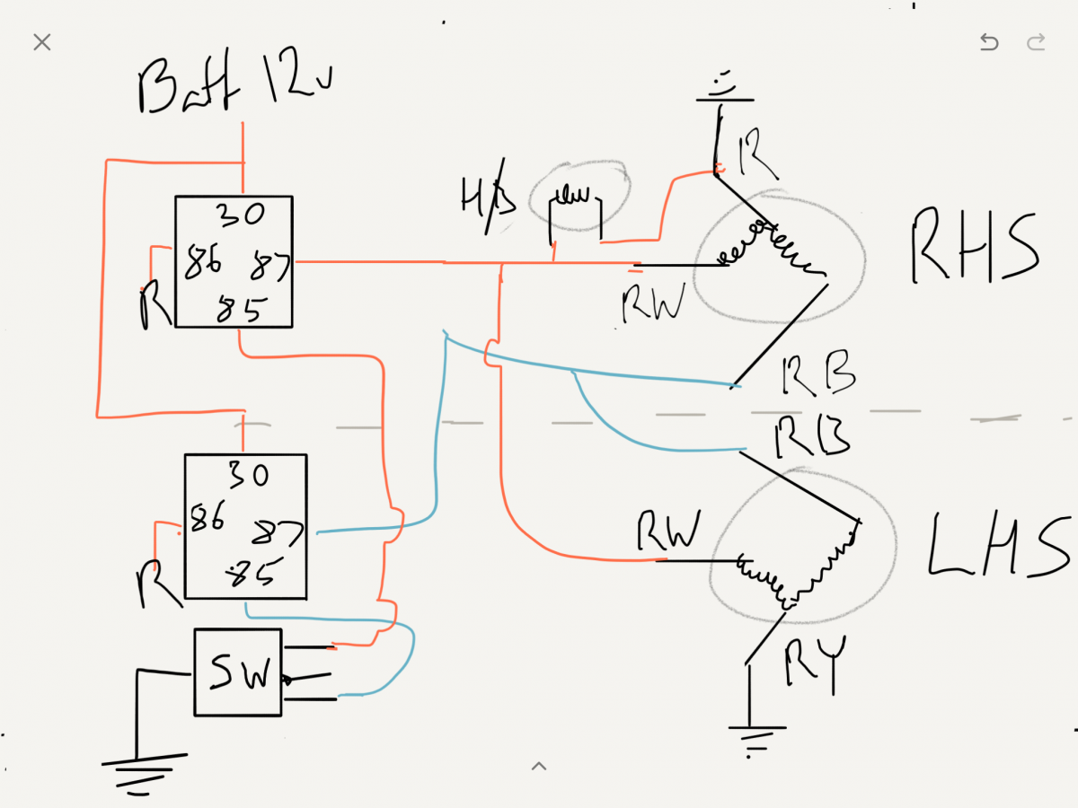

RLY240 Posted March 26, 2019 Posted March 26, 2019 At the risk of confusing or contradicting myself, I believe the wiring is in line with below. I have 2 x 240z one later than the other and the later was already butchered with relays but the earlier car I modded as below. The factory lights are wired with permanent power (via seperate LHS and RHS fuses) to the lights and then ground switched with full current at the stalk. Diagram attached, forgive the hand drawn nature. So to switch to relays you basically remove the permanent power (R and RY) at the light connector and make this the ground point for the lights. Then you can use the R power from the loom and the stalk switch earths to energise the relays with fresh fused power and earth from a better source (ie batt or alternator). You can then intercept the RB and RW lines from the stalk and use these to send the switched relay power to the lights. it’s messy but it works. Your issue will be working out what the previous owner did to intercept the signal wires. Best of luck. Roger. HomeBuiltByJeff 1 Quote

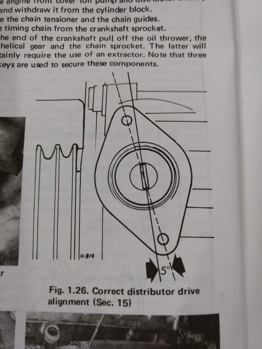

jeff43 Posted April 7, 2019 Posted April 7, 2019 Hi Jeff, When you fit your points distributor the rotor is not pointing at the correct number 1 position, it looks to be pointing at the actual number 4 position. I know you have your leads fitted accordingly but I suspect you fill be chasing your tail until you set the distributor drive up correctly. You will need to drop the oil pump and drop the distributor drive shaft down and reposition it to the correct position. See the attached pic from my Haynes manual. I hope this helps. Cheers Jeff Quote
HomeBuiltByJeff Posted April 7, 2019 Author Posted April 7, 2019 1 hour ago, jeff43 said: Hi Jeff, When you fit your points distributor the rotor is not pointing at the correct number 1 position, it looks to be pointing at the actual number 4 position. I know you have your leads fitted accordingly but I suspect you fill be chasing your tail until you set the distributor drive up correctly. You will need to drop the oil pump and drop the distributor drive shaft down and reposition it to the correct position. See the attached pic from my Haynes manual. I hope this helps. Cheers Jeff I did fit the dizzy drive to that pic, but I am thinking I need to double check it as I believe it could be 1 tooth out. Quote
jeff43 Posted April 7, 2019 Posted April 7, 2019 Hi Jeff, I thought you did, but it just didn't look right when you trial fitted the points dizzy. So yeah you may just be one tooth out, it doesn't take much. It definitely sounds like a timing issue when the engine is running. Good luck with it, I'm sure you will sort it out soon Cheers Jeff HomeBuiltByJeff 1 Quote
