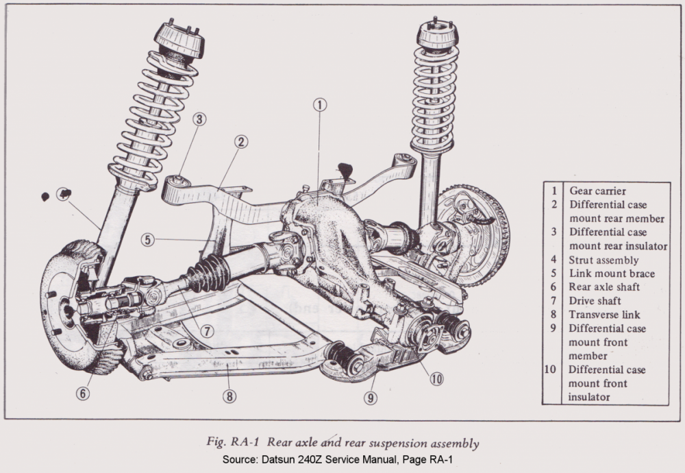

CBR Jeff Posted December 15, 2018 Posted December 15, 2018 Jeff you have a few things assembled wrongly. Check you have the diff mount the correct way around. From memory they will go on either way but only one is correct. The moustache bar appears to be facing the wrong way and is on the wrong side of the hangers. As for having to drill the holes out in the moustache bar I suspect you either have a different model bar or the diff end plate is not an original one. The moustache bar should have tension on it as it acts as a spring to keep the diff in the forward position. Attached is an assembly diagram that may be of assistance. Jeff Quote
HomeBuiltByJeff Posted December 16, 2018 Author Posted December 16, 2018 3 hours ago, CBR Jeff said: Jeff you have a few things assembled wrongly. Check you have the diff mount the correct way around. From memory they will go on either way but only one is correct. The moustache bar appears to be facing the wrong way and is on the wrong side of the hangers. As for having to drill the holes out in the moustache bar I suspect you either have a different model bar or the diff end plate is not an original one. The moustache bar should have tension on it as it acts as a spring to keep the diff in the forward position. Attached is an assembly diagram that may be of assistance. Jeff I have had a whole heap of advice over the last few days from a bunch of different sources and the issue is that the image here is correct for that year, but they changed it several times, and there are several different parts that changed from year to year, not just model to model. In my case, the car is a 71, the gearbox, diff, etc, etc, could be from anywhere. From what I have now been told, the early cars had the moustache bar further forward, but there were issues with the angle of the axels and they wore out faster, so they moved the diff further back. For my situation I think the best way for me to get the correct clearances, is to make up a simple 5mm spacer to put between the diff and the moustache bar. Otherwise I could be banging my head against a brick wall for ages trying to source all of the different moustache bars and diffs, etc until I actually find the right combination that fits. Quote
CBR Jeff Posted December 16, 2018 Posted December 16, 2018 There was three different moustache bars for the 2 seater but they had commonality in the assembly of the components. The parts manual has the following listed. up to 06/71 was part number 55450-E4101 07/71 to 07/73 was part number 55450-E8300 08/72 onwards was part number 55450-N3701 55450-N3701 was also used for the 2+2 and 55450-N4700 for the Auto The moustache bar is a spring if you look at it it will only work effectively in one direction. That direction is as per the picture above. Jeff Quote

CBR Jeff Posted December 16, 2018 Posted December 16, 2018 17 minutes ago, HomeBuiltByJeff said: So from my research, most cars seem to have the moustache bar in 'backwards' and behind the uprights compared to that picture above. Are they all supposed to be as shown in that pic or not. What do you guys all have? Jeff. Install it as shown in the drawing. It will fit and I think you will be surprised the difference it makes. You do need to give the moustache bar a flex to get it into position onto the suspension mounting bolt as it is supposed to have an amount of pre load on it. I have found it easier to install one side then the other. It only takes half an hour to drop the entire assembly out and put it back in again. I have never seen one installed as you have installed it. The data in the parts manuals do not support the comments you made in your early post from feed back you have recived from others. Jeff HomeBuiltByJeff 1 Quote

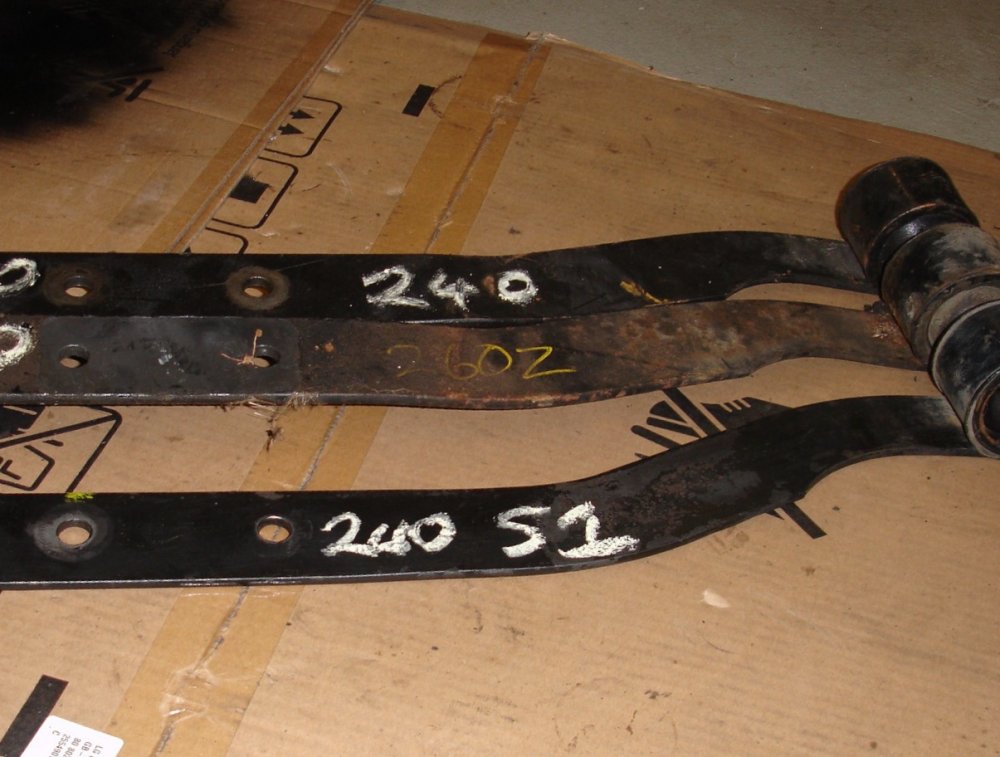

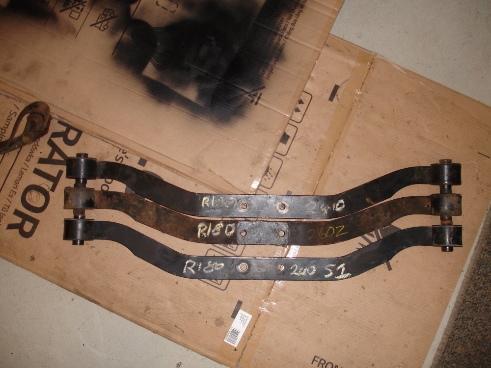

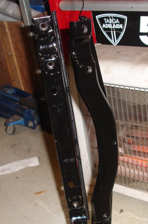

RLY240 Posted December 16, 2018 Posted December 16, 2018 This isn't exhaustive by any means just my observations. The early "forward mount" R180 and R200 both have pretty flat moustache bars and the rearward mount R180s have more of a bend in them. The forward mount also had a flat rear crossmember while the others had one with a pronounced bend for clearance. Early forward mount setup. Early and later crossmembers Moustache bars, ignore the incorrect labels, top is early R180 forward mount, middle is standard 240/260 R180 and the bottom is R200 (I think!) HomeBuiltByJeff 1 Quote
HomeBuiltByJeff Posted December 16, 2018 Author Posted December 16, 2018 20 minutes ago, RLY240 said: This isn't exhaustive by any means just my observations. The early "forward mount" R180 and R200 both have pretty flat moustache bars and the rearward mount R180s have more of a bend in them. The forward mount also had a flat rear crossmember while the others had one with a pronounced bend for clearance. Early forward mount setup. Early and later crossmembers Moustache bars, ignore the incorrect labels, top is early R180 forward mount, middle is standard 240/260 R180 and the bottom is R200 (I think!) I will have a play with the one I have. If I can turn it around and still get it mounted without being under too much tension I will. Quote
RLY240 Posted December 16, 2018 Posted December 16, 2018 1 minute ago, HomeBuiltByJeff said: I will have a play with the one I have. If I can turn it around and still get it mounted without being under too much tension I will. I wouldn't be too stressed, if you can make one work that should be fine. I'm pretty sure one of mine has been butchered to fit and it's still going strong. HomeBuiltByJeff 1 Quote
RLY240 Posted December 16, 2018 Posted December 16, 2018 Plus the front diff mount is offset, it should only go one way (there is a clearance for the tailshaft yoke) but if it's 180 out then the diff is also out of alignment. HomeBuiltByJeff 1 Quote
