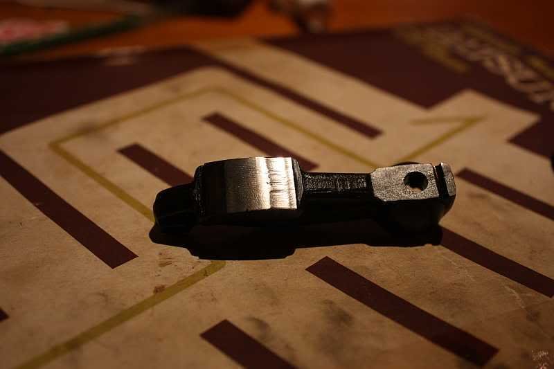

1600dave Posted August 4, 2018 Posted August 4, 2018 Did you check the wipe pattern of the cam lobe on the rocker arm ? If it runs off either end, you'll chew the cam and / or rocker to pieces. Quote
HomeBuiltByJeff Posted August 4, 2018 Author Posted August 4, 2018 6 minutes ago, 1600dave said: Did you check the wipe pattern of the cam lobe on the rocker arm ? If it runs off either end, you'll chew the cam and / or rocker to pieces. It is down near that end of the rocker arm but it is still about a mm from the end of the pad. I hope that will work Quote
