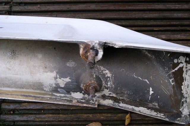

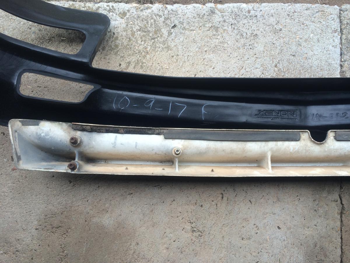

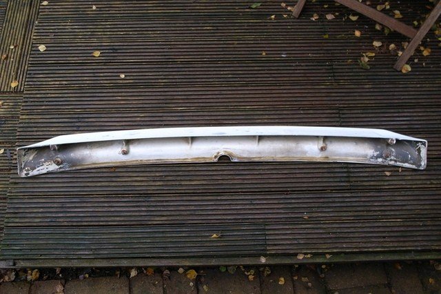

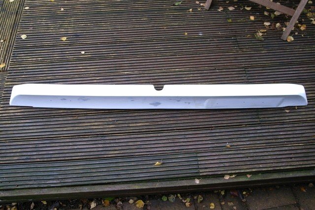

HS30-H Posted February 19, 2018 Posted February 19, 2018 (edited) I'm surprised you went to all that trouble with the ebay rear spoiler. As Gavin has pointed out, the OEM ones had six mounting studs moulded into them and were the proper shape underneath. The inner pair of mounting studs lined up with access holes in the underside of the tailgate, which were put there for that very purpose... Here's a manky one as another example. This is the 'second' type, as fitted to the UK and Euro models and it is made from a very dense pressure-moulded white ABS type material (the 'first'/432-R ribbed type was a classic hand-laid fibreglass roving and resin job) and it has the raised section on the RH side for emblem mounting: These mounting studs had rubber washers between the stud base and the tailgate skin (missing here): Note the raised area for the emblems: Note also the 'step' in the bottom surface at both ends where the spoiler hangs over the tailgate. This is where the rubber seal fitted. Edited February 19, 2018 by HS30-H Quote

TOO60Z Posted February 19, 2018 Posted February 19, 2018 The one Alan showed is correct as the trailing edge returns further down to cover the rear edge of the hatch. Quote
