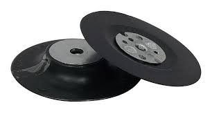

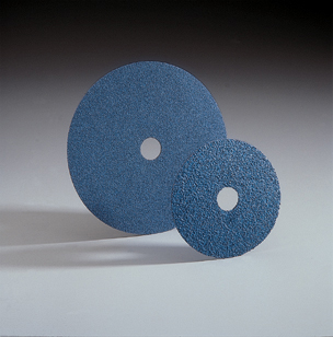

MATTY Posted October 18, 2017 Posted October 18, 2017 I actually think the grinder caused more heat into the panel and more warping than the welder did. I am biting the bullet and getting a 5 inch grinder this week and also some super coarse discs. As someone commented on Facebook, the bigger the disc and the faster it takes away material, the less heat that is transferred. i use fibre backed grinding discs for the majority of any grinding work i do. i find they are easier to use and come in a variety of grits as well giving a better finish than a flap disc or normal grinding disc Quote
HomeBuiltByJeff Posted October 18, 2017 Author Posted October 18, 2017 i use fibre backed grinding discs for the majority of any grinding work i do. i find they are easier to use and come in a variety of grits as well giving a better finish than a flap disc or normal grinding disc I have not seen them? I know most grinding discs I have used have a mesh grid construction, is that what you are refering to? Quote
MATTY Posted October 19, 2017 Posted October 19, 2017 I have not seen them? I know most grinding discs I have used have a mesh grid construction, is that what you are refering to? theses are pretty much like a sanding disc off a orbital sander but designed for a grinder with a nyon backing plate for a lack of a better description and look like this few grinding brands stock their own versions of them but. They are also good because you can use the whole surface area of the disc unlike the conventional grinding disc or flap dics Quote
HomeBuiltByJeff Posted October 19, 2017 Author Posted October 19, 2017 Interesting. I wear out the solid grinding discs pretty fast when I am grinding back welds. Do these last? It looks like sandpaper to me, and I went through half of a flap disc in 10 mins today? Quote
MATTY Posted October 19, 2017 Posted October 19, 2017 Interesting. I wear out the solid grinding discs pretty fast when I am grinding back welds. Do these last? It looks like sandpaper to me, and I went through half of a flap disc in 10 mins today? for a 5'' grinder depending on the grit and angle you grind on they don't last a longer than the normal grinding disc. strange that you're going through grinding discs like that now, that for a 4" or a 5" grinder?? a flap disc is more of a finishing disc and not designed for removing a great deal of material. id prefer the fibre backed discs any day of the week personaly and have been a favorite in most workshops worked in. might be worth trying them out for your self and see what you think but HomeBuiltByJeff 1 Quote

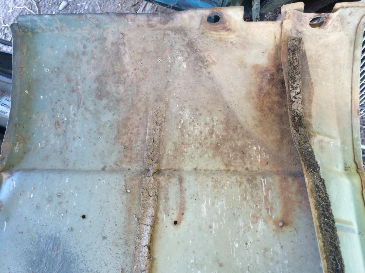

AndBir Posted October 20, 2017 Posted October 20, 2017 (edited) Looks like they did a very rough patch up job, this is what the inside of the lower rear double skinned section of the front guards is meant to look like (including "period" surface rust) - so you got it right with your opening: Water draining down from the windscreen cowl flows down to this area and through the double skinned section and this does block up especially when the rubber seal on the panel breaks down allowing dirt etc. flicked up be the wheels to enter this area - not a good design. Edited October 20, 2017 by AndBir HomeBuiltByJeff 1 Quote

HomeBuiltByJeff Posted October 20, 2017 Author Posted October 20, 2017 Looks like they did a very rough patch up job, this is what the inside of the lower rear double skinned section of the front guards is meant to look like (including "period" surface rust) - so you got it right with your opening: IMG_2946.JPG Water draining down from the windscreen cowl flows down to this area and through the double skinned section and this does block up especially when the rubber seal on the panel breaks down allowing dirt etc. flicked up be the wheels to enter this area - not a good design. Thanks for that. Mine were way too far gone to have any idea of what they were originally suppose to be like. Looks like I wasn't far off the mark, I just made mine a bit short. I mentioned on the Youtube channel, but I think some P90A's had solid lifters. So you may not need to swap your ones over. Yeah, it looks like I got lucky Quote
