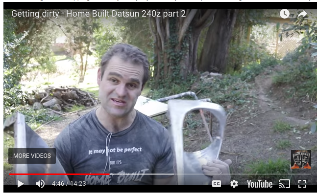

HomeBuiltByJeff Posted September 22, 2017 Author Posted September 22, 2017 This week I get into stripping the many many layers and years of paint and bog off of the Z. It is a very slow messy job, but it has to be done. Quote
Brabham Posted September 22, 2017 Posted September 22, 2017 Good work Jeff. I noticed that the second nose cone has had an additional plate welded on where it rests on the car, it might be worth trying to fix the rusty one by cutting out the rust. Pretty much all zed bonnets have had a hit in the nose so you might want to fix the one you have. I have found that a crumpet wheel like you had on the grinder is best for stripping paint and bog, lots of dust but more pleasant than paint stripper and doesn't leave disc marks in the metal like the flap discs. Getting the panels blasted is the easiest option, which you might want to do after you repair the main rust areas, get them to epoxy prime the panels. Cheers HomeBuiltByJeff 1 Quote

HomeBuiltByJeff Posted September 23, 2017 Author Posted September 23, 2017 Good work Jeff. I noticed that the second nose cone has had an additional plate welded on where it rests on the car, it might be worth trying to fix the rusty one by cutting out the rust. Pretty much all zed bonnets have had a hit in the nose so you might want to fix the one you have. I have found that a crumpet wheel like you had on the grinder is best for stripping paint and bog, lots of dust but more pleasant than paint stripper and doesn't leave disc marks in the metal like the flap discs. Getting the panels blasted is the easiest option, which you might want to do after you repair the main rust areas, get them to epoxy prime the panels. Cheers I was getting ahead of myself saying I was going to get rid of the bonnet. I am with you, I can save it and that is what I will do. A bit of patience and some panel beating and it will be good I am sure. Quote
Administrators gav240z Posted September 23, 2017 Administrators Posted September 23, 2017 Good work Jeff. I noticed that the second nose cone has had an additional plate welded on where it rests on the car, it might be worth trying to fix the rusty one by cutting out the rust. Pretty much all zed bonnets have had a hit in the nose so you might want to fix the one you have. I have found that a crumpet wheel like you had on the grinder is best for stripping paint and bog, lots of dust but more pleasant than paint stripper and doesn't leave disc marks in the metal like the flap discs. Getting the panels blasted is the easiest option, which you might want to do after you repair the main rust areas, get them to epoxy prime the panels. Cheers I agree with Alex on the flap disc (don't use it!!!!!!) you will create low spots on the panel, which will require filler. This is because it's an aggressive disc that will thin out the metal. I learnt this the hard way also. If you're going to use it to strip a section keep it perpendicular or flat to the panel (don't come at it from angles). Only use it to strip thick layers of bog (and glad you were wearing a mask!). The crumpet wheel is far less aggressive to the metal and much safer. I think the big problem you had with the stripper is it's not aggressive enough. You should try aircraft stripper instead, I've found regular paint stripper too weak but aircraft stripper is much more aggressive and suitable for automotive paint etc.. It won't remove bog though! Blasting is good (glass beads) but it leaves the metal a little furry - which is totally fine for a layer of primer. Not sure if you've seen my bonnet repair thread? http://www.viczcar.com/forum/topic/12272-separating-bonnet-skin-and-frame/ Don't use ZIP CUTTERS if you plan to undo spot welds... instead use the smaller spot weld cutter drill bit possible. But repairing the bonnet could take a while, the rear is more of a concern than the front end ding to me. The front could be pulled out with an easy beat, but you may not have access to 1? http://www.easybeat.com.au/ Alliteratively you could tack weld on small washers etc.. to use a slide hammer to pull it back out. Welcome to the joys of 45 year old Japanese iron and the fortunes of multiple ownership! Fortunes? More like tortures I was getting ahead of myself saying I was going to get rid of the bonnet. I am with you, I can save it and that is what I will do. A bit of patience and some panel beating and it will be good I am sure. I would actually scrap the headlight scoops, they are fubar mate. Yes you could invest hours "fixing" them, but the result will never be as good as just sourcing a better set to begin with. (Welding up the split will not be easy given the angles etc..) You can still get them cheap, try eBay US even. They are so common between 240z/260z/280z that they are not that hard to get and therefore cheap. A hood/bonnet is much harder, but there is reproductions available now, I'm just not sure how well they fit. I may order 1 at some point if nobody else takes the plunge before me. But non OEM stuff will always need more "tweaking". Unfortunately as stated above most bonnets have had a hard life. I tried to source a better second hand 1 here only to find everything was in worse shape than what I started with on the Gold car. Layers of bog... layers upon layers. 1 bonnet I found was literally twice as heavy as a regular bonnet it was that full of bog haha! PS: I know how it feels to look this dusty... Quote
HomeBuiltByJeff Posted September 23, 2017 Author Posted September 23, 2017 (edited) I agree with Alex on the flap disc (don't use it!!!!!!) you will create low spots on the panel, which will require filler. This is because it's an aggressive disc that will thin out the metal. I learnt this the hard way also. If you're going to use it to strip a section keep it perpendicular or flat to the panel (don't come at it from angles). Only use it to strip thick layers of bog (and glad you were wearing a mask!). The crumpet wheel is far less aggressive to the metal and much safer. I think the big problem you had with the stripper is it's not aggressive enough. You should try aircraft stripper instead, I've found regular paint stripper too weak but aircraft stripper is much more aggressive and suitable for automotive paint etc.. It won't remove bog though! Blasting is good (glass beads) but it leaves the metal a little furry - which is totally fine for a layer of primer. Not sure if you've seen my bonnet repair thread? http://www.viczcar.com/forum/topic/12272-separating-bonnet-skin-and-frame/ Don't use ZIP CUTTERS if you plan to undo spot welds... instead use the smaller spot weld cutter drill bit possible. But repairing the bonnet could take a while, the rear is more of a concern than the front end ding to me. The front could be pulled out with an easy beat, but you may not have access to 1? http://www.easybeat.com.au/ Alliteratively you could tack weld on small washers etc.. to use a slide hammer to pull it back out. Fortunes? More like tortures I would actually scrap the headlight scoops, they are fubar mate. Yes you could invest hours "fixing" them, but the result will never be as good as just sourcing a better set to begin with. (Welding up the split will not be easy given the angles etc..) You can still get them cheap, try eBay US even. They are so common between 240z/260z/280z that they are not that hard to get and therefore cheap. A hood/bonnet is much harder, but there is reproductions available now, I'm just not sure how well they fit. I may order 1 at some point if nobody else takes the plunge before me. But non OEM stuff will always need more "tweaking". Unfortunately as stated above most bonnets have had a hard life. I tried to source a better second hand 1 here only to find everything was in worse shape than what I started with on the Gold car. Layers of bog... layers upon layers. 1 bonnet I found was literally twice as heavy as a regular bonnet it was that full of bog haha! PS: I know how it feels to look this dusty... Screen Shot 2017-09-23 at 11.40.20 AM.png I am completely with you, that the back of the bonnet is harder to repair than the front. I have already done some similar repairs on the bottom of the doors on the 911. My plan with the bonnet is to cut out a long strip of the damaged area and weld a new bit in. The hard bit is shrinking the metal. There are already a couple of places on the bonnet that 'pop' in and out. I saw you used a 'slapper' I think I will look into that. It looks like the kind of thing I am looking for. As for the headlight bucket, I think it shouldn't be too hard from here. I am not that worried about welding up the split. It is a bit of work, but I don't think it will be too bad. Working on those folds is much easier than welding in strips on flat panels, and dealing with all of the warping that comes with it. Edited September 23, 2017 by HomeBuiltByJeff Quote
Administrators gav240z Posted September 23, 2017 Administrators Posted September 23, 2017 I am completely with you, that the back of the bonnet is harder to repair than the front. I have already done some similar repairs on the bottom of the doors on the 911. My plan with the bonnet is to cut out a long strip of the damaged area and weld a new bit in. The hard bit is shrinking the metal. There are already a couple of places on the bonnet that 'pop' in and out. I saw you used a 'slapper' I think I will look into that. It looks like the kind of thing I am looking for. As for the headlight bucket, I think it shouldn't be too hard from here. I am not that worried about welding up the split. It is a bit of work, but I don't think it will be too bad. Working on those folds is much easier than welding in strips on flat panels, and dealing with all of the warping that comes with it. A slapper is really more useful for raising low spots, for removing the oil caning effect heat shrinking is the way to go. It's not really easy to explain here, but essentially you look for the high spots on the panel and heat them up with an oxy torch (or similar) until you see a little cherry red spot, the you place a dolly under the panel on the rear side (but not butted up against the panel) just a mm or 2 away (for some give) and you hit around the hight spot a few times (in a sort of circular motion) and then finally slap the middle (where it was cherry red down) also. Then you quench it with a wet rat. It's really something you need to be shown to be honest. The slapper will harder the area and may stop oil caning but you may introduce a high spot (which is worse than low spots). I have a spare passenger headlight bucket you're more than welcome to have if it's of any use to you? https://photos.app.goo.gl/5OVgK0UxWOju7uZk2 it's split at the front, someone has welded in a piece (quite poorly mind you) on the right hand side) and it has a broken stud. The melted spots are where I filled in holes from headlight covers using an oxy as practice. If anything you may be able to cut pieces out of it as it's relatively rust free (apart from surface rust)? I don't throw anything out, this is an example of why. I didn't bother to repair it as someone else gave me a good passenger side unit which was in near mint shape. I could possibly post it also, I'd guess it would be $14-$20 within NSW? Quote

HomeBuiltByJeff Posted September 23, 2017 Author Posted September 23, 2017 I have been doing a lot of youtube research, and I am up for the challenge. I have an LPG blow torch which I think should do the job of shrinking pretty well. Thanks for the offer of the passenger headlight bucket, but mine is already perfect I like a challenge, and I want to be able to repair it all. I will give it a go, and worse case I can buy replacements (but I am stubborn enough to persevere ). Quote
