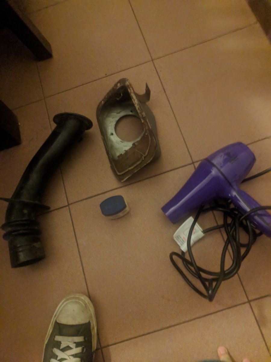

Administrators gav240z Posted March 14, 2019 Administrators Posted March 14, 2019 2 minutes ago, HomeBuiltByJeff said: Mine is completely perished. The whole thing is crumbling. I would love to take you up on that. Ok, let me grab a photo of it tonight. It came with a spare fuel filler section cut out I imported from the US as a patch / section for my 240z. Only problem is separating it from the filler neck section, think I'm gonna need a lot of vaseline and a hairdryer... HomeBuiltByJeff and CBR Jeff 2 Quote

Administrators gav240z Posted March 16, 2019 Administrators Posted March 16, 2019 On 3/14/2019 at 5:24 PM, HomeBuiltByJeff said: Sounds like you have a fun night ahead of you Bit disappointed, didn't get to use the vaseline.. only required a couple of seconds of heat and out it slipped. Quote
