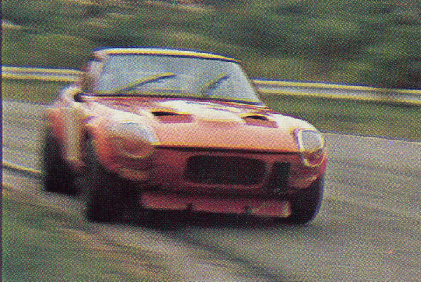

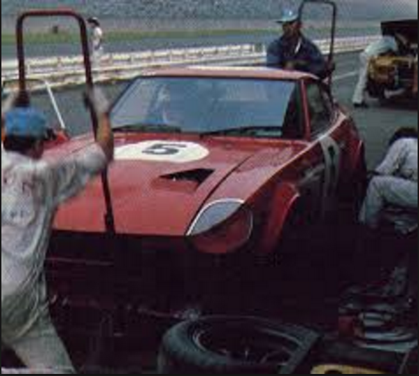

d3c0y Posted February 1, 2016 Posted February 1, 2016 The area where the cowl panel meets the windscreen is a big stall area, so it probably does SFA. In the wind tunnel testing i linked earlier, they popped the bonnet up and it had no effect. For effective pressure venting I think you would need to run the vents further down the bonnet like the Scuderia race car pictured below: Quote
260DET Posted February 1, 2016 Posted February 1, 2016 No, no, no, those Scuderia vents are wrong. They are in the right place but should be facing to the back to allow air out from under the bonnet. If more air in was required then opening the grill area a bit would have done the trick but for a NA L6 engine that part looks about right. Quote
d3c0y Posted February 1, 2016 Posted February 1, 2016 I think if you look closely, the metal is folded up at the front of the vent to promote a low pressure zone to help suck the air OUT of the vent. Radiator opening only needs to be 25% of radiator area from memory. Quote
260DET Posted February 1, 2016 Posted February 1, 2016 Pics aren't very clear but the second one seems to show a front facing open vent, the black part. Anyway, we are agreed that the idea is to get air out there in that low pressure area, not in. Blocking off part of the S30's too large grille opening looks good in the first pic. d3c0y 1 Quote
