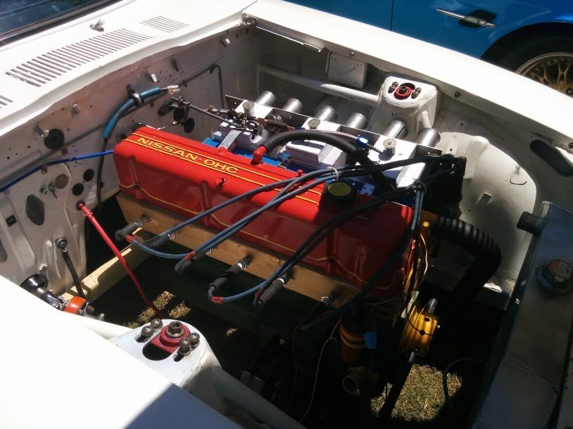

The engine in this thing gives people wood.

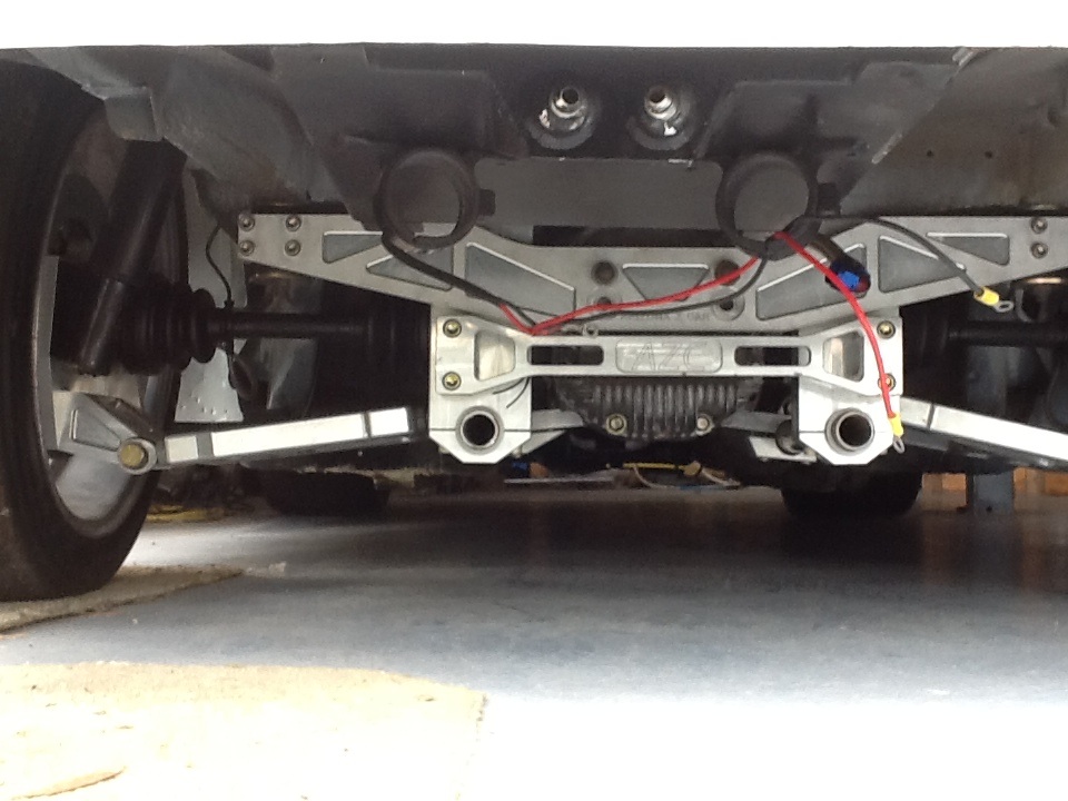

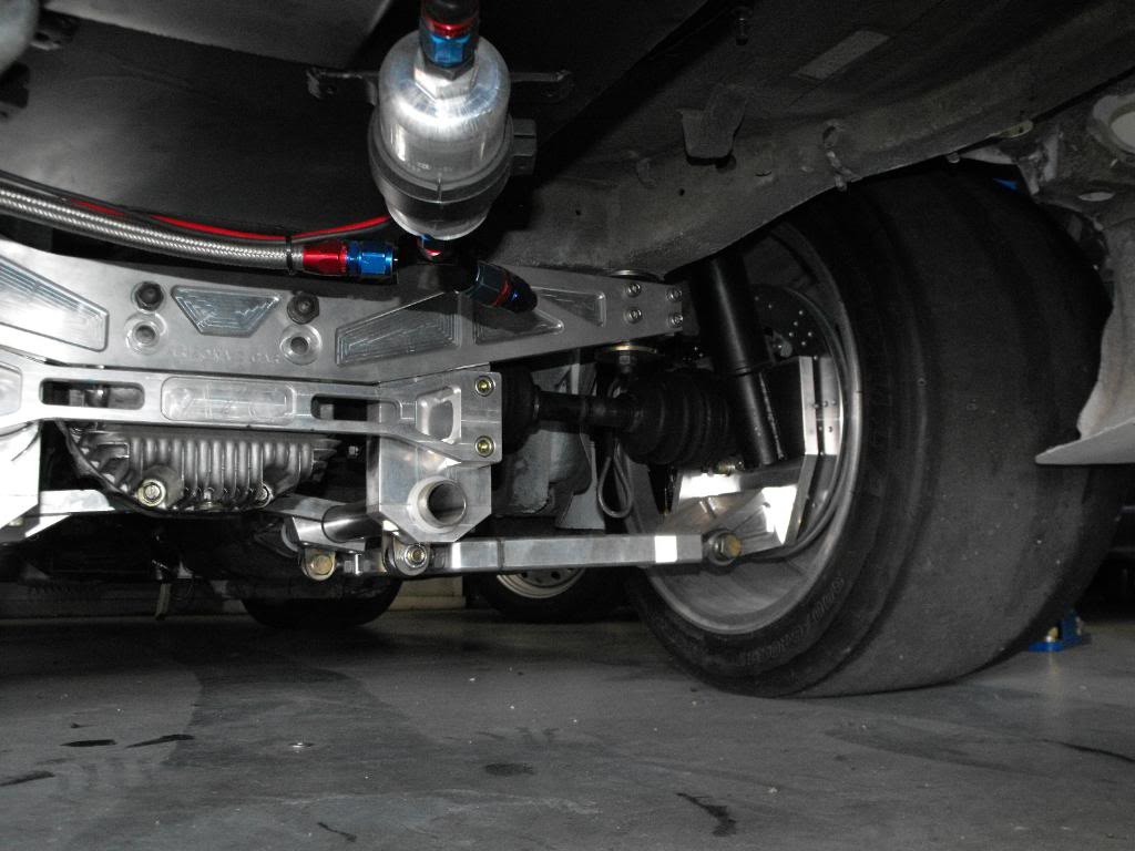

The first thing on the list was the rear suspension . The car has been set up with the Arozona brake and suspension kits. But never sorted. The lower control arms were of some concern. Trying to get the right angle. In particular the length didn't work. The rose joints had to be straight . Not hanging under or on top. This changed the camber, but also the lower control arm angle.

Hi Gordo,
What happen to the passenger side half shaft in the last couple of photos. Looks like it's in 2 pieces.

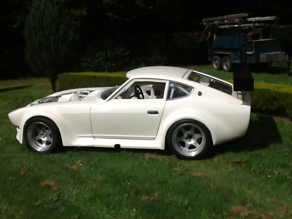

Hey Gordo
that was the first car since the 90's that's used that full set of panels from Alfa - i thought i spotted them in a photo in the NDSOC mag when they passed your place recently
Alan was saying you were at the Island doing a shake down run already!
Though sounded like a bit of sorting still to do
Hopefully the red Z will get back out there and you'll have a twin

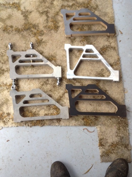

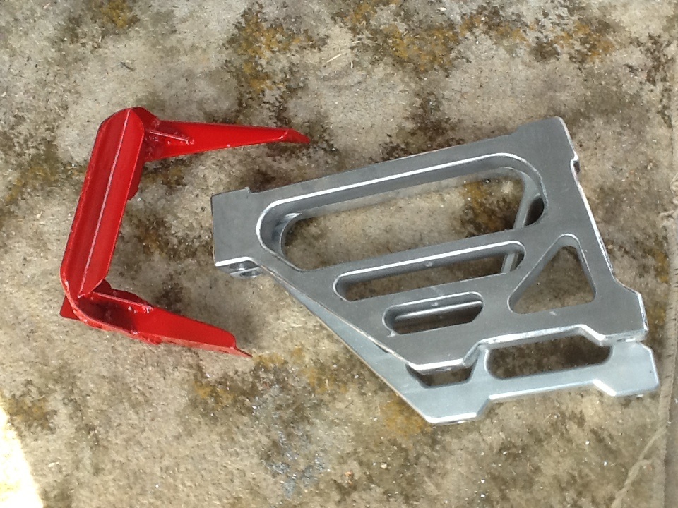

So it was decided to get 40mm shorter rear control arms made. Being a carpenter, I made timber templates for a trial fit. Then new ones where water jet cut and machined. This gave me the ideal angle and length .

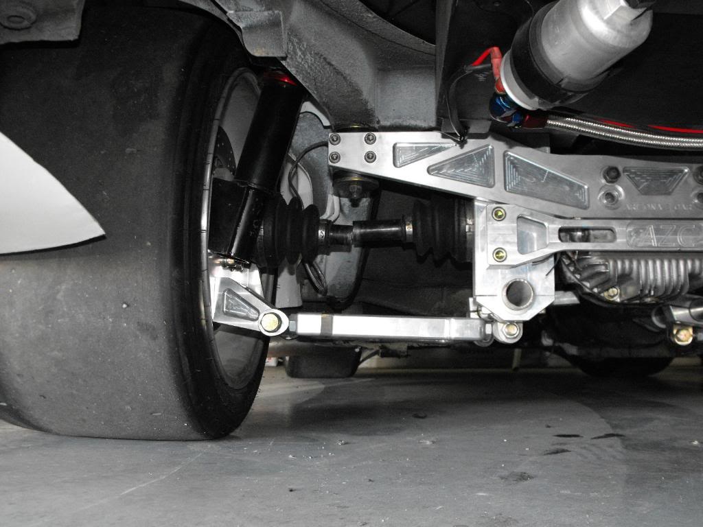

So while sorting the rear control arm out, and now determing the camber it was discovered the half shafts where to long. They where at there shortest length. So as the suspension moved up and down there was no where for it to move. Costing the shortening of the half shafts, it was decided to change the rear wheel off set buy 20mm to bring the wheel closer to the diff and then we could ajust the lower control arm back to the original position and then have 20mm of movement in the half shaft..
    Then the diff mount needed some sorting. The Arozona set up is a bit strange with two pices of alloy coming off the main rear control bar to support the front of the diff. So I left this set up and made an additional mount that bolts up from the body.
