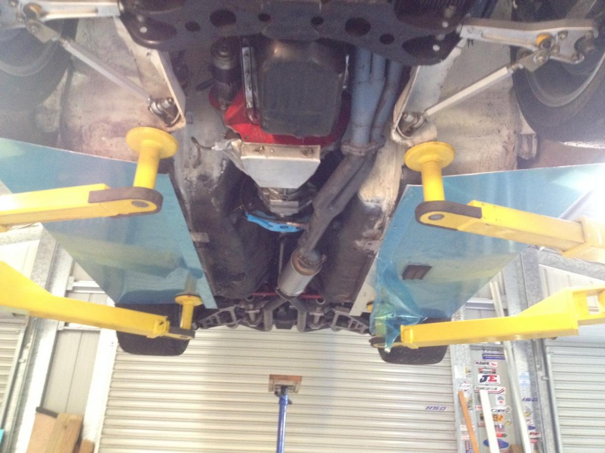

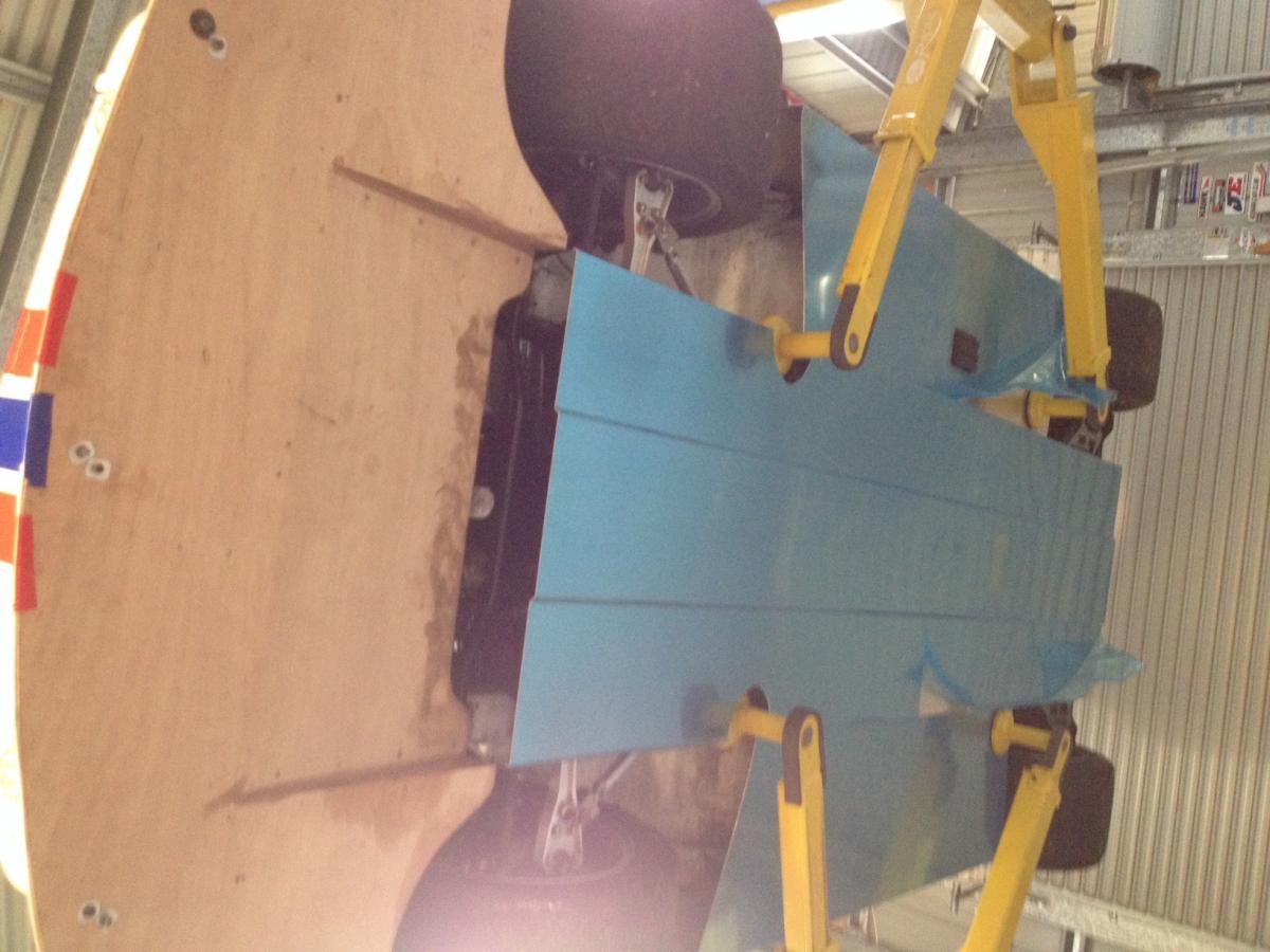

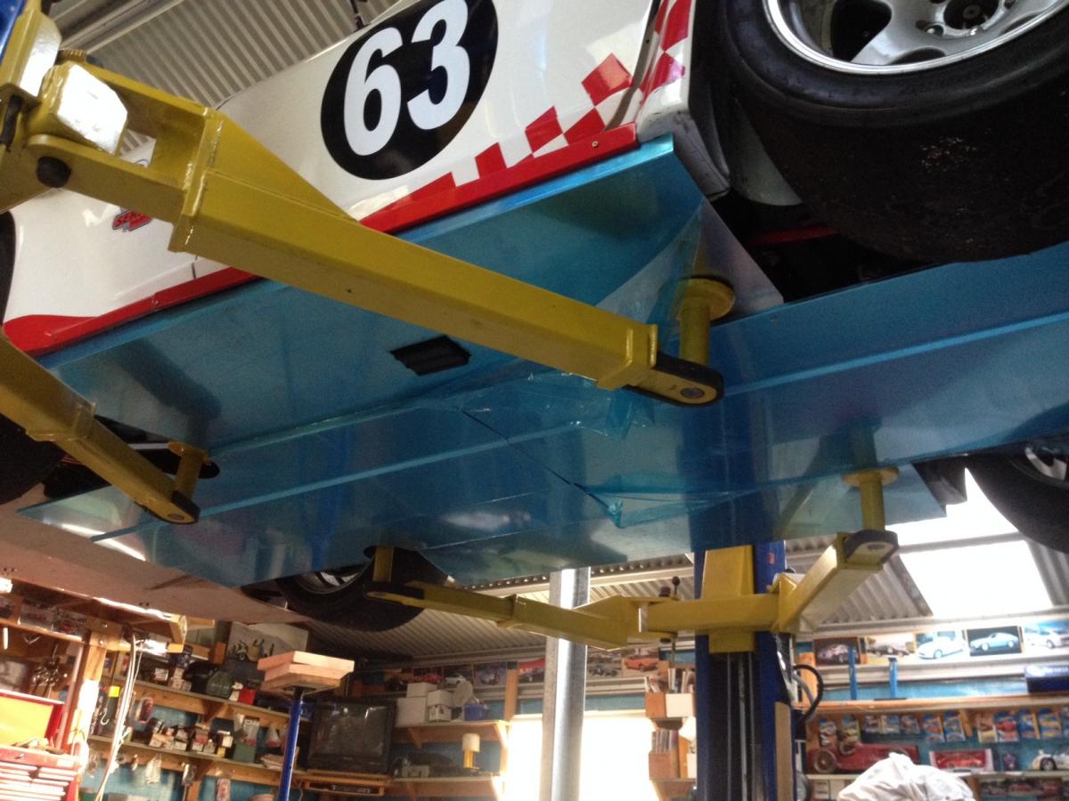

Gordo Posted October 12, 2015 Author Posted October 12, 2015 Toying with the idea of a flat bottom on the Zed. Anyone done this before. What sort of gains would I get? Quote
260DET Posted October 12, 2015 Posted October 12, 2015 Considered this a while back but put it in the 'too hard for the anticipated benefit' box On the other hand a diffuser could be the go, if it upset the handling balance then you would know it's working. Gordo 1 Quote
