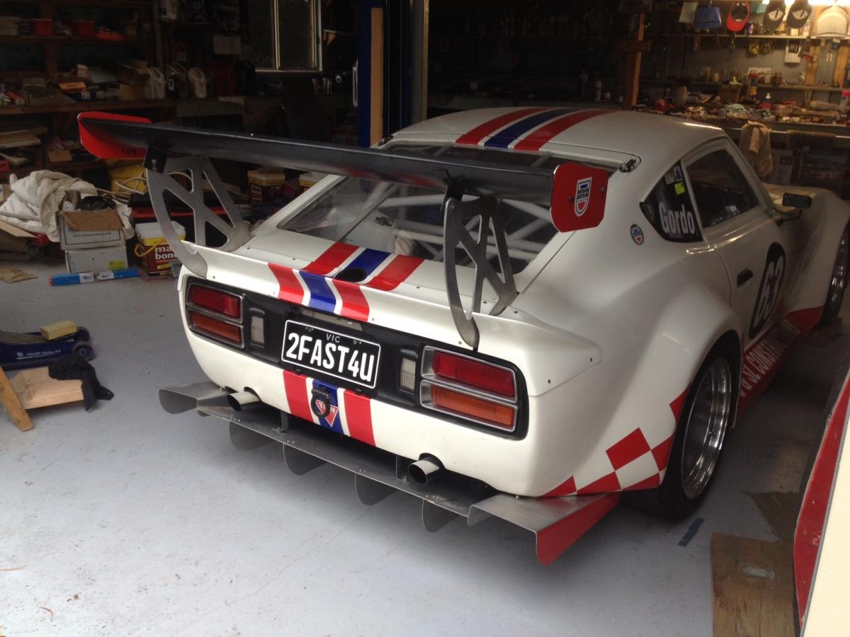

Gordo Posted February 18, 2016 Author Posted February 18, 2016 Got any idea at what speed the current wing starts working Gordo? Some start from as low as 80kph. From Richard. How would anyone know. All I now is it works. The Lukey Hights spin was my fault, to fast on entry. The speed there is pretty fast. About 6200rpm in 4th, maybe 175kph on entry, so the wing would be working. Quote

DatZed Posted February 21, 2016 Posted February 21, 2016 Do you know what the airfoil is that you are using? Perhaps you have a little too much aoa and that's what is costing you the top speed? You reduce the aoa by 1 degree every session until you find the balance point between drag and downforce. This is obviously predicated on the assumption that the airfoil is reasonable efficient and not stalling and becoming a sail on the straight. d3c0y 1 Quote

Gordo Posted March 10, 2016 Author Posted March 10, 2016 I've put the rear spoiler on. Will try the car with the wing on, and then take it of to see what the speed difference is on the straight. d3c0y and 260DET 2 Quote

TomC18 Posted March 11, 2016 Posted March 11, 2016 Hey, maybe you should flatten the wing right out before removing it, if you have enough runs. I found my old data and was doing 238kph at the end of the straight when I did the 1.46.5 - that was with half a G Nose and minimal front downforce, ie just the spoiler, no splitter on front, and rear spoiler all as currently. Gordo 1 Quote
Gordo Posted March 21, 2016 Author Posted March 21, 2016 Was at the Island on the weekend trying a few things out. First run no front splitter. 6100 rpm on the straight. 10kph head wind. Second run, no front splitter and took the rear wing off. 6450rpm on the straight. 20 kph head wind. And the car handled like crap. Almost lost it twice, and very unstable in all the fast corners. Third run, put the splitter and wing back on. Car felt fantastic and was 2 -- 3 seconds faster at 6100rpm on the straight. Testing complete. Leave the areo stuff on. 260DET, Sirpent and Ponyo240z 3 Quote
Sirpent Posted March 21, 2016 Posted March 21, 2016 Testing complete. Leave the areo stuff on. Love your work, thanks for putting our half witted theories to the test Quote
