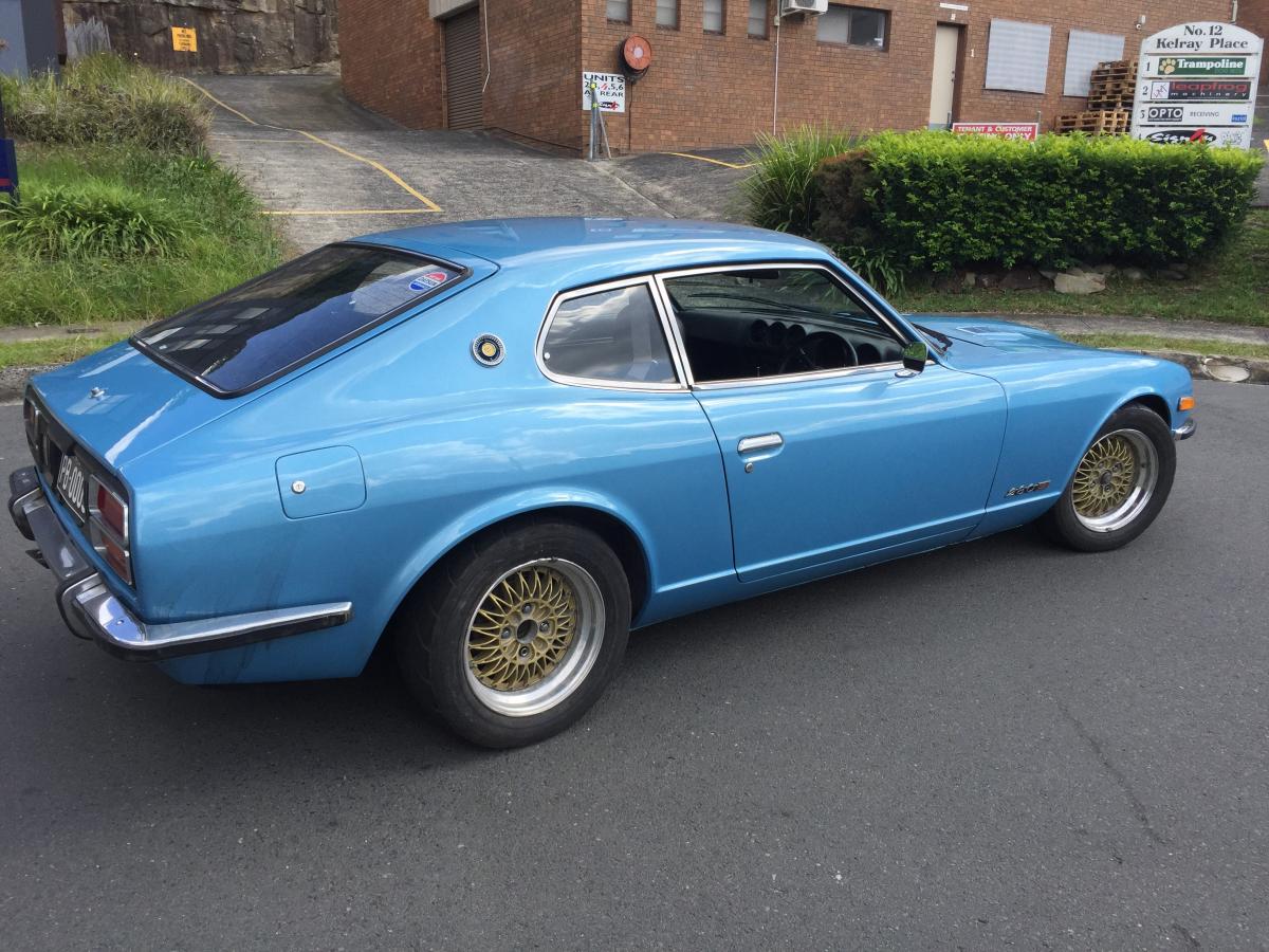

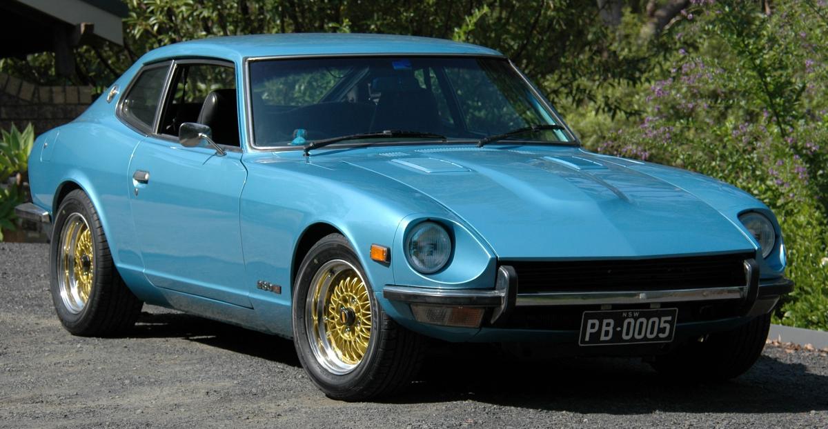

Dionysus Posted March 28, 2016 Posted March 28, 2016 Better picture with the wheels please. What offset are they PB? Quote

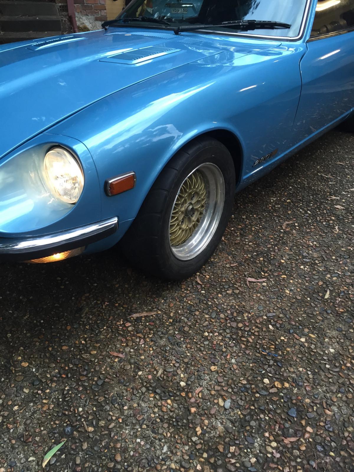

Moderators PB260Z Posted March 28, 2016 Moderators Posted March 28, 2016 (edited) Hi You don't miss much The rims are Simmons V4 15X8 at 0 offset and fitted with 225/50/15 tyres The fit is pretty good but not perfect : At the front there was a tiny bit of scrubbing on the lower valance, but easily sorted - Trim the valance or change to 205/50/15 tyres At the rear -6 offset would fill the guards a little better. Another thing to consider is the availability of 225/50/15 tyres is not the best. I am learning this as the tyres currently on the rims need replacing. Cheers PB Edited April 2, 2016 by PB260Z GongZ 1 Quote

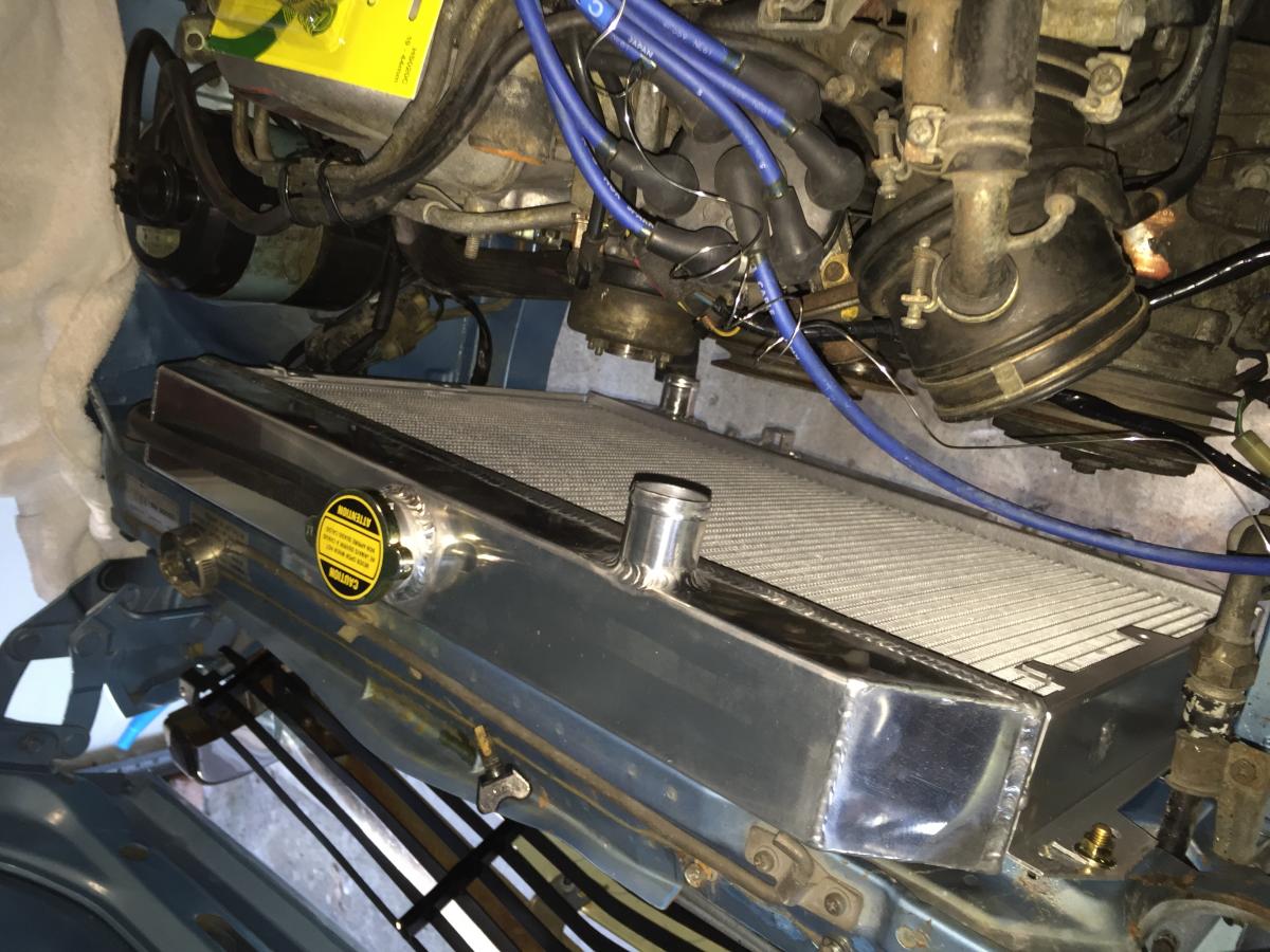

Moderators PB260Z Posted April 2, 2016 Moderators Posted April 2, 2016 (edited) Hi, So the ebay radiator arrived during the week and looks pretty good. Yes it did need a little fiddling to get it bolted up, but nothing major. Just waiting for some Spal fans to arrive than I will be able get her back on the road. Cheers PB Edited April 2, 2016 by PB260Z Quote
CBR Jeff Posted April 2, 2016 Posted April 2, 2016 (edited) PB that should transfer the heat and keep the engine cool. It will be a lot more efficient that a std unit. Jeff Edited April 2, 2016 by CBR Jeff Quote
Moderators PB260Z Posted April 2, 2016 Moderators Posted April 2, 2016 PB that should transfer the heat and keep the engine cool. It will be a lot more efficient that a std unit. Jeff Hi Jeff Hoping so. The old unit was not in the best of shape then add to that I added some chemical flush to the water which resulted in the block sludge moving to radiator core. Cheers Quote

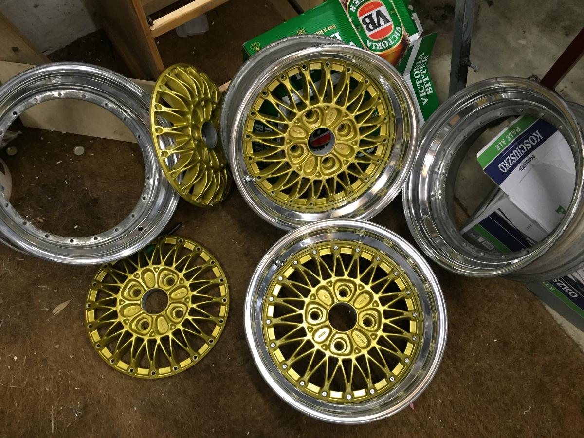

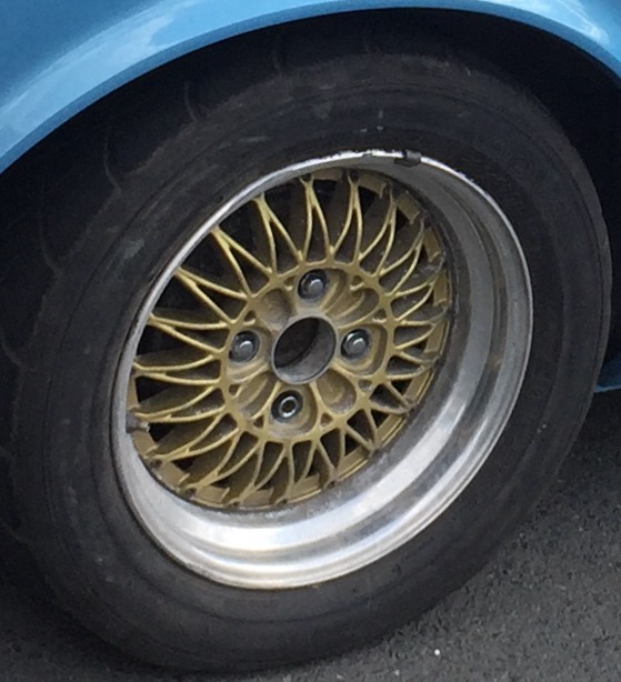

Moderators PB260Z Posted April 7, 2016 Moderators Posted April 7, 2016 A little progress on the rims. Dionysus, GongZ, mother240 and 1 other 4 Quote
Cozza Posted April 7, 2016 Posted April 7, 2016 I always new VB was no good for drinking but never thought to use it as a polishing compound. Good thinking Mate. Wheels look great by the way. blu260z, sydney mike and andyk_79 3 Quote
Moderators PB260Z Posted April 16, 2016 Moderators Posted April 16, 2016 Hi Finished cleaning up the rims and fitted some new tyres, starting to look the way I want it to sydney mike, gav240z, blu260z and 1 other 4 Quote

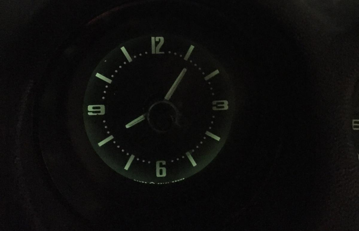

Moderators PB260Z Posted June 25, 2016 Moderators Posted June 25, 2016 (edited) Hi Just a small update. I now have a working and acurate clock well it has kept time installed for 3 weeks. Yes, I know it is wrong face for a '77, and the hands are a little short - but this is prototype of an economical clock restoration idea and I didn't want to risk destroying my original clock. Edited June 25, 2016 by PB260Z Quote
