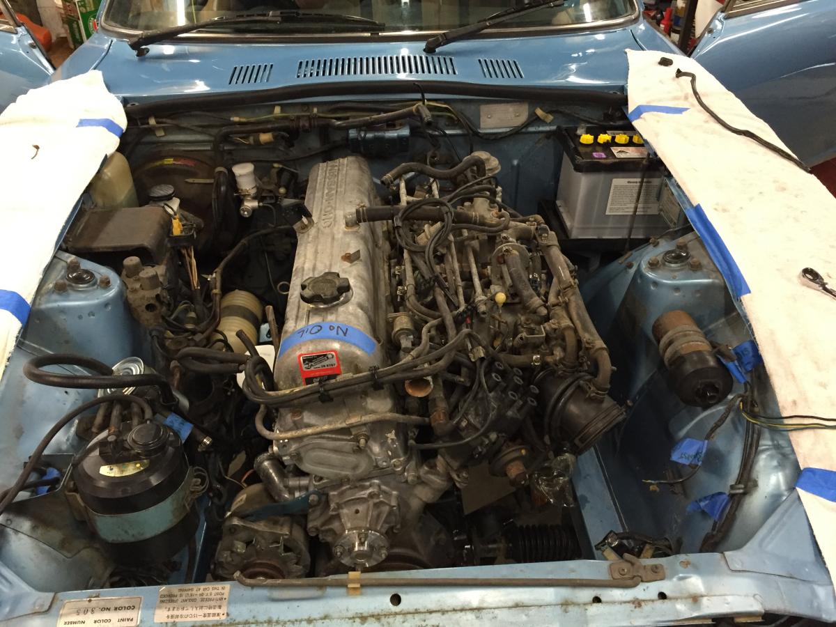

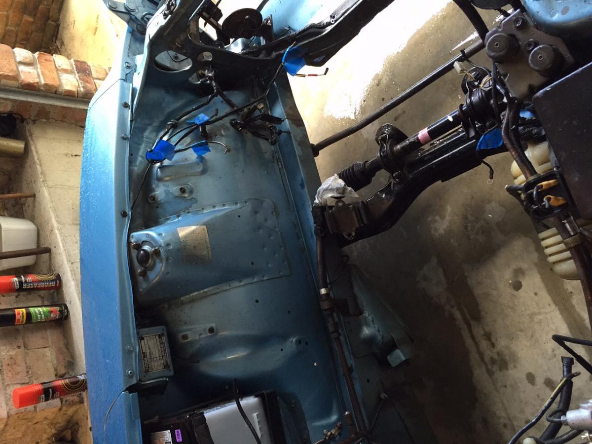

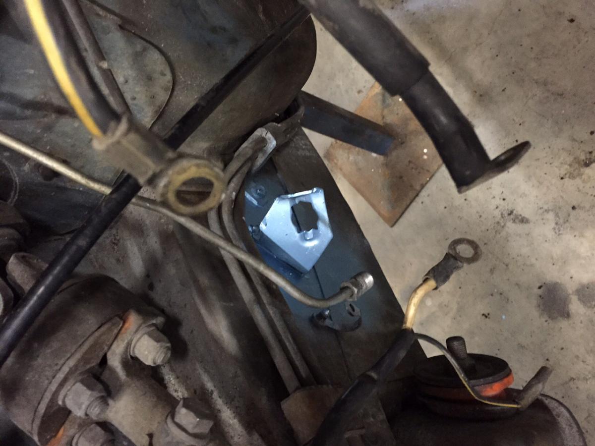

Moderators PB260Z Posted September 20, 2015 Moderators Posted September 20, 2015 (edited) Hi, Spent the last few days addressing some of the little details needed. 1. Mounted the ZX EFI Fuel Pump and Damper nice and high away from harm. 2. Remove 30+ years of accumulated grime from the engine bay. 3. Mount Clutch hose on the chassis rail. Edited September 20, 2015 by PB260Z Quote

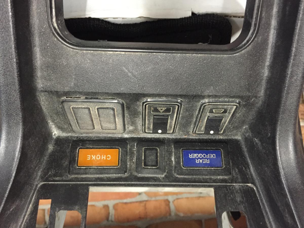

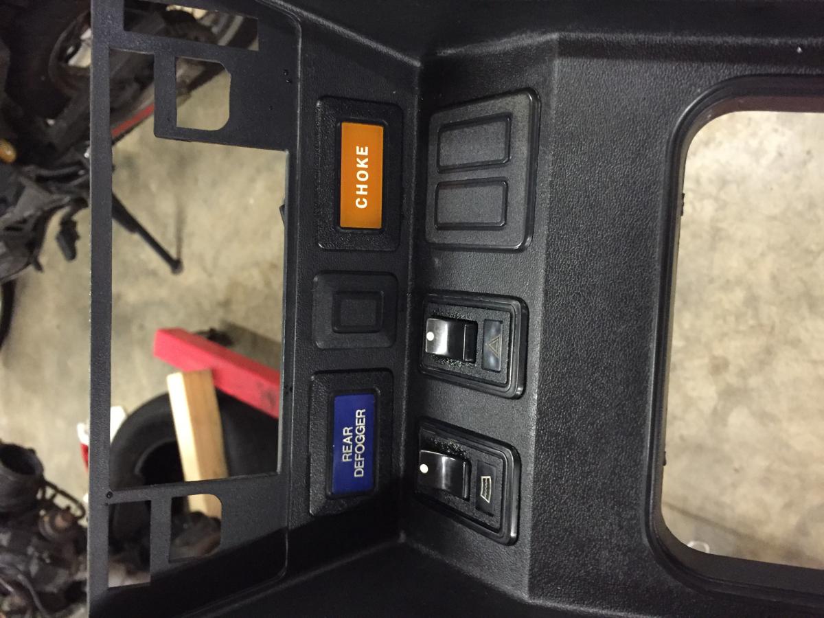

Moderators PB260Z Posted November 1, 2015 Moderators Posted November 1, 2015 (edited) Still struggling for timeto work on the bus, work is rather busy right now.I am managing to tackle a few smaller jobs. Cleaned up the console and switches today.Still need to fix the ashtray lid and fit a leather boot for the gearshift. Edited November 2, 2015 by PB260Z Quote

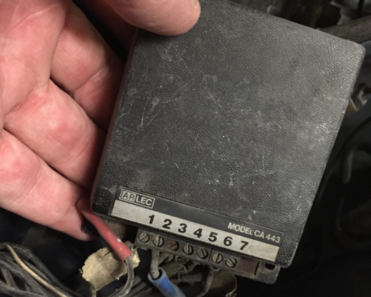

Moderators PB260Z Posted November 15, 2015 Moderators Posted November 15, 2015 Managed to get down into the workshop and do some work on the bus today. Attacked a lot of those little jobs that needed doing. - Headlights sorted - Wipers & Washers Sorted (you can use an S130 pump with a quick mod) - Rear seat locks fixed - Interior cleaned and carpets sorted. - New steering wheel fitted - L28 EFI loom modified to suit the S30. The car is starting to look the part on the exterior & interior - feeling very motivated to put the L28 in. In the process of fixing the washer pump I found the little black box in the picture below hidden under the washer bottle. I am guessing a simple sort of car alarm (although no siren or bonnet switch is fitted) anyone ever seen one like it ? Cheers PB Quote

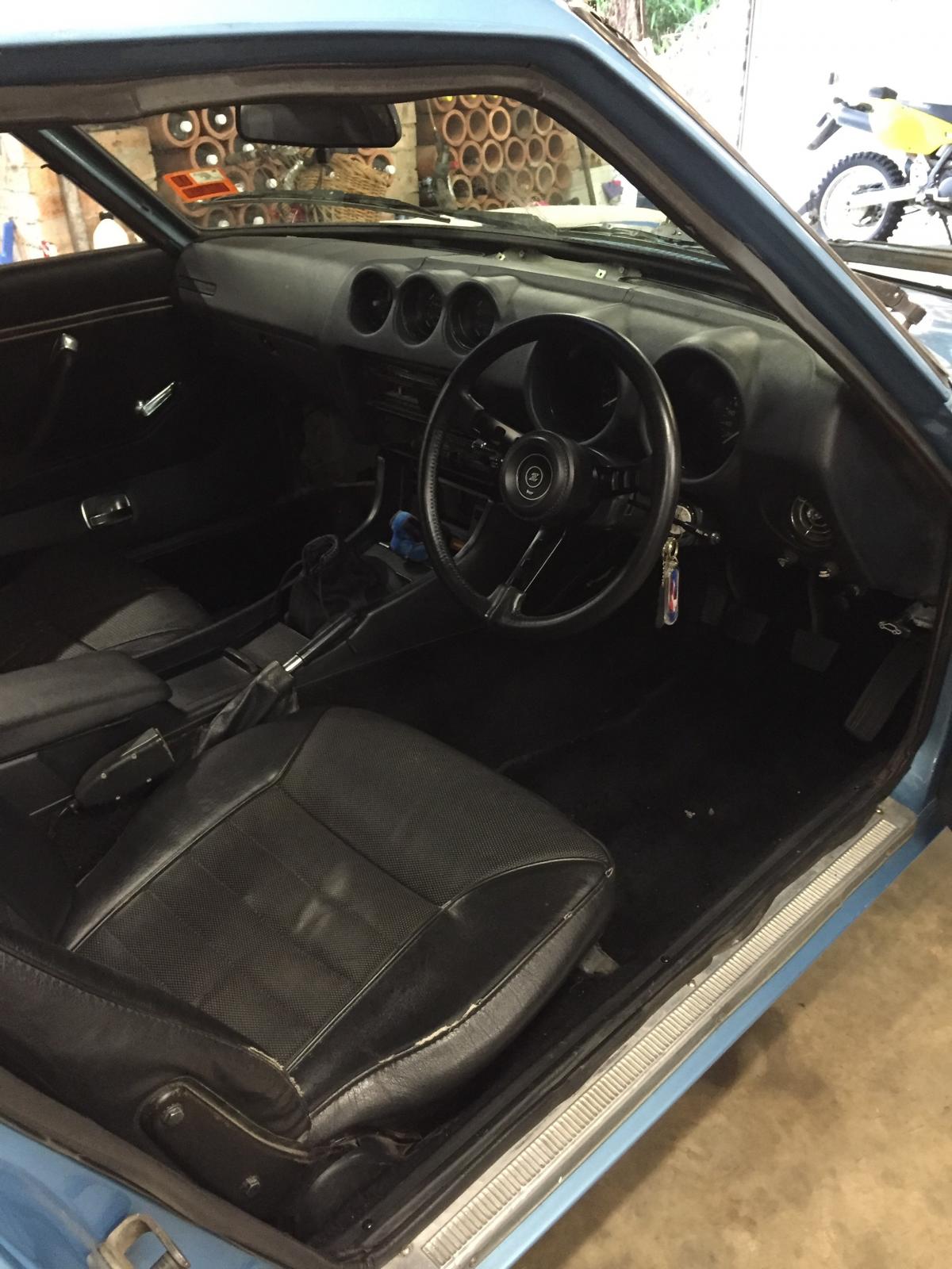

Moderators PB260Z Posted November 23, 2015 Moderators Posted November 23, 2015 The interior has also progress, but this happened the weekend before. Quote

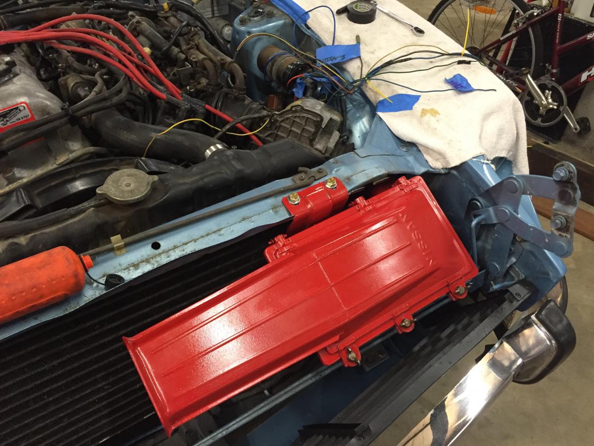

Moderators PB260Z Posted November 27, 2015 Moderators Posted November 27, 2015 Factory 280Z Air Cleaner, AFM fitted up and wiring almost finished. Getting very close to initial start up. Quote
