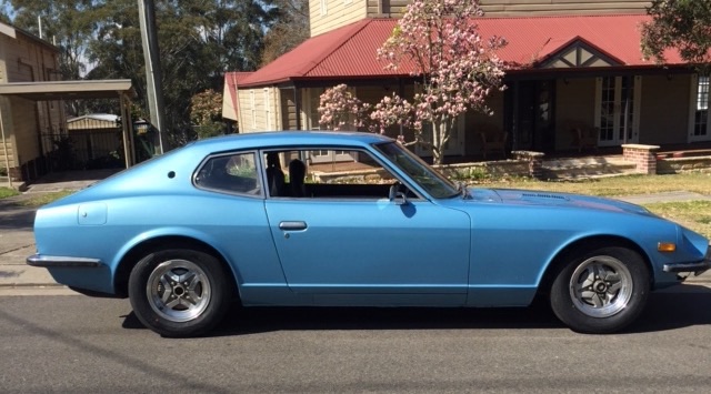

Yes, 225/50/15 on the front occasionaly scrub on the valance, usually when reversing into my driveway - the ramp angle is all wrong.
Ok. Thinking a 215 on an 8 inch rim would look good . Unfortunately I don't have a single picture that shows both wheels together. But you can see the clear difference between my two wheels. Plus, you can also see my need for lower springs... Lol.
But I do love the look of 225s on the rear.
Thanks for your input Pete, much appreciated.
Cheers,
Rob
Cheers,
Rob
Hi
Lowering your car will make an amazing difference to how those fronts look, I reckon they will look great.
Once it is done, post up a few photos.

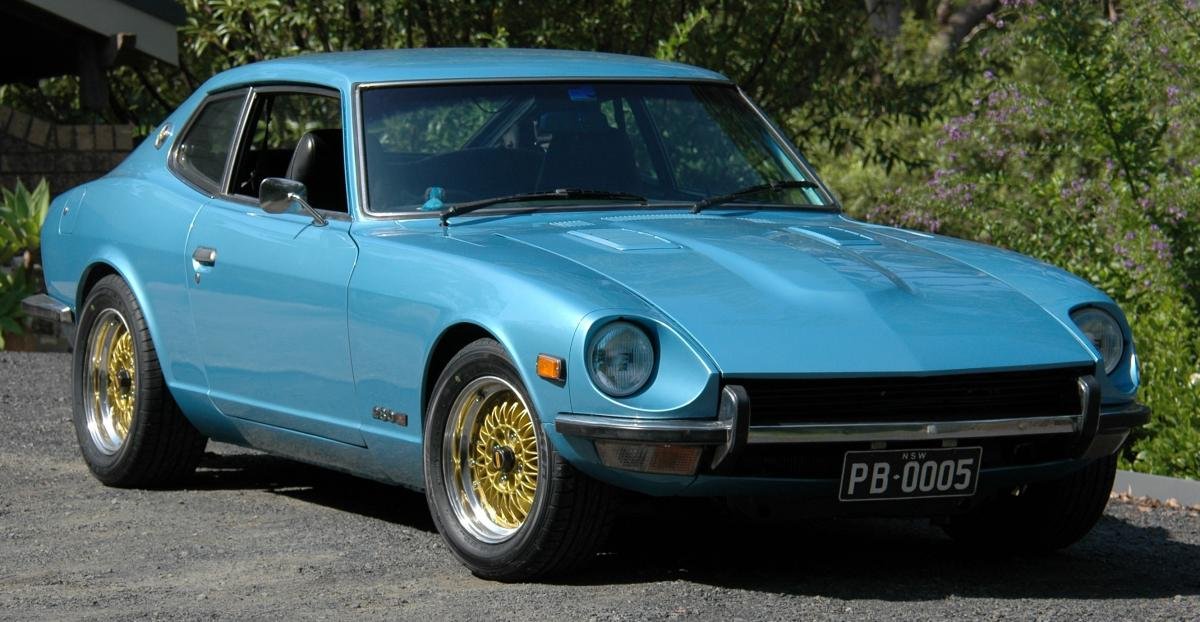

The Bus is now in Melbourne (Cheltenham area) with Vic plates and has had a good clean.
The new owner, Andrew, is taking great care of her
31 minutes ago, Ponyo240z said:
Hi Peter
What suspension set up were you running in this?
Hi
Kings Lowered all round, with 2 seater strut hats on the rear
Wheels are 15"
