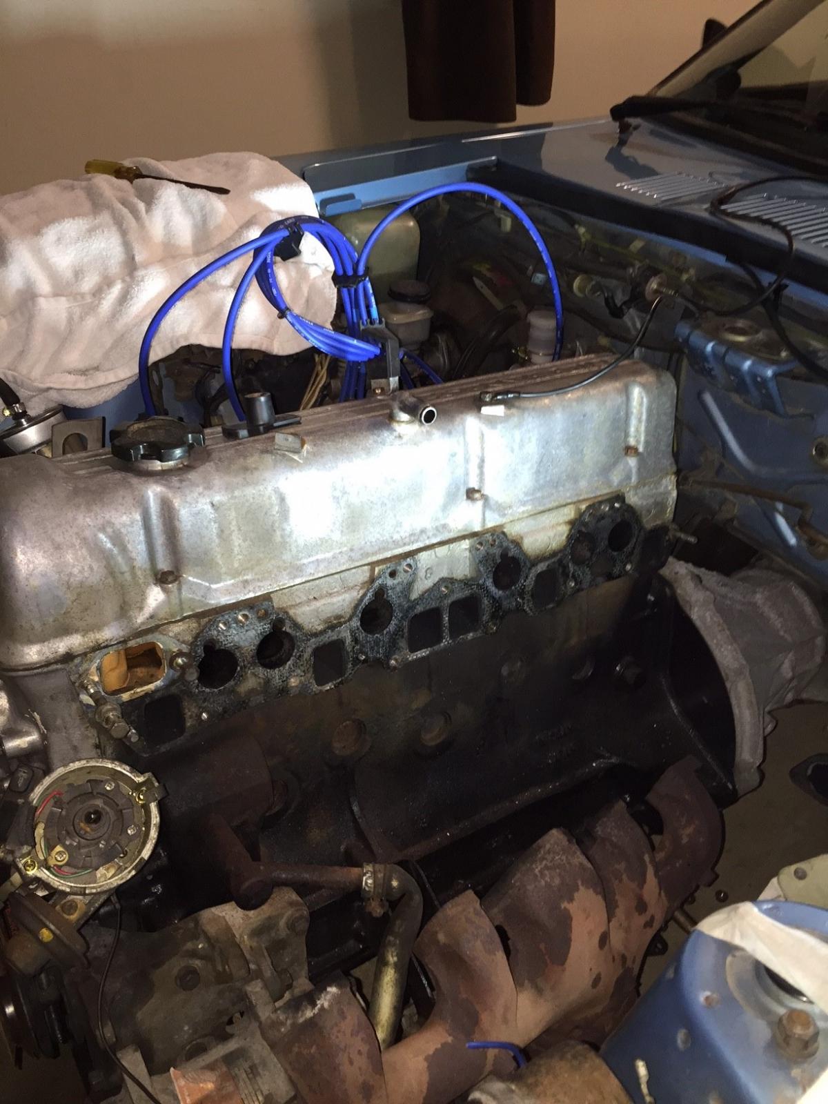

Moderators PB260Z Posted December 21, 2015 Moderators Posted December 21, 2015 A quick update on progress. Suffered a small set back on the weekend - blew the exhaust manifold gasket. Gives me a another reason to spend time in the workshop over the Xmas holidays. Such is the joy of older cars. Cheers PB Quote
Moderators PB260Z Posted December 22, 2015 Moderators Posted December 22, 2015 Have started the job of replacing the manifold gasket. I will do the rest when I get back from Xmas at the In-Laws (will be in need of some "shed therapy" ) Cheers PB Quote

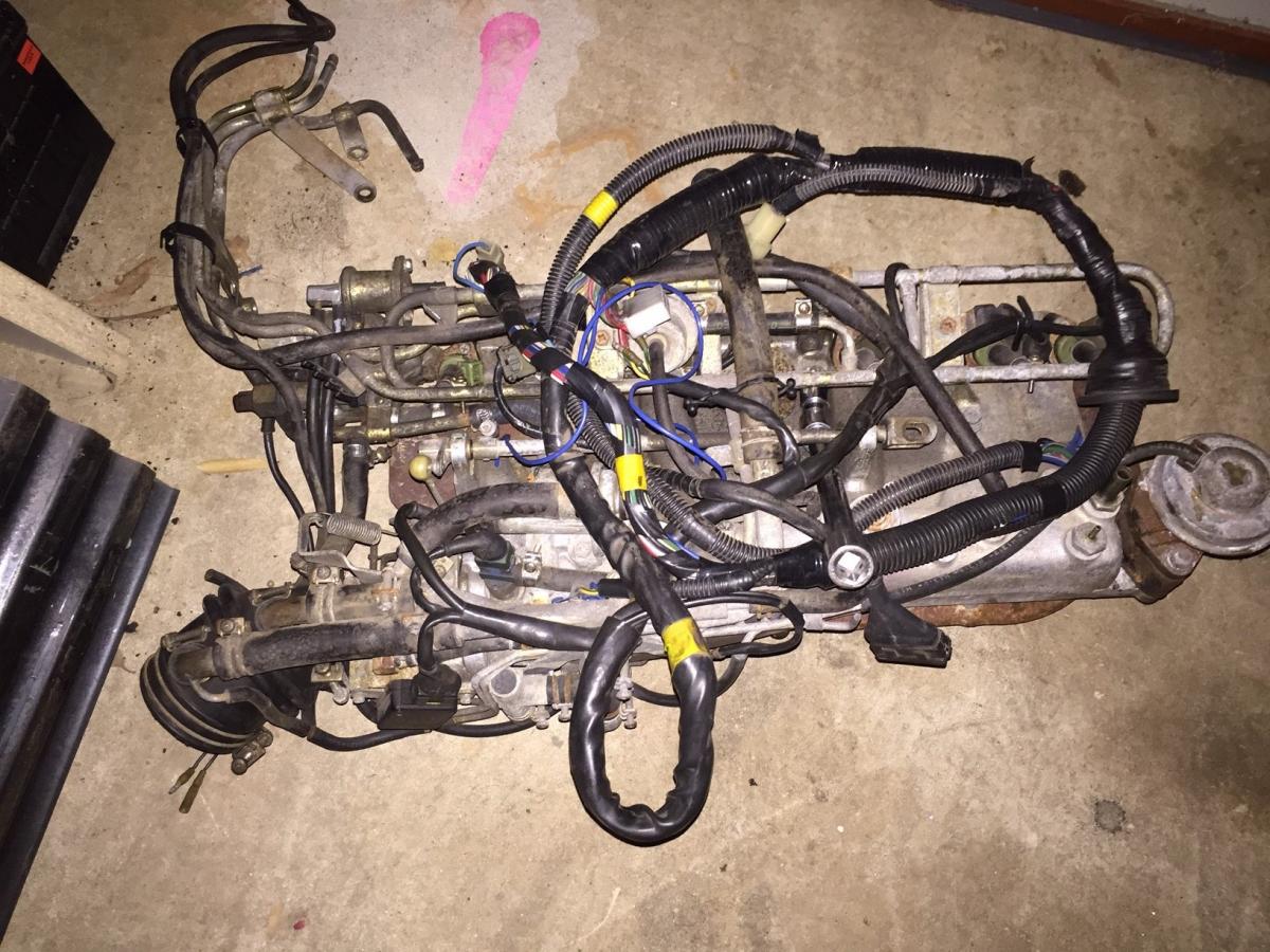

Brabham Posted December 22, 2015 Posted December 22, 2015 That L28 induction looks like a tangled ball of snakes! Nissan didn't make that very pretty. Hope to see the car out and about soon Quote
Moderators PB260Z Posted December 22, 2015 Moderators Posted December 22, 2015 Hi Alex Yeah not the tidiest of setups and looks especially bad in that image as I have all the loom from the ECU rolled up on top of the rest. Cheers PB Quote

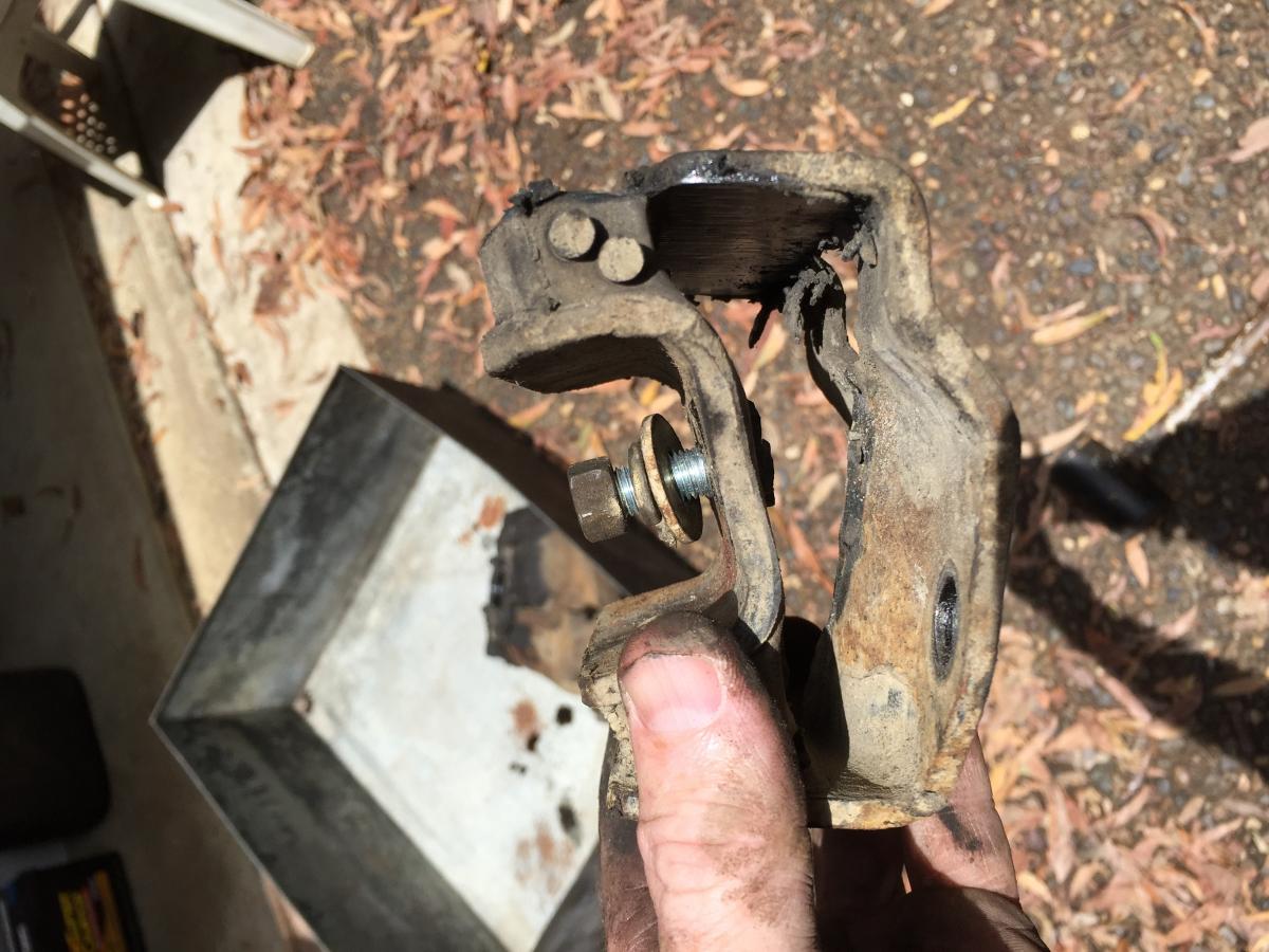

Moderators PB260Z Posted December 27, 2015 Moderators Posted December 27, 2015 Found the source of the bump coming from the rear - no surprises really Quote
Administrators gav240z Posted December 27, 2015 Administrators Posted December 27, 2015 Diff mount? Quote
Moderators PB260Z Posted December 27, 2015 Moderators Posted December 27, 2015 Diff mount? Well, what is left of one. All good got a new one from Warren a week or two back. Now to check the diff ratio and see what that tells me Quote
