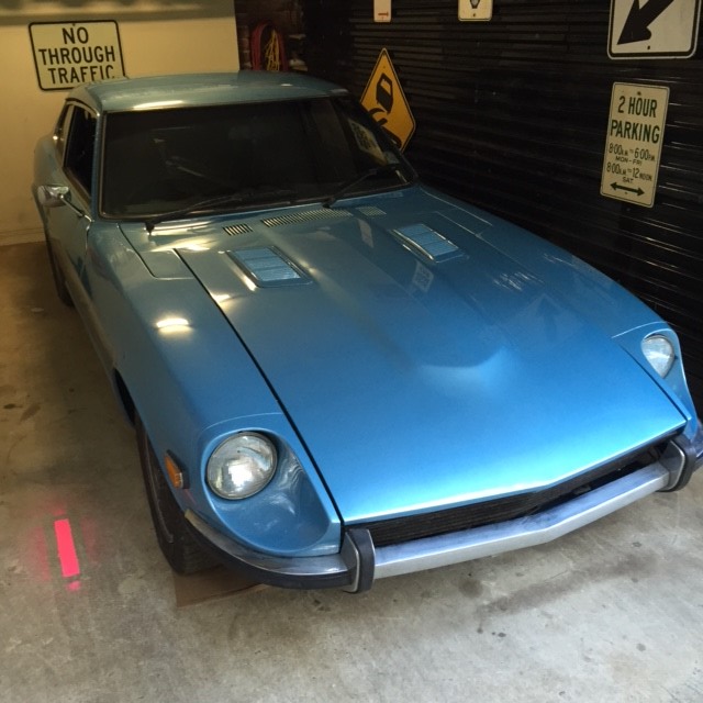

Moderators PB260Z Posted August 15, 2015 Moderators Posted August 15, 2015 Hi All A couple of photo's of the bus when I got her back to Sydney last Sunday after the Paint & Panel was finished. The car hasn't been used for about 4 years so now begins the task of getting her back on the road. Tomorrow I will (hopefully ) sort out the rough running and make a start on fixing the ride heights, currently the nose is about 50mm lower that the tail Cheers PB Quote

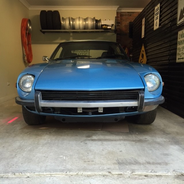

Moderators PB260Z Posted August 20, 2015 Moderators Posted August 20, 2015 A quick update Have fitted the Kings Springs KDFL-04 & KDRS-09 and 260Z 2 seater rear hats. Also fitted a set of "Rego Friendly" 195/70-14 tyres (these are the standard size) tyres. The result ? The front is now 8mm or so lower than the rear. A very pleasing result for height and stance. Now to sort out the negative camber. Quote

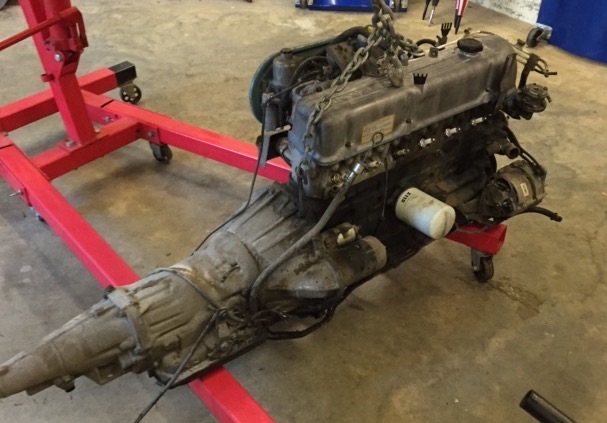

Moderators PB260Z Posted August 23, 2015 Moderators Posted August 23, 2015 Fun day yesterday I made a start on the rough running and other things for rego, I came up with this initial list - Overhaul and tune carbies - Fix ehaust manifold leak - Fix flange gasket leak - Fix rear main seal leak - Replace diff strap. - Replace rack boots I have decided not waste any time or money on the L26 & Auto and instead go straight to L28 Manual & R200 swap. Accordingly pulled out the L26 & Auto yesterday afternoon. This will put rego further away, but, such is life. Cheers PB (will post a photo or two later) Impatient1 1 Quote
CroS13 Posted August 23, 2015 Posted August 23, 2015 Stance looks good Pete! i cant remember did you replace the shocks too?Rudi. Quote
Moderators PB260Z Posted August 23, 2015 Moderators Posted August 23, 2015 Hi Rudi. Thanks, I am happy with how it is sitting now, just need to swap the front mounts back to standard. No I didn't replace the shocks, they seemed OK on a shortish test drive and have no leaks. Cheers PB Quote

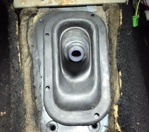

Moderators PB260Z Posted August 24, 2015 Moderators Posted August 24, 2015 (edited) Today only a small step forward. Transmission tunnel mod completed. Edited August 24, 2015 by PB260Z Quote

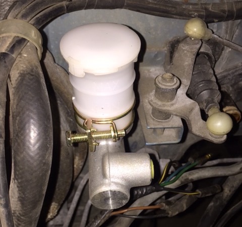

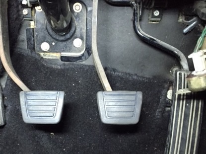

Moderators PB260Z Posted August 26, 2015 Moderators Posted August 26, 2015 A little more progress, Pedals and Master Cylinder sorted. Hopefully will get the L28E out of S130 on the weekend. Quote
Moderators PB260Z Posted August 26, 2015 Moderators Posted August 26, 2015 (edited) The pedal bushes fitted OK?Mate, an absolutely perfect fit. Time will tell if they will need a thrust washer.Will probably grab another set for the brake pedal as compared to the clutch it feels a little loose. Cheers PB Edited August 26, 2015 by PB260Z Quote

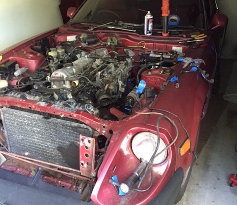

Moderators PB260Z Posted August 30, 2015 Moderators Posted August 30, 2015 Started the next step of the project, getting the running gear L28E, Manual & R200 out of the rusty old S130. This marks the end of the road for ZX, once I have removed all I need she will be scrapped. Quote

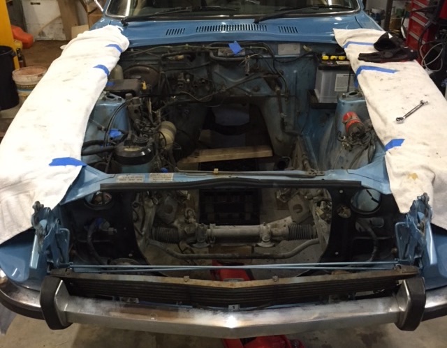

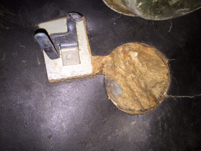

Moderators PB260Z Posted September 1, 2015 Moderators Posted September 1, 2015 Had a bit of a look at how best to fit the EFI loom into the Bus tonight. Low and behold what should I find in the passengers footwell ? A cut out in the underfelt and a clip to hold loom in exactly the place I intend to pass the loom through the firewall. Love it when a plan comes together. George 1 Quote

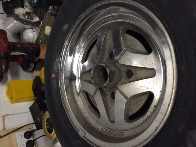

Moderators PB260Z Posted September 2, 2015 Moderators Posted September 2, 2015 (edited) Broke out the Autosol and cordless drill to attack the rims. Just amazing what a big difference you can make in very little time. No they won't be perfect but they will be 1,000% better. Edited September 2, 2015 by PB260Z Quote
George Posted September 2, 2015 Posted September 2, 2015 I love those rims Pete. I have a set myself so when you finish there... Quote
Moderators PB260Z Posted September 3, 2015 Moderators Posted September 3, 2015 I love those rims Pete. I have a set myself so when you finish there... : I will lend you what is left of the polishing wheel ? Quote

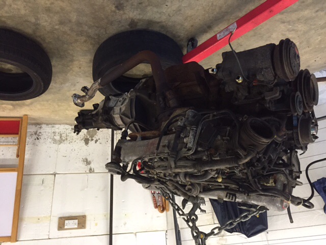

Moderators PB260Z Posted September 4, 2015 Moderators Posted September 4, 2015 Another step forward today. Got the L28 out of S130. Now to fix a leak or two, swap over the ancillaries then tidy it up and drop it in S30. Quote

Moderators PB260Z Posted September 6, 2015 Moderators Posted September 6, 2015 Well, I ran into a minor "speedbump" in the project tonight. Swapping in the R200 isn't going to as straight forward as I had hoped. The doner S130 has an R200 mated to CV drive shafts, whilst the S30 has an R180 mated to uni's, So a bit of research needed to determine the best way forward on that front. For now will stick with the R180 and see how it's ratio works with the manual box. The fun of it all Quote

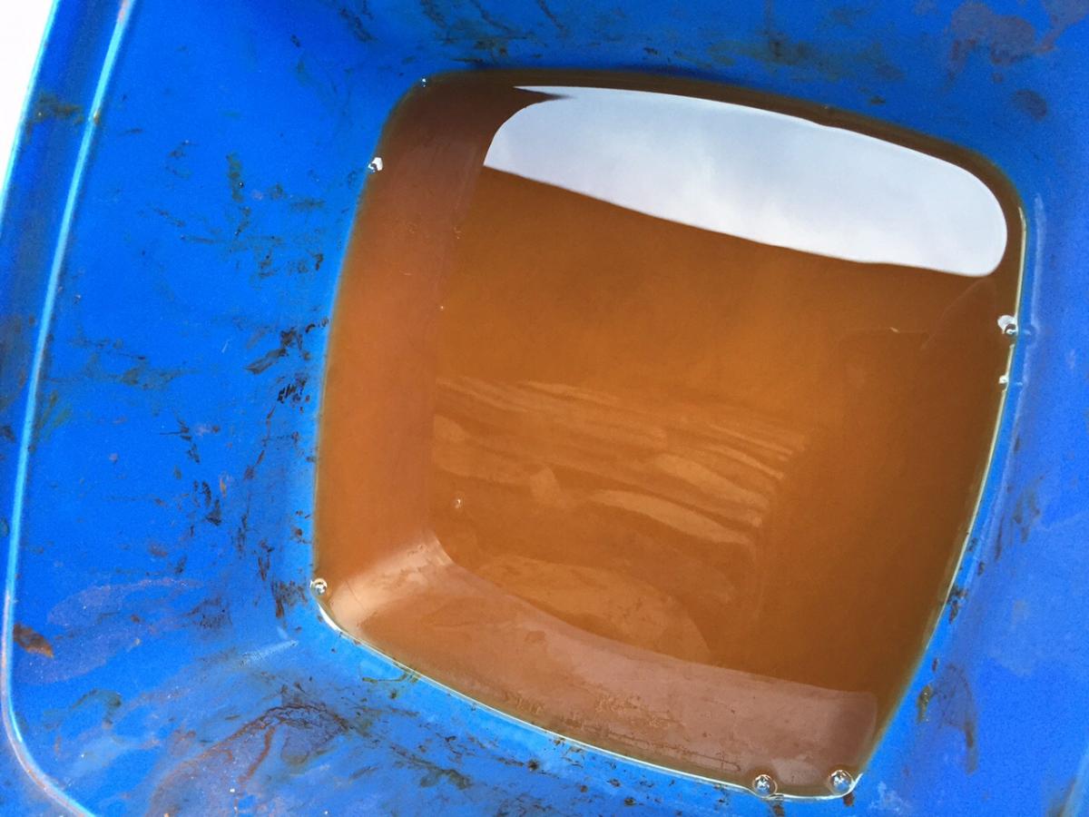

Moderators PB260Z Posted September 12, 2015 Moderators Posted September 12, 2015 Hi Today I started on transplanting the fuel pump, regulator and related hardware from the S130 to the S30. This will require a custom fuel pump & regulator bracket. Time to get out the welder and fabricate something - love this type of work. It is amazing the S130 was even running given the fuel that came out of the lines (see image) guess it proves that fuel filter is working. Quote
George Posted September 12, 2015 Posted September 12, 2015 That looks like the water that comes out of my air compressor. Quote
