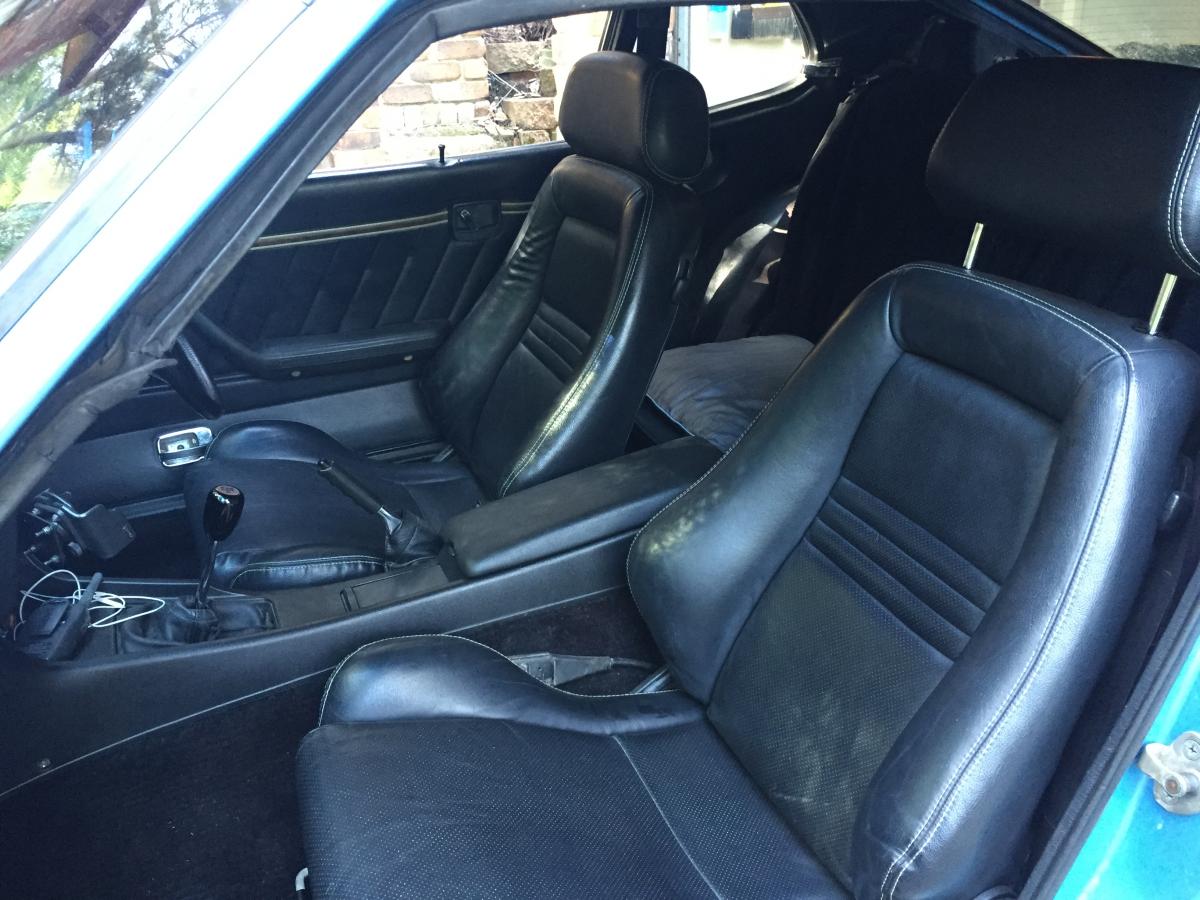

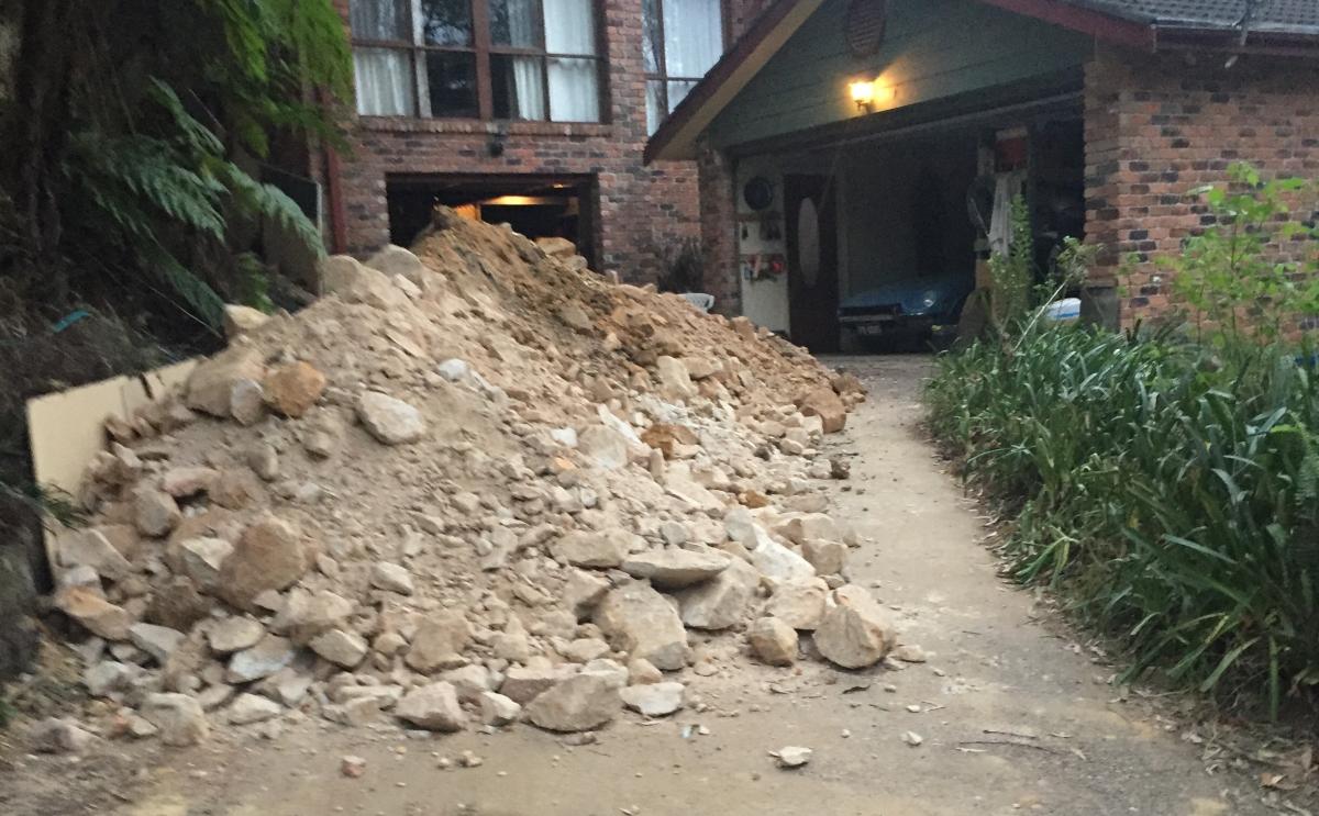

Moderators PB260Z Posted October 24, 2017 Moderators Posted October 24, 2017 Hi AllThings have pretty busy for me with work and a major landscaping project at home so I haven't had much time get out in the Z, truthfully for a while a couldn't even get it out of the "Z Shed" due to the huge amounts of dirt piled up on the driveway. Anyway, the dirt has cleared so I have made another step forward, and one I have been hoping to do for a while - New seats.Just in time for an upcoming roadtrip Quote
Administrators gav240z Posted October 24, 2017 Administrators Posted October 24, 2017 Peter you driving down solo or with folks? Quote
Moderators PB260Z Posted October 24, 2017 Moderators Posted October 24, 2017 Peter you driving down solo or with folks? Currently Solo, Down Saturday, Back Monday Quote
