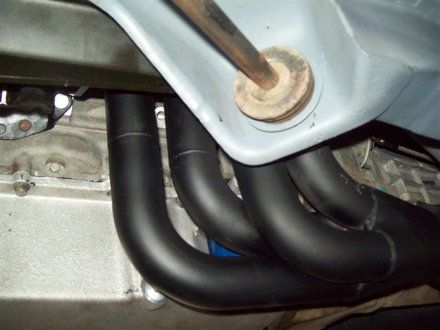

acf321 Posted October 26, 2012 Author Posted October 26, 2012 Actually did something about the Hornet this week... Called James Flett at M.I.A Engine Services, who built my engine and asked about the right exhaust to put on the car. He suggested 2.5" straight through. Got on the phone and called Castle Hill Exhaust and then Liverpool Exhaust for two quotes. Circa $800-900 for a mandrel bent 2.5" stainless system from Extractor back, with mid resonator, and rear 'straight through' sports muffler. Not sure, but sounds OK to me from a pricing perspective. Out of interest, they did say the mild steel equivalent would be $400-$450, ie half. Now just on another question Aaron has a 'tig welded' exhaust on his masterpiece, and I have just read Gareth's bit about Tig welded trumpets. Can anyone tell me what is Tig welding, and why would I specifically ask for this? Is it lighter / neater, or just more exxy? Cheers Adam. Quote

Roberto Posted October 27, 2012 Posted October 27, 2012 Adam, I cannot tell you how happy I am with the PMC magnaflow exhaust. There is no drone / boom / resonance at all and not too loud, but a straight through system with proper mandrel bends so free flowing. Quote

Riceburner Posted October 27, 2012 Posted October 27, 2012 I think there's pics of Peter Mac's sytem on Roberto's build Adam. Sounds great and looks to be show car quality. Did James say anything about a 3" system? From what I've read and recommendations 3" can be beneficial depending on engine/intended use. From my experience MIG would do the job and be more cost effective than TIG, but I'm just a plumber! I can't wait to hear this and as the club saying goes........ 'Video or it didn't happen' Lol. Quote
acf321 Posted October 28, 2012 Author Posted October 28, 2012 Yes Gareth .. there WILL BE video evidence!! Remember the Hornet has been hibernating under a plastic sheet for about two years, and i've been to see it only once this year. It's like this awesome christmas present just sitting there ready to be unwrapped! On the question of the 3" system, James was pretty clear that the car only needed a 2.5" system, and the two chaps i spoke to at Liverpool and Castle Hill both suggested 2.5" as the biggest needed. At the end of the day, the SWR extractor collector is only 2.5", so making the exhaust any bigger than that would be surplus to requirements. Not to mention, bigger pipes are heavier! I'll be using the car for perhaps the odd track day, and fast (did i write that) Sunday morning fun. I should also mention here that I have a perfect 'as new' rear windscreen with vertical demister in a foam box ready to install in coming months. James' car has this and it looks the goods, just finishes off that old school look perfectly in my view. I need to get another oil catch can too, as i sold the last one I had given it was not deemed good enough for the job. Actually thought a period (1971) Castrol oil can / bottle with a tube coming out the top of it might actually be the right look to go for. Yet another small detail to get resolved. Anyway, thoughts and recommendations are always appreciated. Cheers Adam. Quote

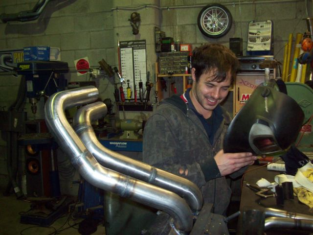

peter mc Posted October 28, 2012 Posted October 28, 2012 Up to 280hp the 2.5 is all that's needed , but if you are chasing 300+ 3 all the way , on a good race engine there is 15hp from 4000 all the way to 8000 with a much better torque reading . on a 2.4 or 2.6 id never fit a 3in its just not needed , and as for welding tig is more expensive because the time factor , i can do the job in half the time with a MiG , and it would do a good job , but if you want a SS exhaust that looks good and is a quality thing it has to be tig Quote

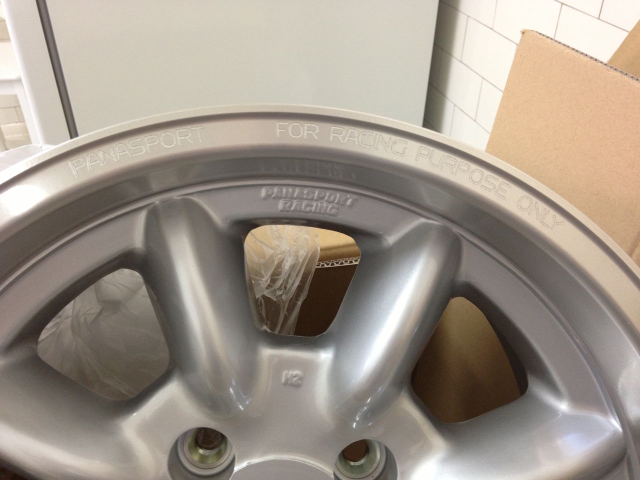

acf321 Posted November 23, 2012 Author Posted November 23, 2012 Actually did something this week i've been wanting to do for over 10yrs, that is bought a set of Panasport Racing 8 spoke wheels for my car. Dimension is 15X7 with zero offset. I bought the track wheels, given they're the only variant now made, but more importantly, they're ONLY 5.5kg a piece, versus the road variant at ~6.5 kg, and say mini-lites or Compomotives at say ~8kg a corner! Know what they say about unsprung weight! Straight silver wheel with polished lip is the colour scheme. Will be running 205/60 series rubber, perhaps Advans or some form of sticky Dunlop / Bridgestones. James is running the exact same wheel and tyre combo, and I'm struggling to find a better looking wheel / tyre combo than this hands down. Interestingly, the green car here also runs the same Panasport, but to my eye, these 16" wheels are just that bit too big. My Charcoal 15" watanabe F8's with Dunlop Formula R tyres are now in the for sale section. So am I right, is this not just the best old school (ex JDM) look?!? (perhaps showing my years these days!) Cheers Adam. p.s oh yeah, wondering why I went for 15"? smaller and lighter, inspired by the other orange car here! Gotta love a good bit of fat old sidewall! Quote

Riceburner Posted November 23, 2012 Posted November 23, 2012 I've got the Aus classic car mag with James' orange car, the 'stance' looks great with plenty of travel. Wow 5.5kg's is damn light, Awesome! Quote

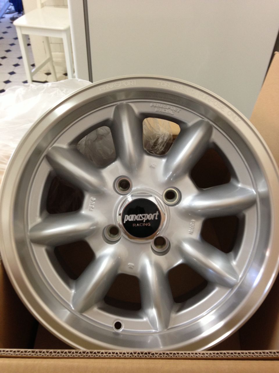

acf321 Posted January 30, 2013 Author Posted January 30, 2013 BIG development ... Panasport Ultra light wheels arrived yesterday and I think they look absolutely fantastic. I can't explain why, but I actually prefer these wheels to Watanabes. Weight is very minimal at ~5.2kg as I stuck with 15*7", and UL takes about 1kg off per corner over standard. This means I need to buy tyres very soon (Dunlop Direzza Star Spec - yep silly name I know, but excellent intermediate tarmac rally / road tyre), and then its off to the exhaust shop to have that 2.5" mandrel system installed. At that point, we're about 98% the way done save for one or five little tid bits. I've gone back to Jim's car with the exact same wheel and tyre size, and the red car, with slimmer rubber on Panasports. Quote
