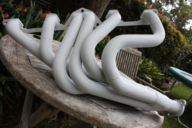

acf321 Posted September 24, 2011 Author Posted September 24, 2011 Ok, went back to have a look at the Hornet today and did not have the heart to lift the sheet... nothing has happened in a while! However, I did call SWR to order my custom extractor kit that i've decided to have ceramic coated as opposed to a more simple paint finish. The theory goes that not only does the ceramic coating inside and out protect the metal from oxidization literally forever, but conceals the heat of the exhaust gasses inside the extractor, so as to; 1) improve the scavenging effect of the extractor, and 2) minimise heat soak into the surrounding engine, car and importantly carbs. Whilst the usual silver coating is normally preferred, I actually chose white to replicate the look of the aluminium oxide coated extractors of the 60's and 70's formula one cars. Here is the inspiration for my white ceramic coated pipes, which I should be collecting next weekend. Hope you like! Quote
Whittie Posted September 24, 2011 Posted September 24, 2011 You'll love the ceramic coating! It's true what they say about increasing the scavenging effect, the heat keeps the volume of the gasses up for a longer distance, and hence a larger effect as each cylinder exhaust gas can only pull gas from other cylinders once it reaches the collectors. I have the silver ceramic on mine and they went dull after 1 track day. They were chrome for the photo's tho, but are now a grey, White is a much better colour!! Also, it's true about the heat, I can come in after 20 minutes on the track and actually hold onto the extractors with a bare hand! It's incredible how much insulation the coating provides. It also helps keep engine bay temperatures down by a lot and with the extractors so close to the inlet venturi's it makes an even bigger difference. Quote

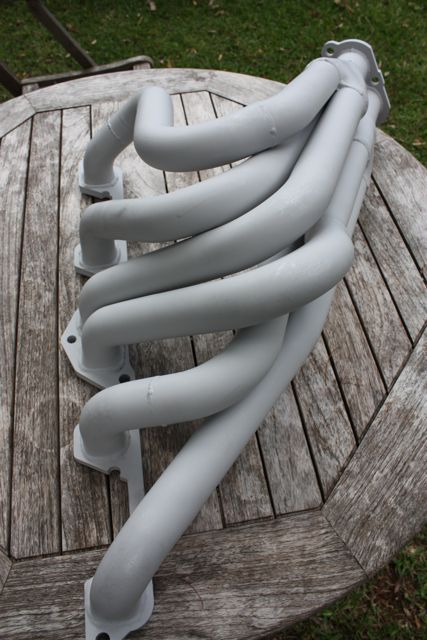

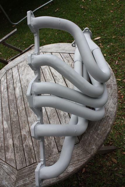

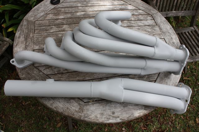

acf321 Posted October 1, 2011 Author Posted October 1, 2011 As promised, another update on the Hornet. Popped out to Stewart Wilkins this morning to collect my extractor kit which I had asked to be coated in white ceramic. The good news is the extractors look superb, as Peter Mc had suggested, with all welds, bends and collector junctions finished to a very high standard. The coating is more a powder finish, which I suspect in time will be more grey but to me this is the better choice than a chrome look. I spoke to Stuart about suspension, and he confirmed that the koni yellows are a fantastic choice that they use all the time to great effect. He suggested adding a coilover threaded part to the standard leg, so we could infinitely vary ride height, spring rate, and strut stiffness. I'll get round to this once the Hornet is on the road, but as a minimum, I'll get koni yellow's installed, like Andrew and Chris240 have done. I also took out my Mk63's to ask about refurbishment. We will remove the pistons (i have two sets) and have them machined and then re-chromed to make them as new. Stu will also blast the calipers and set them up properly. I'll have Nat spray them in hi-temp paint, or if I can, I'll find the OEM paint finish and colour and have them done that way. If anybody knows the colour or correct factory Mk63 finish, i'd love to hear how they were done. Anyway, here are some pics of the extractors. I think they'll be great. Quote
benny Posted October 1, 2011 Posted October 1, 2011 they look pretty... what is the diameter of the primaries?? Quote
acf321 Posted October 1, 2011 Author Posted October 1, 2011 primary's are 1 5/8" and the collector and exhaust pipe is 2.5". Quote

peter mc Posted October 1, 2011 Posted October 1, 2011 nice mate you can not buy better pipes under $1500 they work a treat Quote
NZeder Posted October 1, 2011 Posted October 1, 2011 They look great hmm if I ever go L6 again those could very much end up in between the struts of a zed I own Quote

acf321 Posted November 8, 2011 Author Posted November 8, 2011 Hello Folks briefly had five to call Nat today and enquire about the extractors. The good news is he has put them on, and the less exciting part of this was that he needed; 1) a hammer, and 2) a file to make them fit !!!! Hhhmm I thought to myself, before thinking hmmm again. Nat is a complete fanatic, so I gently asked if he'd cracked any of the ceramic coating off, the answer of which was 'no'. Apparently the issue was that there was literally no room between the inlet and the extractor, such that he had to 'very very modestly flatten the top of the extractor, and file the underside of the inlet manifold'. He told me not to worry, and that often this kind of fine tuning is necessary to get a proper fit. I guess this is right, although not having tried this I cannot comment from experience. He assures me that the set up is excellent, and there is very little to be worried about. I do trust Nat, so I am hoping to pop out Sat morning early to have a look and grab a few photos. I'd say it'll be going to the exhaust shop in December, so that should be the start date! More to follow. Quote
