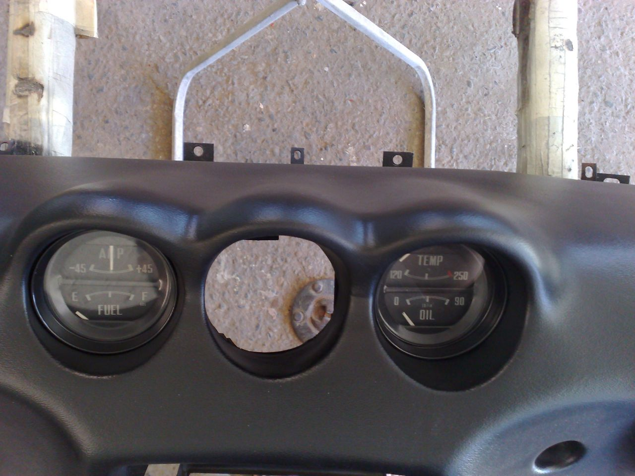

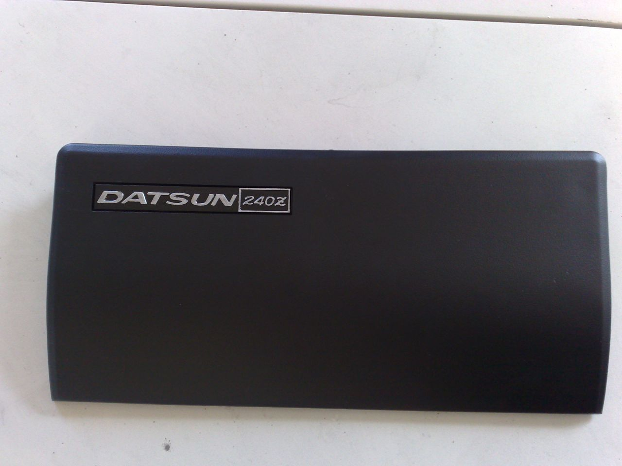

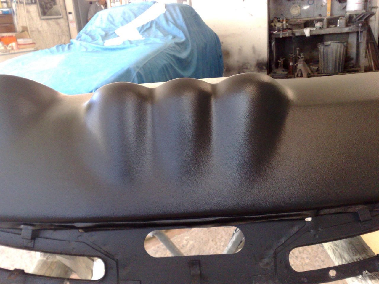

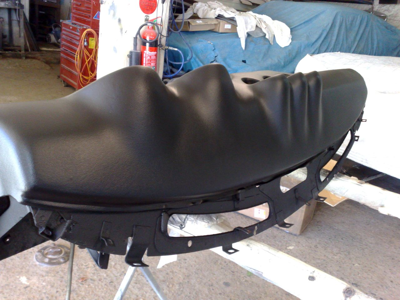

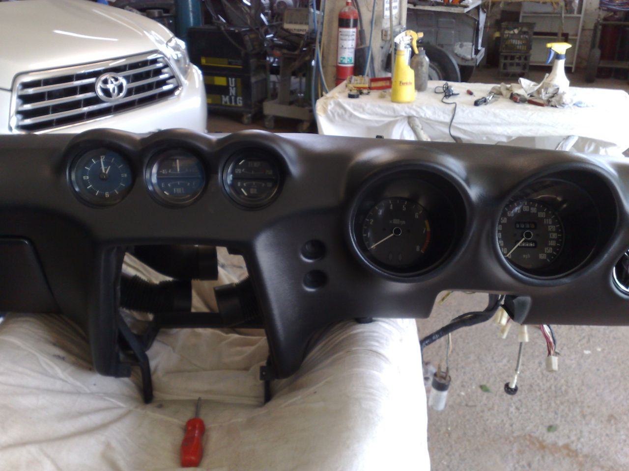

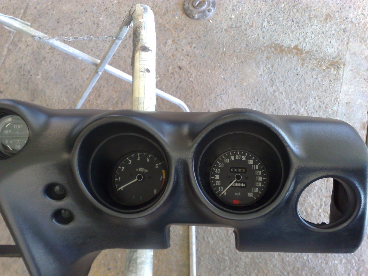

acf321 Posted October 16, 2010 Author Posted October 16, 2010 Week 68... Not much has happened these last few weeks, but today I went over to Nat's shop to have a look at the re-skinned dash. Before we opened it I was pretty skeptical as i've seen some really poor dash restos before. On opening the package, this was anything but shoddy. The fit and finish is perfect, as is the way they matched the new skin to that of the factory finish glove box lid. Nat hand painted the glove box emblem too, and from my perspective, that looks excellent. We pulled all the gauges apart, cleaned them, polished the lens and re-assembled. Aside from the clock that is not working, all else is a perfect fit and to me looks factory fresh. We'll paint the centre console in the coming week or two, and with the new choke and throttle levers, the interior should start to look as fresh as the outside. I'm awaiting another shipment of parts from the US this week, which includes F&R strut top caps, and new gear shift bush, and a set of OEM exhaust/inlet man washers so we can send the car off to the exhaust place. Hopefully more to report in a week or so, when Nat will have the dash, door linings and maybe centre console in place. cheers Adam Quote

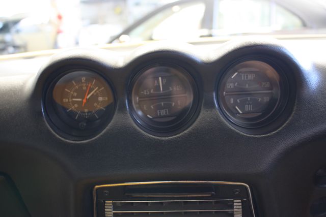

NZeder Posted October 16, 2010 Posted October 16, 2010 re the clock - common issue and I think it is a Cap that fails. Dash looks great like the rest of the car too Quote

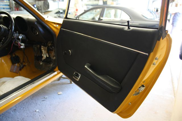

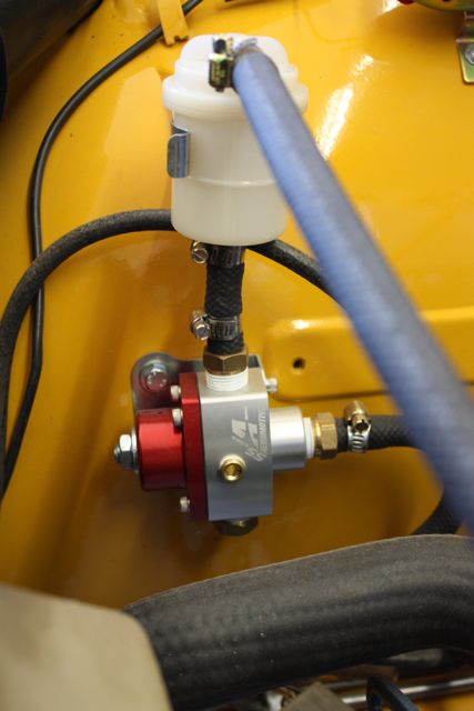

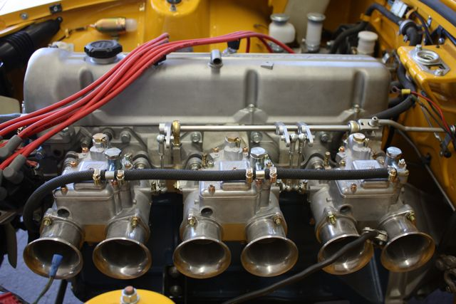

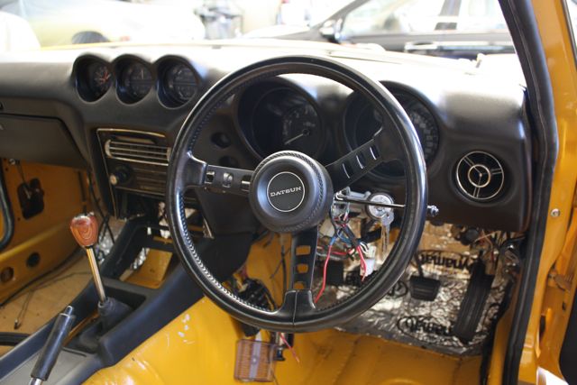

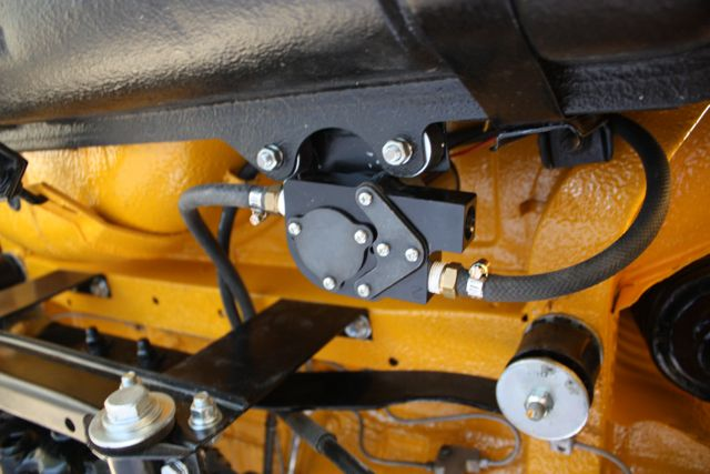

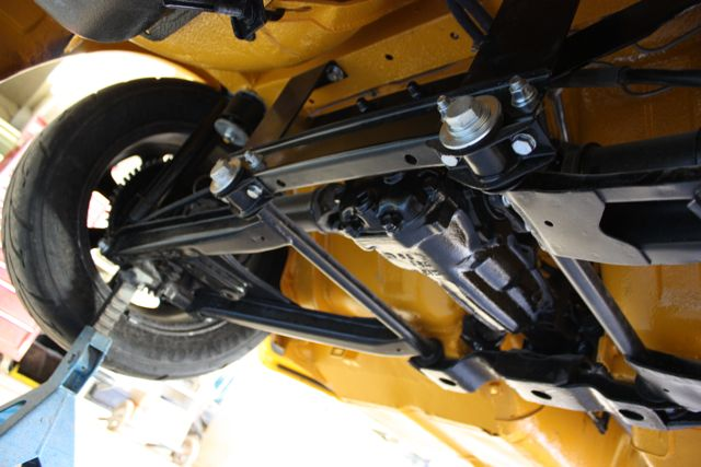

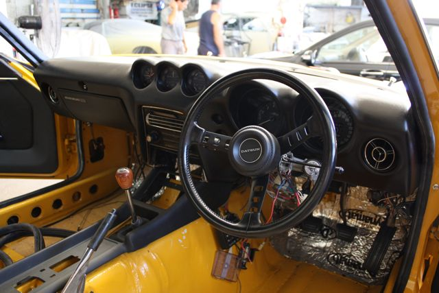

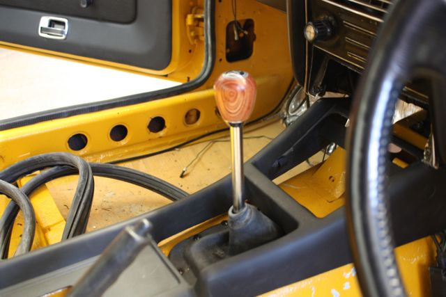

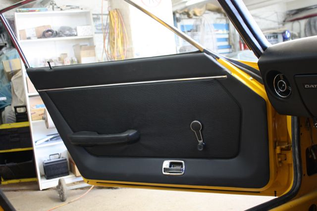

acf321 Posted January 22, 2011 Author Posted January 22, 2011 Its been about three months since I went down and had a look at the Hornet .. it was a much needed break for me, and by bank account. Nat's been busy though .. and I took a few photos. The car is very nearly ready to be driven now. All we really need to do is complete the interior (seats are done), balance the wheels, add a battery and exhaust and the car should be right to go. A few more things like the correct length of door seal rubber, aligning the rear hatch, putting on the bonnet, and finalising electrics. Here's where its now at; 1) Selector is now installed with 4 speed gear knob (i will be chasing up a 5 cog number in due course). This was just done by gently heating and bending the rod back dramatically from the centre point, as was done in Lurch's red car. I have a photo with the console in place, and the car in 1st gear, to show how much room we have left, not much, but sufficient. The transmission feel is genuinely like a rifle bolt, given the tranny is rebuilt, and there are all new bushes in the selector. The shorter shifter feels rather more like an MX5 too, which is not a bad thing, 2) Dash is installed, including the magnificent Cali-clock from my very good mate Mike. All the dials have been disassembled, cleaned, and the lens cleaned. They really look impressive in the flesh, and like new, 3) The Compe Steering Wheel is on and looks just perfect.. Old School Fast look 4) All electrics are now operational, and the centre console is all connected, with new rods for the air vent and heater controls. The fascia is the original one, and is a little shabby, but does remind me the car is a 71 model, and not a 2011 model. I restored the side vents (with super fine steel wool that made them like new) but have yet to complete the middle vent, 5) Centre console fits perfectly, but will need the small holes drilled for the rear following my refurbishment of it last year, and we'll be re-spraying it in the correct 2-pack paint to ensure it wears better than the cheaper canned stuff that's on it now. I think it looks great, and given it was a busted up mess when I got it, it really looks the part, 6) Fuel lines are in, including elec fuel pump, and regulator (see photos). We went for a simple type single line and have not put in a return line yet, but should there be an issue with this, we'll add a return later, 7) New door cards are in, and they look brilliant! - still available last year so if you have the means, grab a set via Nissan while you still can. 8.) Seats are recovered, but as I was not happy with the tension of the fabric, they'll be going back to be re-done. Enjoy the photos. Shouldn't be too long now! Cheers Adam Quote
Riceburner Posted January 22, 2011 Posted January 22, 2011 Compe wheel and calender clock, good choice. It's Awesome mate, this is an immaculate zed! A dream car Any progress with the headers? Quote
acf321 Posted January 22, 2011 Author Posted January 22, 2011 Thanks Gareth. On the headers... yes, Andy is still going to be doing the firing order set of headers, but given i've had a break and need to finalise with Nat before we move the car out, it might be a few weeks, if not a month or two to get the exhaust done. Not sure if I mentioned it, but i'm getting a custom 1 5/8" ceramic coated mild steel header, with 2.5" mandrel bent stainless system with mid resonator and rear sport muffler from there back. Yes, must say I have taken a little more than some inspiration from your car, its a monster! Cheers Adam Quote

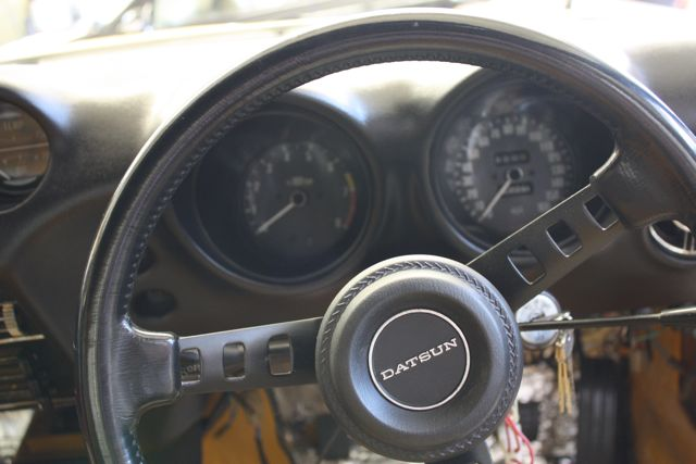

Lynton Posted January 22, 2011 Posted January 22, 2011 Adam did you get your stock steering wheel foam grip reconditioned and if so who by? Looks great Lynton Quote
mossy Posted January 22, 2011 Posted January 22, 2011 Adam did you get your stock steering wheel foam grip reconditioned and if so who by? Looks great Lynton The steering wheel is a Nismo compe handle steering wheel, very pricey but very nice! Quote
Lynton Posted January 22, 2011 Posted January 22, 2011 Adam do you have a supply source, Lynton Quote
