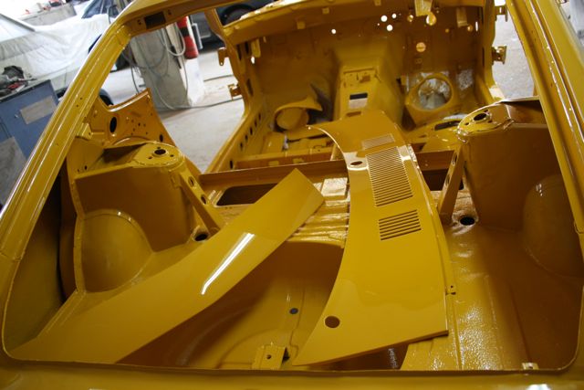

Administrators gav240z Posted January 16, 2010 Administrators Posted January 16, 2010 Looks amazing, I'm sure you are really happy with it. I like the period colour and I think its going to look really good when you get it together with Watanabe's and the L24 in there . I was wondering where you were due to no updates, now I know. Quote
FLEXZED Posted January 16, 2010 Posted January 16, 2010 hey mate i was wondering what you have been up to, now i can see, looks AWESOME cant wait to see it in the flesh Loui Quote

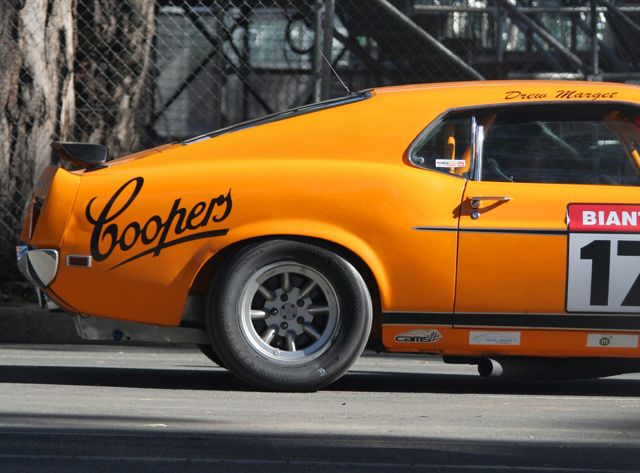

Brabham Posted January 19, 2010 Posted January 19, 2010 Nice choice of color, I am a huge fan of the Can-Am Mclarens. It must be very close to that new Ford orange I have seen on the Falcons, it reminds me of Mclarens when I see them. Only trouble is they are Fords Quote
NZeder Posted January 19, 2010 Posted January 19, 2010 I love the colour very period correct and just slightly different to normal colour choice - love it. Don't know about you but red 240z - over it (well I have owned 2 red ones and it is the most common colour) so it is good to see something different but still in keeping with the cars period. It is like the 920 safari gold that so many don't like (me having seen HS30-H which is 920 I like the look) but not as mustard and a little up the scale on the orange = perfect. Good choice Adam Quote
lightmaster240z Posted January 19, 2010 Posted January 19, 2010 Lov the colour. It is looking great. I look forward to seeing it progress to a lovely finish project regrads Bruce Quote

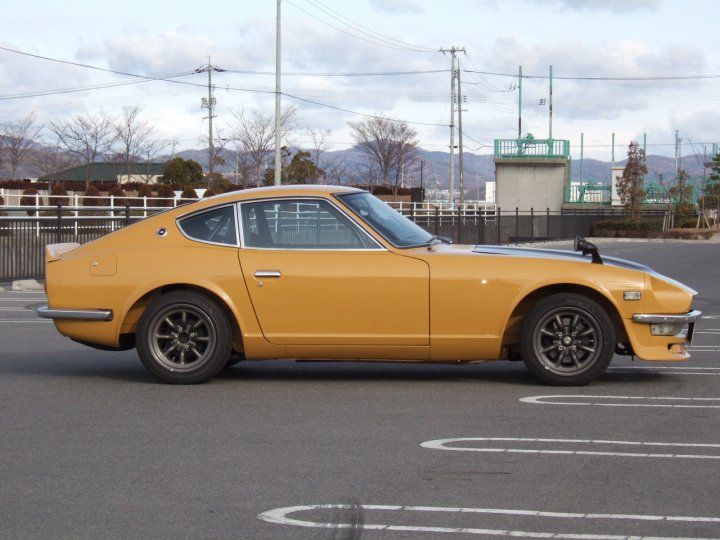

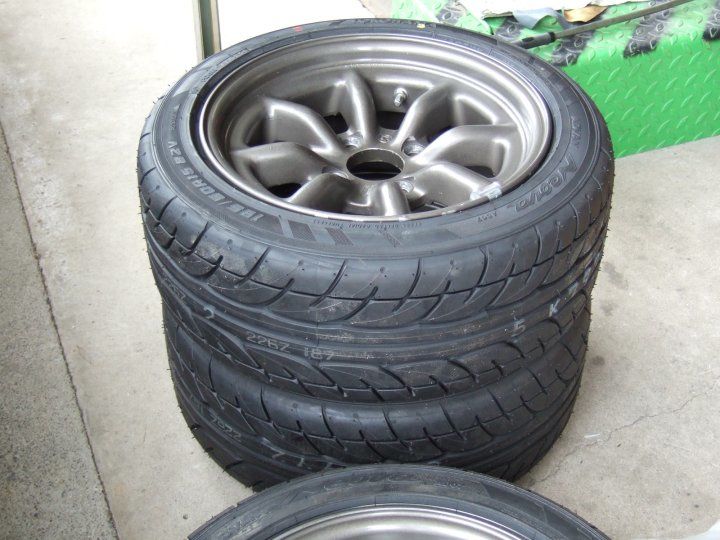

acf321 Posted January 23, 2010 Author Posted January 23, 2010 Week 35... The hornet is being bolted back together with doors and guards on today. No photos as I thought i'd wait a week or two for some more. On another note, I bought my Watanabes today second hand but in as new condition. They are F8 15x7.5 in gunmetal grey. They come with a set of Dunlop Formula R tyres, the exact ones I was intending to use anyway. Accordingly, i'll be selling the Performance five spoke's shown in this thread if anyone's interested. I've not picked the wats up yet, so added a photo of Tomitaku's exact same wheels (F8 15X7.5). Adam Quote

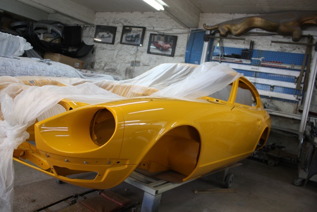

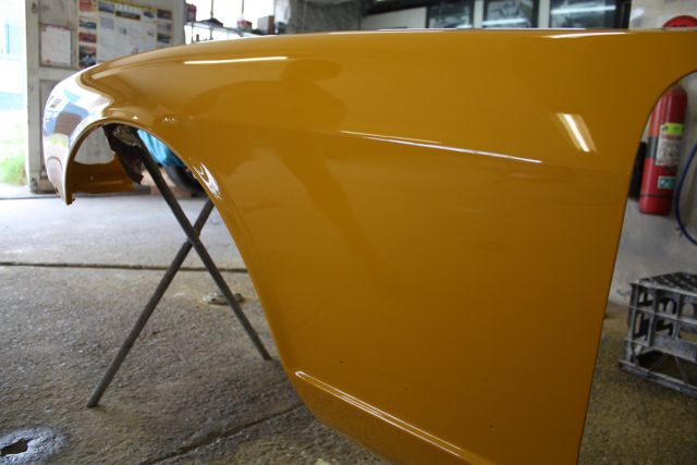

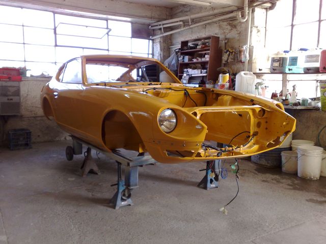

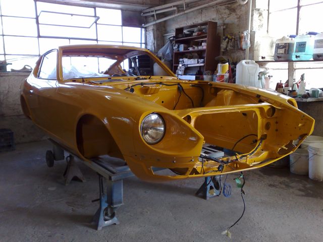

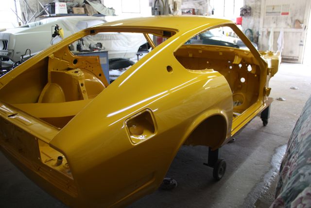

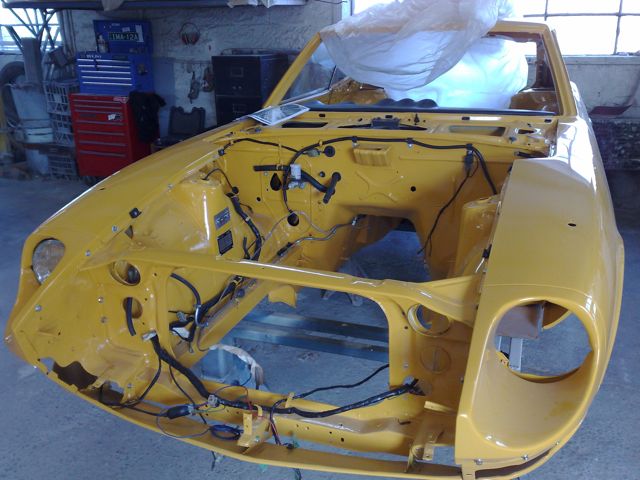

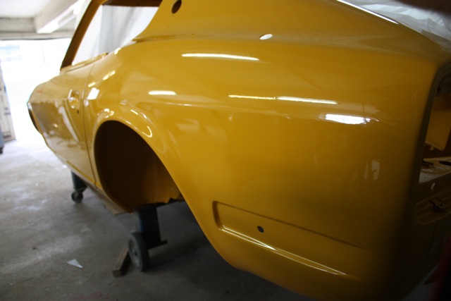

acf321 Posted January 25, 2010 Author Posted January 25, 2010 Here's the latest from today's visit. Once its fully assembled, we're going to make a decision as to whether it needs a shot of clear, and what buffing is needed. At this stage, its pretty much straight off the gun. Took down a box of rubber and parts for Nat and the boys to start putting on. Just also ordered new door locks (2nd hand), gear knob and master cyl caps. Hopefully we're just about there on new parts. Some parts I can't find that you may have lurking somewhere inc; 1) black caps that clip onto the circular seat back adjustment knobs (these are circular black plastic things), and 2) metal clips that hold the base of the rear tail light garnish to the car (they are welded onto the body under the tail lights - two per side). If you have either, pls drop me a PM. Next step is to get the suspension redone. Thanks to the help of nzedder, i'll be using koni yellow (externally adjustable) shocks, and lowered springs. I think I have King springs in there now, but depending on where we need to set the ride height, these will likely be cut, or we'll go for some K-Mac items (anyone used these? thoughts vs Kings or others?). Am staying away from external camber adjustment plates etc etc etc at the moment as we can add these later is needed, and I just want this thing running. Should be getting the wheels tomorrow. Nat is sending off all the metal fasteners / brackets / door strikers etc for yellow zinc plating. Ordering all new nuts and bolts for the body to ensure a tidy finish. Dash is pretty good, but might have gauges tested and cleaned. Cheers Adam Quote

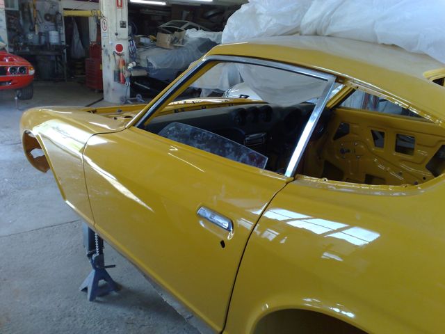

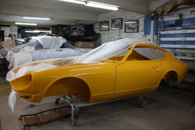

acf321 Posted February 19, 2010 Author Posted February 19, 2010 Week 39 ... starting to look like a car ! Quote

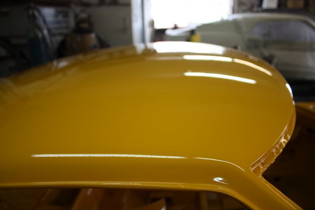

acf321 Posted February 20, 2010 Author Posted February 20, 2010 thanks guys . the cost does make me sick, but the results speak for themselves, and the colour in the flesh really looks excellent. Just wait'll we stick on the watanabes and lower it to the weeds. Quote

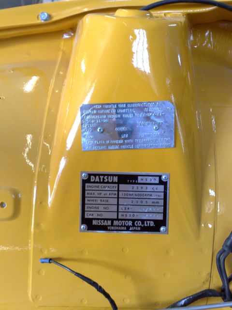

garvice Posted February 20, 2010 Posted February 20, 2010 Mate what were they thinking when they put the nissan plates back on. They have done such a quality job with the car then they clearly put the name plate on crooked. That would bug the crap out of me, don't know how you can put up with it. Quote
acf321 Posted February 20, 2010 Author Posted February 20, 2010 Hey Garvice ... good to hear from you mate .. you must have burning ears, as we were questioning if we could get any new rubber seals for the rear hatch hinges, as you were making. Any luck on this? On the nissan plates, i know what you mean, but that is the way the Aussie RTA put them on back in the day, the holes are alread there. I could change it, but it would be making new holes. Having said that, Nat is not happy with the top plate and we are going to glue it to the panel, so it will come off and be changed slightly before its completed. I put the watanabes up beside her last week and it just looks completely insane .. we were all just bowled over by the colour / symmetry. Quote
