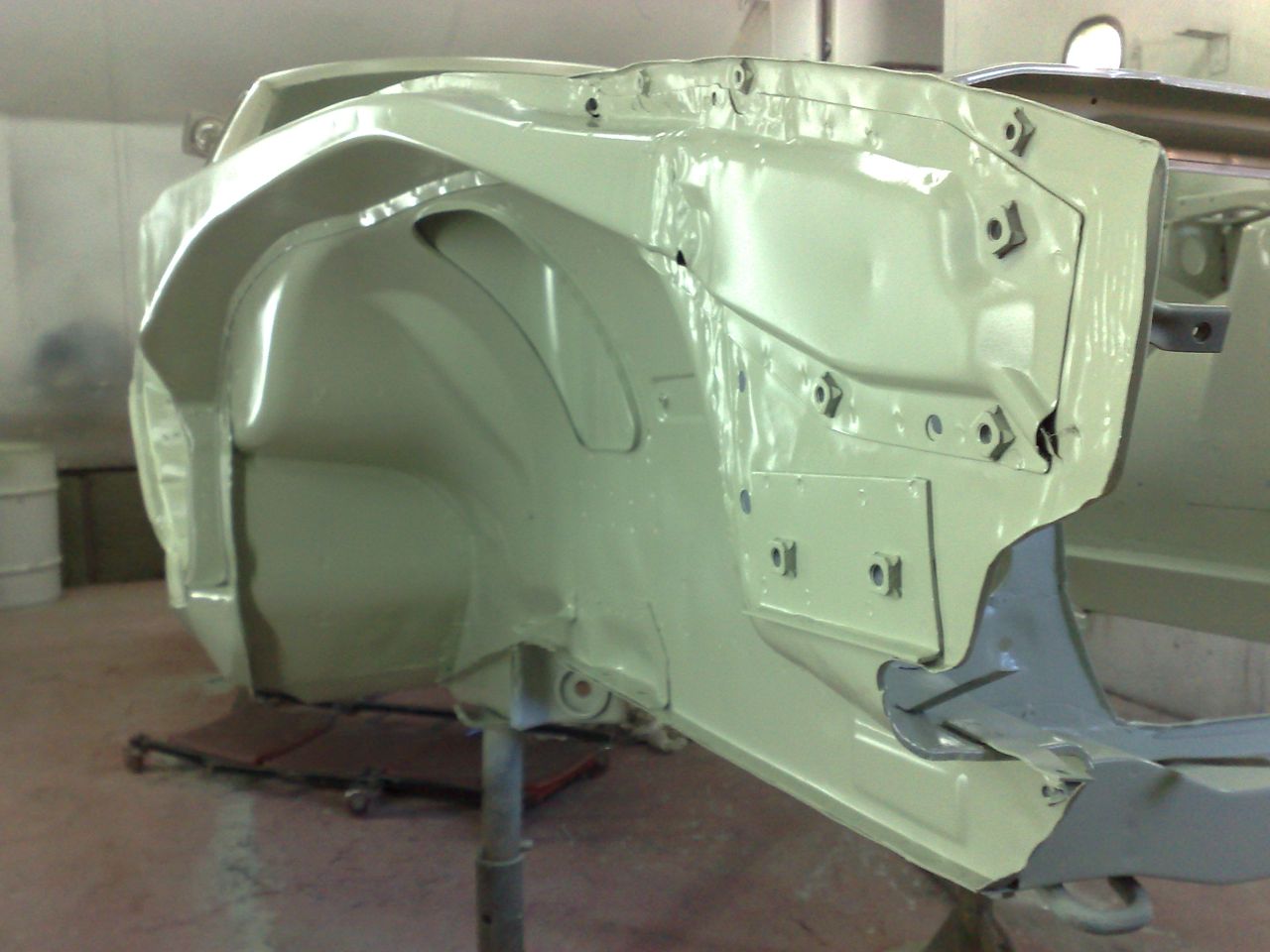

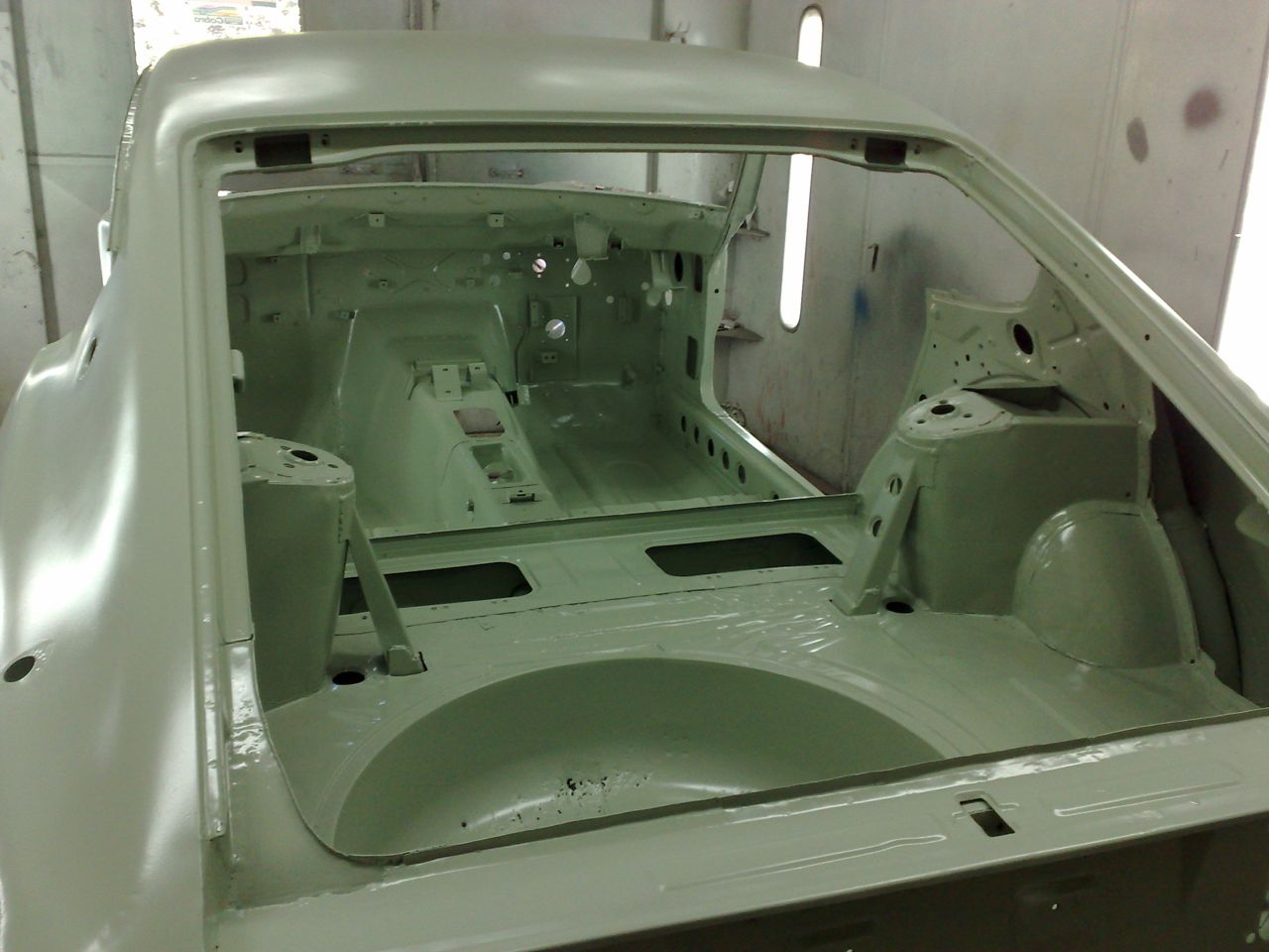

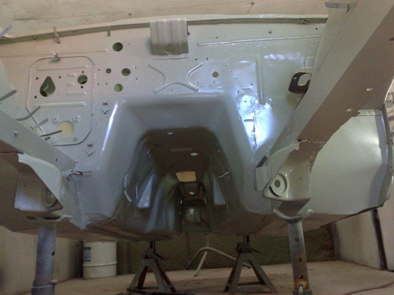

acf321 Posted August 15, 2009 Author Posted August 15, 2009 Thanks Lurch .. Yes, that was actually chopped off and re-made. That will be properly ground down and finished in the coming days. The body is not finalised (as evidenced by that photo) but the rust is all gone. Quote

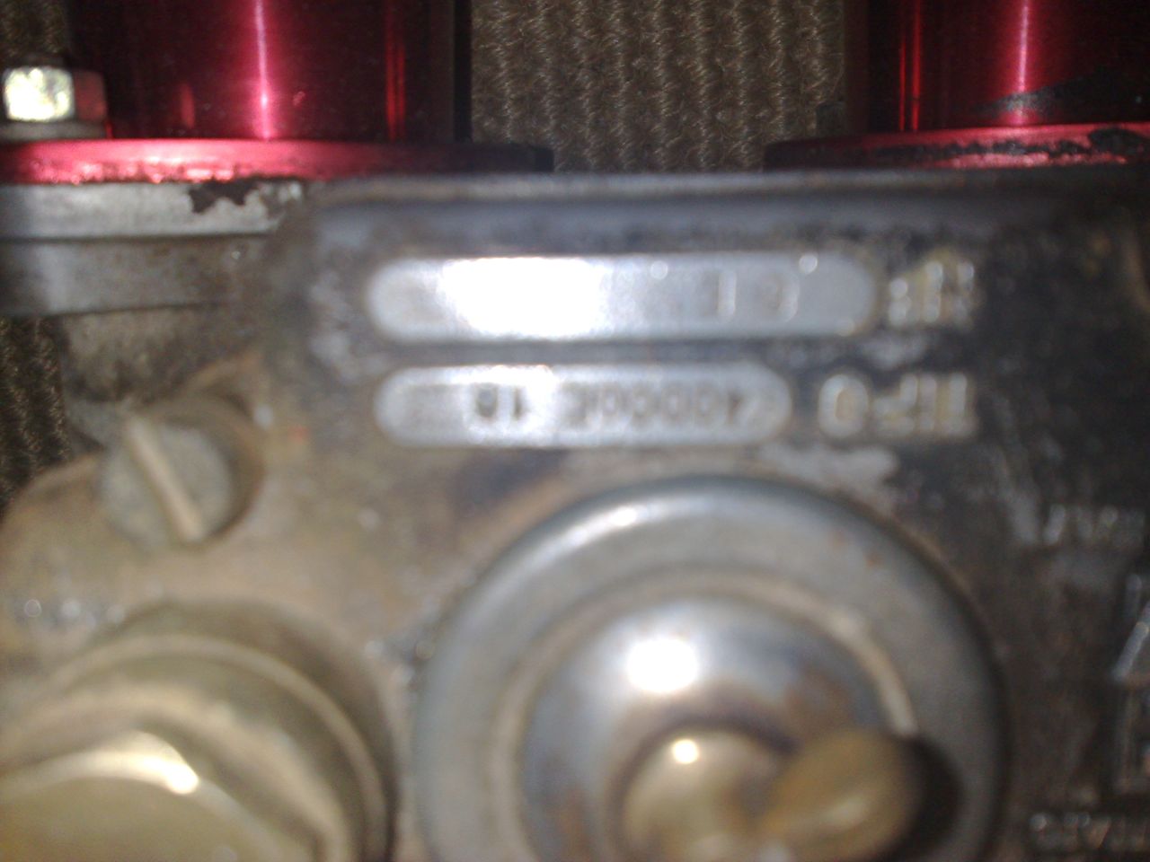

acf321 Posted August 18, 2009 Author Posted August 18, 2009 week 13.5... Just received my triple 45mm O.E.R 'racing carburetors' from the US (via Japan it appears) and inlet manifold. Cannot believe how beautiful this stuff all is (see pics above) and LIGHT !!!! (its all alloy, including carb bodies). Gotta be 5kg less on the manifold than the weber and Cannon setup I have. If anyone wants these, let me know as I found a good source via a mazda rotary site. The only thing that has me ever so slightly wondering is the manifold is shorter at 4.25" versus the Cannon 5.5" one I have with the webers. Have read a bit about these on the Hybridz and other sites, and it appears there is marginal difference between the lengths that appears obvious. Lurch, i'm sure you're salivating to tell me, so please do tell! Will let the credit card cool off, but then will be ordering the; 1) Fully adjustable cam pulley, and 2) twin idler gear from Kameari in the coming weeks. The hornet body should be all but completed this weekend, so will stick up a few shots if I get a chance. Cheers Quote

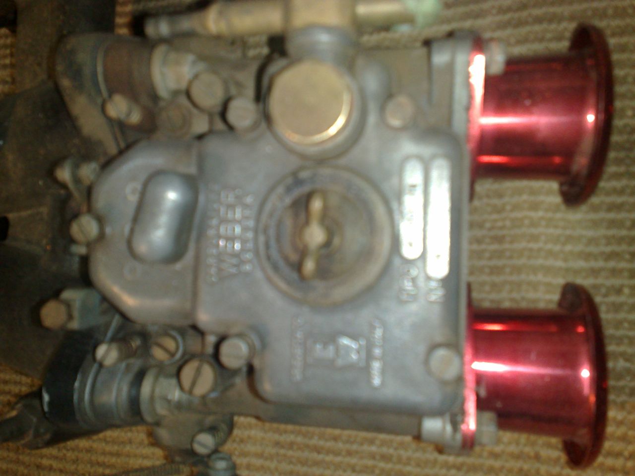

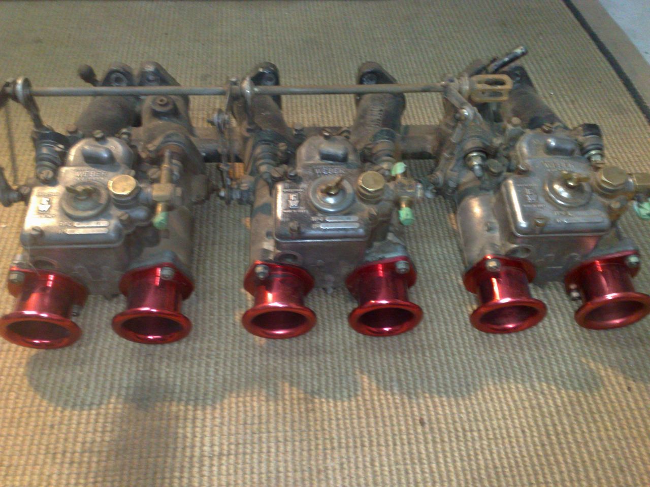

acf321 Posted August 20, 2009 Author Posted August 20, 2009 Hi all and thanks for taking interest in my webers, cannon inlet man and linkage I am selling. I have attached the photos of the carbs here (as per your various PM's). Just to remind you, they are matching 40mm italian webers, they work, they are 100% complete. Rgds Quote

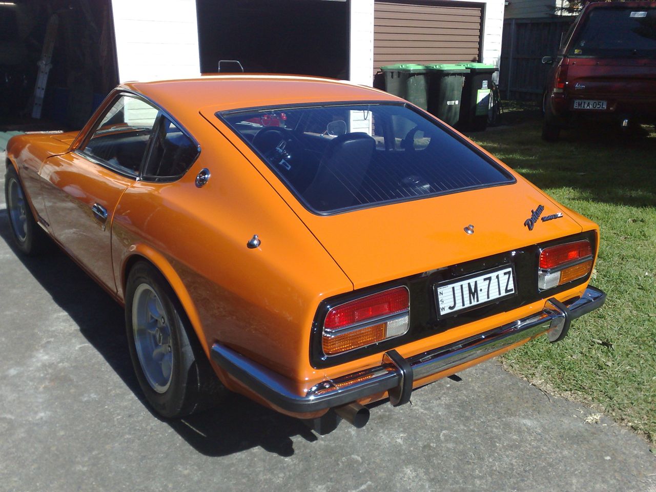

acf321 Posted August 23, 2009 Author Posted August 23, 2009 I think Orange has it !!! I asked my brother in law last night .. he said there are two colours ... 1) orange, 2) silver .. it was orange out of the factory too ..... Quote

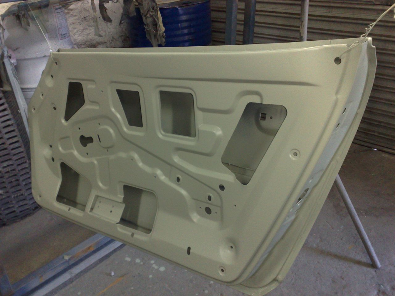

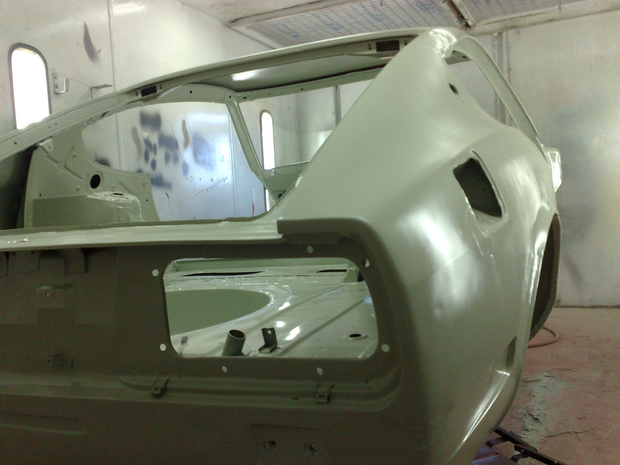

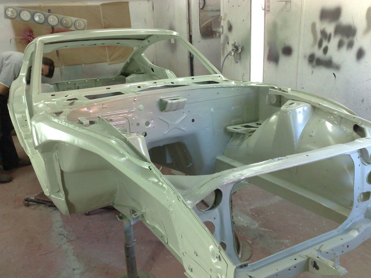

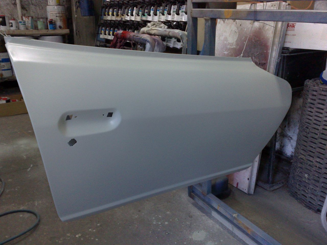

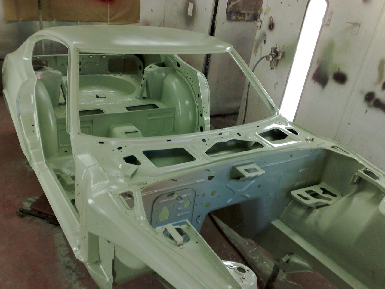

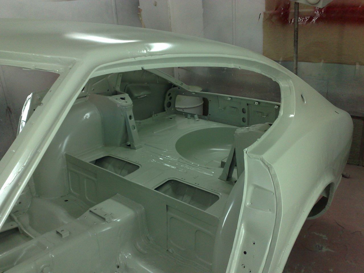

acf321 Posted September 5, 2009 Author Posted September 5, 2009 Week 16... The Brown Hornet is moving along nicely, and the work that Nat and the gang have done is frankly amazing. This week they finally got her into a coat of primer, being sure to drill some extra holes in the roof channels and other places to ensure it finds it way into all the nooks and crannies, such that the dreaded worm is a thing of the distant past. Next step obviously is to get the shape into the body, such as the guards, pillars etc etc. Note there are still holes in the spare wheel well, and we only still have one door! Waiting on Warren for these parts still. The drivers side door you see here had a new skin on it this week, and in the event we cannot source a decent passenger door, we'll start to completely rebuild that. On the engine, James had me order the Cam this week from the US (Isky stage 3), with new valve springs, lash caps and retainers. The valves are ordered, as are the custom pistons, both of which are yet to be machined to suit the newly ported head. Kameari parts are on order with BenZed, and once I have the new extractors i'll be taking them to James to have some customisation work done, and then inside & out ceramic coating. We're sticking with the 280Z electronic dizzy, but this will be re-mapped to match the desired output of the motor. As for the block, it did have one spun bearing that very fortunately did not score either the block or crank. Also been conversing with some Japanese people to get the right Watanabe wheel size and offsets, and I received my 'Datsun Spirit' seat covers that look completely awsome. Will be testing a few colours as the body is ready to receive them. I've got a silver'ish colour in mind, and we're going to have a go with some OEM Safari Gold to be sure that a lairy 70's scheme is not the right way to go. More to post soon. Enjoy these pics. Cheers Adam Quote

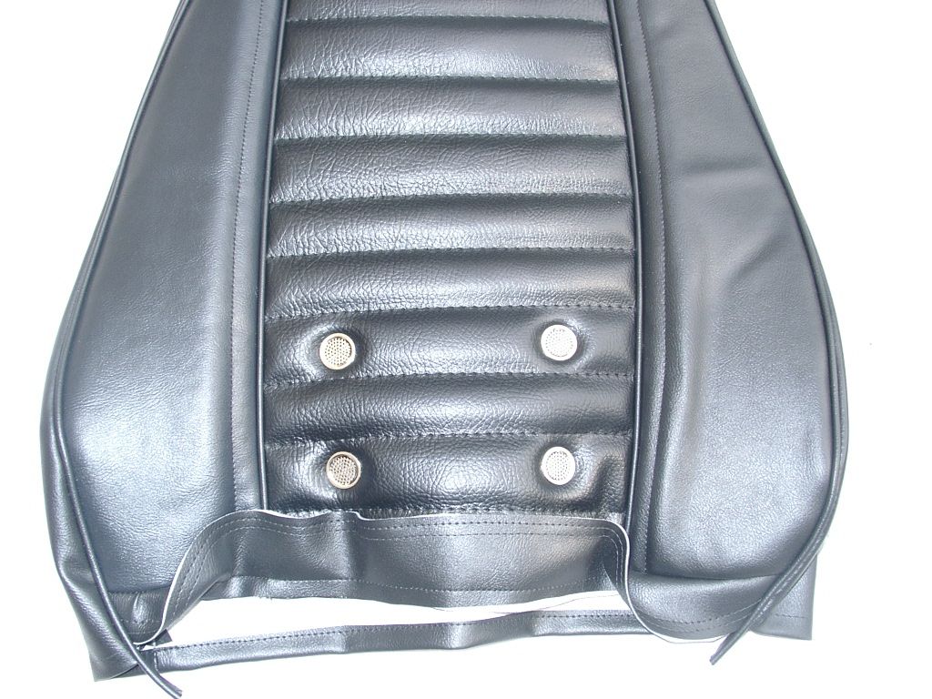

acf321 Posted September 5, 2009 Author Posted September 5, 2009 This is the seat covers from DatsunSpirit ... Not 100% identical, but extremely close. The quality of the vinyl and padding far exceeds the factory stuff too, so it should be pretty nice to sit on as well. Diamond vinyl kit from the same supplier should be here in a week or so, and to ensure a good fit I think i'll have an upholsterer install the lot once painted. Quote
