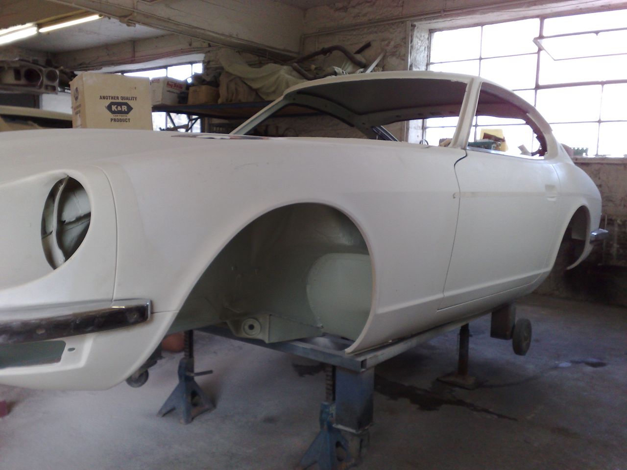

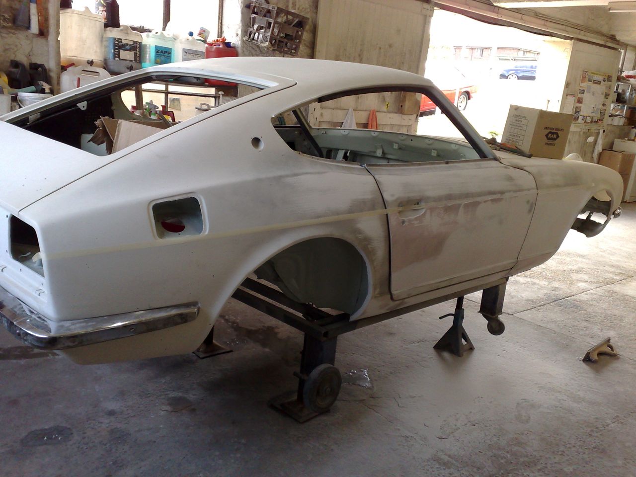

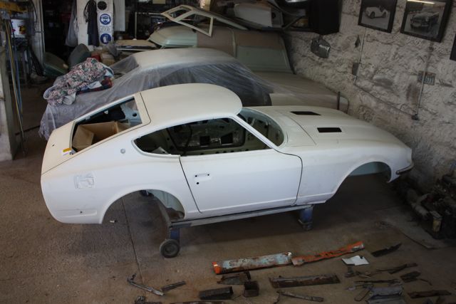

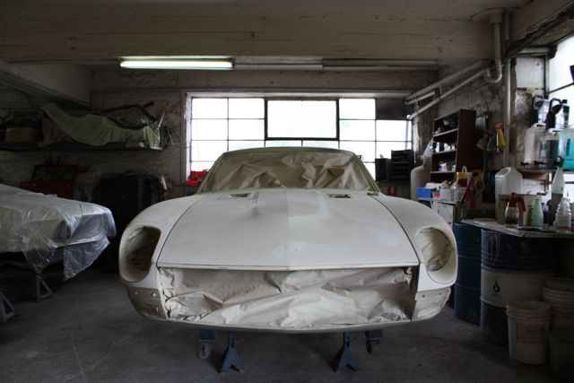

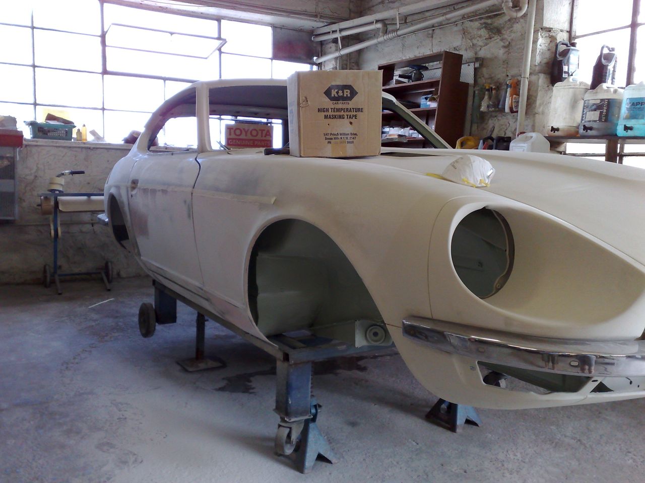

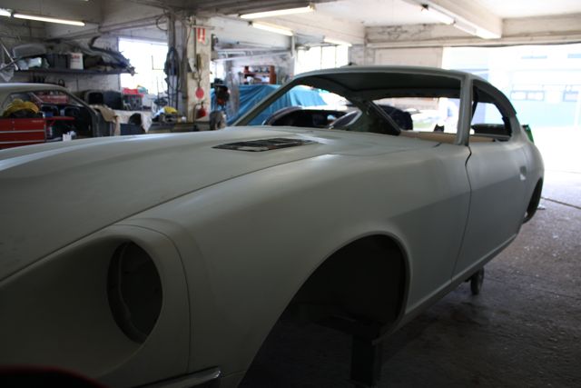

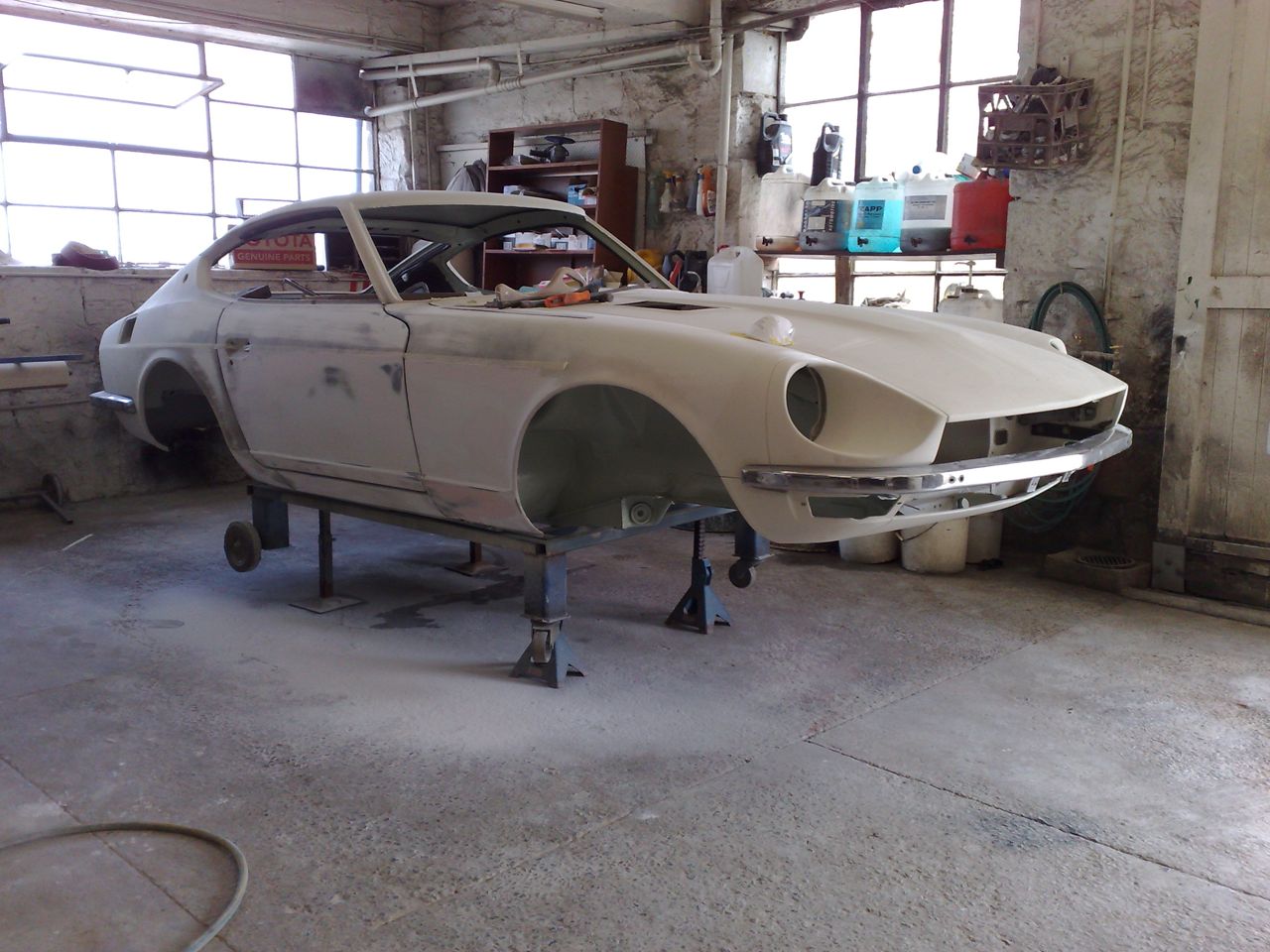

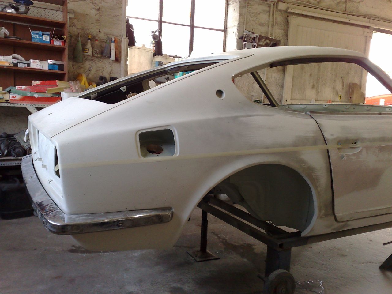

acf321 Posted October 24, 2009 Author Posted October 24, 2009 Week 22... Was not planning on going to see the hornet today, but alas I did and Nat was actually blocking it when I was there. As far as I can see the alignment is 99% done, and straight with the only issue now being the drivers door skin, where the gaps are just too wide. Nat is planning on completing this, then we're ready to complete blocking and onto the stone guard. F&R bars are on, but given they both need straightening and chroming, I am considering buying a set of aftermarket stainless ones from Ebay. This is likely to be a cheaper and better option than repairing what we have, especially with the dollar where it is. I ordered the Kameari Twin Idler gear and fully adjustable cam sprocket as well, given strength of the currency. Am even tempted to grab the watanabes while the Yen is where it is. Cheers Quote

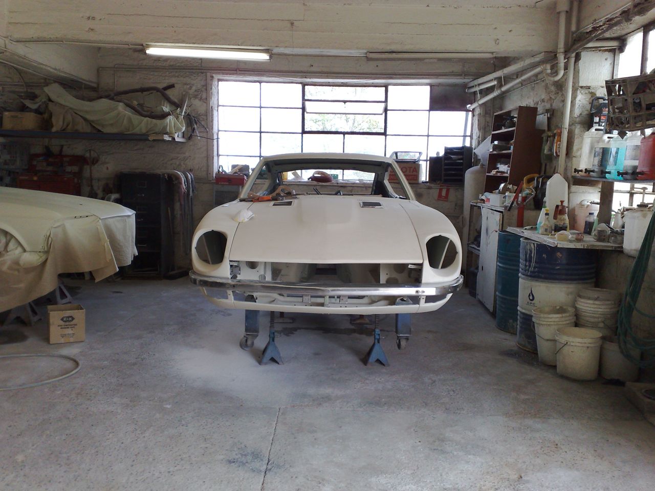

acf321 Posted October 24, 2009 Author Posted October 24, 2009 You can see the masking tape on the sides that Nat is using as a guide for the blocking. The lines should be pretty straight when done on this. Quote

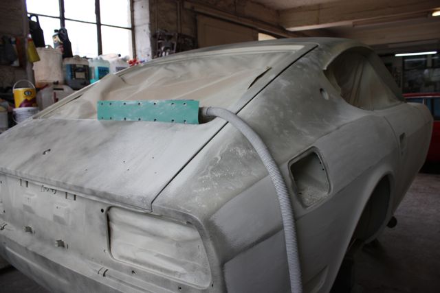

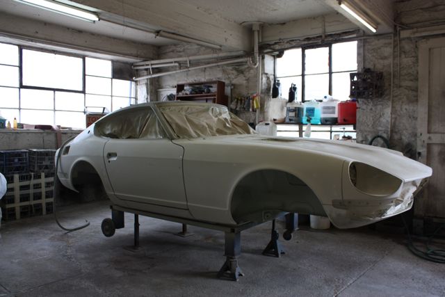

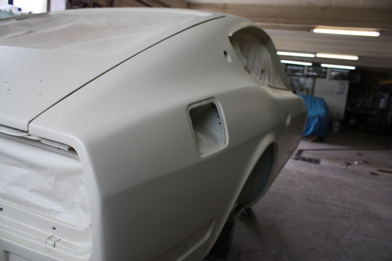

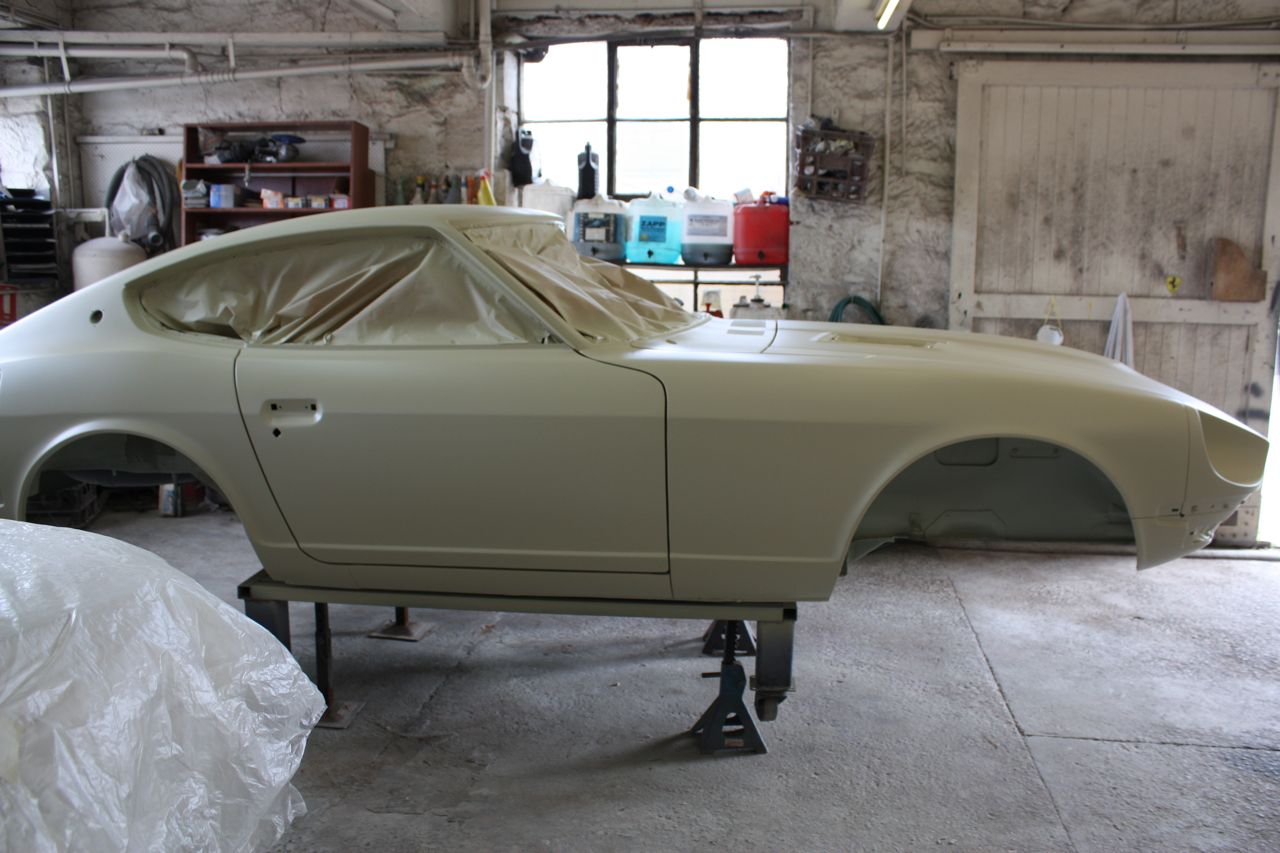

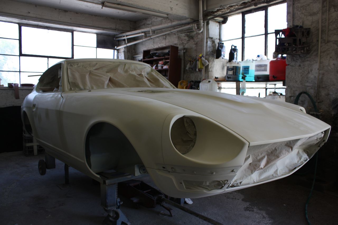

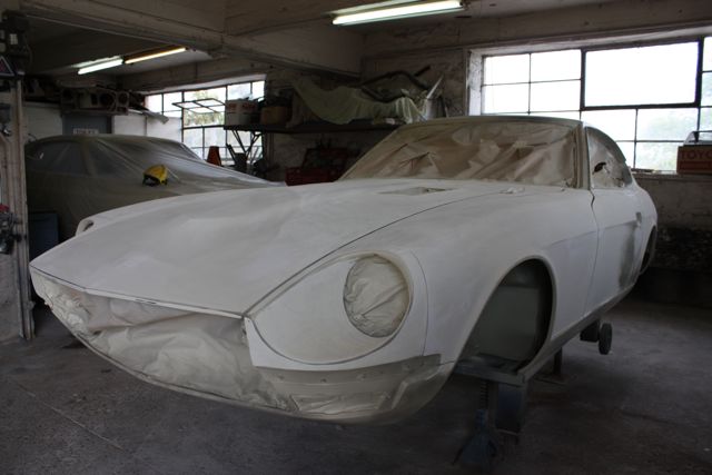

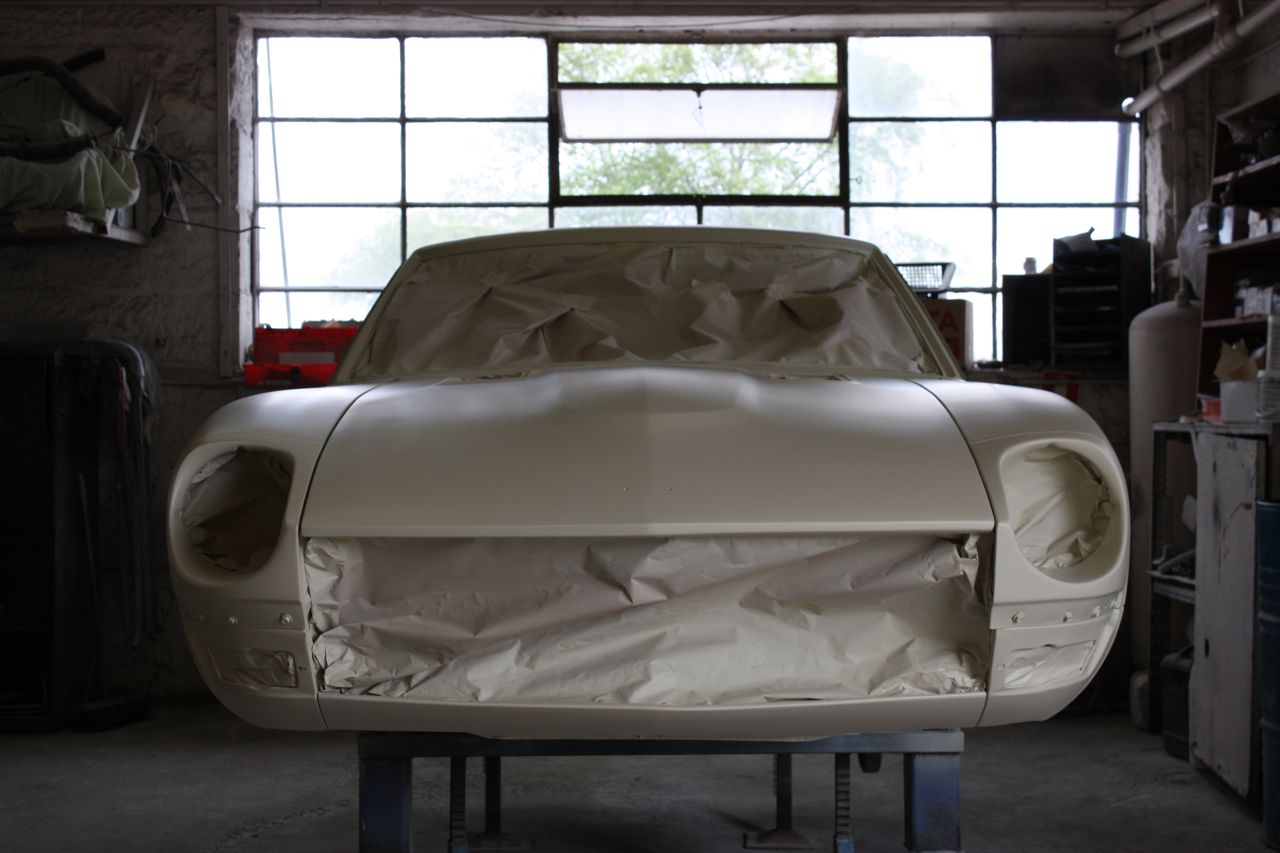

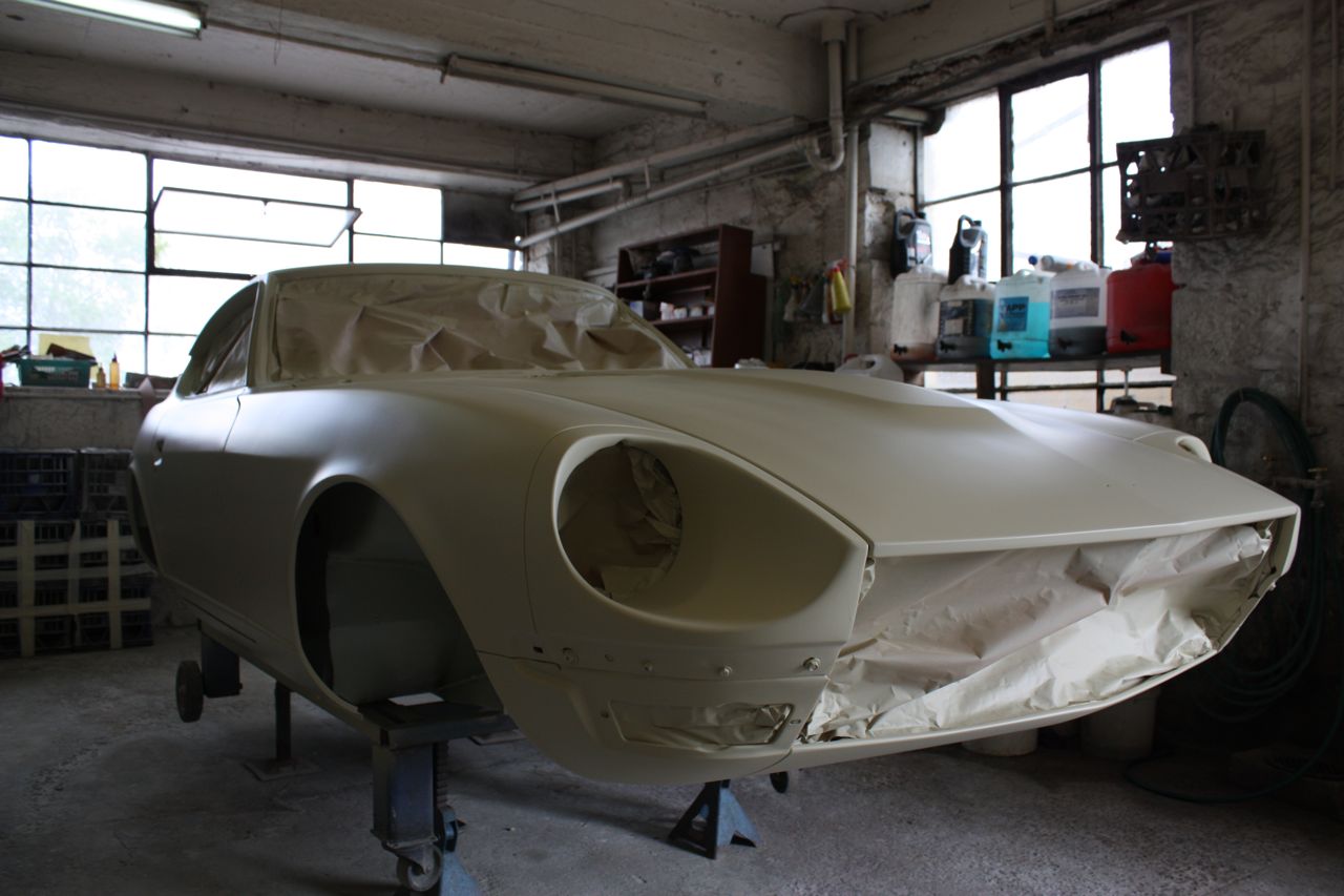

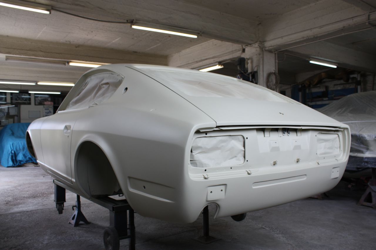

acf321 Posted October 31, 2009 Author Posted October 31, 2009 week 23... What a difference a week makes. This week the Hornet had been completely hand blocked and aligned and was sitting in two pac primer when I saw it. Must say, it really is starting to look good now! The purpose of priming is to check the lines, and Nat will again shape, guide coat, block, dry sand, wet sand and then re-prime in the coming week. To me it looks finished, but there remains quite some work to have her completed. Just ordering some final parts from the US and then it should be about done. Received my Kameari twin idler gear and adjustable cam sprocket and was pretty surprised by the quality. Now I have all the parts for the motor, so will get these to James to make a start on the build. Seeing NZeder's red 240 with those 16" wheels has made me pretty confused again .. do I go 15" or 16" wats? Decisions Decisions Enjoy Adam Quote

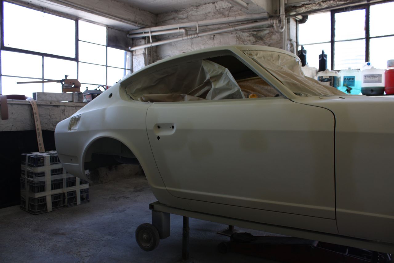

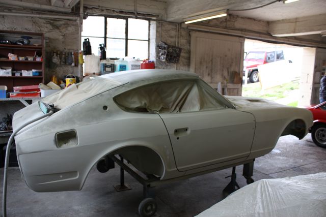

acf321 Posted October 31, 2009 Author Posted October 31, 2009 more photos.. The last one is my favourite so far. Quote

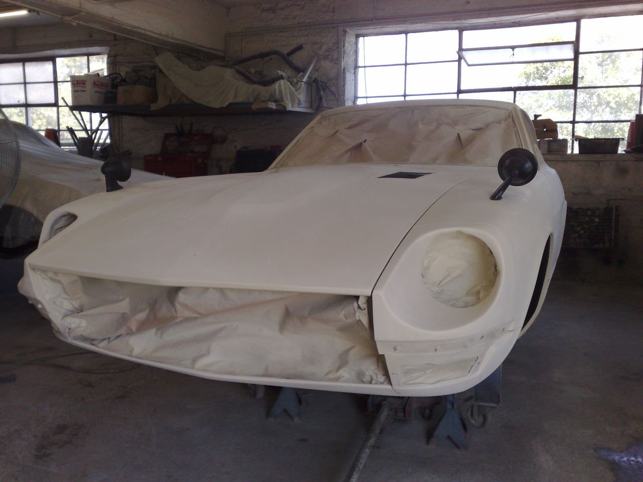

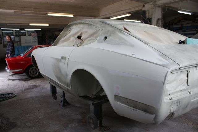

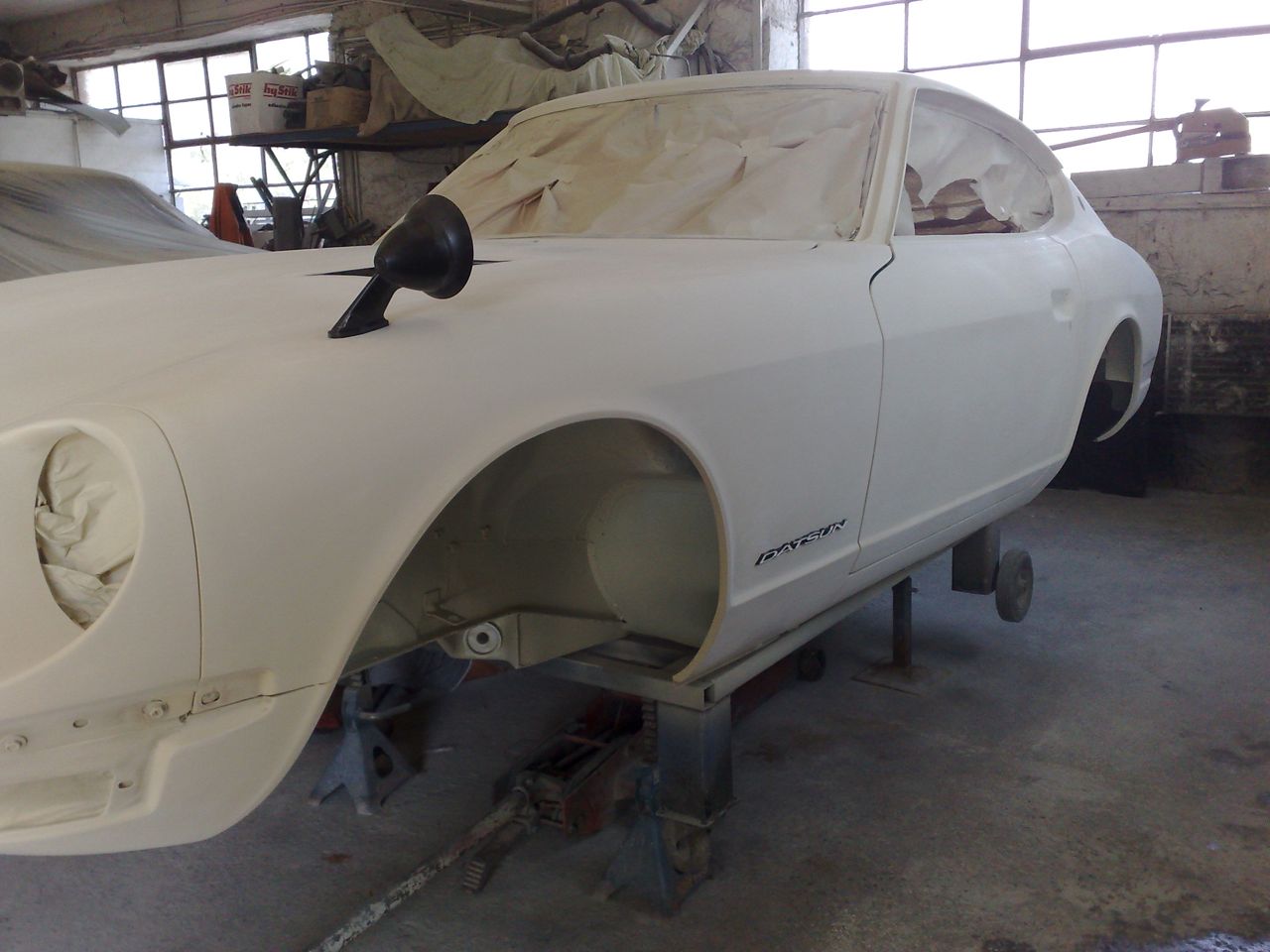

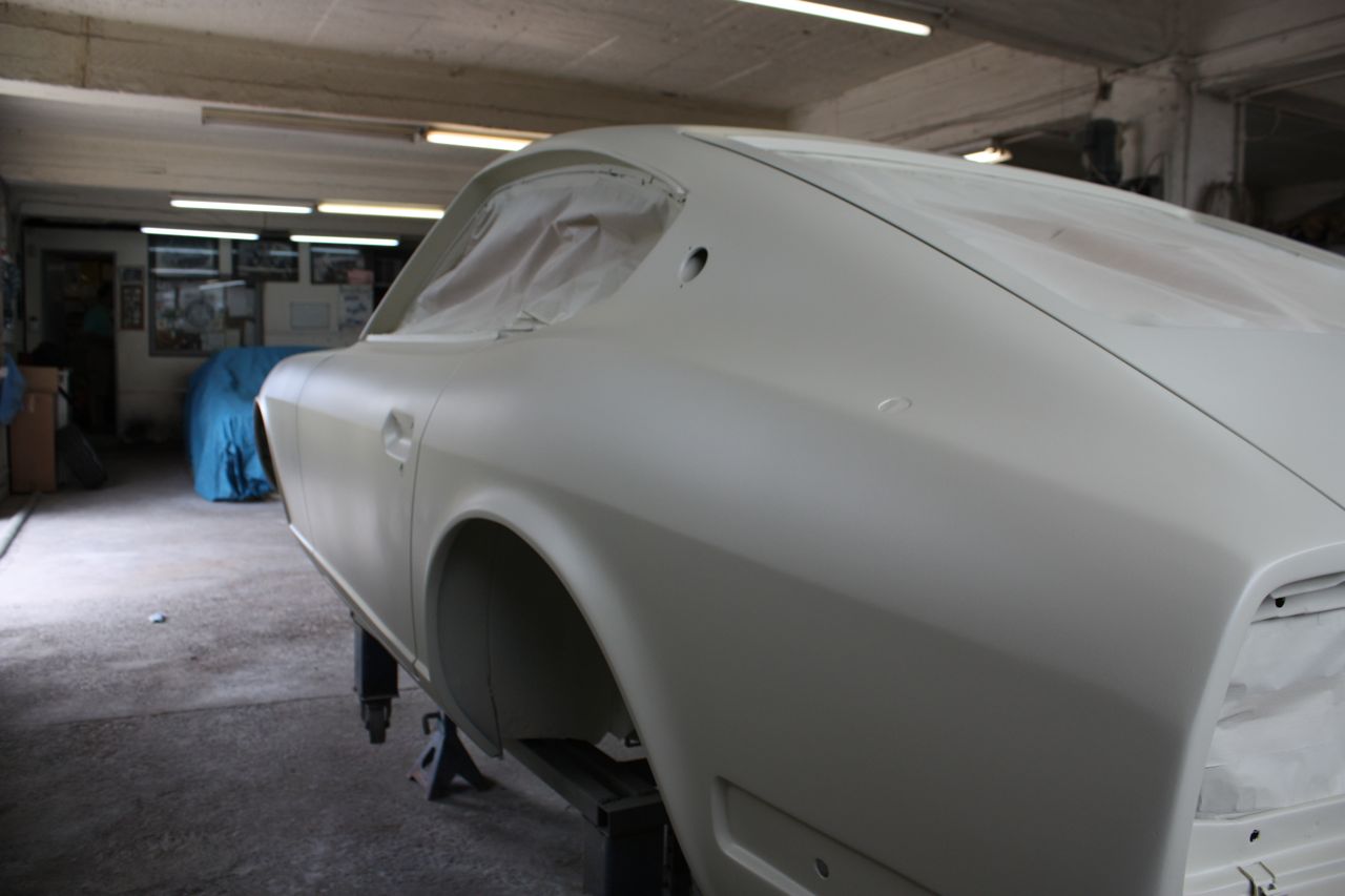

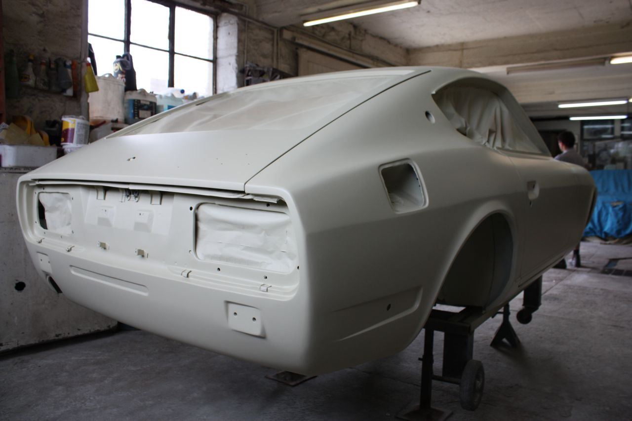

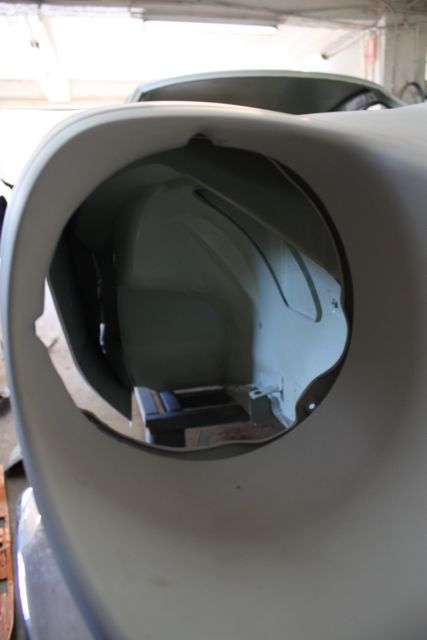

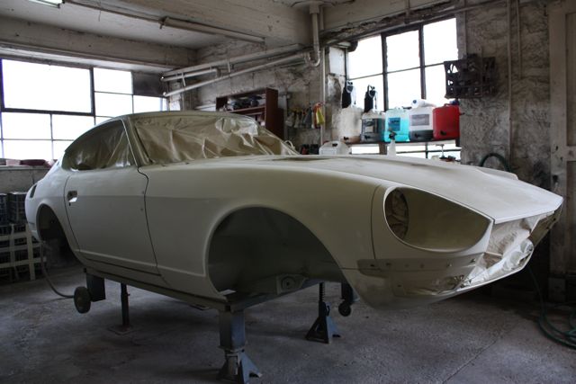

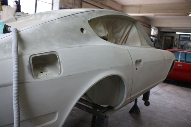

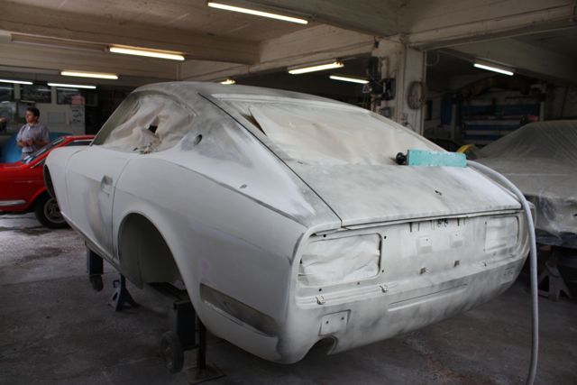

acf321 Posted November 7, 2009 Author Posted November 7, 2009 Week 24... Nat's just about finished final blocking. The dark lines and patches on the Hornet this week show the remainder of the guide coat left after blocking. Interestingly, he found a couple of high spots that chamfered off nicely. Rear deck, roof and drivers side still needs more work, but it almost looks two tone with the roof a darker shade with guide coat still on. Engine is at build phase, with only the harmonic balancer now required. Transmission has been rebuilt and we can confirm its a later 260 item with brass syncro rings. Its been wet blasted and fully reassembled. We have not changed any ratios (noting its all pretty standard stuff), but may address this if we deem it necessary once done. James has a 240Z item that I could swap with him (for authenticity), but not sure of the merit in doing this. Block has been hot tanked, pistons made, flywheel seriously lightened (-2kg+), and rods drilled out for larger gudgeon pins. Still awaiting balancing of the above, once its bolted together. I can't wait to hear its shreaking, popping and farting once done. Exhaust will be 2.5" custom stainless with small hotdog and sports muffler. Wheels are a bigger decision than I thought. I know they'll be watanabe, just not sure if we go for RS type, or F8 (effectively the same wheel with less dish). Given the body remains standard, it'll be 7.5" front and likely 8" rear ... maybe 8.5" if i'm feeling lucky. Keeping 55 series tyres in keeping with that old school look. I've got the new seat covers and diamond vinyl kits ready to go in. Next stage is Nat finishes the blocking, re-primes, and does the stone guard underneath and inside (like NZeder). The outside is then hand sanded with 800 grit wet and dry and its into the booth for the paint. The method here is for 2 light coats, 2 heavier coats, and one final thin coat with more thinner, the purpose being to give a smoother finish. Not convinced I'll go for a clear coat yet. Checked out my suspension again today ... I think the springs are King brand with Koni inserts. Not sure, but we will confirm this when we get them apart. Nat's keen to make sure we get the height just right ... See the green 432 i'm using as a benchmark for the suspension settings. I'm actually getting pretty excited about this now ... enjoy. Adam Ponyo240z 1 Quote
acf321 Posted November 7, 2009 Author Posted November 7, 2009 last (with the green inspiration!!) Quote

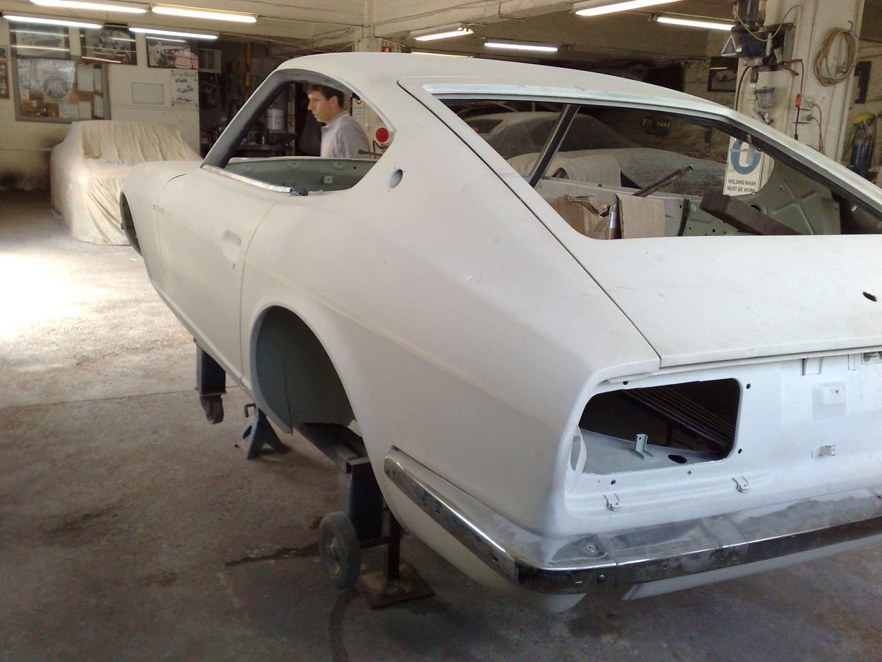

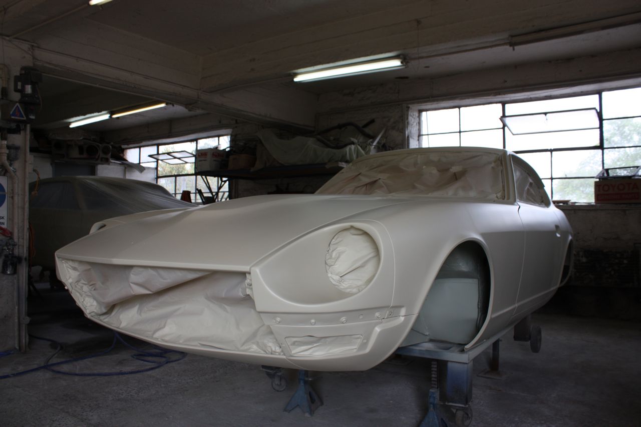

acf321 Posted November 20, 2009 Author Posted November 20, 2009 Week 26... Been away for 10 days and returned to see Nat's completely finished the body, and is adding seam sealer, badge & mirror holes and generally finishing everything ready for paint. The car still has one more guide-coat and sand ahead of it before 800 grit wet sanding prior to paint. Believe it or not, Nat's been finding high spots this week that are now gone. Once this is complete, we'll add the stone guard underneath and inside pre paint. Colour is determined, has been tested and looks (in my opinion) very good. Suffice to say its a 70's racer and will look like it! I went to James Flett's MIA Engine Services workshop today to drop off the cam, carbs, valve springs, inlet, and Kameari parts. The block has been hot-tanked, bored 60 thou (to ~2.5l), and skimmed. Gearbox, head and timing chain cover have been bead blasted with mild scotchbrighting, giving a factory fresh satin finish. E88 head is very fresh with only one helicoil insert evident, and no other evidence of damage or corrosion. All the magic on the head is yet to occur, which will almost absorb 50% of the budget of the build. Pistons and valves have arrived, fly is 2.5kg lighter, and rods and crank are balanced, with new seriously strong rod bolts (not sure of brand). Assembly should only be weeks away. Still need to acquire extractors, and while the tuned length ones do look incredibly tempting, at three times the price of the SWR product, they're probably not warranted. I called Nat on the way home to ask him to add a few more seam welds on the strut towers, as with this engine I could be tempted to throw this car around a little more than I thought. Hopefully by next time I write, we'll be somewhere near the spray booth... Cheers, Adam Quote

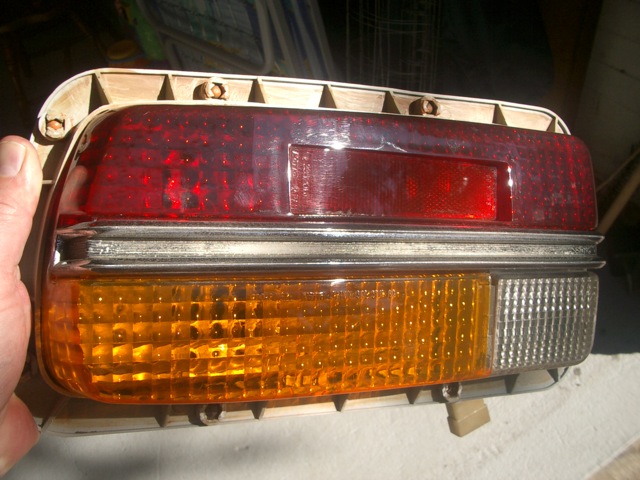

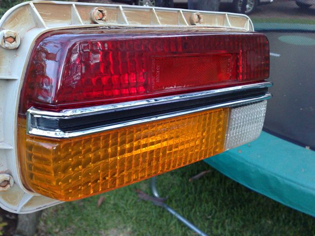

acf321 Posted November 21, 2009 Author Posted November 21, 2009 Forgot these yesterday ... I spent a heap of time cleaning and polishing the rear tail lights and after re-assembly I could not bare the look of the chrome bars ... I had them re-chromed and the results are outstanding (but a little exxy). The quality and shine speaks for itself .. See the before and after shots. I taped off, primed and painted the middle with satin black. Cheers Quote
