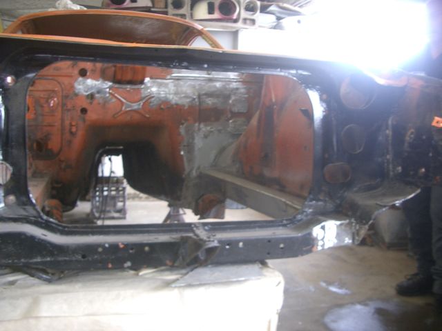

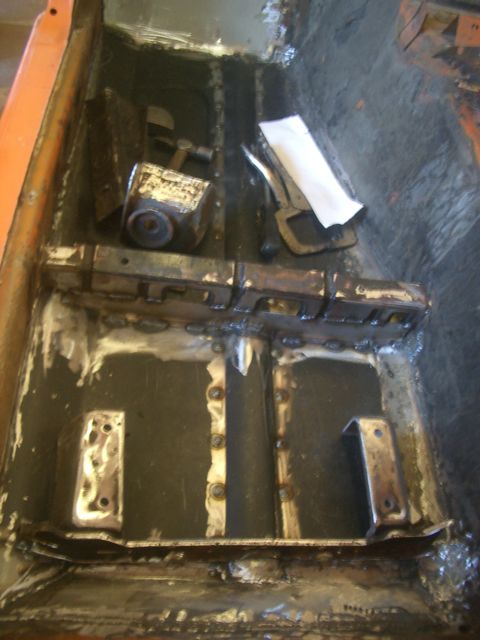

acf321 Posted June 6, 2009 Author Posted June 6, 2009 Week 4. Arrived extra early this morning as last week I was late and Nat got very busy ... needed as much time as possible to ensure we covered off on all the things Nat's done .... and NEEDS doing! Bottom line, Nat's been chewing up more grinding disks this week... on my 240 !!. When he was telling me about the Muira's and Countach's he once used to restore, between slipping in the bit about how he helped build two D-Type replicas, he did admit this was the worst car he's dealt with from a rust / fabrication perspective. There you have it ... I'm man enough to admit i've bought a complete piece of steaming poo. We decided that at least we've identified all the problems and are a large part of the way through it. Nat was surprised by the quantum of 'dodgy work' that had been done to this car, again largely as a result of this leaky battery. The front left side frame rails, box section, floor, fire wall, and plenum chamber have all in some way been affected. The only good thing to say about it all is that we're progressively replacing everything. The issue with Warrens floors was not the panels themselves, but the fact that we had to remove an area larger than the panel's dimensions ... see in the photo at the right and top ... shiny stuff is the extras. During the preview, we headed into the office to have a look at Gaijin's car ... to try to make myself feel more normal ... As I said to Nat ,, if you think my job is complex, have a look at this bloke!! even showed him the photo of the owner with all the tubes hanging out of him !! (don't think its as a result of the car tho ... and I hope you're making a fast and full recovery!). Spent a good hour looking at colours and had a look at Milennium Jade, olive, green, blue and red ... still no decisions though. Hope you're enjoying this !!! Cheers Adam Quote

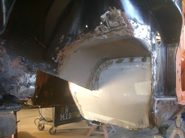

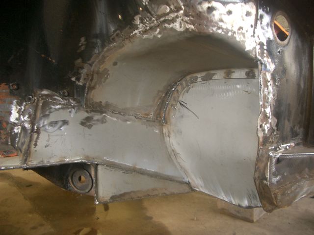

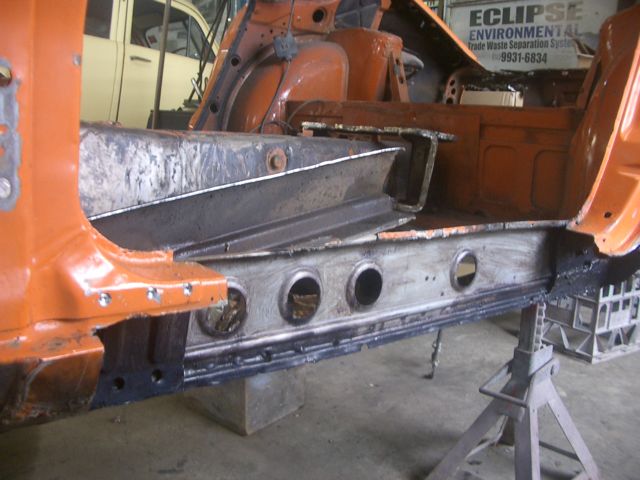

acf321 Posted June 20, 2009 Author Posted June 20, 2009 Week 6... Nat was around this weekend so I trundled down there thismorning to find much had been done in the past two weeks. Aside from being a little distracted by the immaculate DB6 that Nat was doing some mechanical work to, the FX holden that appeared to be getting the same 'lightening' treatment that my 240 is well used to, and a fiat 124 sport that he was re-doing the suspension on, we did have a moment to have a look at the hornet. I summary, Nat has completed all chassis sections, floors, wheel arches, and has now progressed onto the passenger side sill section ... yes the part that we said only weeks ago was 'fine and will not need any repairs' !!!!!!! Bottom line, we're sure the drivers side is fine (no really we are!!), so now we need to complete the sill, rain gutters, and then beaver panel. Tried to get a feel for where we're at, and Nat says about 80% done ... Panels are still not back from the bead blaster with the GTS Monaro, given the rain has slowed down their progress .. (they don't like to play with bare metal in this rain). Enjoy the photos.... sorry for the quality ,,, camera battery just about dead and lighting pretty average! Rgds Adam Quote
acf321 Posted June 20, 2009 Author Posted June 20, 2009 Oh yes, we need to know if anyone makes new sills, and the rear section that the tail pipe goes through (under the rear bumper)? Also .. if anyone has or knows where to get a beaver panel locally, that would be a nice find. Cheers Adam Quote
C.A.R. Posted June 20, 2009 Posted June 20, 2009 New sill panel pressing's are available from Rare Spares... Quote

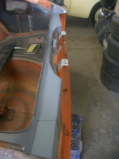

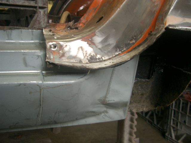

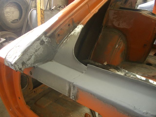

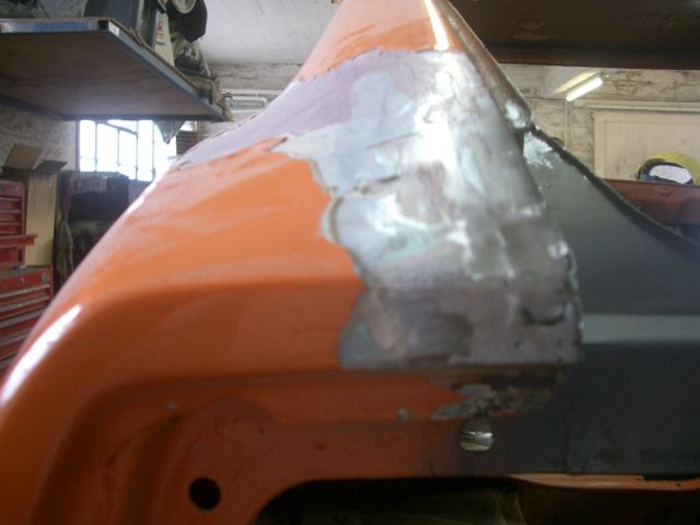

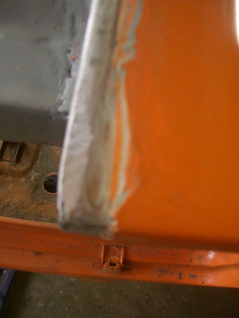

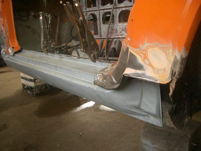

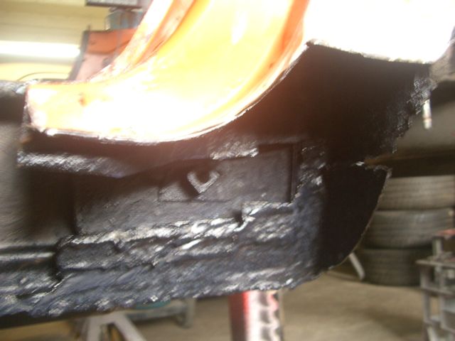

acf321 Posted June 27, 2009 Author Posted June 27, 2009 Week 7.. Today's update shows we're getting much closer to a completed body ... Nat bought sill panel pressings complete with end mouldings and is in the process of installing. These really look the part and will make for better panel fitment when doors come back from the blaster. We also have new doglegs that will go on. Nat's been working on repairing the beaver panel section (see photos). As part of this work, they made up about 5 separate pieces and welded them all into the correct position, which looks really impressive. Also took a photo of the rear panels showing where they've peeled some of the paint off to check the body integrity. We scratched the paint back with a razor to see how many coats this car has actually had.. and counted 11 (its in the photo, albeit the quality is poor), including; base coat, original orange, four new orange coats, four separate undercoats, another red colour. The total thickness of the paint (see photo) is well in excess of 1mm (suspect in total there'd be over 20kg or excess paint yet to come off). Only things to finish now include rain gutter sections, finish putting beaver panel back together, and complete fitting sills & doglegs. Once panels are back in the next week or so, we'll have a go at trial fitting them for alignment Had a long chat about colours today. Nothing finalised here, surprise surprise! Enjoy the photos. Adam Quote

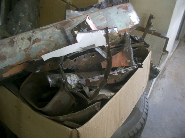

acf321 Posted June 27, 2009 Author Posted June 27, 2009 More photos, including the box of removed items Quote
