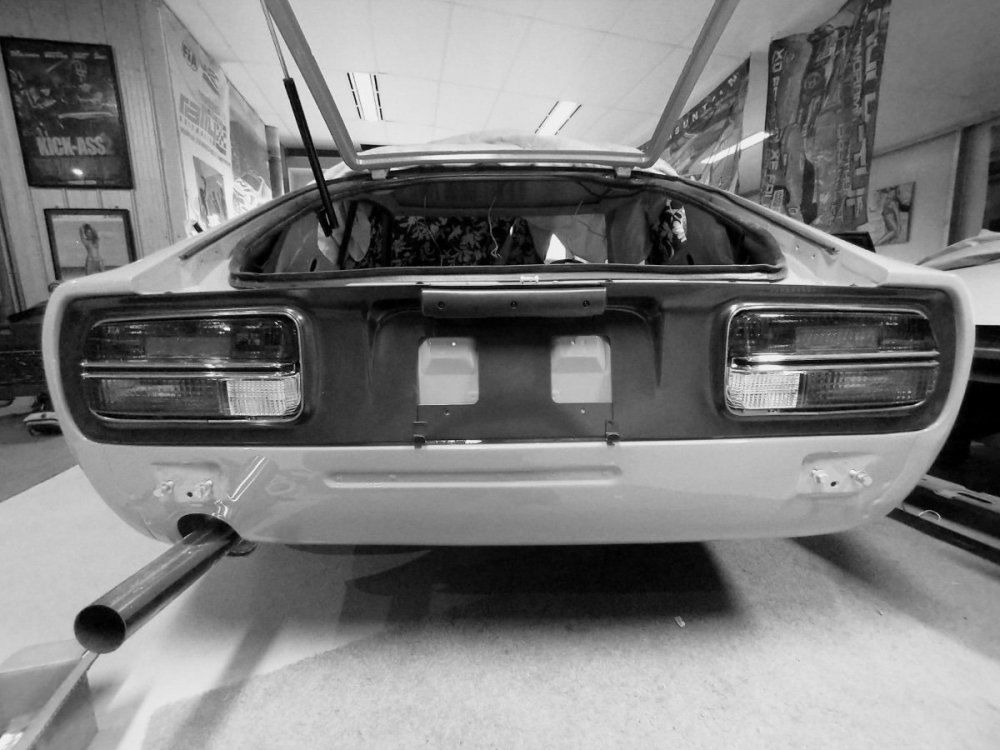

Wags Posted October 27, 2021 Author Posted October 27, 2021 Another photo this afternoon. Look at the back of this! So in the photo…we have the hatch on with the restored strut and fittings, the brand new lights and lenses, brand new number plate light, painted taillight panel section, and the beautifully polished stainless light surrounds which Locky was working on for ages to get spot on! OdinZ, Mike_F, gilltech and 2 others 4 1 Quote

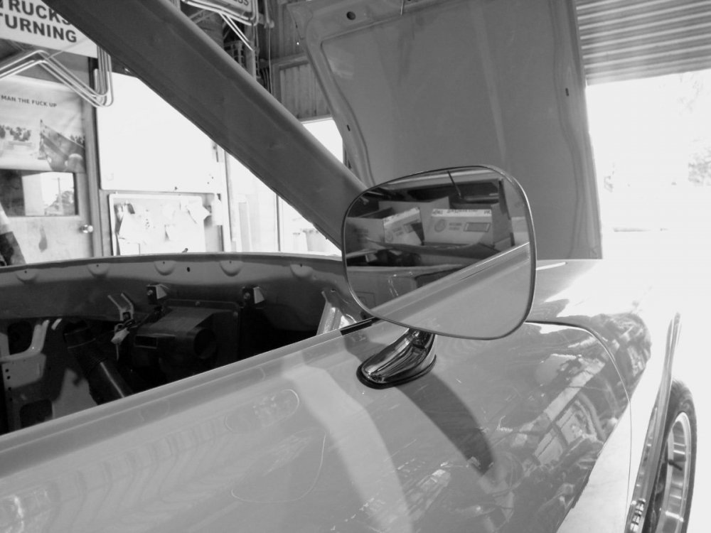

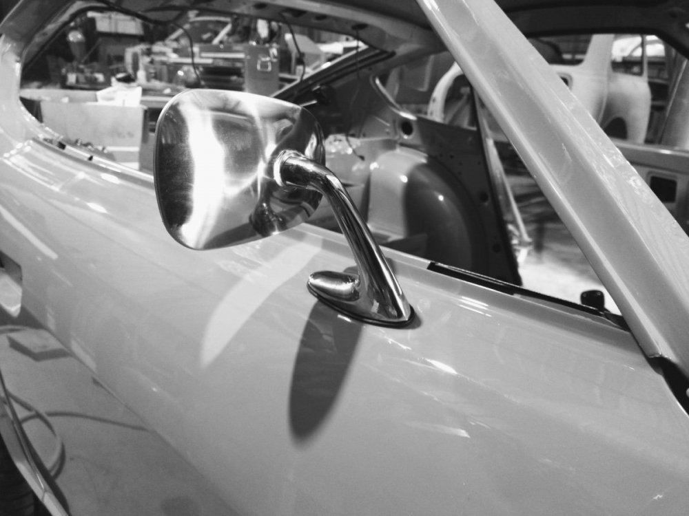

Wags Posted November 9, 2021 Author Posted November 9, 2021 Some more stunning photos from Locky and the fine people at CAR. the rear of the new headlights and the brand new side mirror that I bought new from a chap in middle America. Totally worth the cost in my mind. gav240z, CBR Jeff and Mike_F 3 Quote
Mike_F Posted November 9, 2021 Posted November 9, 2021 Nice! I'm still in two minds as whether to do the great looking but impractical fender mirrors, or to use the door mirrors that the car actually came with... What were the determining factors for going with the door mirrors for you? Quote
C.A.R. Posted November 9, 2021 Posted November 9, 2021 1 hour ago, Mike_F said: What were the determining factors for going with the door mirrors for you? You can actually use them. gilltech, OdinZ, Enzo and 2 others 5 Quote
Wags Posted November 9, 2021 Author Posted November 9, 2021 I heard there is a degree of regret that comes free with fender mirrors. CBR Jeff, Mike_F, gilltech and 1 other 4 Quote

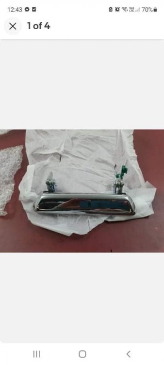

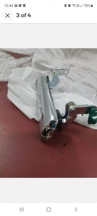

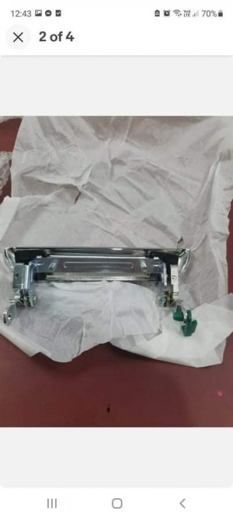

Wags Posted November 9, 2021 Author Posted November 9, 2021 So the original chrome door handles were not salvageable…these baby’s are ordered and on their way: gav240z and Mike_F 2 Quote

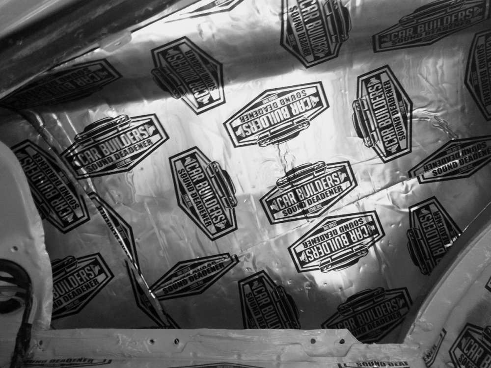

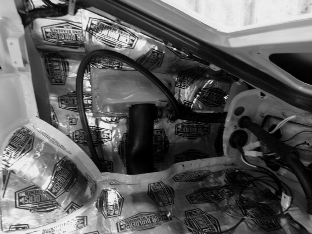

Wags Posted November 9, 2021 Author Posted November 9, 2021 Sound deadening ready to go in Mike_F and OdinZ 2 Quote

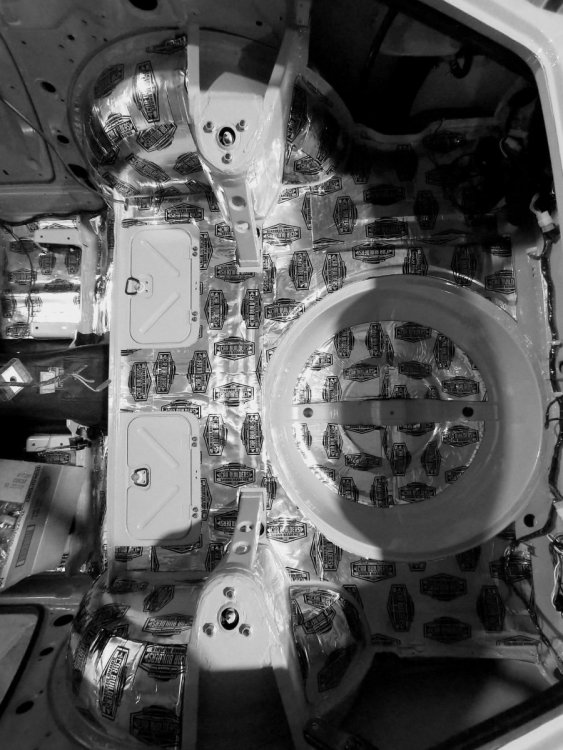

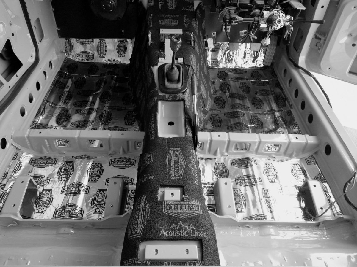

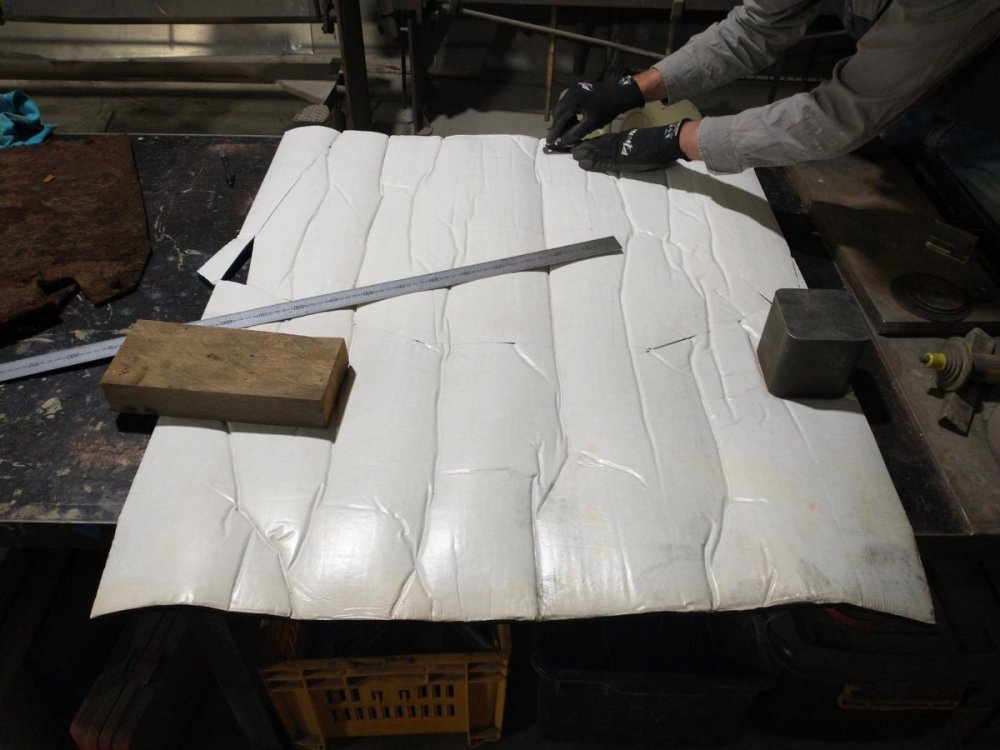

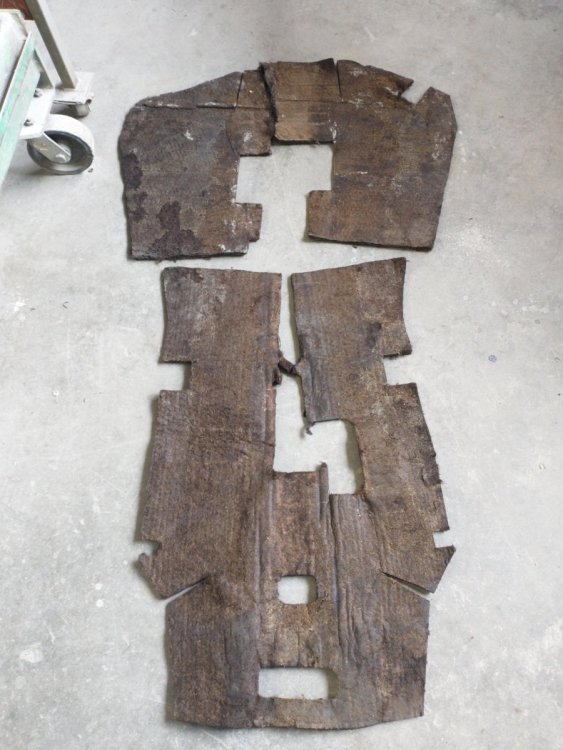

Wags Posted November 11, 2021 Author Posted November 11, 2021 Out with the old and in with the new…insulation and sound deadening before and afters CBR Jeff and C.A.R. 1 1 Quote
AndBir Posted November 11, 2021 Posted November 11, 2021 Do you plan on using the acoustic/thermal insulation in the doors and rear quarters? Quote
Wags Posted November 11, 2021 Author Posted November 11, 2021 12 minutes ago, AndBir said: Do you plan on using the acoustic/thermal insulation in the doors and rear quarters? We are doing the boot yes. Doors…I’m unsure if that’s necessary. I have heard that sound deadener behind where the speakers mount give you an amazing sound but they are just in the boot for my build and not in the doors. Quote
C.A.R. Posted November 11, 2021 Posted November 11, 2021 I'm not going to worry about the doors - they are new and made of slightly thicker steel. Also getting the self adhesive deadener in there would be a right PITA... I'll will however stick some in the 1/4 panels to mitigate any 'drumming'. Wags 1 Quote
Wags Posted November 12, 2021 Author Posted November 12, 2021 (edited) Some more pictures from CAR. Sound deadening/acoustic stage just about in the bag. Edited November 12, 2021 by Wags Change CAF to CAR CBR Jeff, C.A.R. and OdinZ 2 1 Quote
scotta Posted November 14, 2021 Posted November 14, 2021 On 11/11/2021 at 6:53 PM, C.A.R. said: I'm not going to worry about the doors - they are new and made of slightly thicker steel. Also getting the self adhesive deadener in there would be a right PITA... I'll will however stick some in the 1/4 panels to mitigate any 'drumming'. I would definitely put some strips in the doors. I did to mine and It makes a massive difference. I put two strips about 100mm high. Not too difficult Quote
AndBir Posted November 14, 2021 Posted November 14, 2021 On 11/11/2021 at 3:53 PM, C.A.R. said: Also getting the self adhesive deadener in there would be a right PITA... Yep it is a PITA, but somewhat easier on the later 260z doors as the bottom opening is larger. It certainly makes the door sound much more solid when it is closed, hard to tell about the noise-thermal benefit though. 8 hours ago, scotta said: I put two strips about 100mm high. Not too difficult Wish I had thought of that at the time Quote

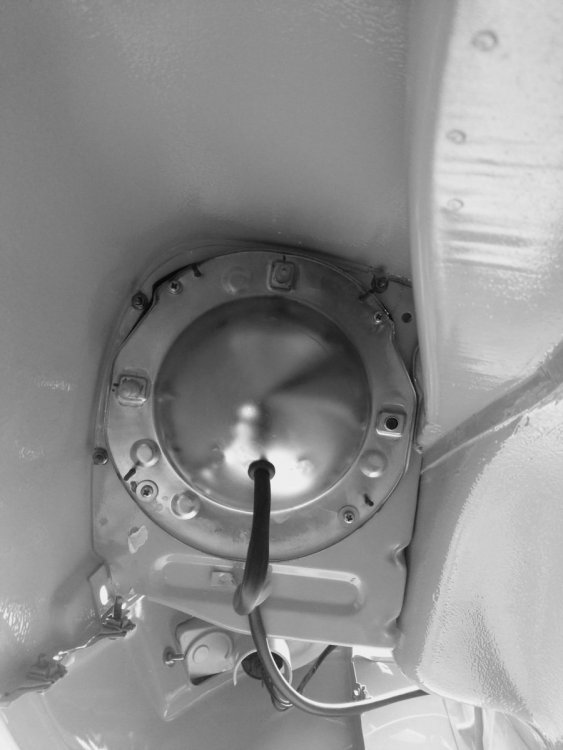

Wags Posted November 15, 2021 Author Posted November 15, 2021 Some more pictures from CAR. gav240z 1 Quote

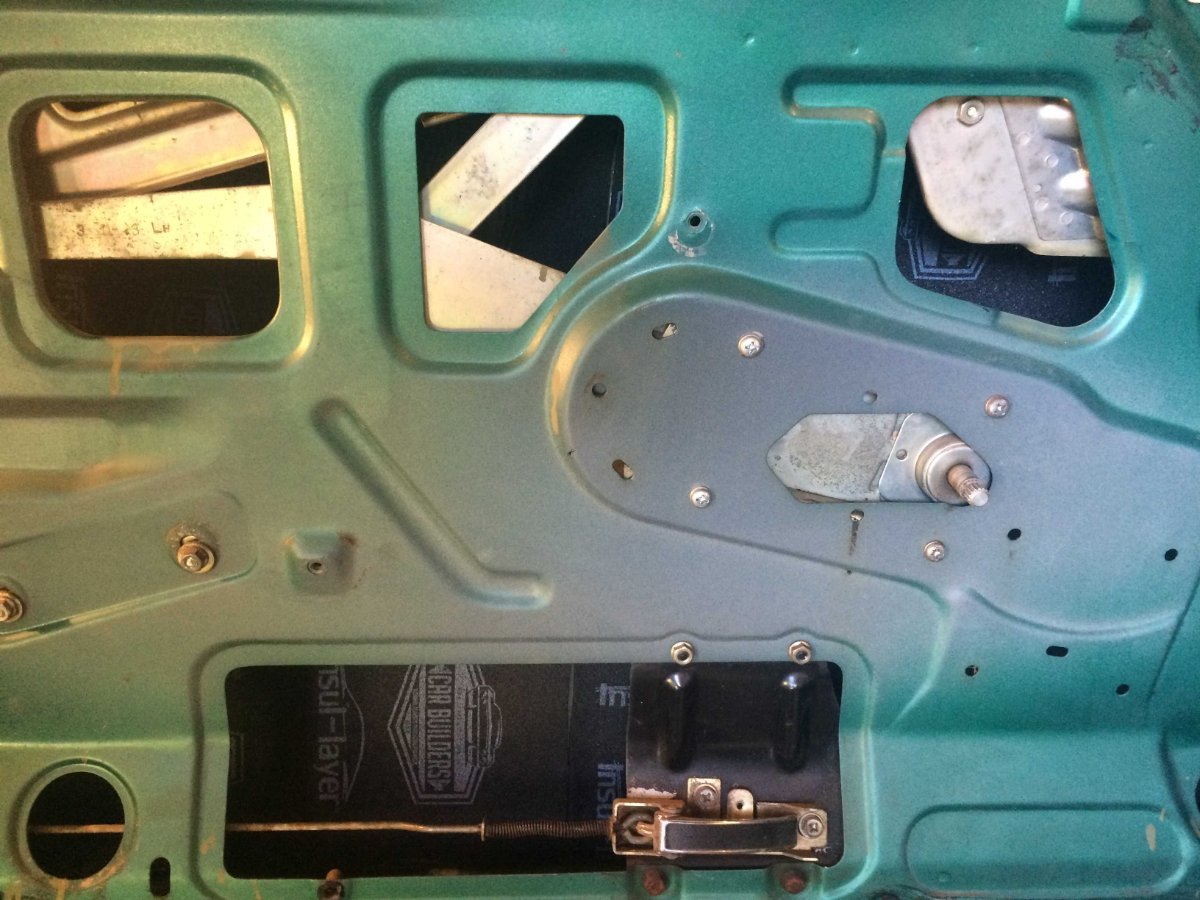

C.A.R. Posted November 15, 2021 Posted November 15, 2021 After thinking about it and discussing it with Graeme who was installing all of the sound deadening, we decided to line the doors: And the quarter windows have now been attacked for cleaning up & new seals: Ponyo240z 1 Quote

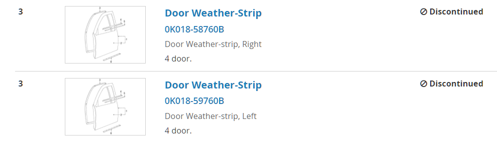

AndBir Posted November 16, 2021 Posted November 16, 2021 (edited) 1 hour ago, C.A.R. said: I'd use new Kia Sorrento door seals. I used the Kia Sportage seals and they worked very well. The item numbers are : 0K01859760B and 0K01858760B Seems Kia may not be making these any more but some online suppliers still have stock: Edited November 16, 2021 by AndBir added info re discontinued parts Quote
gilltech Posted November 16, 2021 Posted November 16, 2021 Good luck with the Kia Sportage door seals, I was looking a year back and couldn't find any stock anywhere. Quote
