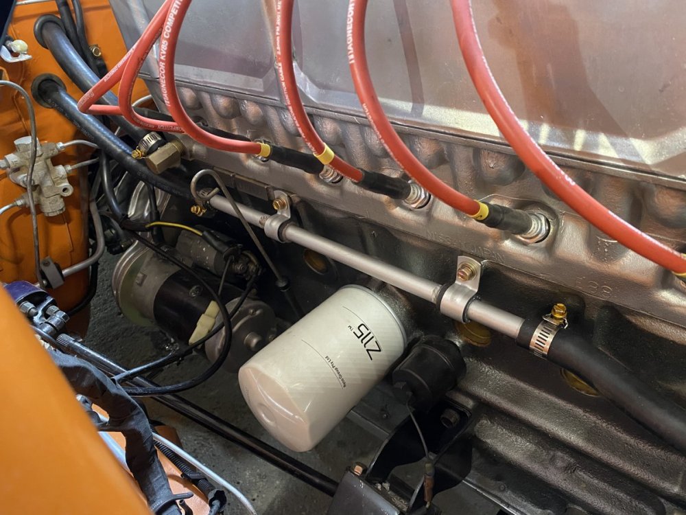

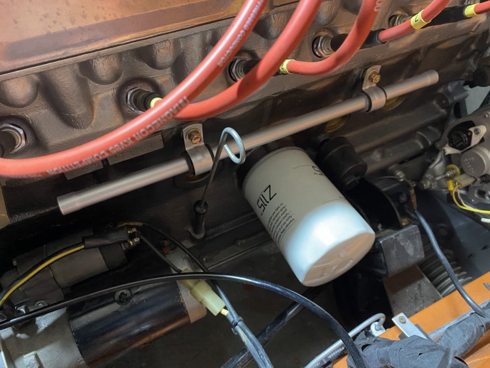

CBR Jeff Posted July 13, 2020 Author Posted July 13, 2020 Delivery of anything from off shore is taking an age. Just waiting on a small shipment so I can get the car to rego. In the mean time I made a section of pipe for the heater to replace what would normally be hose yesterday. Jeff jeff43, Wags and Ponyo240z 3 Quote

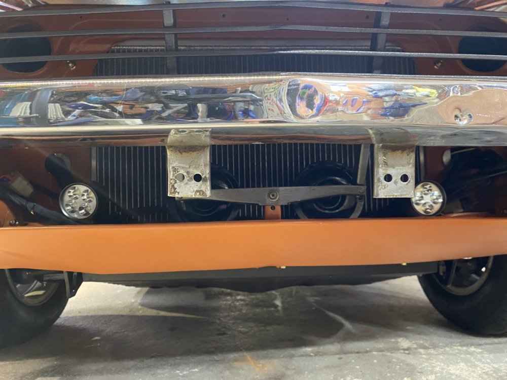

CBR Jeff Posted August 2, 2020 Author Posted August 2, 2020 Heater tap arrived a few days ago. Installed it and piped in the heater over the weekend. Happy with the pipe along the side of the engine although I did get the brackets slightly in the wrong spot. I’ll touch up the paint later. I also moved the small LED 4000 lumen lights that I had mounted under the front bar in the fog light holes back behind the grill. I was not happy with the look on the bar they were too obvious and looked wrong. They are now quite hidden but should still be effective. I just need the cartridge air filters to arrive from EFI Hardware, when fitted I can take the car to rego. Jeff Wags, theremm and KatoKid 3 Quote

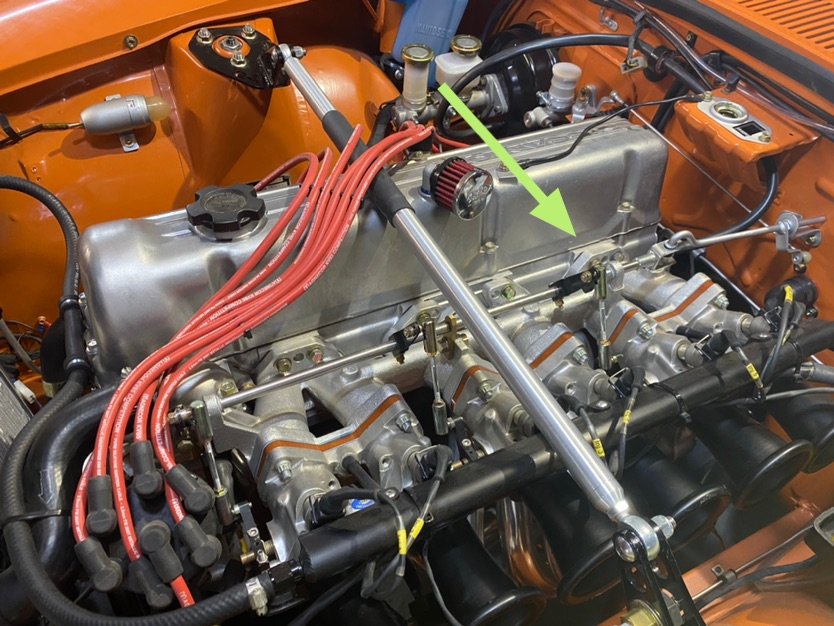

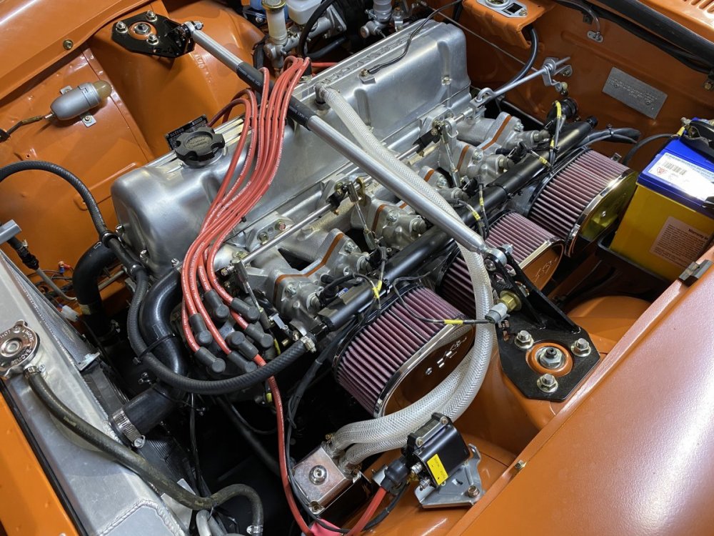

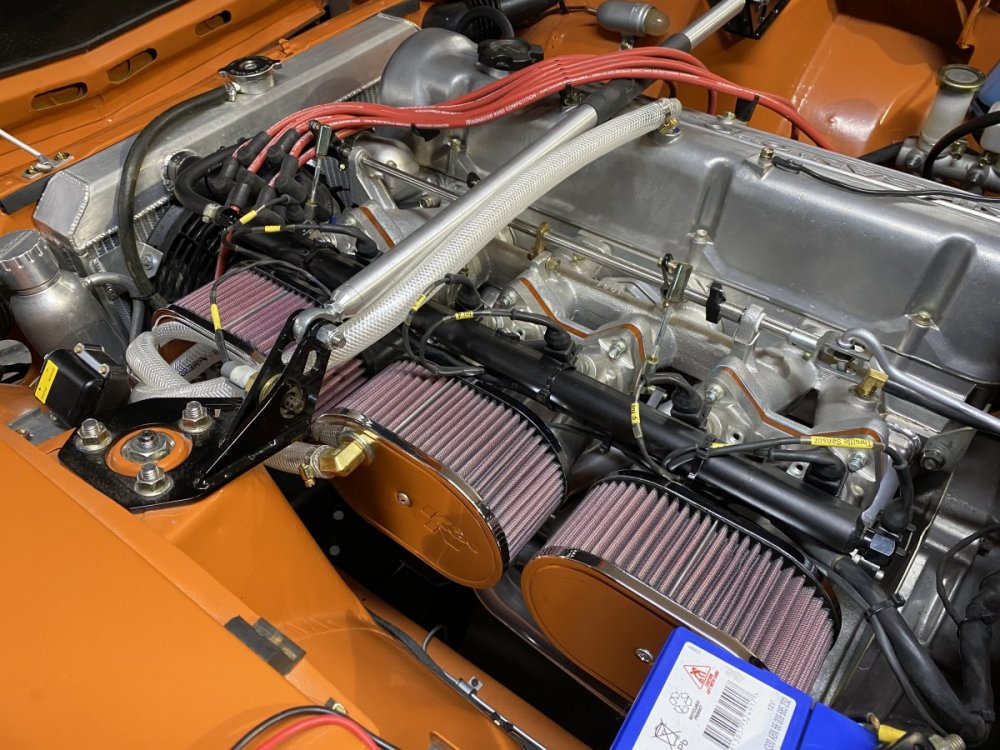

CBR Jeff Posted August 10, 2020 Author Posted August 10, 2020 Air cleaners finally arrived via EFI hardware. fitted them up this afternoon. I’ll drop past and see the rego man tomorrow and see when he has time to do the checks. This will be much cleaner that oil filters. Jeff hmd, AndBir, KatoKid and 1 other 4 Quote
Cozza Posted August 10, 2020 Posted August 10, 2020 Your engine bay looks great Jeff, well done. whats the sensor in your strut brace?Intake Air Temp? Quote
AndBir Posted August 10, 2020 Posted August 10, 2020 39 minutes ago, CBR Jeff said: Air cleaners finally arrived via EFI hardware. Looks great, I am looking to go down the same route regarding the PCV --> Catch Can --> Intake. Out of interest, how did you secure the brass elbow inside the K&N filter cover? And presuming it is a nut of some kind, how have you secured it to prevent it working loose over time? Thanks, Andrew. Wags 1 Quote
CBR Jeff Posted August 10, 2020 Author Posted August 10, 2020 (edited) 17 minutes ago, Cozza said: Your engine bay looks great Jeff, well done. whats the sensor in your strut brace?Intake Air Temp? Thanks. Yes it’s the air temp sensor for the ECU. Jeff Edited August 10, 2020 by CBR Jeff Quote
CBR Jeff Posted August 10, 2020 Author Posted August 10, 2020 6 minutes ago, AndBir said: Looks great, I am looking to go down the same route regarding the PCV --> Catch Can --> Intake. Out of interest, how did you secure the brass elbow inside the K&N filter cover? And presuming it is a nut of some kind, how have you secured it to prevent it working loose over time? Thanks, Andrew. It was a great job for a very wet Sunday in the shed with the heater on and the footy on the radio. I used a 5/8 barb to 1/2 bsp elbow. Drilled out two washers to size then placed one on either side so as to spread the load on the filter cover. I cut the nut section off of a 1/2 female to 5/8 bsp nipple and used it to secure the lot together. After it was all together I drilled a 1mm hole through the bsp section of the elbow and installed a split pin through it to stop the nut coming off. I also used a fuel comparable sealer to help hold it all together. It shouldn’t go anywhere. Unfortunately I forgot to take a photo. Jeff Wags and KatoKid 2 Quote
AndBir Posted August 10, 2020 Posted August 10, 2020 56 minutes ago, CBR Jeff said: Unfortunately I forgot to take a photo. Not a problem, a great explanation so no need for a photo - thanks.. Is the tubing you are using rated for fuel/oil as I understand that can be a requirement depending on how finicky the inspector is? Wags 1 Quote
Wags Posted August 11, 2020 Posted August 11, 2020 Mate that engine bay looks fantastic! Those filters look brilliant! Quote

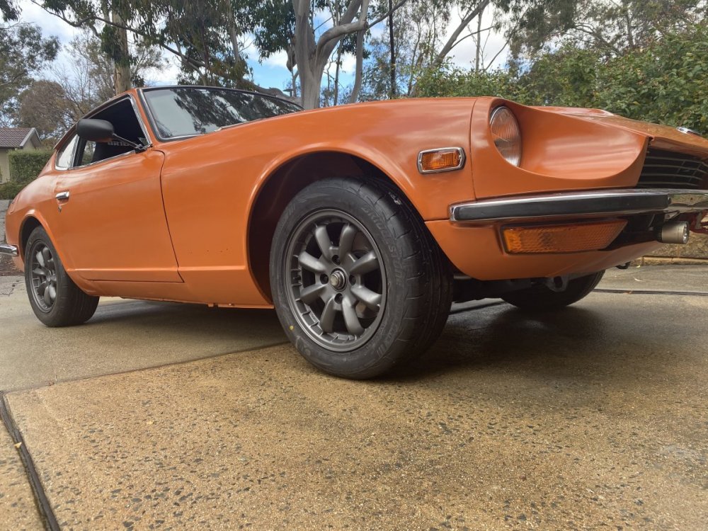

scotta Posted August 30, 2020 Posted August 30, 2020 Jeff, what are the size / offset of the Enkei comp wheels? Quote
CBR Jeff Posted August 31, 2020 Author Posted August 31, 2020 (edited) 20 hours ago, scotta said: Jeff, what are the size / offset of the Enkei comp wheels? Scotta They are 15x7 with +25 offset. Im going to run a 10mm spacer with the 205/55 tires. This gives the same scrub angle as STD. Jeff Edited August 31, 2020 by CBR Jeff scotta 1 Quote
Cozza Posted August 31, 2020 Posted August 31, 2020 I also have the enkei compe’s although in 15x7 0 offset with standard struts running 205/50’s with no problem. I can get up to 3.5’ caster And -3’ camber comfortably with no guard alterations, they work great! they can be a bit of a pain to clean the brake dust out though. scotta and CBR Jeff 2 Quote

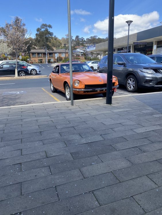

CBR Jeff Posted September 1, 2020 Author Posted September 1, 2020 At the local coffee shop today on the way back from rego inspection. Engineer is happy with only a couple of quite simple but important things to fix. Fuel line rubbing in two spots that were not possible to see until the car was on a hoist, change the vacuum hose on the break booster as it’s not the appropriate line and change the speedo drive on the gear box to the correct one so the speedo works. I’ll get these sorted and then go back probably next week. Jeff 240ZBUILTBYME, ScottyD, jeff43 and 1 other 4 Quote

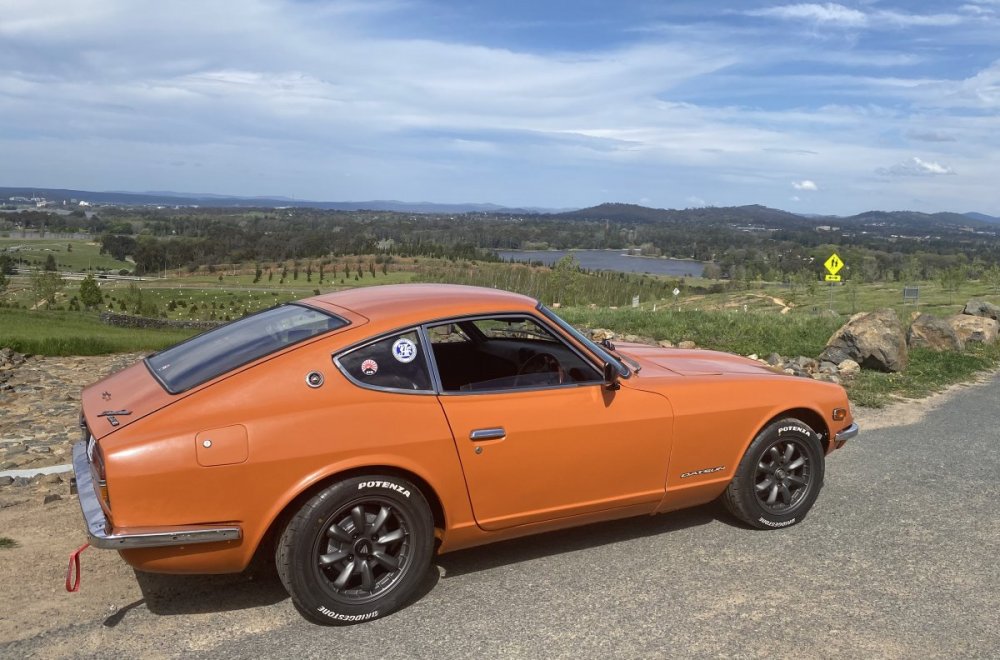

CBR Jeff Posted October 1, 2020 Author Posted October 1, 2020 Well 14 days short of 6 years the Z has number plates. So stoked about finally getting to this point. Spent all day driving around Canberra today. I’ll get some photos to post over the next few days. Other news is that I purchased a 1983 720 king cab (L18 5 speed) this week. These things are amazing in that you can still get nearly all the components and they are as cheap as chips. A new guard is under $100!!!! Should be a much quicker and simpler build. Planing on it being my daily work Ute, shop truck style. it’s getting delivered next week so I’ll post a few photos. Jeff ScottyD, Dragonball240z, AndBir and 2 others 5 Quote

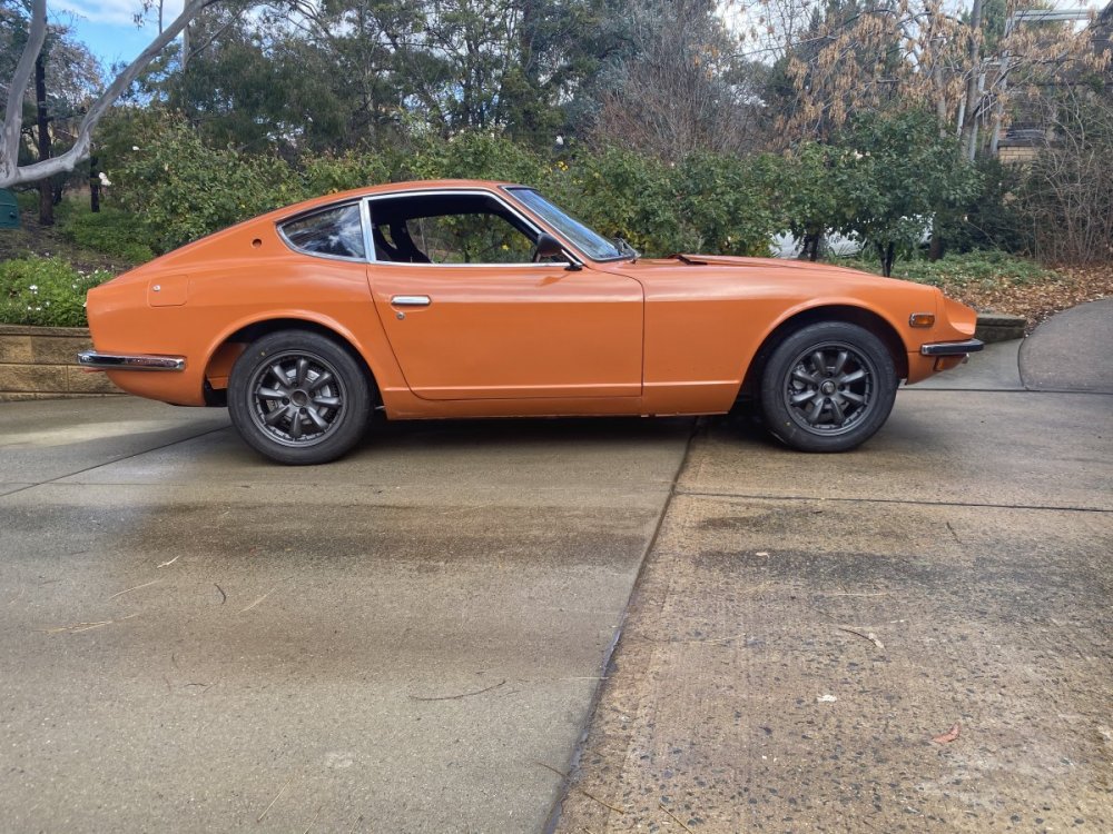

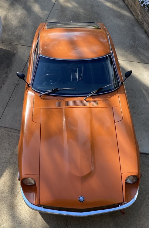

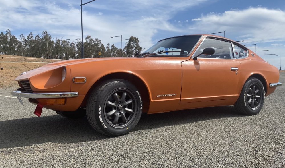

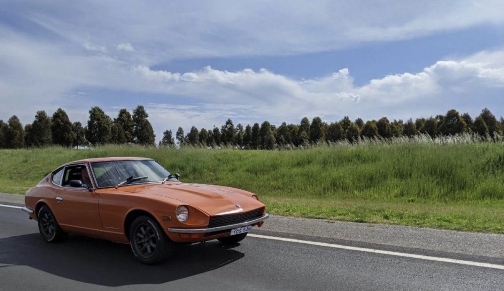

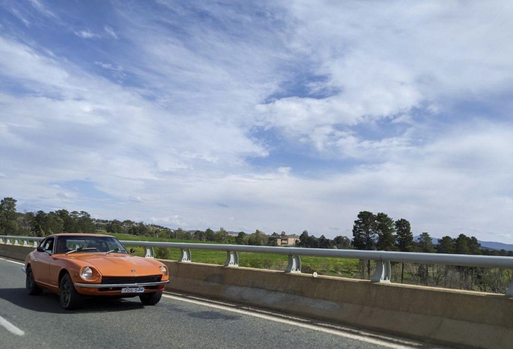

CBR Jeff Posted October 5, 2020 Author Posted October 5, 2020 As promised a few photos. Jeff Wags, KatoKid, 240ZBUILTBYME and 2 others 5 Quote

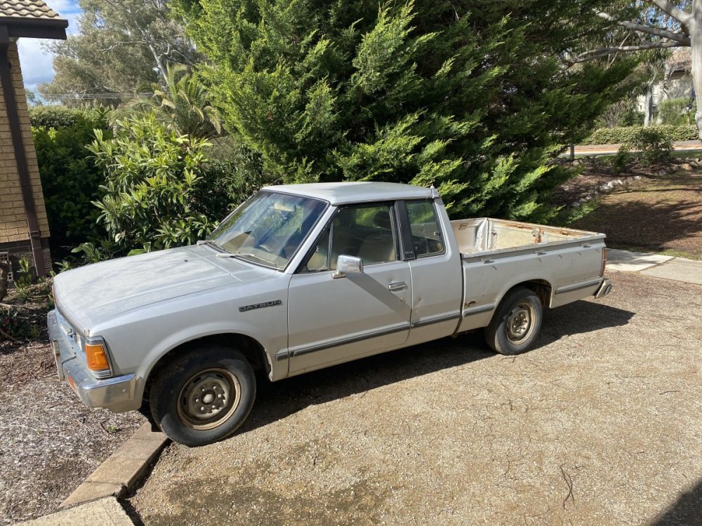

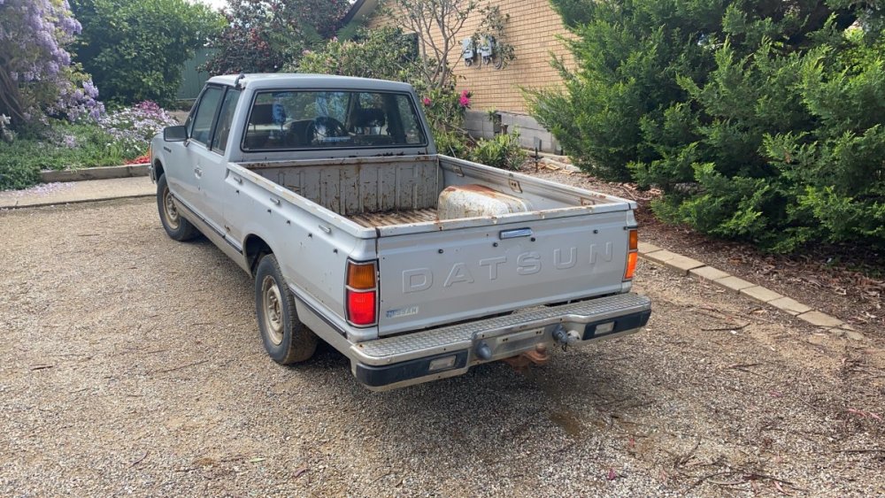

CBR Jeff Posted October 8, 2020 Author Posted October 8, 2020 The Datsun 720 arrived today. What a classic. Love the tailgate. Jeff Ponyo240z, JDM-TOY and gilltech 3 Quote
