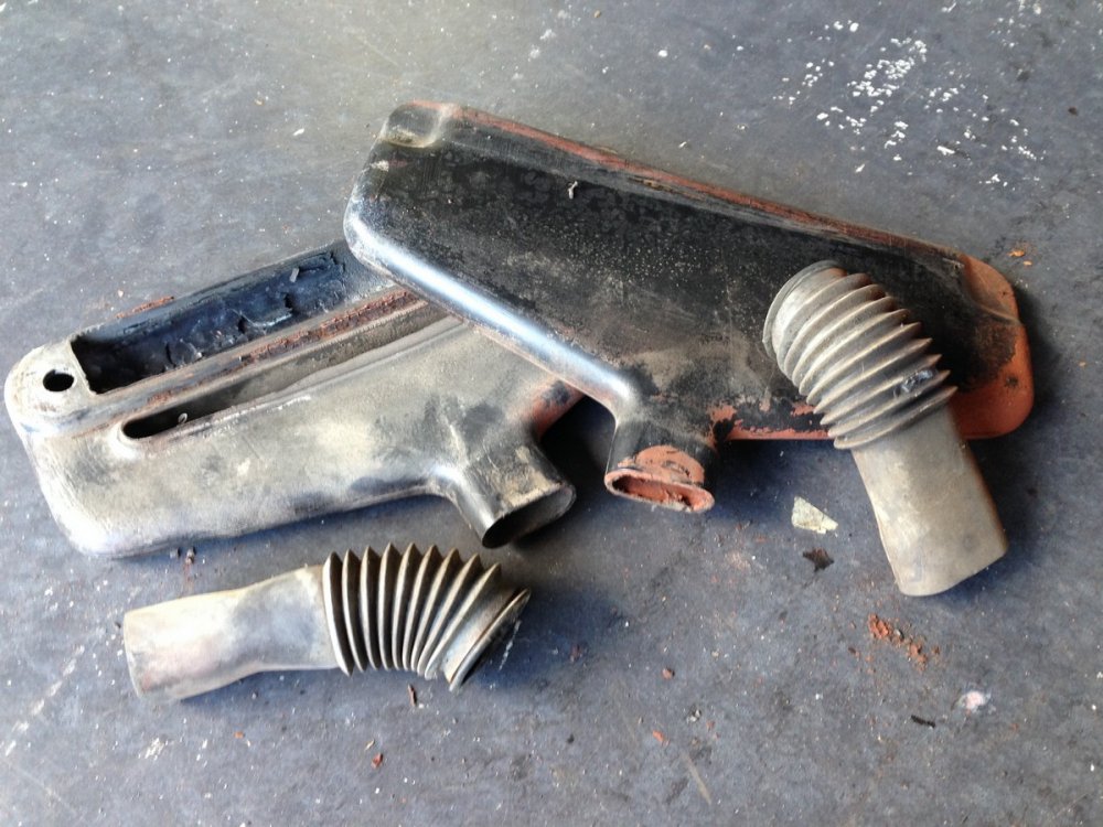

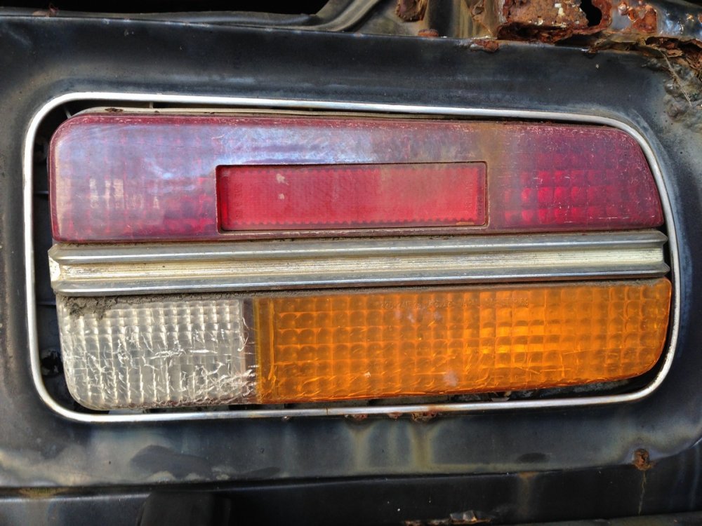

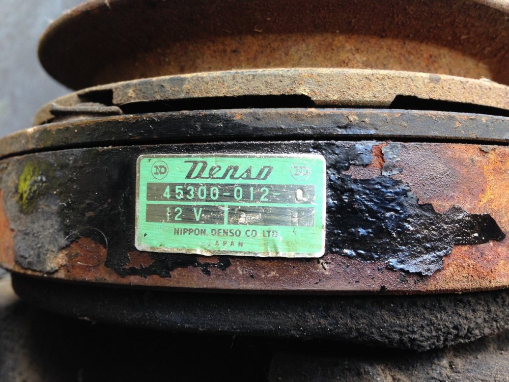

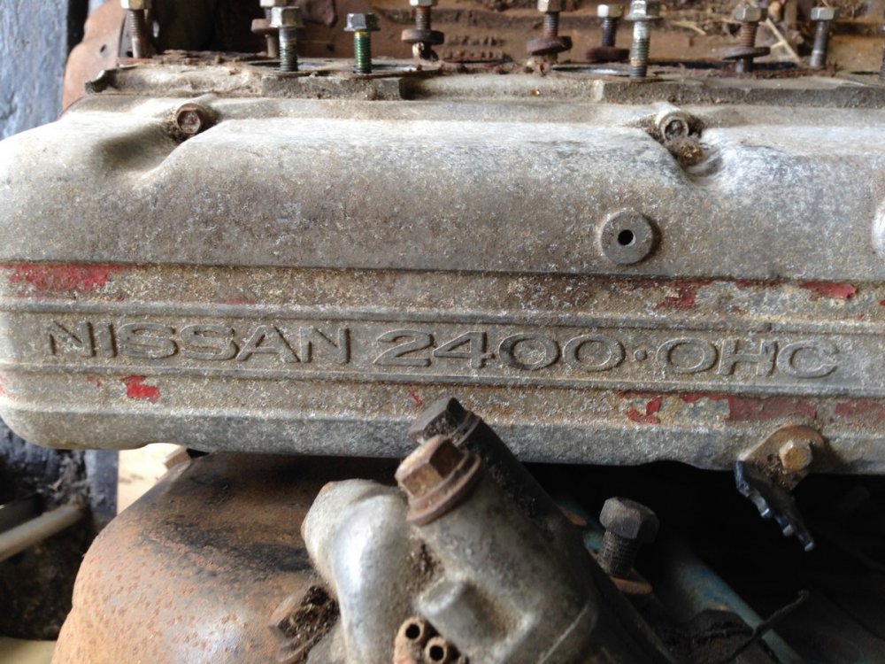

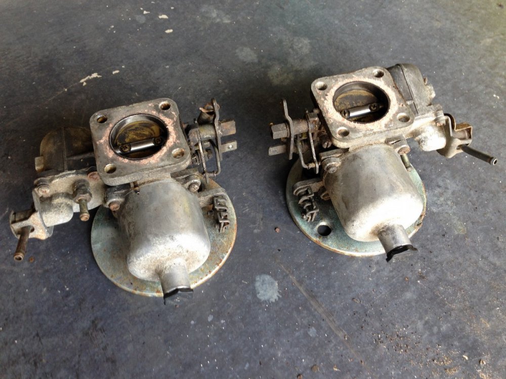

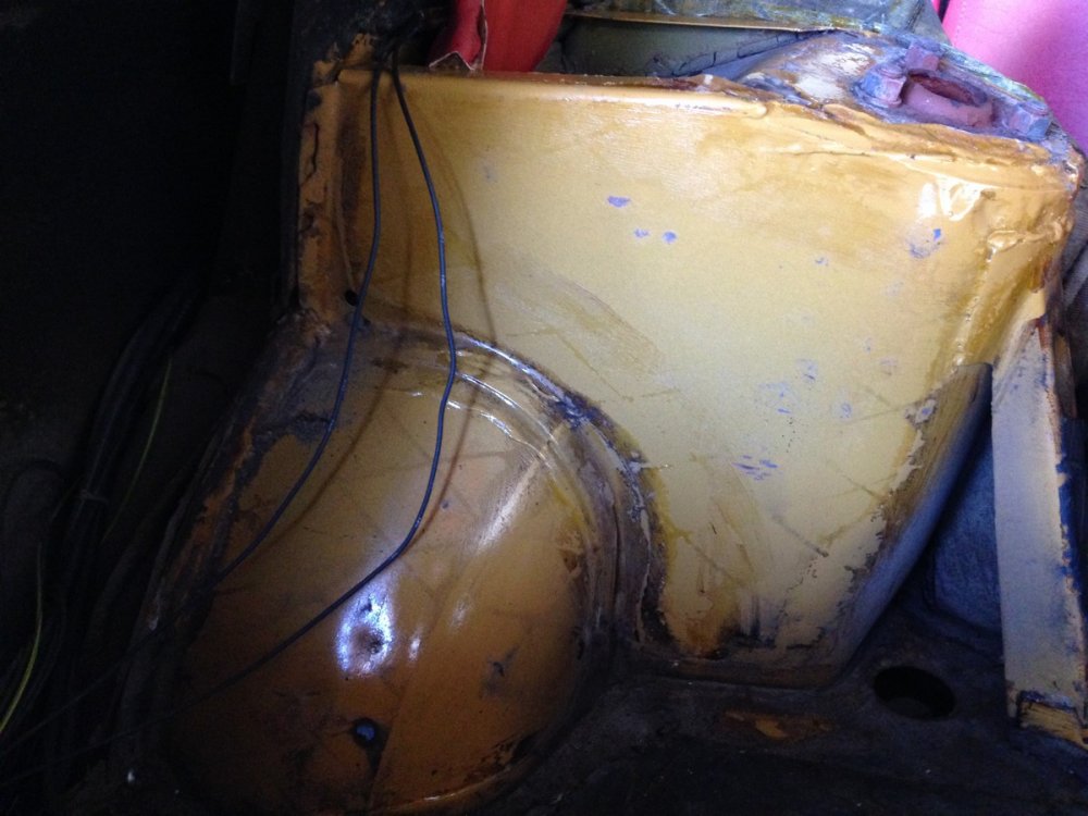

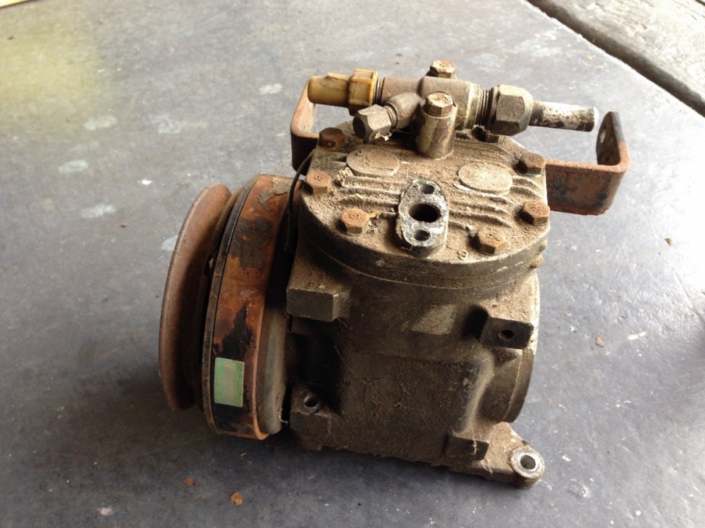

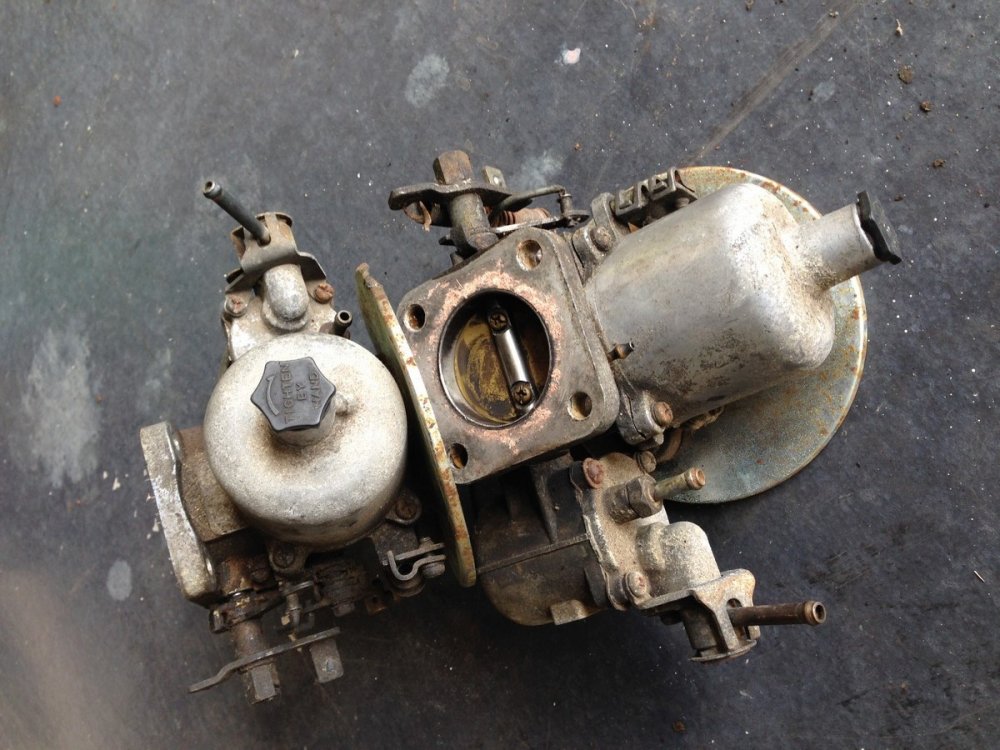

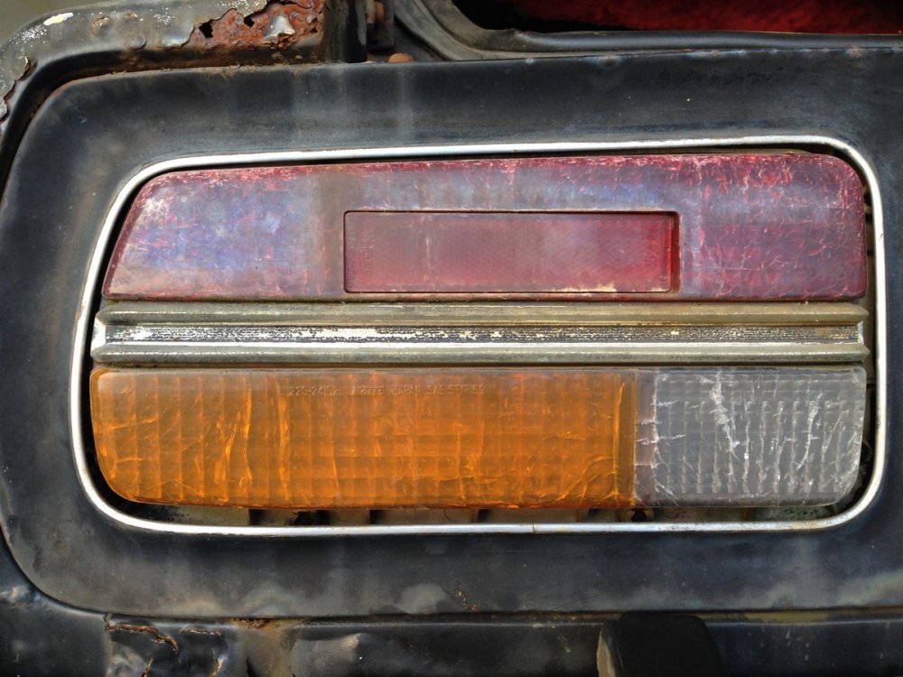

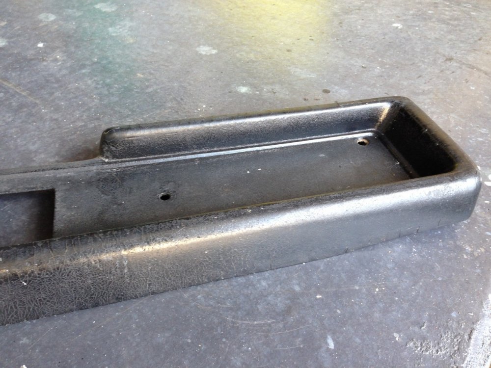

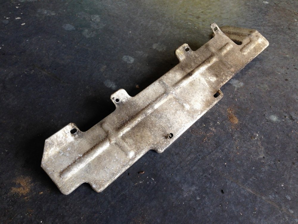

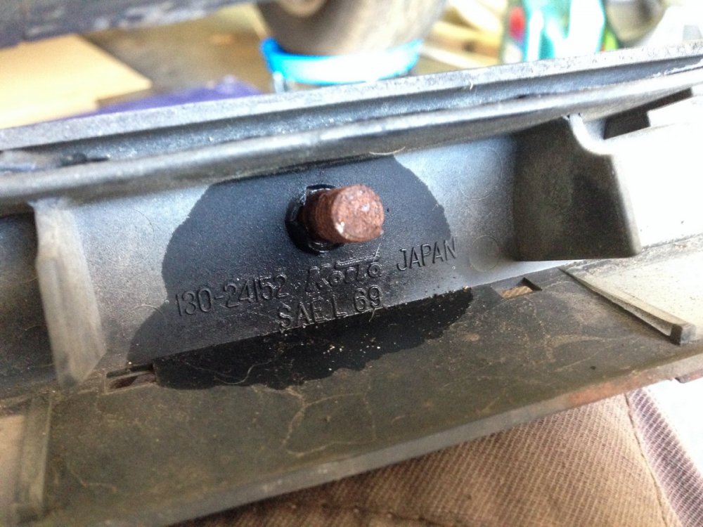

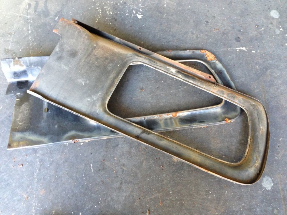

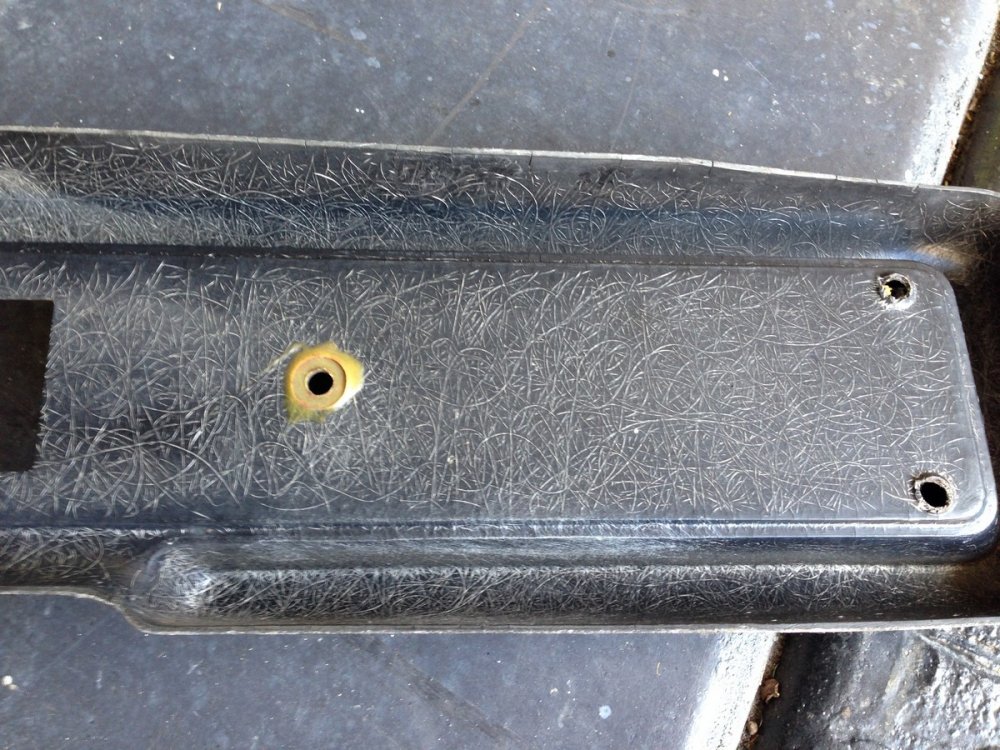

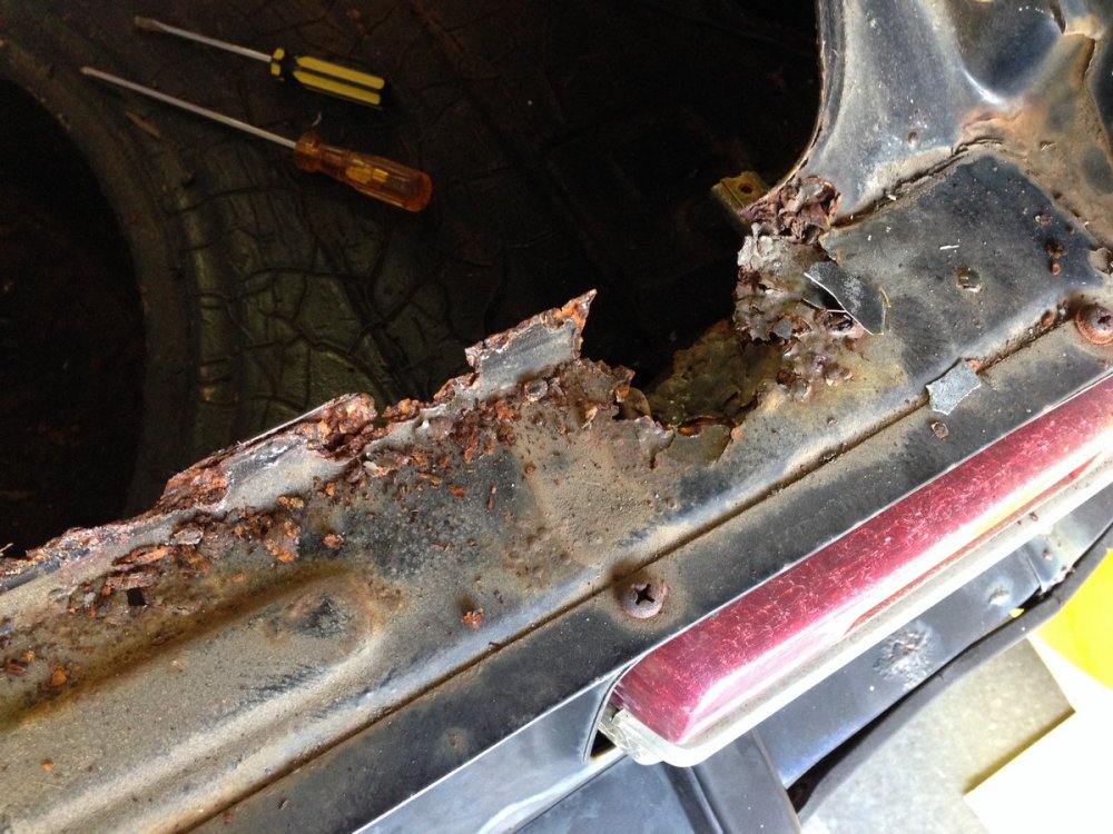

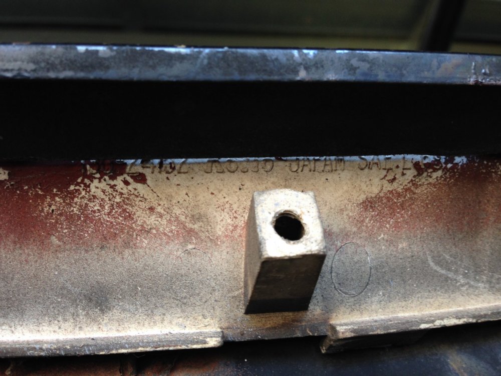

George Posted February 2, 2014 Author Posted February 2, 2014 Yay, no rust here. I'll take every small win. Console damage. Cracks. Made from fibreglass. Air con unit by Denso. I'm guessing not original? It's heavy. Should polish up nicely. The other cover looks in better condition but it's the later style. 4 screw SU's. I believe there were 3 heat-shield styles. This is the correct one for this car. Koito rear light assembly. Rough. Only a touch better. Eeeek! Will clean up well. License plate light assembly. Can be saved. The lenses, not a great shot I know, are still clear. The inside/rear part of the license plate assembly. Also usable. The left one is usable but the right one has some rust and will need to be replaced. My first snapped bolt and it was a fender one. I expected more to be honest. Interesting air horns made in Italy. Quote

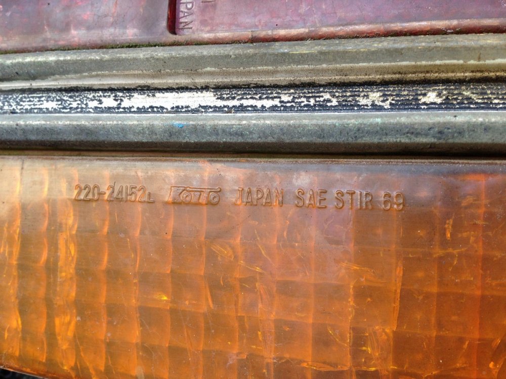

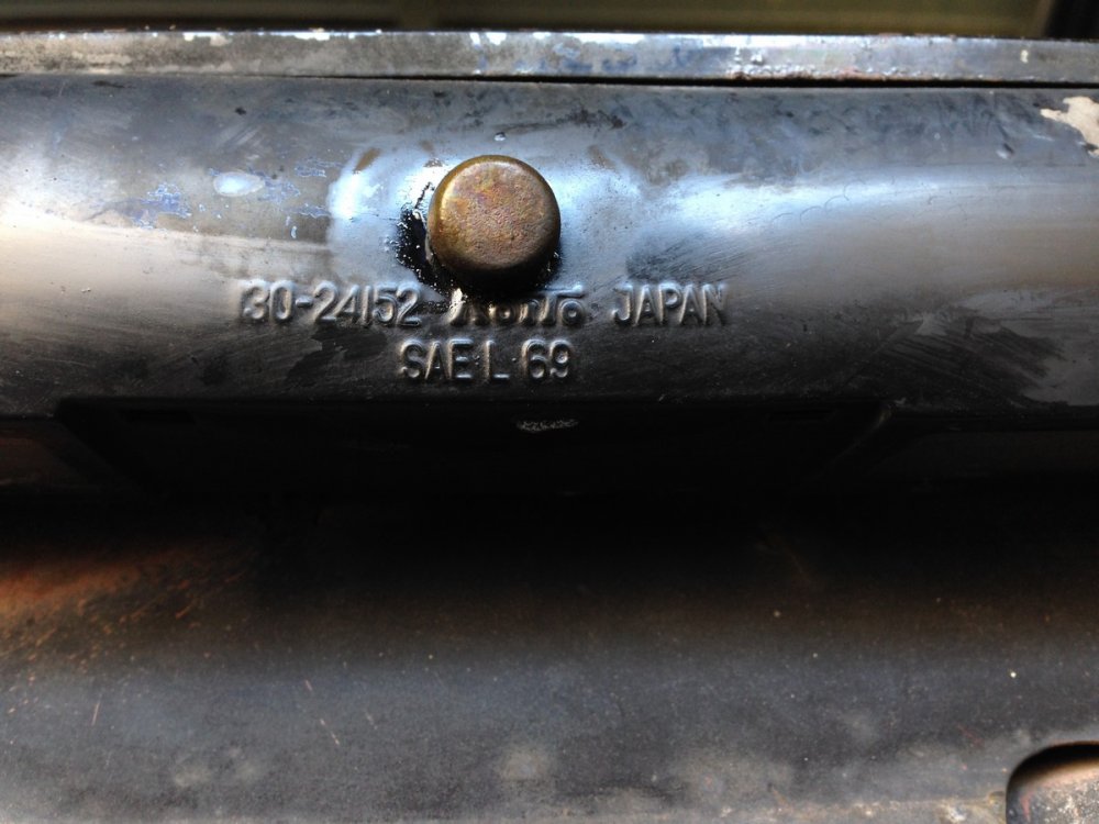

Administrators gav240z Posted February 2, 2014 Administrators Posted February 2, 2014 I didn't think the AU market got the 2400cc valve cover. Looks like we did. Unfortunately those tai lights are probably not fixable. What is in the middle of the rear licence plate light? Never seen that bolt? Looks after market. I wonder if that 69 stamped on the back of the koito licence plate is a reference to year of manufacture? Looks like Safari Gold it is . I think your console can be fixed. Mine had cracked in same area. A bit of fibreglass on the backside of it and it should give it strength. I thought the SU screw thing was in reference to the dome top screws not the manifold itself. They could be the originals. Maybe our market didn't get them? That air con could have been an original option. Don't worry about how those carbs and valve cover looks. Polishing alloy is not too hard and will make them like new. Cadmium plate the SU throttle parts to fix those. I'm looking into DIY kits since so many z parts were plated. Quote
