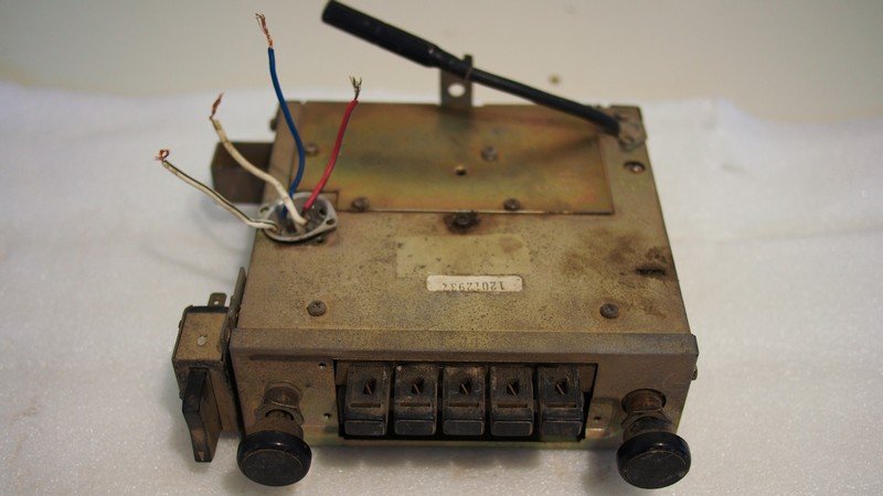

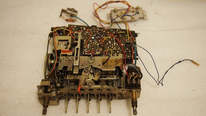

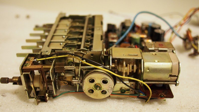

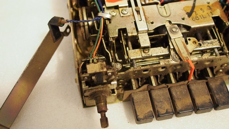

George Posted June 25, 2014 Author Posted June 25, 2014 There won't be too many posts of substance from me for the next 4 or so months. Paul has parked the shell while he finishes other jobs and I'm busy finishing some home renovations and then taking a holiday. Despite working 7 days a week for the past few months I've found the time to strip the shell and source some parts. Other than that I don't have the time nor the place to be working on anything related to the car although I have sourced a lot of parts but I don't really want to spam this thread each time a bolt or a clip arrives. Having said all that, I did find the time to play around with the radio. Check out the whole process here: I've mentioned before that I enjoy tinkering and that's all this was; just winding down for a couple of nights after work. PeterAllen sourced the platers and he did me a big favour running around town on his own time. The result is an interesting one with the streaks and wild colours unlike the original consistent cad plating finish. I believe it's called thin-film interference but I'm no expert in plating. It would have been fine to leave as is but I undid one screw and the rest followed. The inside was in need of a clean up as much as the outside. Funky streaks and colourisation. Quote

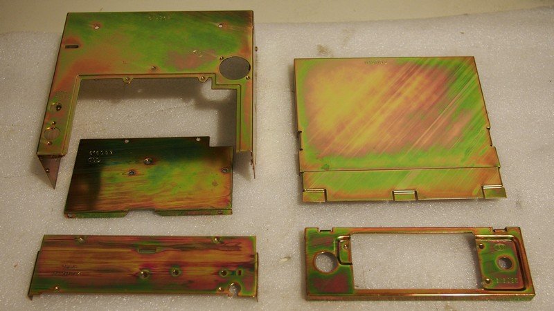

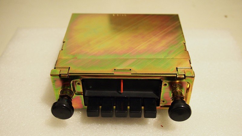

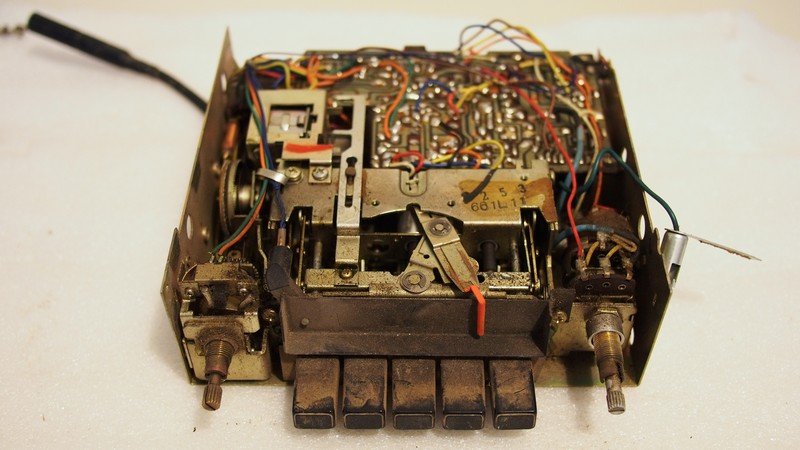

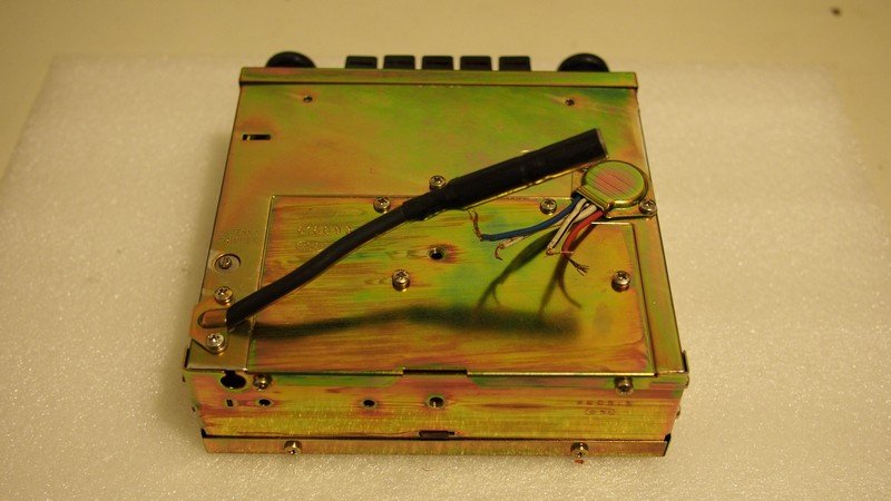

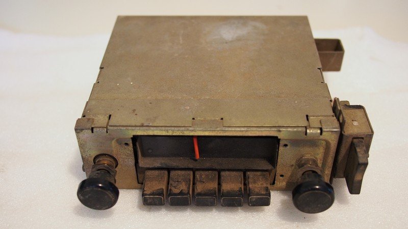

Administrators gav240z Posted June 25, 2014 Administrators Posted June 25, 2014 Hey George, radio looks good. Although I'm wondering if it's possible to get plating done that doesn't have that funky green colour in it? On a head unit like this it really doesn't matter as it's not going to be seen for the most part, but in the engine bay etc.. I'd rather a gold / yellow plating colour for hinges and latches, inspection lamp etc.. Quote
George Posted June 25, 2014 Author Posted June 25, 2014 Hey George, radio looks good. Although I'm wondering if it's possible to get plating done that doesn't have that funky green colour in it? On a head unit like this it really doesn't matter as it's not going to be seen for the most part, but in the engine bay etc.. I'd rather a gold / yellow plating colour for hinges and latches, inspection lamp etc.. Agreed Gav. For visible parts I would prefer a consistent finish as per older cad plating. Quote
d3c0y Posted June 25, 2014 Posted June 25, 2014 Looks great, i think once it's in the car you wont even think about the colour of the cad plating. I think it's easy to take some of these details too far that you wont be able to fully appreciate once it's installed. Quote
George Posted June 25, 2014 Author Posted June 25, 2014 Looks great, i think once it's in the car you wont even think about the colour of the cad plating. I think it's easy to take some of these details too far that you wont be able to fully appreciate once it's installed. I agree, this might seem like a waste of time but I really worked on the radio to get used to a new bench grinder which I'm using as a polisher and to try out plating parts. Brushing up on my soldering skills was a sobering experience as well. I should flog this radio on fleabay. I've seen some recently asking close to $1k for ones in worse condition. Quote

vorn70 Posted July 21, 2014 Posted July 21, 2014 Nice work on the radio George. I have just been catching up on you build budget and progress. I like you idea of putting a figure to each area. As the body work is getting done you can start to collect the bits and pieces you need, I'm sure where you spend more is some areas you might be able to save in others. Keep the updates coming mate. Quote
Administrators gav240z Posted July 22, 2014 Administrators Posted July 22, 2014 Agreed Gav. For visible parts I would prefer a consistent finish as per older cad plating. Actually George, I noticed when I was refurbing the steering wheel that the original horn assembly was in that yellow cad plating, but it had a hint of that discolouration like the Hitachi head unit you had done. I didn't get a good photo, but just saw this for a heater 'c0ck' on Yahoo! Auctions that shows this. By the way do you know what it costs to have parts electroplated like this? Does it make sense to do all items at once? I hesitate to give them everything in 1 go only because I'm scared they will loose parts etc.. Quote
George Posted July 22, 2014 Author Posted July 22, 2014 By the way do you know what it costs to have parts electroplated like this? Does it make sense to do all items at once? I hesitate to give them everything in 1 go only because I'm scared they will loose parts etc.. Gav, Peter and I paid $80 for a small lot of parts but in saying that I don't think it'll go up by much, if at all, if we had twice as many parts. To a plater I imagine the cost is in the prep as that's the manual component. As long as that part of the job is relatively easy it shouldn't cost a lot. I wouldn't do everything at once if it's the first time you're using the plater. Try them out with a small collection of parts and if you're happy do the lot. As for loosing parts, I wouldn't worry too much as long as you don't give them a chance. By that I mean drop them off and pick them up ASAP. I understand your concern there and I'm sure they would as well so bring it up prior to engaging their services. I bet they get that question from restorers all the time. Quote
PeterAllen Posted July 22, 2014 Posted July 22, 2014 A lot of the green/purple discolouring you see in photographs is the result of flash photography. While they are not perfect they look much better to the naked eye. Interestingly the less polished the surface the more consistent the colour seemed to be. Unlike chromium plating it appears that a rougher, media blasting, finish results in a better zinc-passivating finish. A photo of the lot, minus George's bits, is available on the 'Plating' thread I started. The cost depends somewhat on the labour involved. In our case George included a dozen very small screws and tiny washers which the plater had to bind individually to a length of fuse wire for dipping. I thought it was great value for money. Quote

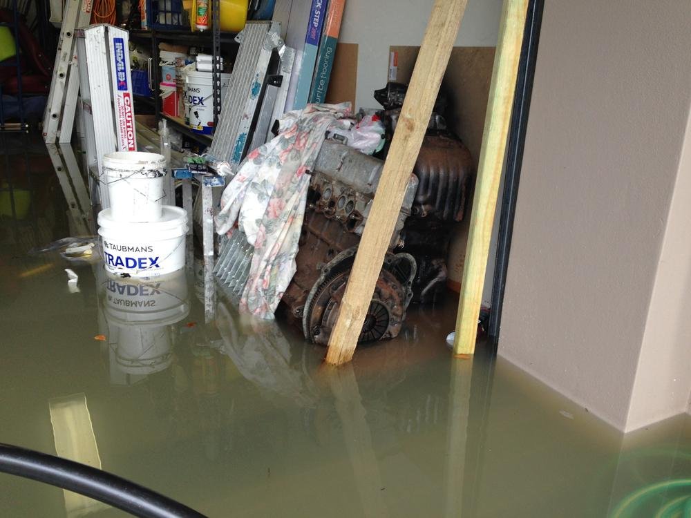

George Posted August 19, 2014 Author Posted August 19, 2014 So this just happened today. The spare engine is on the left and is sitting on the sump. Seems ok. The matching numbers engine leaning against the wall got some water in I believe so it will need some attention. I also had a tranny and the diff sitting on a trolley further back but they barely got a splash on them. Long day and we're still a bit damp! The water got up to around 12cm in places and did a bit of damage but nothing that the insurance can't fix. Just a bit of a pain really. Quote
