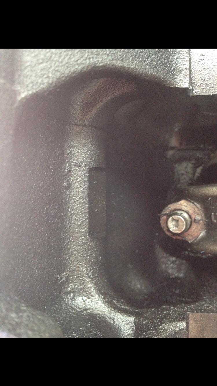

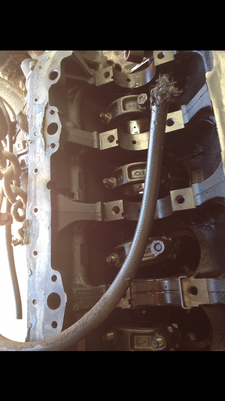

  19. Gordo, no unfortunately not. It's in bits and pieces again Regarding numbers on clearance I found this http://www.zcar.com/forum/10-70-83-tech-discussion-forum/277137-stroker-rod-bolt-clearance.html It's says "0.080 to 0.100" clearance through full arc of rotation" So that's what I'll check for.
  20. Hahaha, I wish! Yeah I am doing a dummy assembly to see if any other bits will cause an issue. In terms of clearance, is 1mm ok or would 3mm be better incase anything stretches under load. I was wondering if there is a specific minimum clearance measurement.
  21. I'm building a stroker up at the moment and I have read about potential block clearance issues. I'm running an LD crank, Datsun spirit light weight 139.5mm rods and Pistons. I noticed when I tore down an LD engine that the block had been clearanced by the factory (see pics). It appeared to be the main oil gallery. What sort of clearance to the block is sufficient for an engine at high RPM and how thick will the gallery walls be? Cheers, Gareth.
