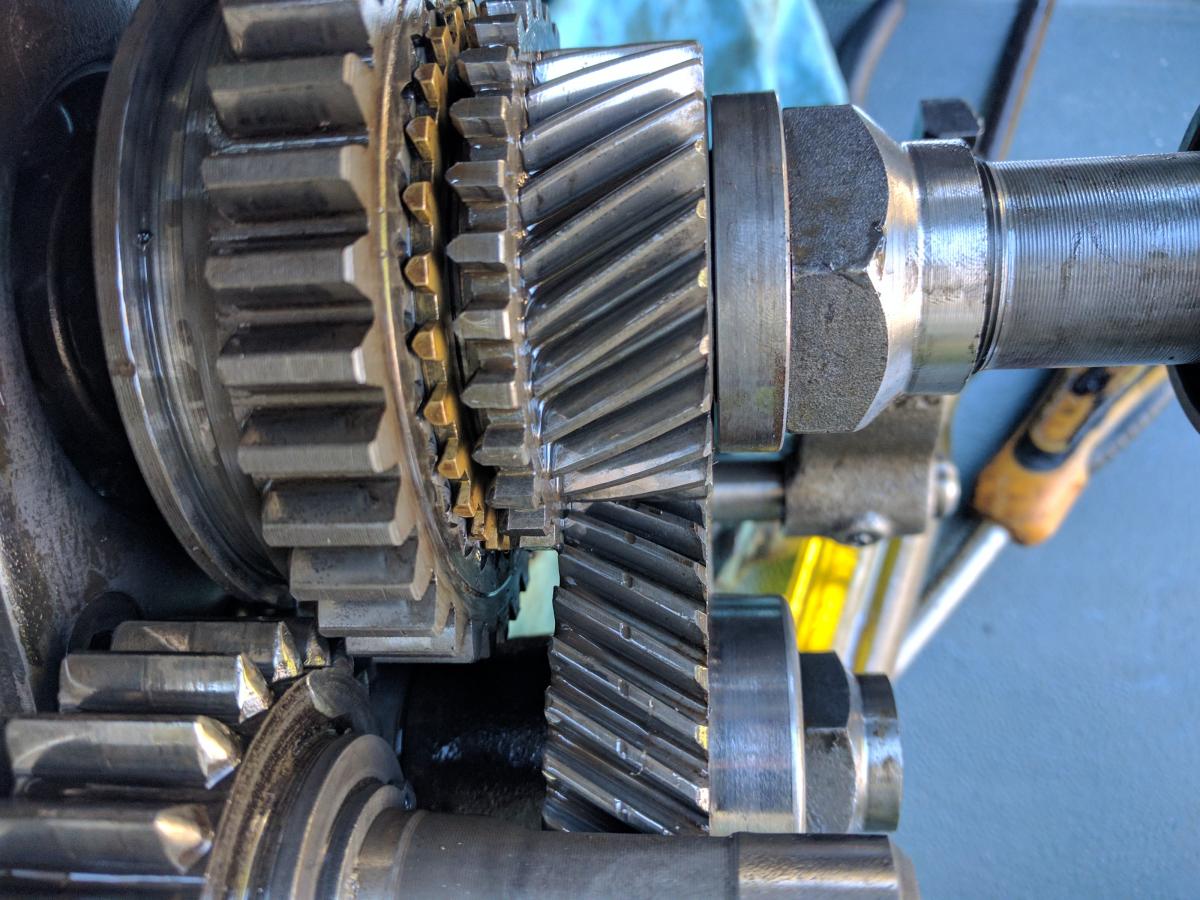

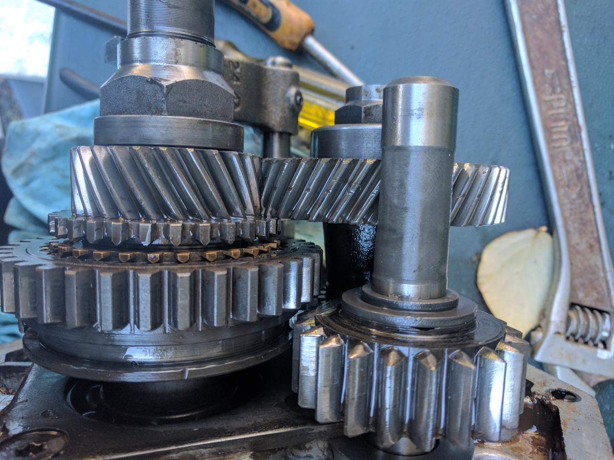

Andrew_L26 Posted July 2, 2017 Posted July 2, 2017 (edited) So when I did my manual conversion I noticed my gearbox has a significant chugging/whiring in neutral. It goes away when the clutch is depressed so it's not the throw out bearing. I've taken apart the trans expecting to find one of the bearings to be munted but they all seem fine. It would appear that it is these two gears fouling on each other. I was thinking I could possibly grind down the side of the gear to stop them from touching but that seems extremely hack! The synchros felt fine when driving the car but I was wondering if there is any easy way to check their condition (tolerances etc.) Also, is there any way to tell the ratios from counting teeth etc. As it would be nice to know what this box is! Edit* To confirm its the upper step's side that is fouling on the other gear Edited July 2, 2017 by Andrew_L26 Quote

Howdy Posted July 4, 2017 Posted July 4, 2017 G'Day Andrew, if the countershaft is pushed all the way back, 5th shouldn't be hitting reverse but this sometimes happens after pulling the housings off and the countershaft slides forward. I can't see any countershaft thread out the back of the nut but is hard to see from the side view, normally there is a little shaft showing or it is flush with the nut. If the nut is overhanging the countershaft, maybe there is something not quite right. You can check alignment by bolting only the front bell-housing up and front cover with the countershaft shim (or no shim) installed (leave the extension housing off) tap forward both shafts and check there is clearance between 5th and reverse. If not you may have incorrectly installed spacers somewhere. There shouldn't be any grinding when you turn the main shaft. I reckon it will look right when you bolt the front up. Make sure you get measurement "A" right by using the correct countershaft shim and allow for any gasket you use on the front cover. As the others said, if it is a quiet whiring sound, probably OK but if it is a whine and there are no chips, rust etc on the teeth, probably input shaft bearing. It is always important to put new, good quality bearings in while it is apart, especially if you have reasonable power because these boxes are not very strong. Worn bearings allow too much gear spread under load, especially 3rd gear, and is the reason for a lot of failures in my experience. Andrew_L26 1 Quote
Andrew_L26 Posted July 4, 2017 Author Posted July 4, 2017 All your assumptions are incorrect Andrew. You need to replace the input bearings, but while it's apart you might as well rebuild it with a full set of new bearings. And FWIW, it's a (wide ratio 3.3 1st) 280ZX gearbox. Thanks, where would I source a new set of bearings. Just match the part numbers on the bearings and order some quality replacements? I'm not wanting to spend stacks on this box as let's be realistic I purchased it for $150 and I might upgrade to a SR box as I'm hoping to be pushing 220KW at the wheels (Turbo L28) How are you able to identify the box? G'Day Andrew, if the countershaft is pushed all the way back, 5th shouldn't be hitting reverse but this sometimes happens after pulling the housings off and the countershaft slides forward. I can't see any countershaft thread out the back of the nut but is hard to see from the side view, normally there is a little shaft showing or it is flush with the nut. If the nut is overhanging the countershaft, maybe there is something not quite right. You can check alignment by bolting only the front bell-housing up and front cover with the countershaft shim (or no shim) installed (leave the extension housing off) tap forward both shafts and check there is clearance between 5th and reverse. If not you may have incorrectly installed spacers somewhere. There shouldn't be any grinding when you turn the main shaft. I reckon it will look right when you bolt the front up. Make sure you get measurement "A" right by using the correct countershaft shim and allow for any gasket you use on the front cover. As the others said, if it is a quiet whiring sound, probably OK but if it is a whine and there are no chips, rust etc on the teeth, probably input shaft bearing. It is always important to put new, good quality bearings in while it is apart, especially if you have reasonable power because these boxes are not very strong. Worn bearings allow too much gear spread under load, especially 3rd gear, and is the reason for a lot of failures in my experience. I'll defiantly check all that and seriously look at some new bearings. There is a little rust on a few of the gears as well as one of the selector forks. There is a fair amount of pitting on the first gear (closest to bellhousing) on the countershaft, would this be the cause of the noise and is it an issue? I would imagine that it will wear the opposing gear quicker and possibly cause the tolerances to go out of whack over time leading to failure. There doesn't appear to be any chips in any of the gears however the oil that I put in it about a year ago (has probably done maybe 30Km on it, was really black and had plenty of metal shavings in it. the gearbox did have some sort of grease additive caked on the inside of the housing which had plenty of metal shavings in it. I will investigate further when I get home! Thanks stacks for your replies! Andrew Quote
Howdy Posted July 4, 2017 Posted July 4, 2017 Hey Andrew, black deposit is normal in a long service box and some small fine metal flakes like small hairs on the magnetic drain plug but not lots of metal shavings on the inside of the bell-housing. Work out if the shavings are alloy, brass, or magnetic - will give you and idea where they came from. Best to pull it apart and check the needle roller bearings and inner races which each gear rides on. The box may have been sitting for some time and surfaces have rusted. That box will break the countershaft drive gear, 3rd gear or 5th with a turbo L28 @ 220 RWKW if you use the power a bit. An SR box in very good condition might last for a while but may eventually break 3rd or 5th gears after a bit of abuse. You can beef them up a bit by adding a heavy duty 11 ball bearing on the input shaft (std is 9 from memory) and a HD needle roller bearing (the contained type so it holds thrust) on the rear of the counter shaft and limit oil flow through the sandwich plate - late model SR boxes have a 1 way trap door to block flow towards the rear under acceleration which causes starvation of oil to 3rd. The bearings are available at most bearing suppliers. Quote
dat2kman Posted July 4, 2017 Posted July 4, 2017 (edited) Have you tried a different oil? Plenty have filled with Redline Lightweight Shockroof 90, ( smurf blood) with very good results. Gearbox rebuilders hate the stuff as it sticks everywhere inside the box, and is a bit hard to clean, on teardown. This oil quite often solves a noise issue. However, looking at bottom pic in your post, with red circle, IIRC there should be a spacer fitted before fifth countershaft gear, that lower gear usually does not sit that far forward.. Edited July 4, 2017 by dat2kman Quote
