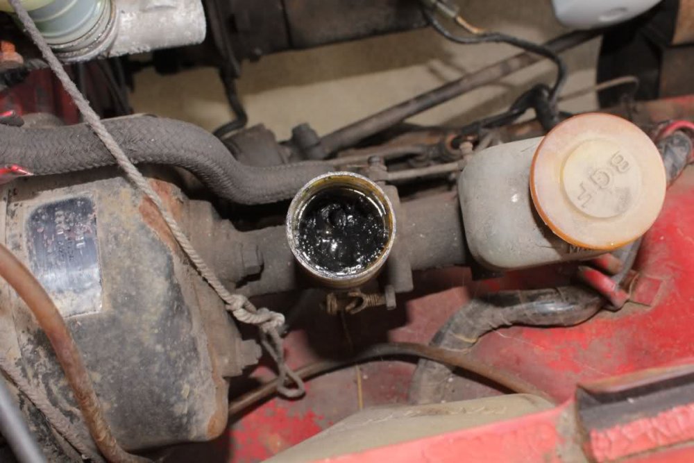

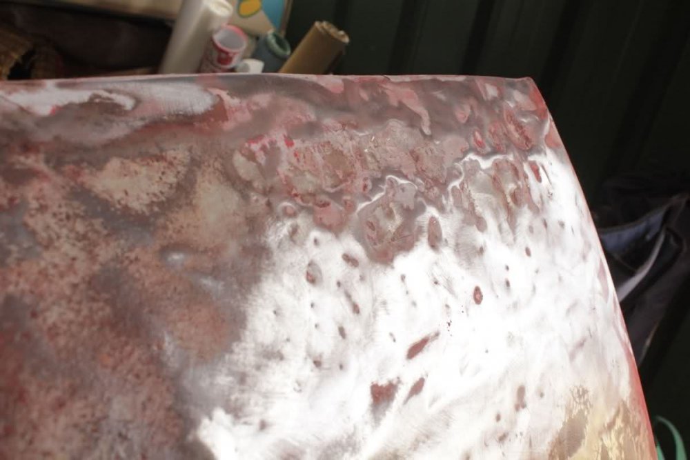

thriller Posted January 29, 2012 Posted January 29, 2012 My new old car. An interesting place for rust: Passenger side is pretty well shot to shit. Sneaky hole underneath the passenger fender Finally part of the car without rust: Engine bay looks tidier than the rest of the car Almost complete lack of passenger floor. This is a little bit concerning as I don't think the standard replacement floors reach this far back. Might have to find someone splitting up a shell and get a donor patch After a few hours with the car I had a bit of a poke under a tiny hole I'd spotted, opened it up a bit and found a bit of a nightmare... The worst thing is I have no idea the extent of the rust under here Anyway now onto the actual work. I've started stripping the bonnet back using one of those 3M strip discs (drill type. bunnings didn't have the grinder one last time I went?) and it's taking a very long time because there seems to be more than a few layers of paint on the bonnet. It seems to go metal-factory red-primer-red respray-primer. Would I be better off using chemical stripper for this? Doesn't seem like a problem on any of the other panels, they all strip back quickly. Quote
